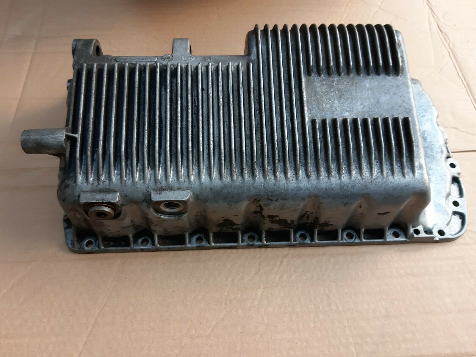

Goce Posted April 6, 2021 Report Posted April 6, 2021 In that case it's an easy fix, try changing the oil temp sensor, its the one next to the oil drain plug on the oil pan. They are cheap, if that doesn't fix it, you can add resistors to the wire from the sensor to add or subtract resistance, with that lower the gauge reading. Quote

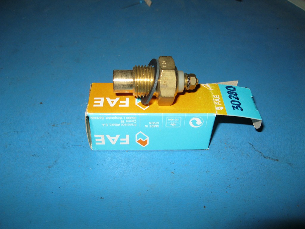

91MR2 Posted May 28, 2021 Author Report Posted May 28, 2021 Gentlemen, long time, no update... I've been enjoying trouble free driving in the Mi16 for the last couple months, as I waited for my oil temperature sensor to arrive, and it finally did the other day, so after a few days of fiddling around in the garage, it is now installed. However, my issue is still there with the higher readings. My first clue that this wasn't going to fix my issue was when it arrived, I tested the ohms on it compared to my original one. Sadly, they were reading almost the same. I kind of figured that it was unlikely to cause any changes once the new one was installed, and of course that was the case. Was worth a shot for the low price/effort, plus my oil was due to be changed anyways... Seems the issue now may lie in the gauge itself (good call, Bean), since as I noted, the oil level gauge too gives seemingly incorrect/inconsistent readings. I now have to decide how far I want to go with this issue... Since I've been able to verify oil temperature with my infrared gauge (getting around 175-185 when I shoot the bottom of the pan), I think it is safe to assume my gauge is regularly reading about 50 degrees too high. I hate looking at it knowing this, but at least I know for sure now... Options at this point now are to pull the cluster and then ??? I already briefed my mechanic on this one, he's not sure yet if he wants to start pulling the cluster apart. Can't say I blame him, as I don't want to either. I could buy a used cluster from Brian Holm I guess, and then try to match the odometer. Or try to find the gauge itself if possible and swap into my cluster? But struggling a bit with the decision of whether it's worth it or not... Thoughts? Quote
Bean Posted May 28, 2021 Report Posted May 28, 2021 I’d calibrate the sensor readings with the temps using a potentiometer to add resistance to circuit in series, or run it in parallel to lower the resistance to the point where it reads the temp the same as the gun. Sensor is fixed/not adjustible, and you really have no idea if the gauge cluster can be adjusted, but since it all works, “calibration” is all it needs to work properly. I’d wager once the proper resistance is found, that will bring the gauge range into proper spec. Rabin Quote

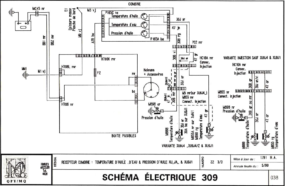

SRDT Posted May 28, 2021 Report Posted May 28, 2021 First try to check the wiring, sadly I don't have any 405 wiring diagram but looking at the 309 diagram you may have many things that can go wrong between the sensor and the cluster: Anyway removing the cluster doesn't look too hard: http://xrms.free.fr/phpwebgallery/category.php?cat=12&start=0 Sure you need to take the top of the dashboard off but after that you got plenty of space. For having done the exact same fix than this guy on a 309 I can tell you that it's not as fun when you need to put back the cluster. Quote

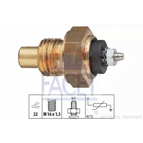

91MR2 Posted September 8, 2021 Author Report Posted September 8, 2021 Also, I'd like to replace all the coolant related sensors, anyone know the part #'s and a good place to purchase from? Also, how many sensors there actually are? 3 or 4? More? Quote
91MR2 Posted September 9, 2021 Author Report Posted September 9, 2021 Small update, after speaking to Brian Holm, it seems there are 5 total sensors/switches related to coolant temperature. The 3 clustered near the thermostat / water jacket are the one for the temperature gauge (1 wire), one for the signal to the ECU, and one for the fans (we think). Then there are 2 others, a low coolant warning (suspected to be in the radiator), and an overheat light sensor (not exactly sure where this one is located). I ordered the sensor for the fans, as well as one for the temperature gauge (just to be sure everything is accurate/linked). Once it arrives I'll install and update accordingly. Quote
