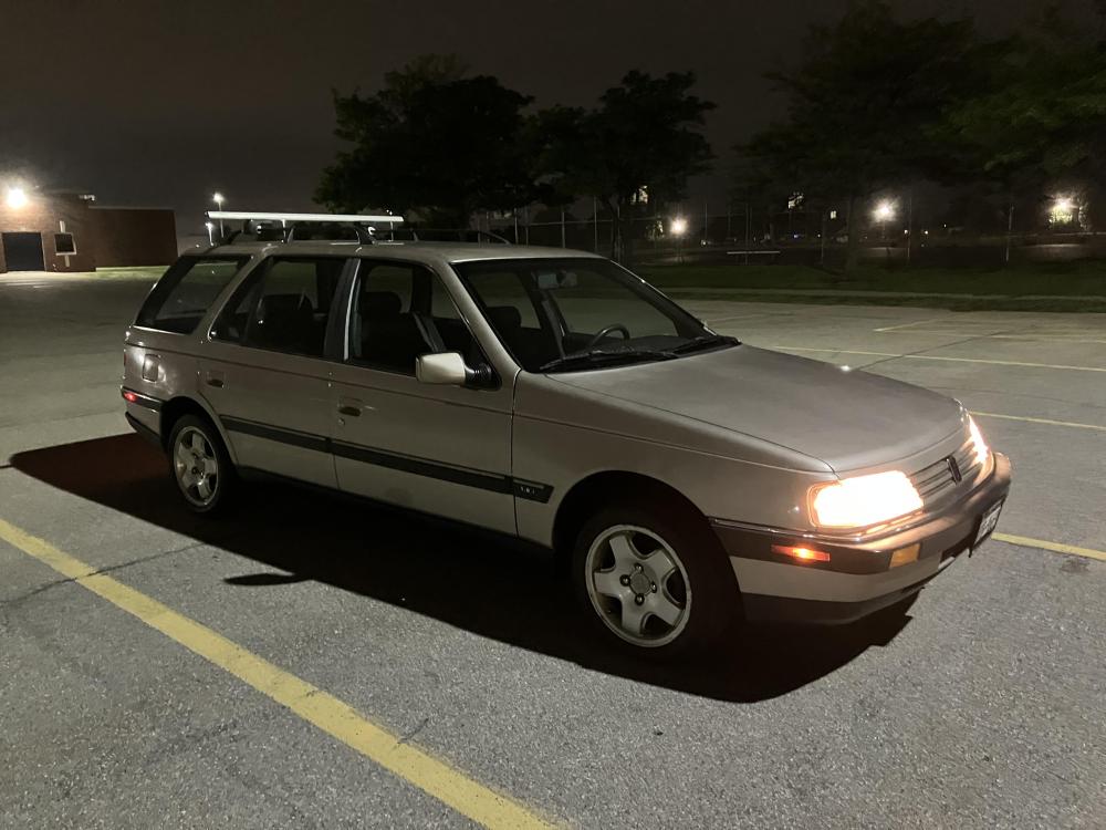

Hey guys, been way too long since I've had an update here. I've been working on my latest Lotus Esprit project, but it should be wrapping up soon. I have also since picked up another Peugeot 405, details will be shared soon, as there will be some work to be done on it as well... -

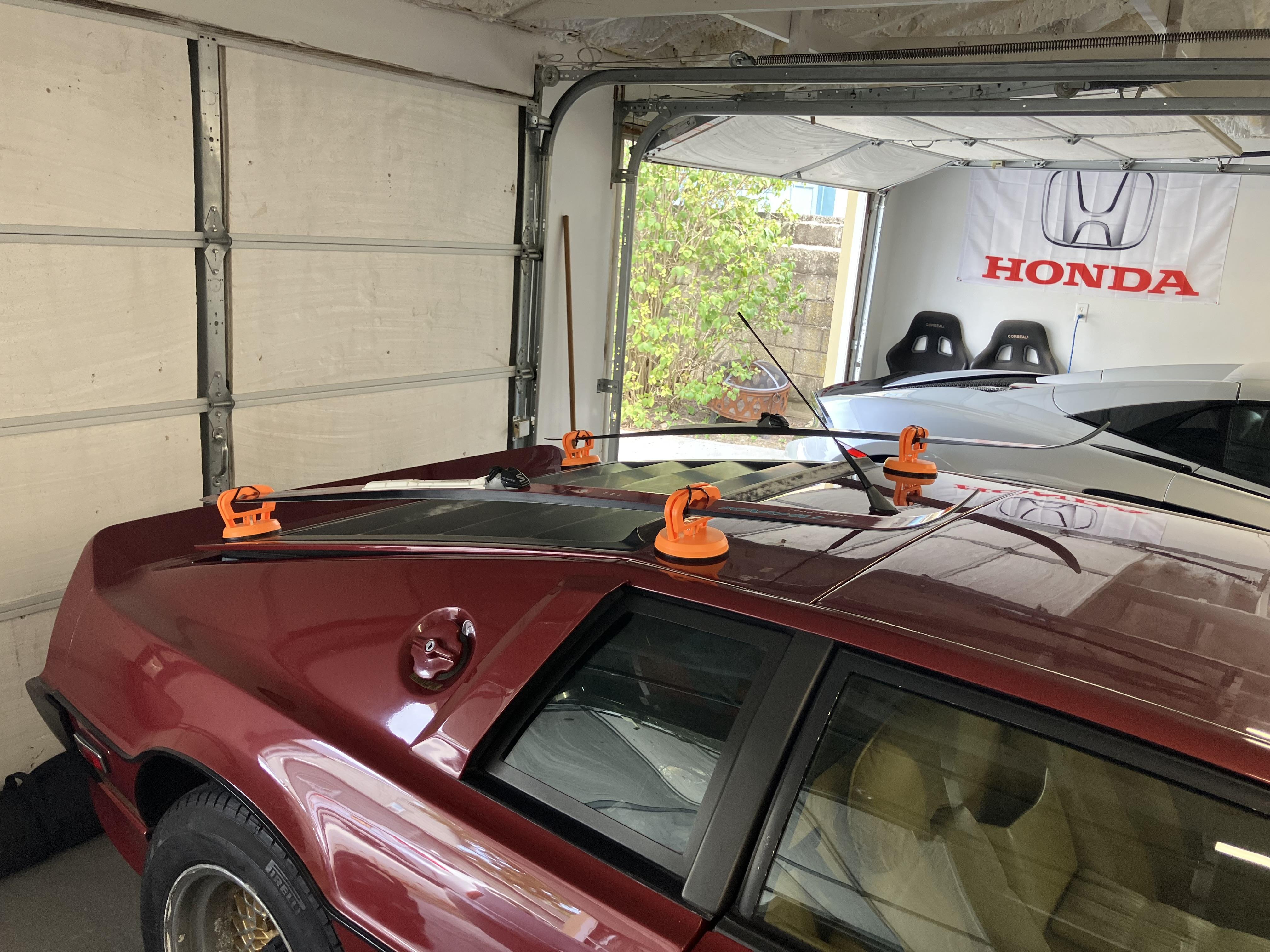

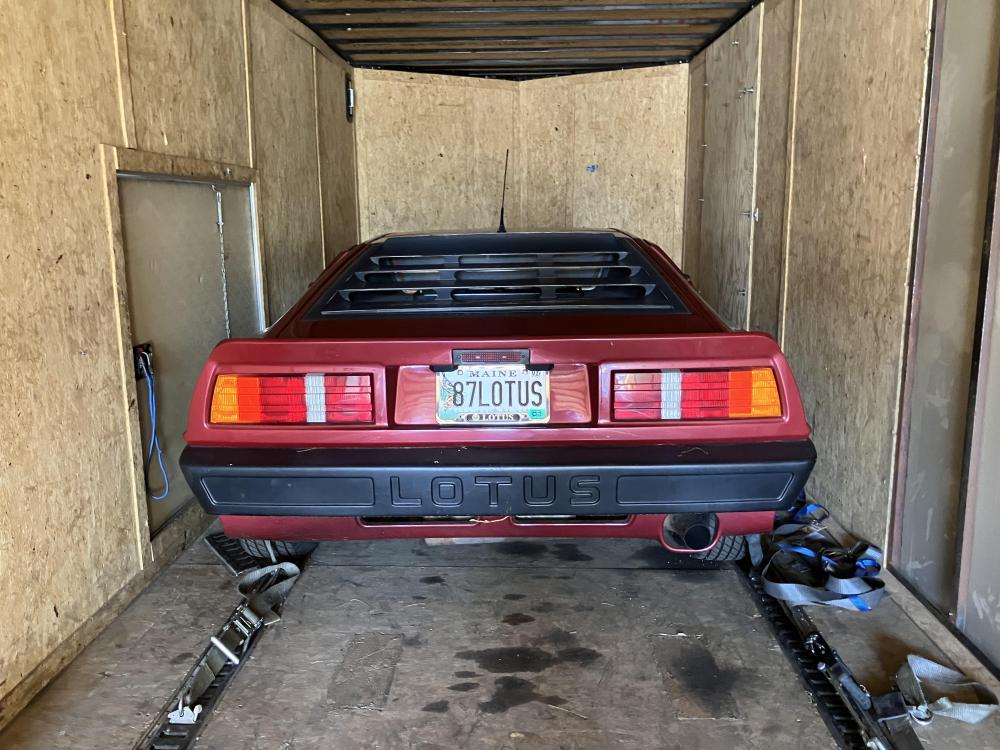

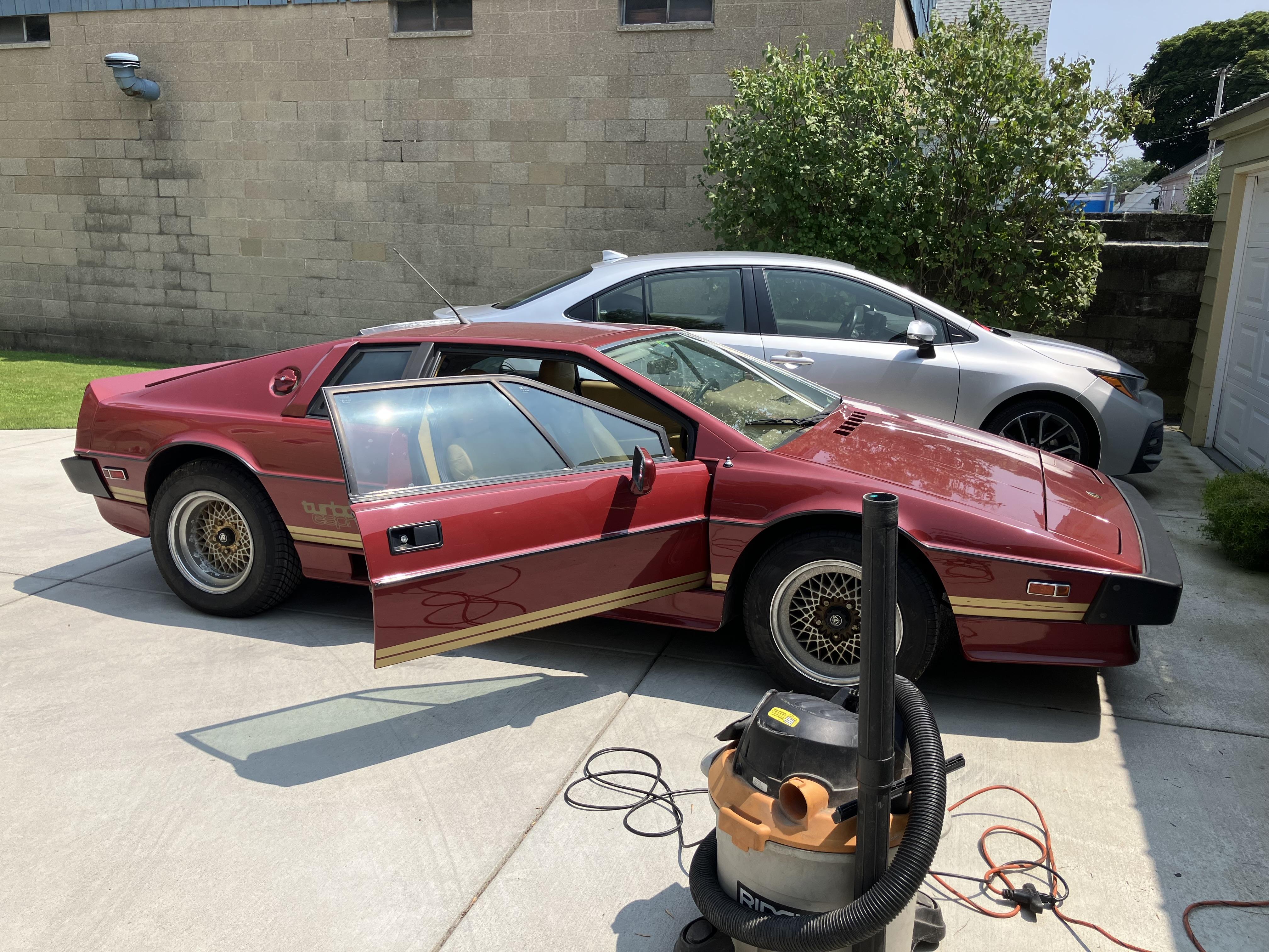

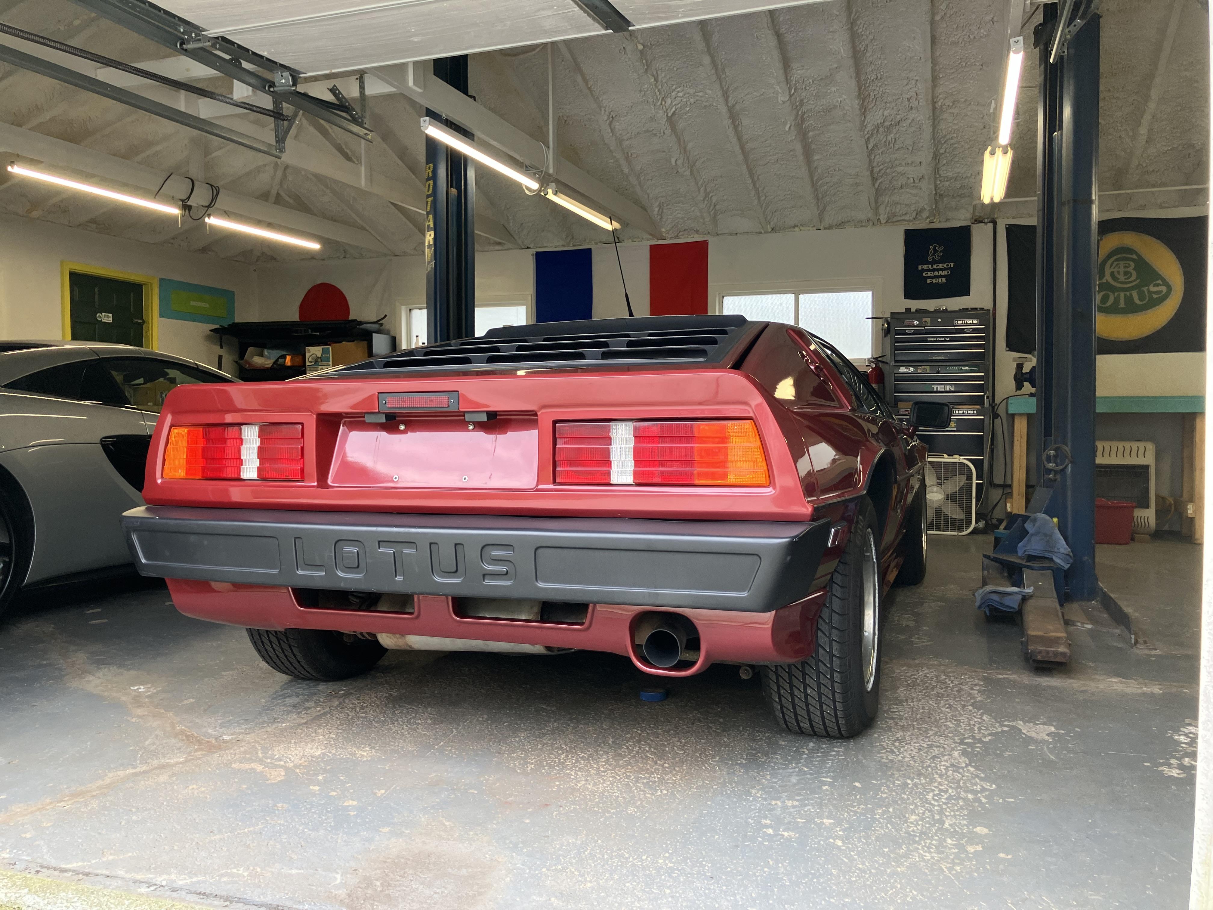

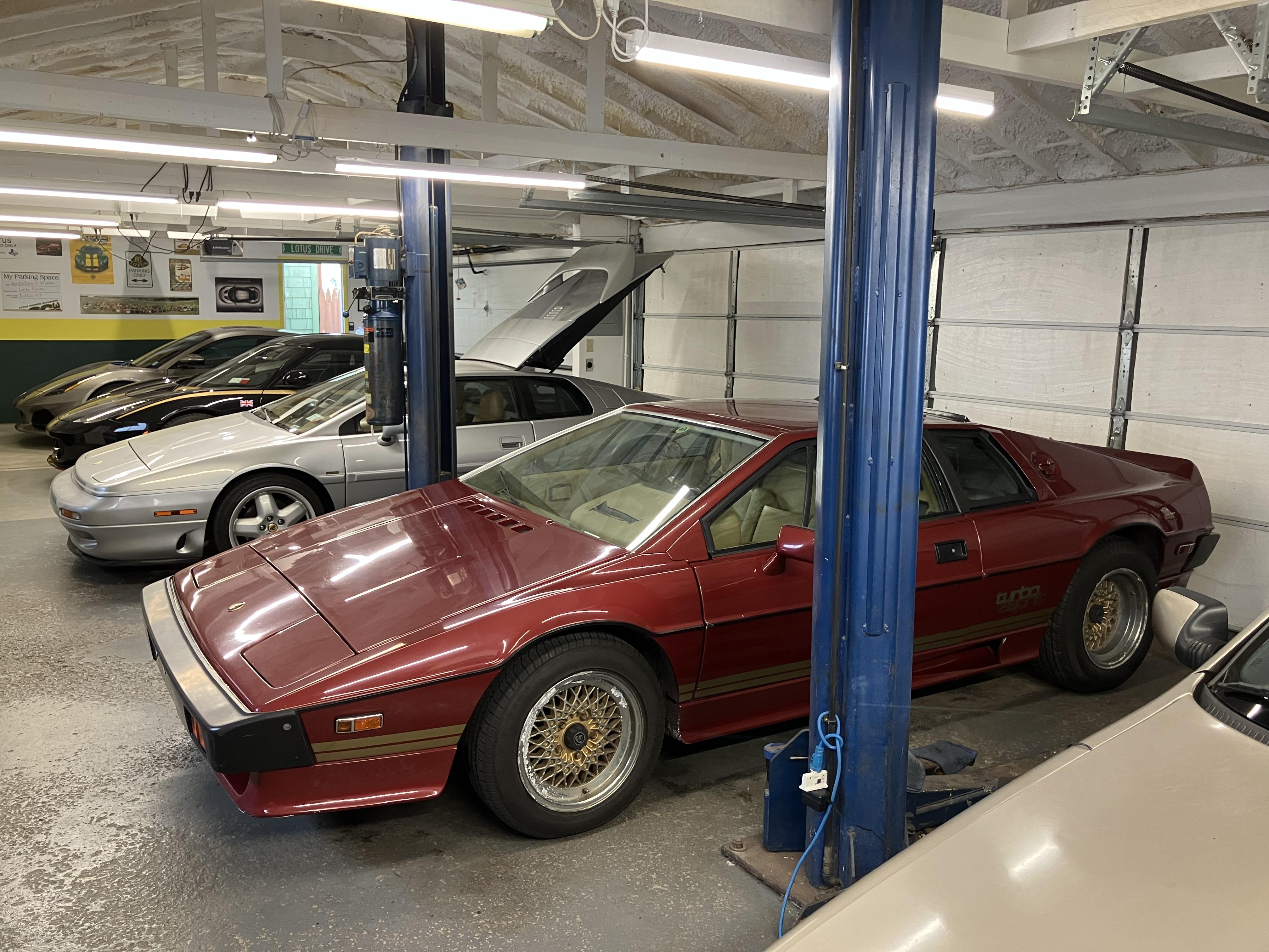

Gentlemen, been a while since my last check in... There has been almost no Peugeot content to share since my last update, just seems to be one of those years. Also, some other cars joined the fleet, namely my new to me 1987 Lotus Turbo Esprit. This was not a planned acquisition, but it will be a great fall/winter project. More details to come, but here are some shots of it as it sits now. And yes, we will be making a Bond car replica (on a budget of course)... For reference, to the younger crowd: https://supercarnostalgia.com/blog/lotus-esprit-turbo-for-your-eyes-only -

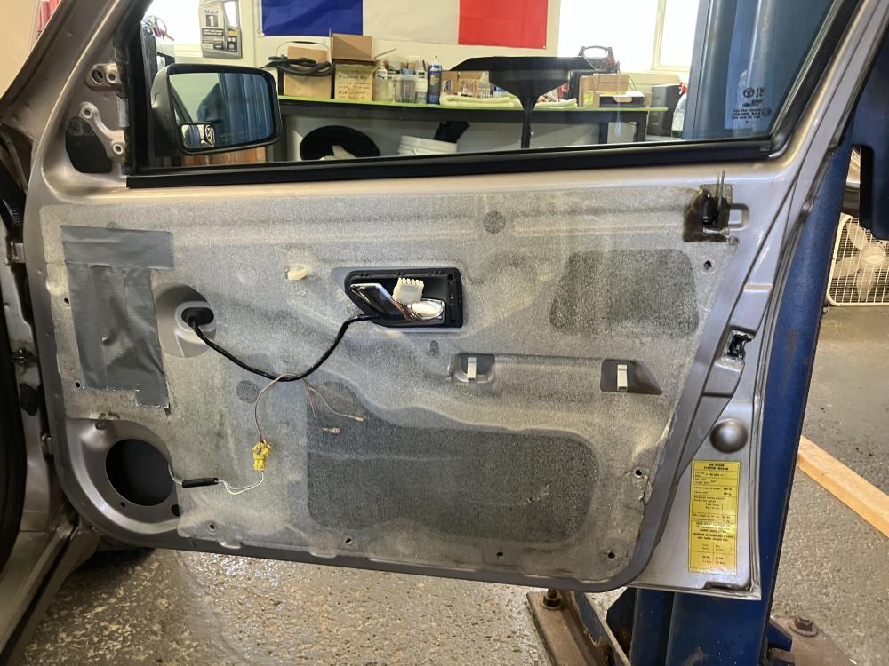

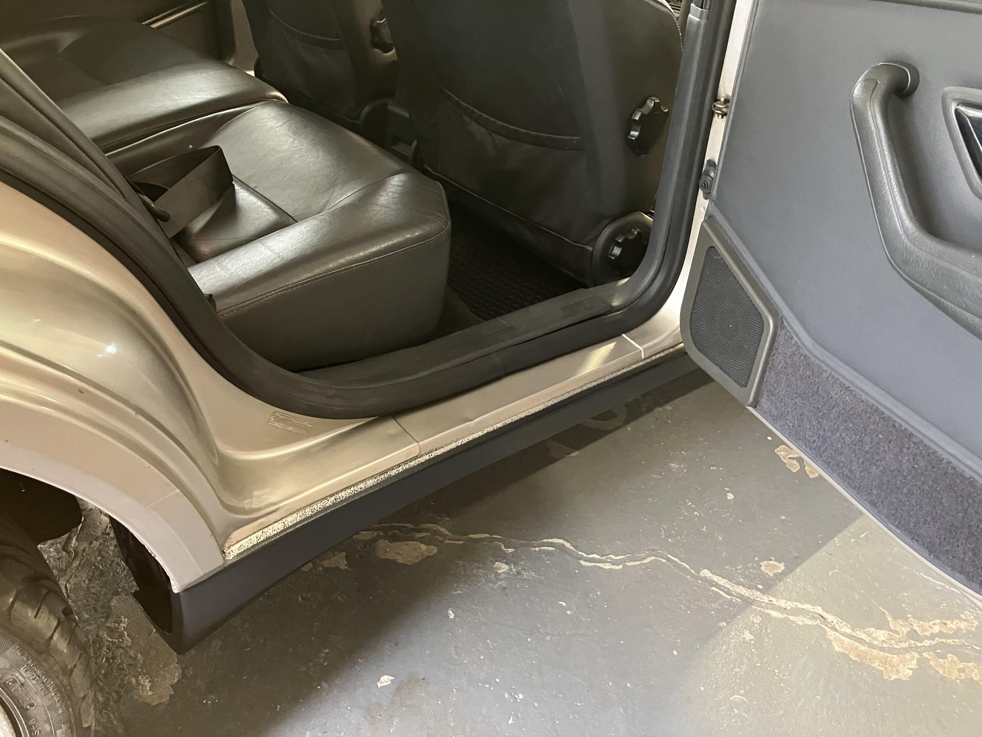

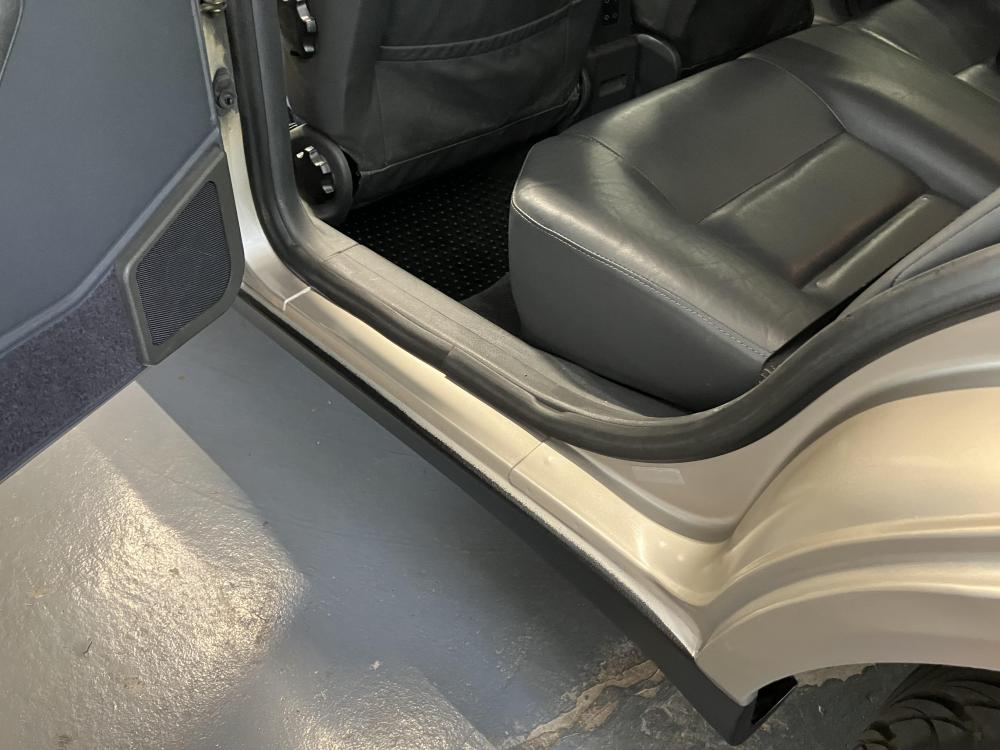

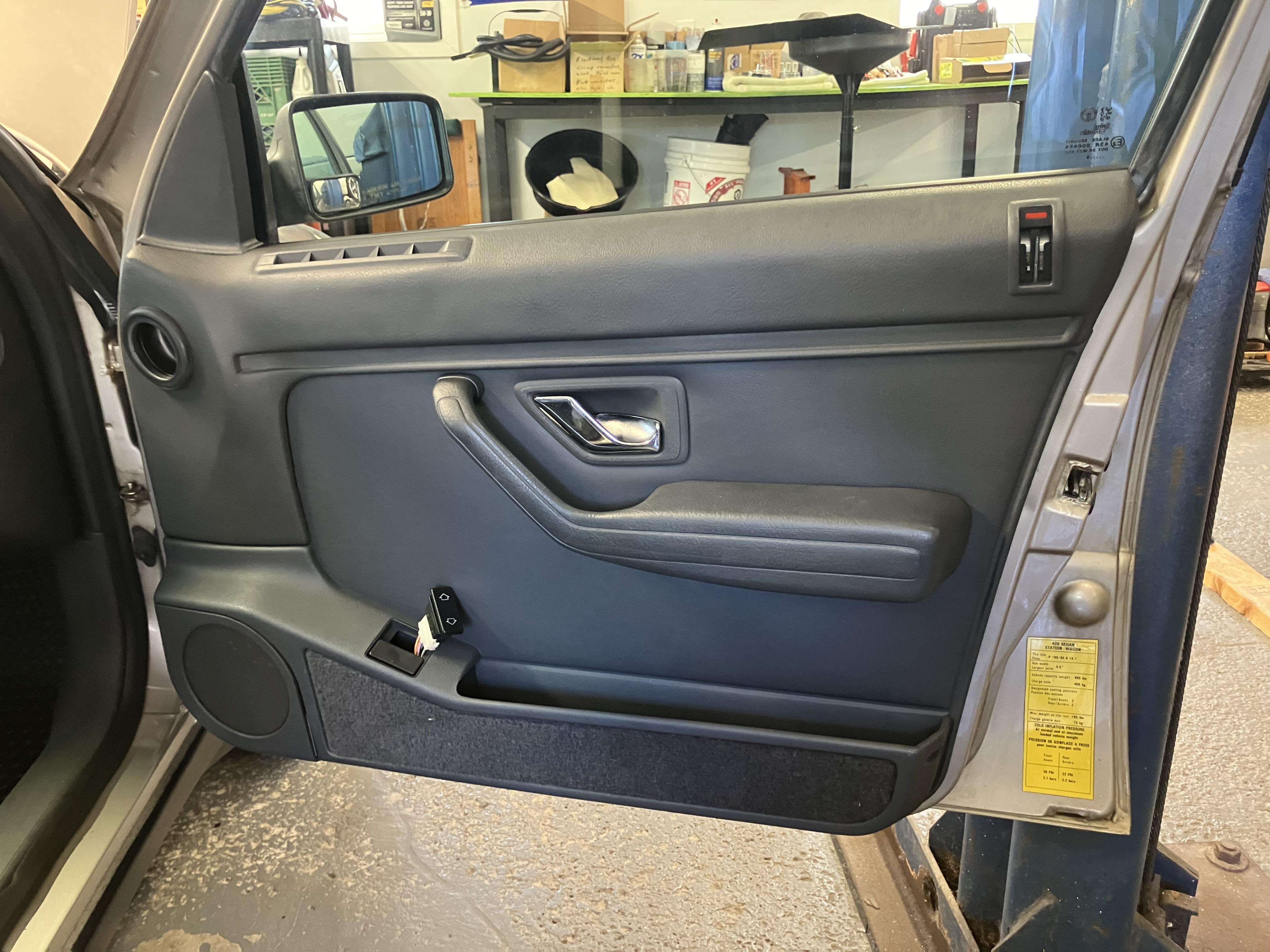

Door cards installed. They did a really nice job blending the paint in the jambs as well. They also re-sprayed the bottom chip guard. Very pleased... -
Joe's '91 405 Mi16 (and '90 SW and '92 Mi16)...
91MR2 replied to 91MR2's topic in Member build threads
Started cleaning the car both inside and out, to prepare for the reinstallation of the door cards, speakers, trimwork, etc. Coming together nicely so far... -

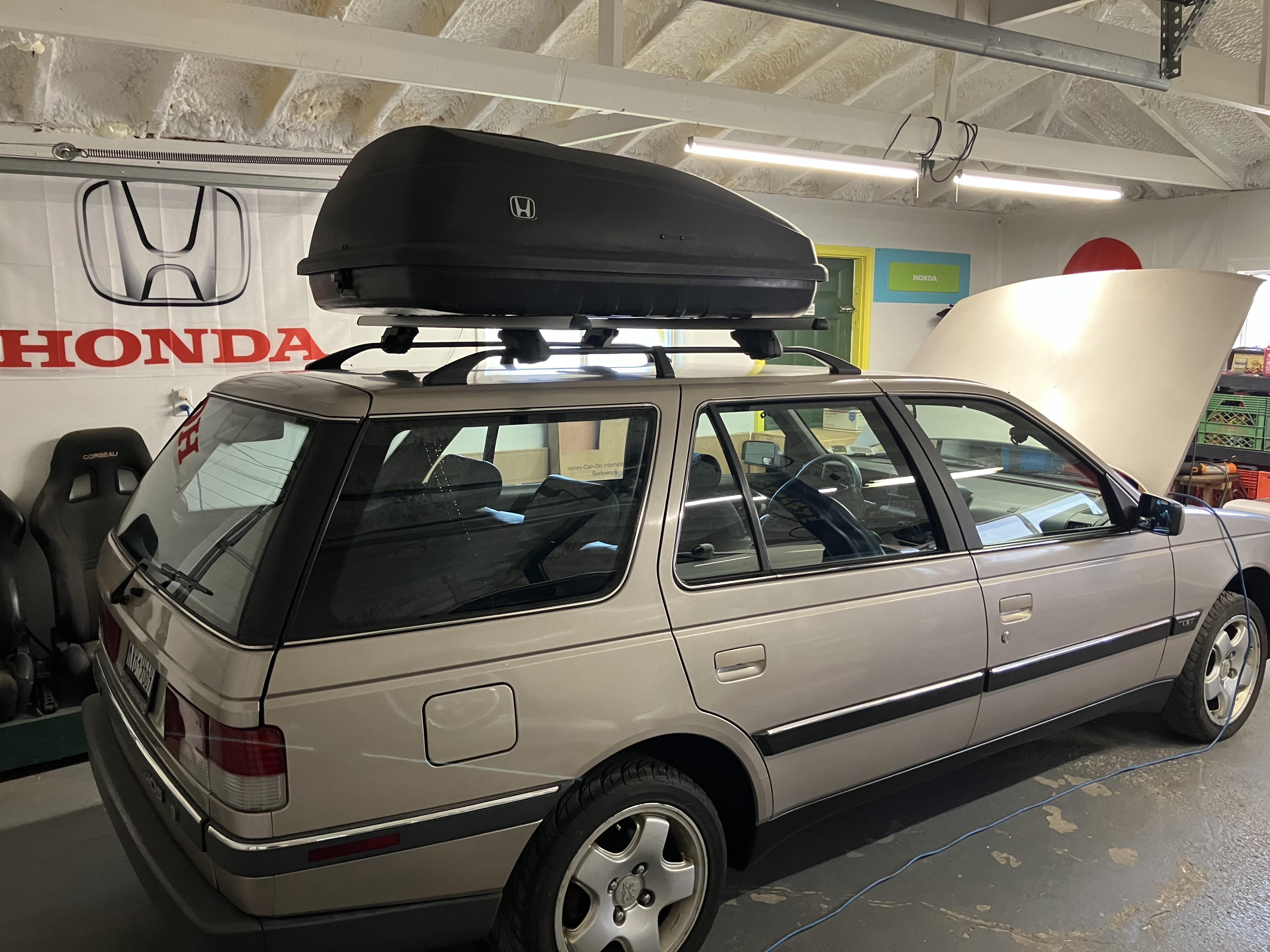

Ok, got the SW back from paint, very pleased with it, they did great work. Going to get everything cleaned up again and then re-assemble this week. After that, pulling the wheels off for a deep clean of them and the wheel wells, and then this one is pretty much done (or as done as any 34 year old car can be...). -

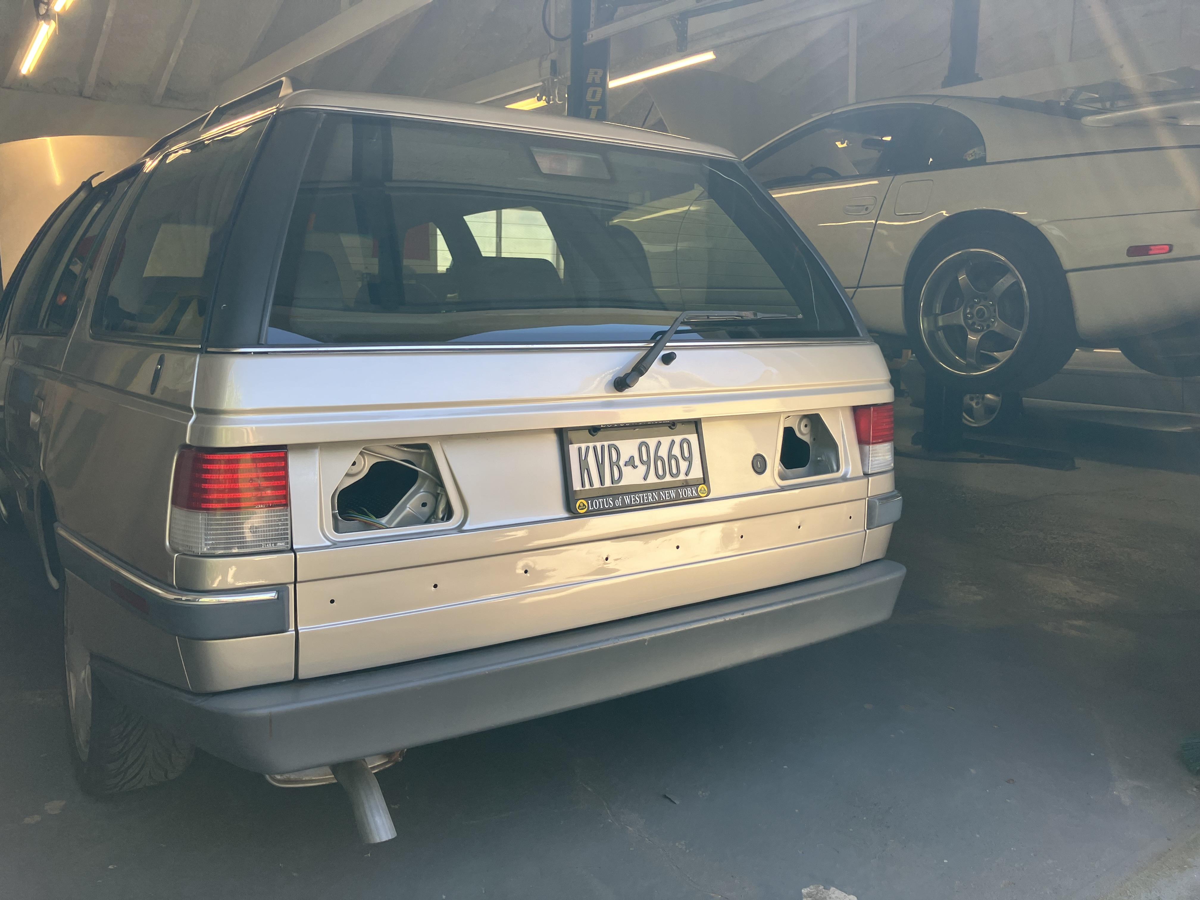

Progress at the body shop is well underway, these guys do great work, hard to tell there was ever any rust... -

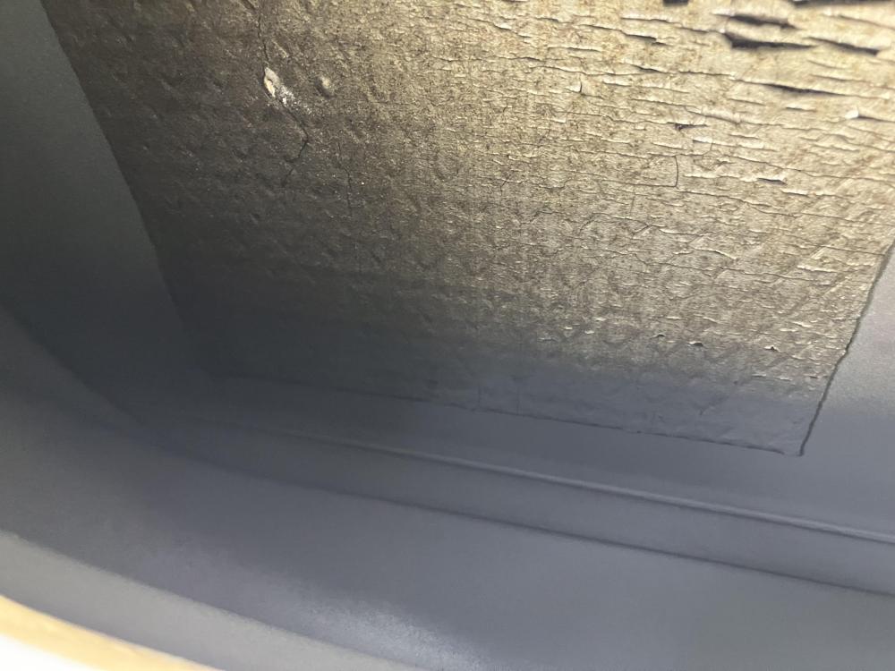

That's pretty much what I did by using the chassis saver on the insides of the doors, and then the rustoleum on top. As far as drilling holes to squirt in oil or something like that, I don't think it will be necessary, given how clean the car is otherwise, not to mention the use it will see going forward. -

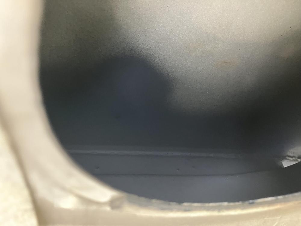

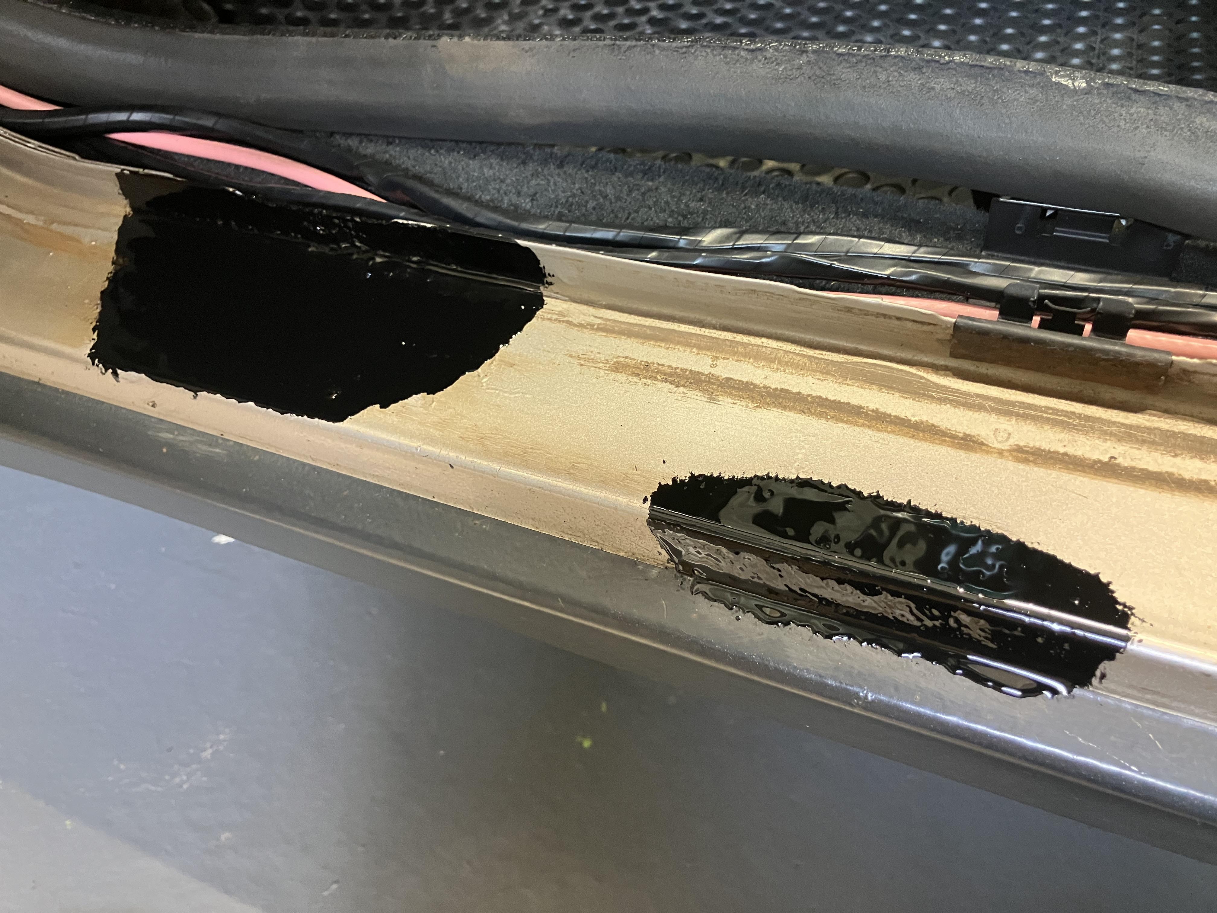

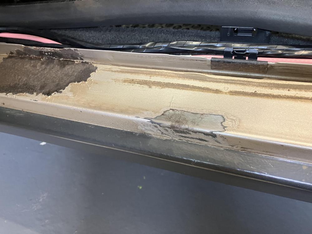

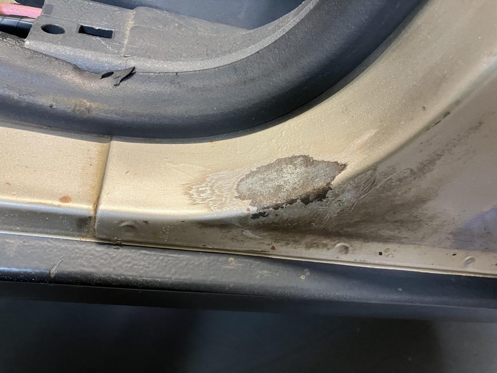

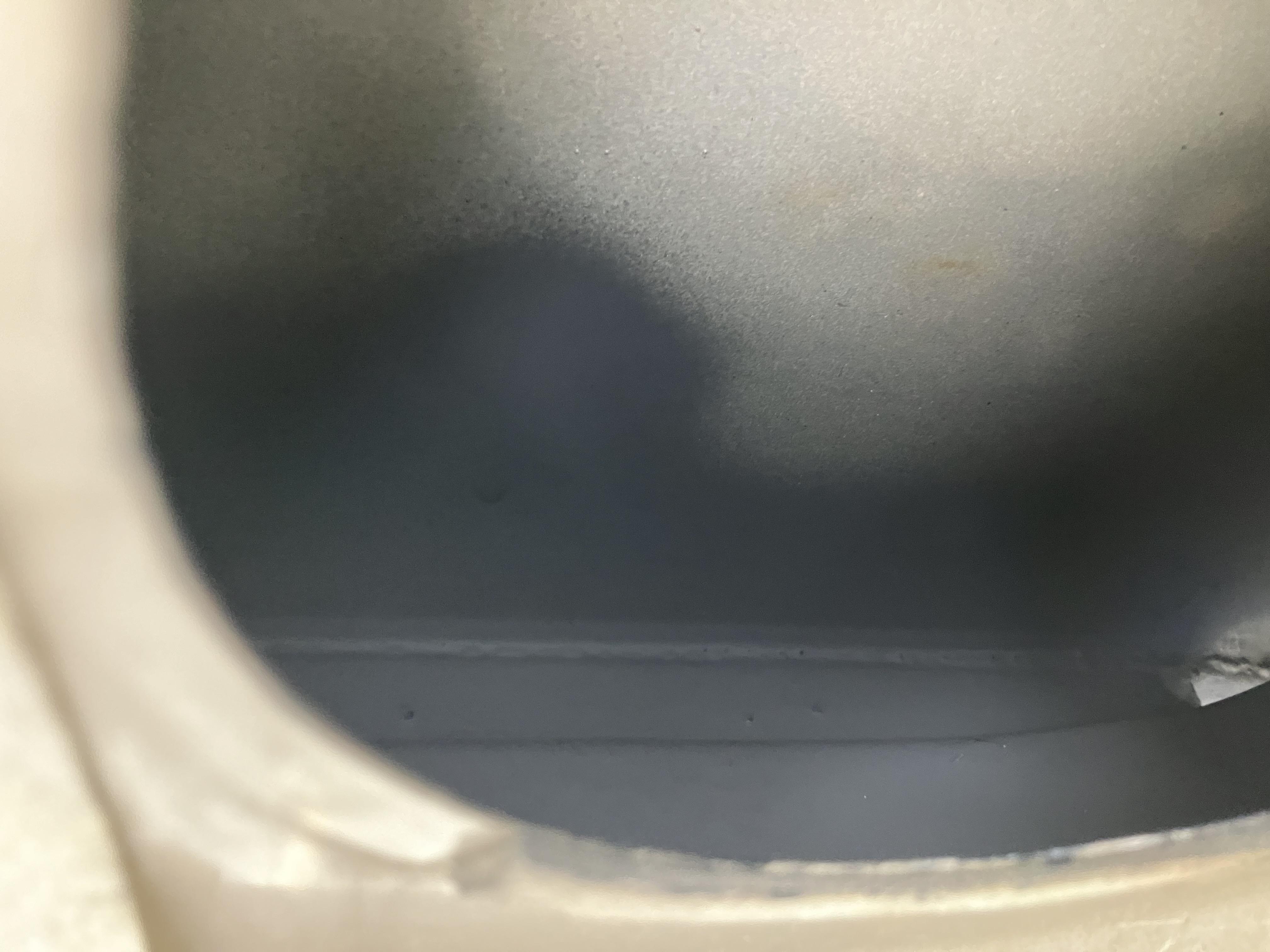

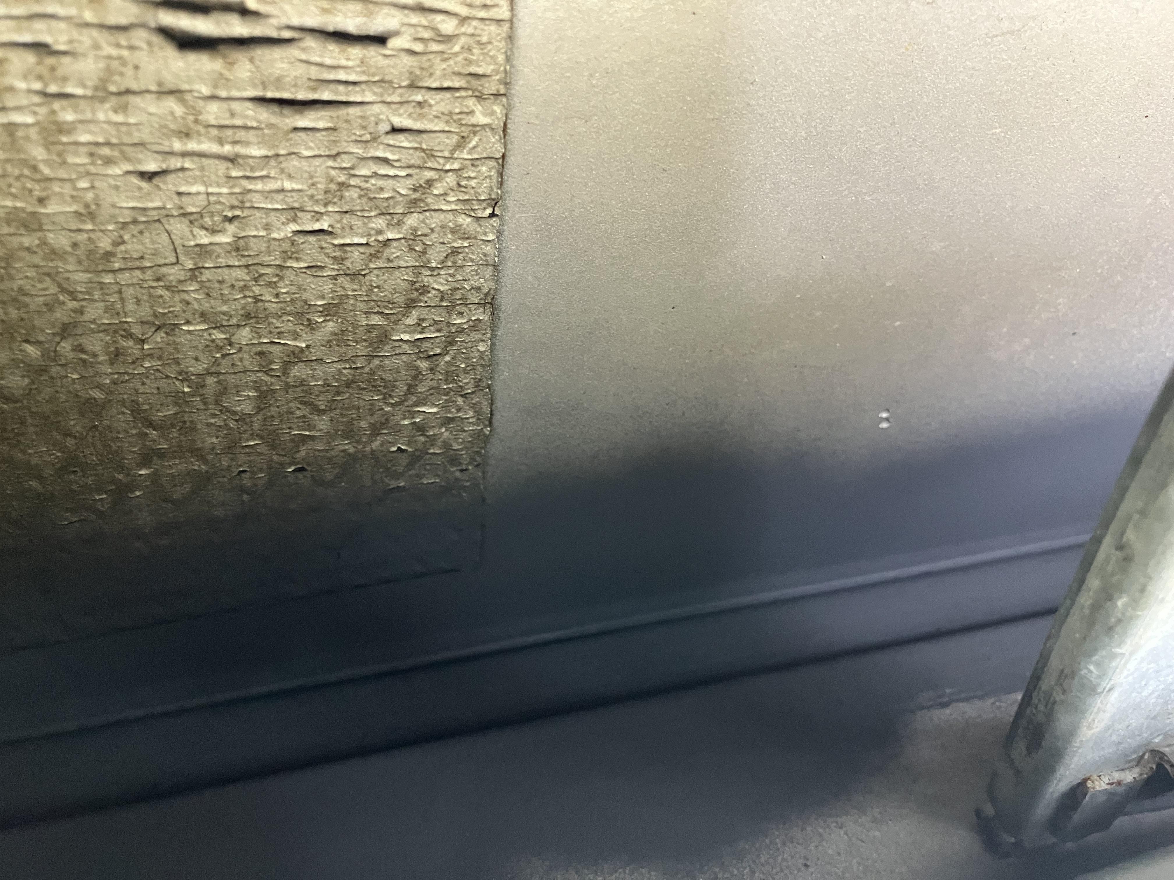

Applied the chassis saver over the last couple days to all areas needing treated, specifically the bottoms and insides of the drivers side doors and the driver's front door sill area. For whatever reason, there were some areas of bubbled paint, but after scraping/grinding it all away, the metal was still solid (no holes). After applying the chassis saver, I then went another step and sprayed a rustoleum inhibitor over the top. I think this should keep the rust away for the rest of my life at least, given the use these cars all see now (nice weather only, and about 500 miles a year)... -

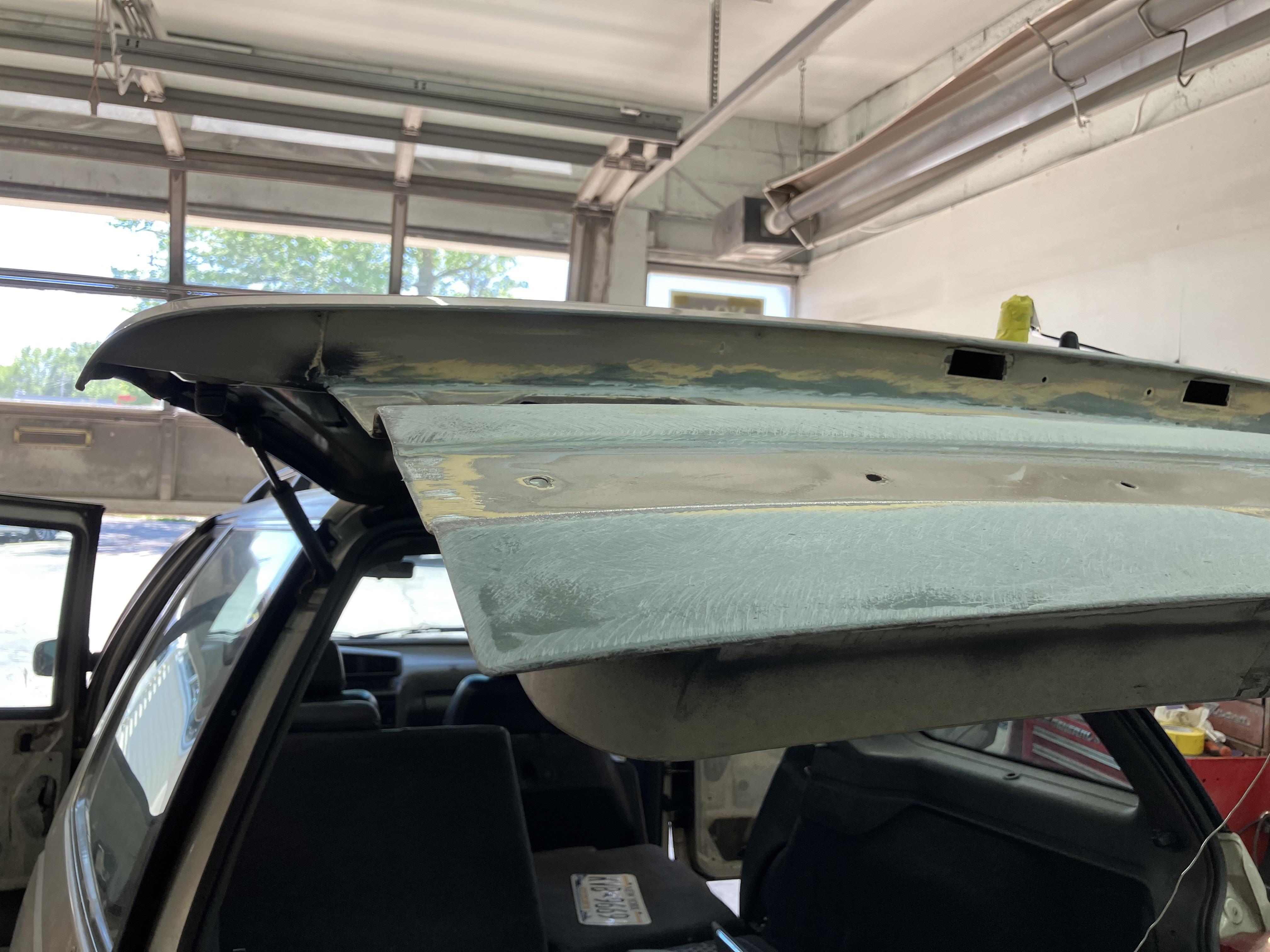

Finished the grinding/scraping/preparations today on the Sportwagon. Next week I will treat the metal with Chassis Saver (similar to por-15), and into the paint shop it goes. This was the day I was least looking forward to, so glad it is over... -

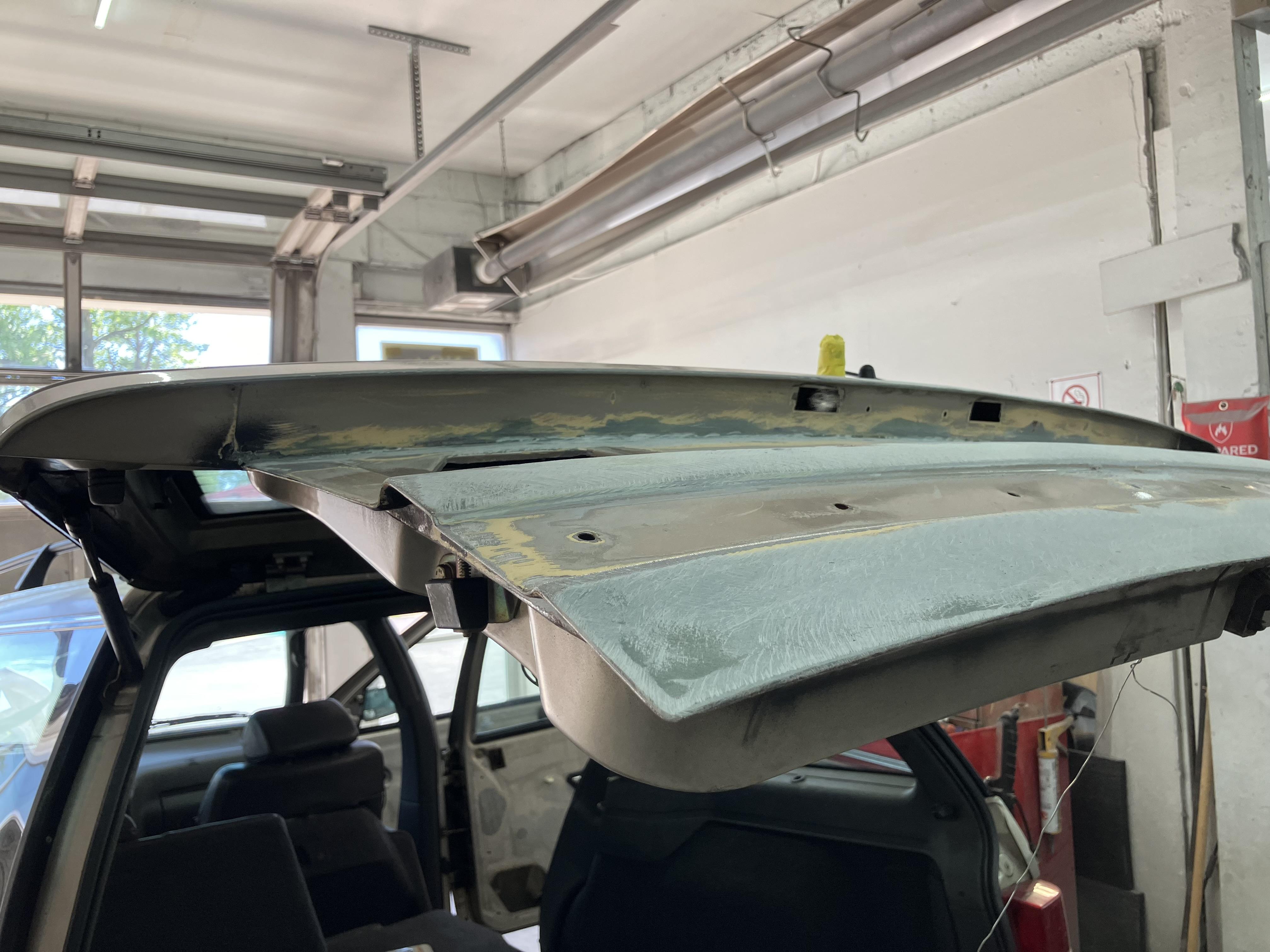

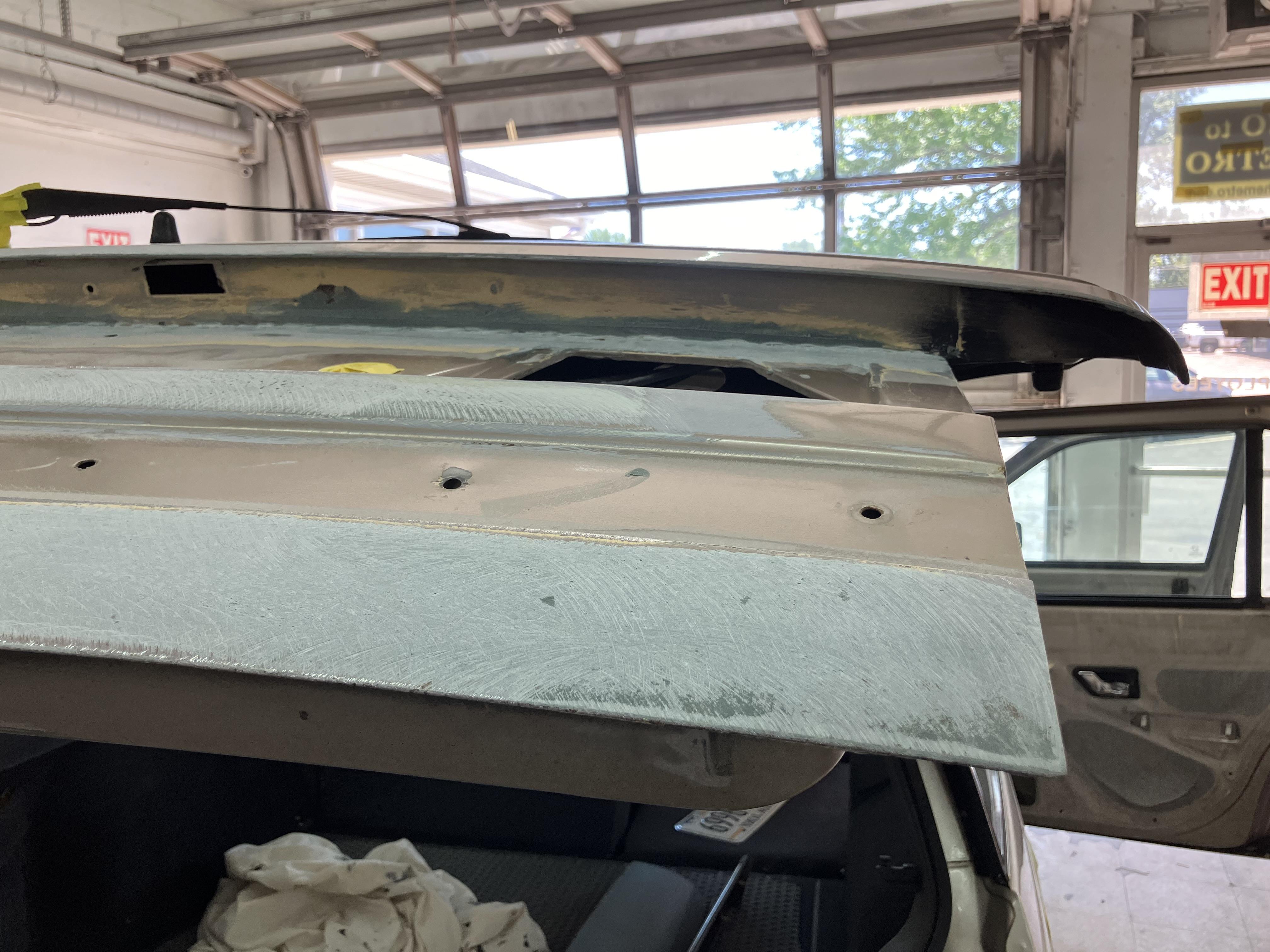

Hey guys, been a bit... Re. the red car, got the injectors out and cleaned them, re-installed them, fired right up and nothing leaking now, so that's a good start. Still need to install the new driver's side front brake hose and want to service the rear calipers, but that's for another day... Re. the SW, finally getting ready to have a little paintwork done. Started today by scraping some rusty scale of the bottom of the hatch, as well as the driver's side doors. Fortunately the car is very solid, so this is a very basic cleanup and respray of the damaged areas, unlike the red car which needed some more invasive surgery... Stay tuned...
