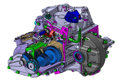

Coming soon (this year in Europe if not delayed) :
This is the future 6 speed BE4 called MB6. Based on what we know about the current BE4 the BE3 bellhousing should bolt but a little bit of welding or maybe some creative thinking might be needed.
No torque ratings, gears or final drive ratios yet so wait and see.

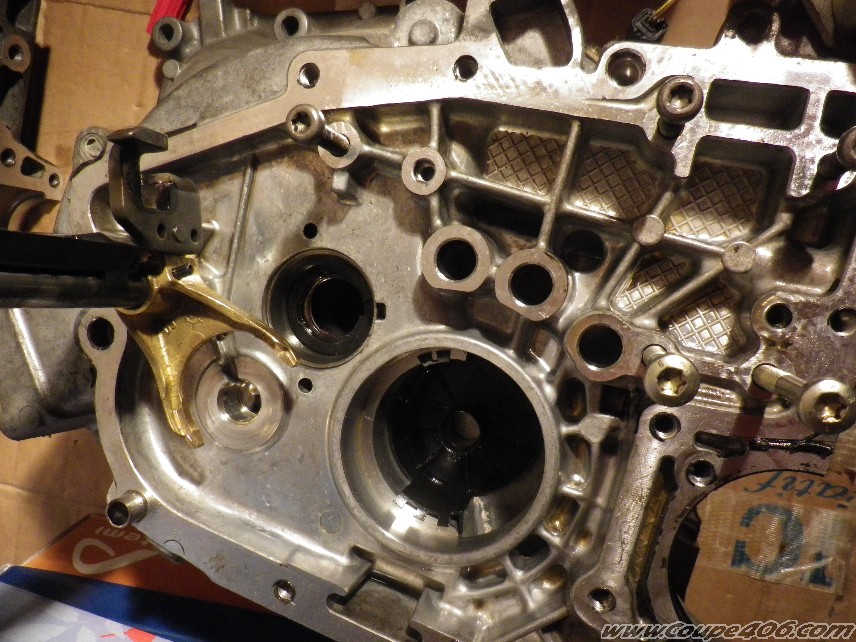

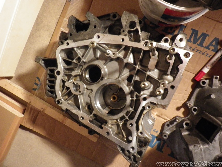

Just like for a 405 you will need cable selection and an hydraulic clutch. For the bellhousing... well there is your problem.
ML5T that exist for 30° XU:
ML5C/ML6C:
Nothing you can't overcome (as seen on your 405 project) but it's more complicated than picking the right parts and bolt them together like the 406 guys are doing.

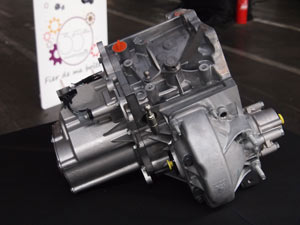

New 6-speed manual gearbox
Compactness: same volume as the equivalent BVM5 with torque of 250 Nm
Production sites - Machining and Assembly: Valenciennes then in China from the end of 2018
Annual production potential: 500,000 in France
Series production launch: September 2017
Commercial launch in mid-2018 for the new Peugeot 308
Max. Torque (Nm) 250
GB Mass (with fluid and without coupling) 38 kg
Triple cone synchronisers in ½, simple cone in 3/4/5/6
Reverse blocked
Opening 5.7 to 6.7
8 different bridges
Length 380 mm
MTAC / MTRA:
PC: 2,220 kg / 3,300 kg
Light-Duty Vehicles: 2,320 kg / 3,200 kg
At last some specs!
So same torque rating, same mass and same compactness than the BE4 ; so far so good.
Whe don't have ratios yet but with openings from 5.7 to 6.7 you may have some serious drop depending of the gearbox.
The old 1.6 HDI 120hp had a 6.7 opening with the MCM 6-speed, if you take the 6th out you got a 5 speed with 5.7 opening.
