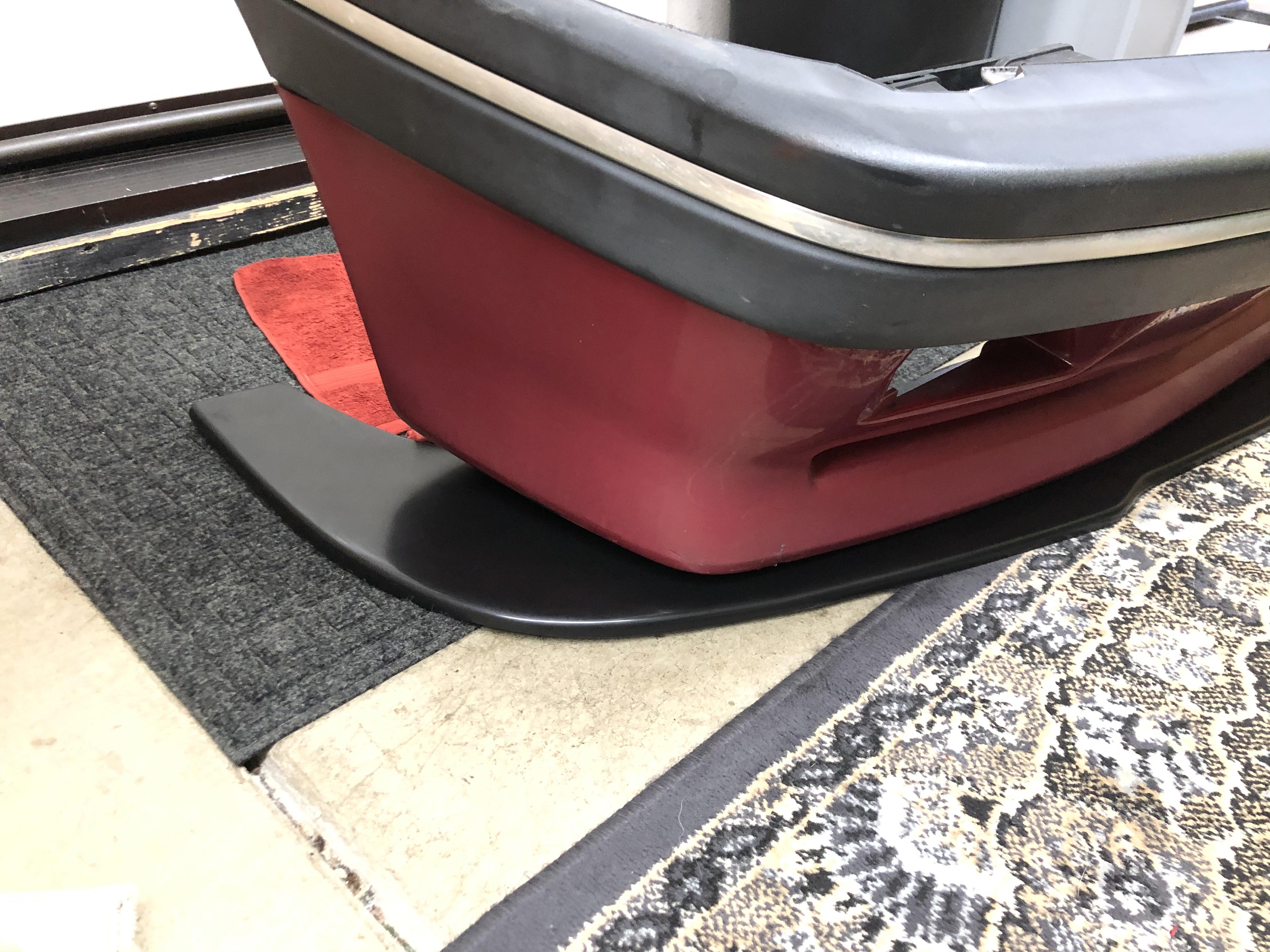

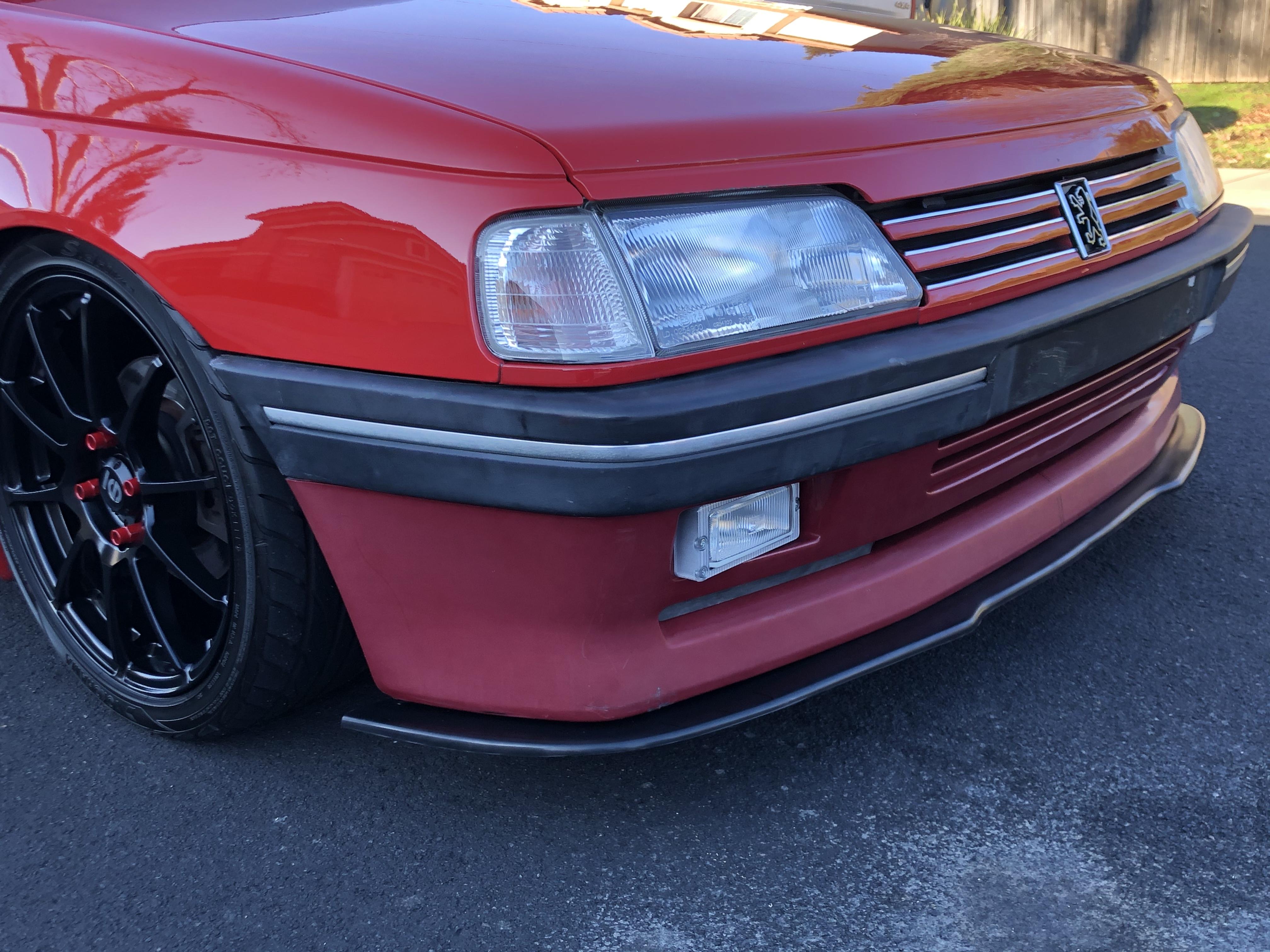

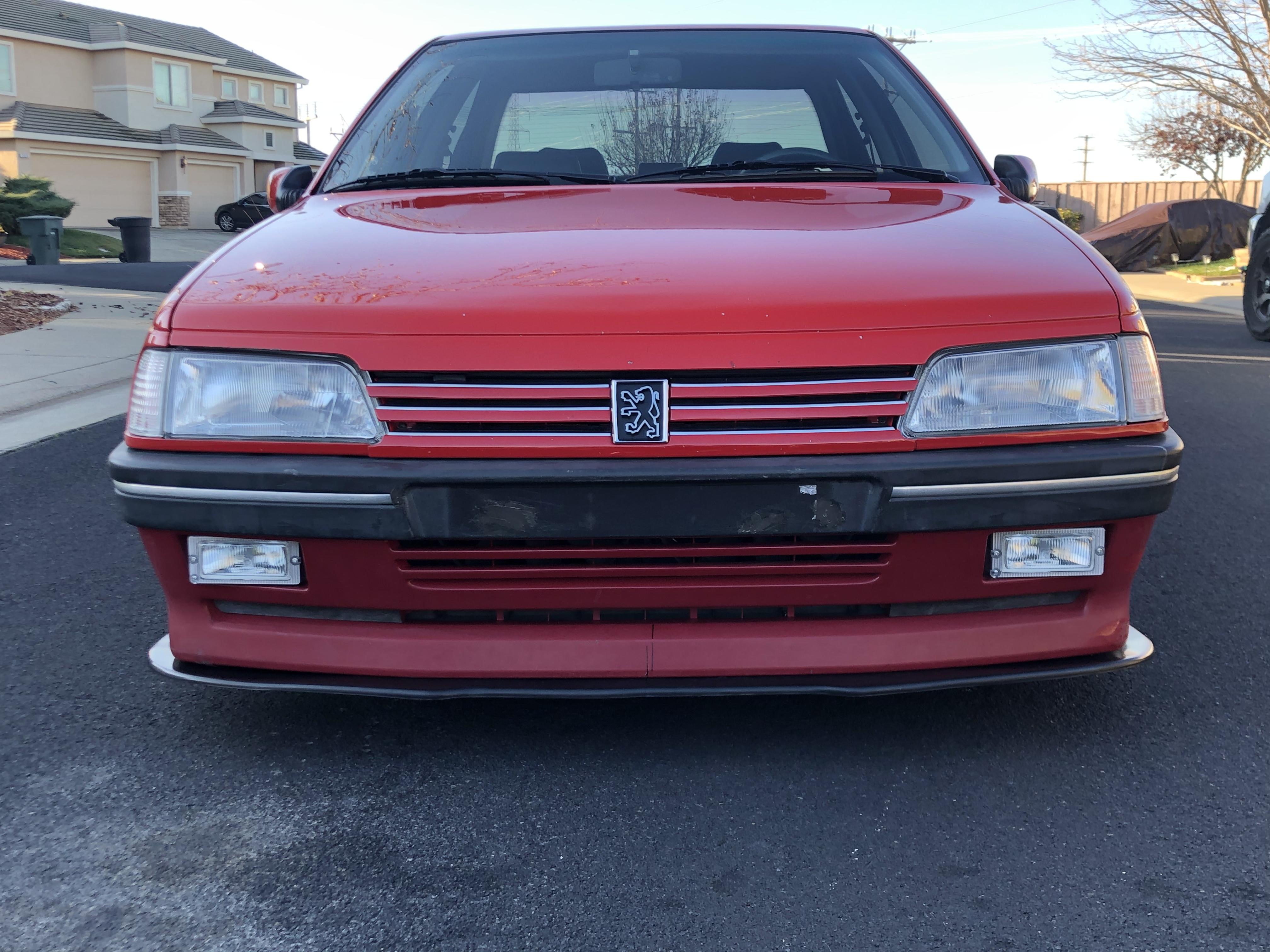

my3AWDgst Posted December 11, 2019 Author Report Posted December 11, 2019 I also ordered this universal lip, definitely minor trimming required Quote

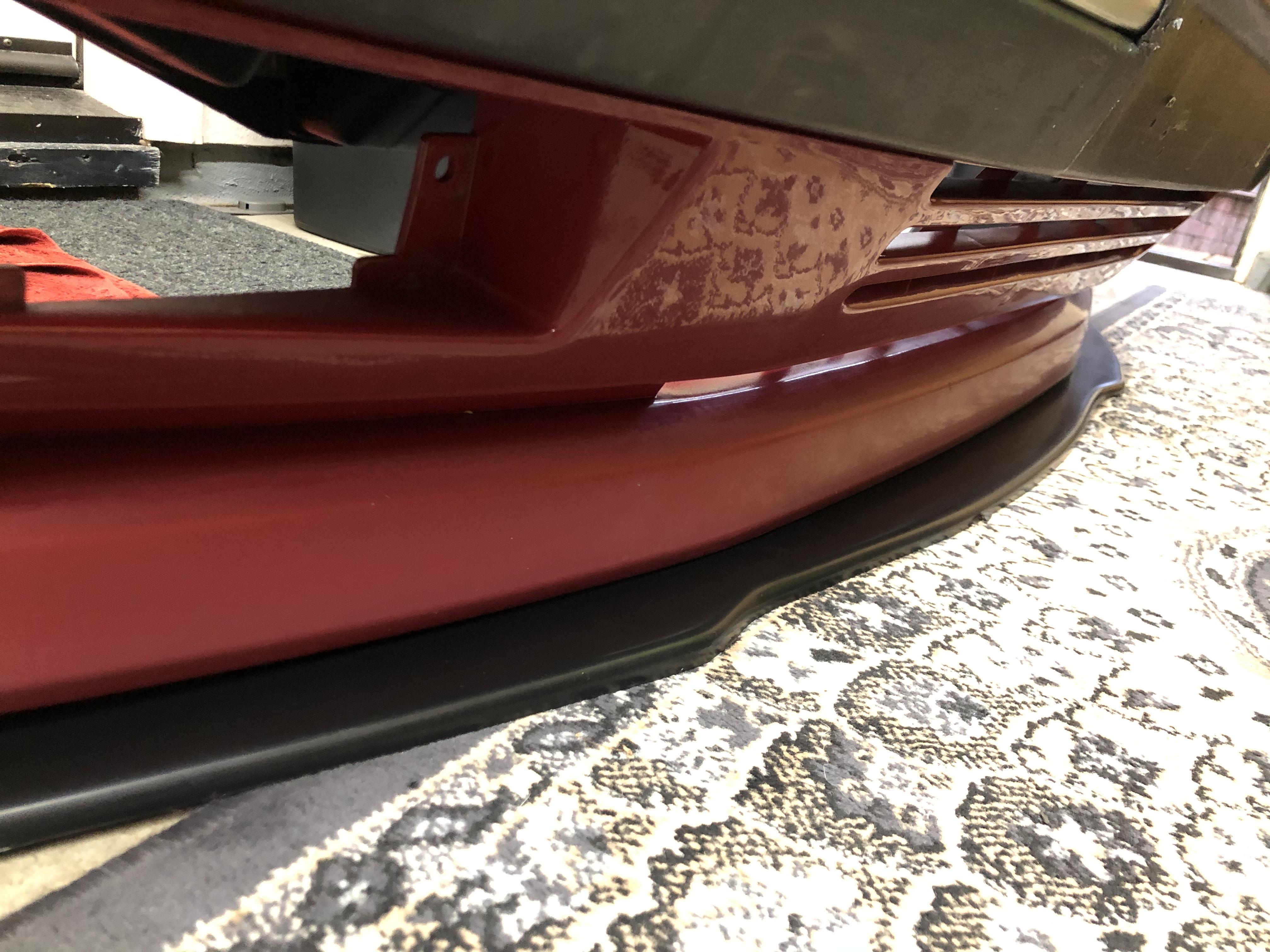

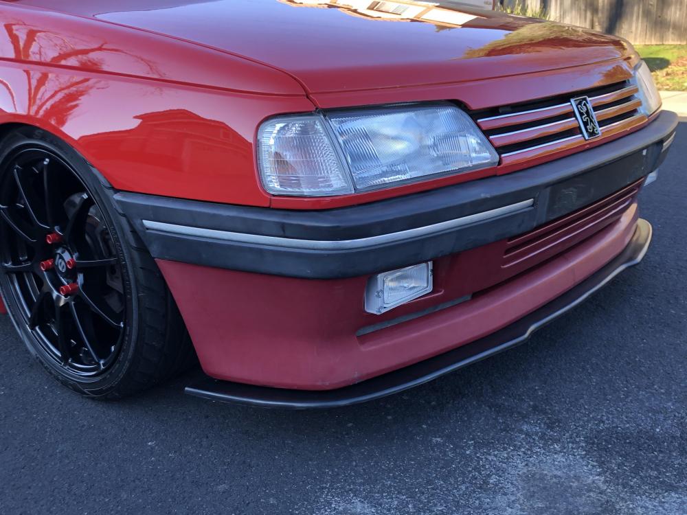

Goce Posted December 12, 2019 Report Posted December 12, 2019 As i said on FB, congratulation i really like to see proper euro style looking Mi16 in the US. Years ago on vacation in greece an american who owned an 405 thought my Mi16x4 had a body kit and truly did not believe they come stok like that in europe. I hope you get them installed quickly, painted and showcase the 405 Mi16 as it truly should look. As for the chin spoiler, test fit the bumper first, it comes much closer to the radiator support the regular bumpers come. You may be able to install spacers and just bolt it on the rad support. The tow hook goes thru those holes at the bottom and hangs under the bumper. Quote

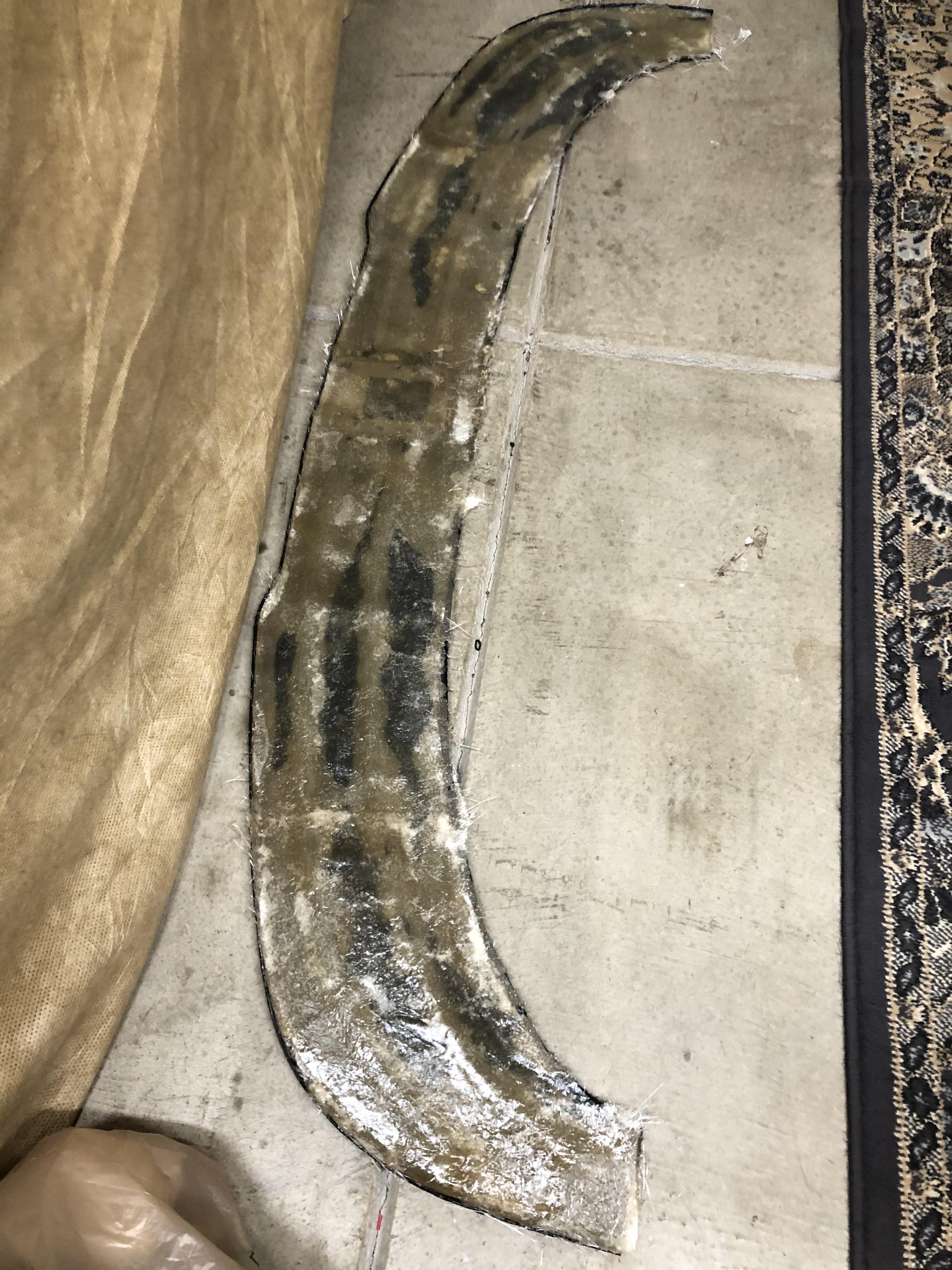

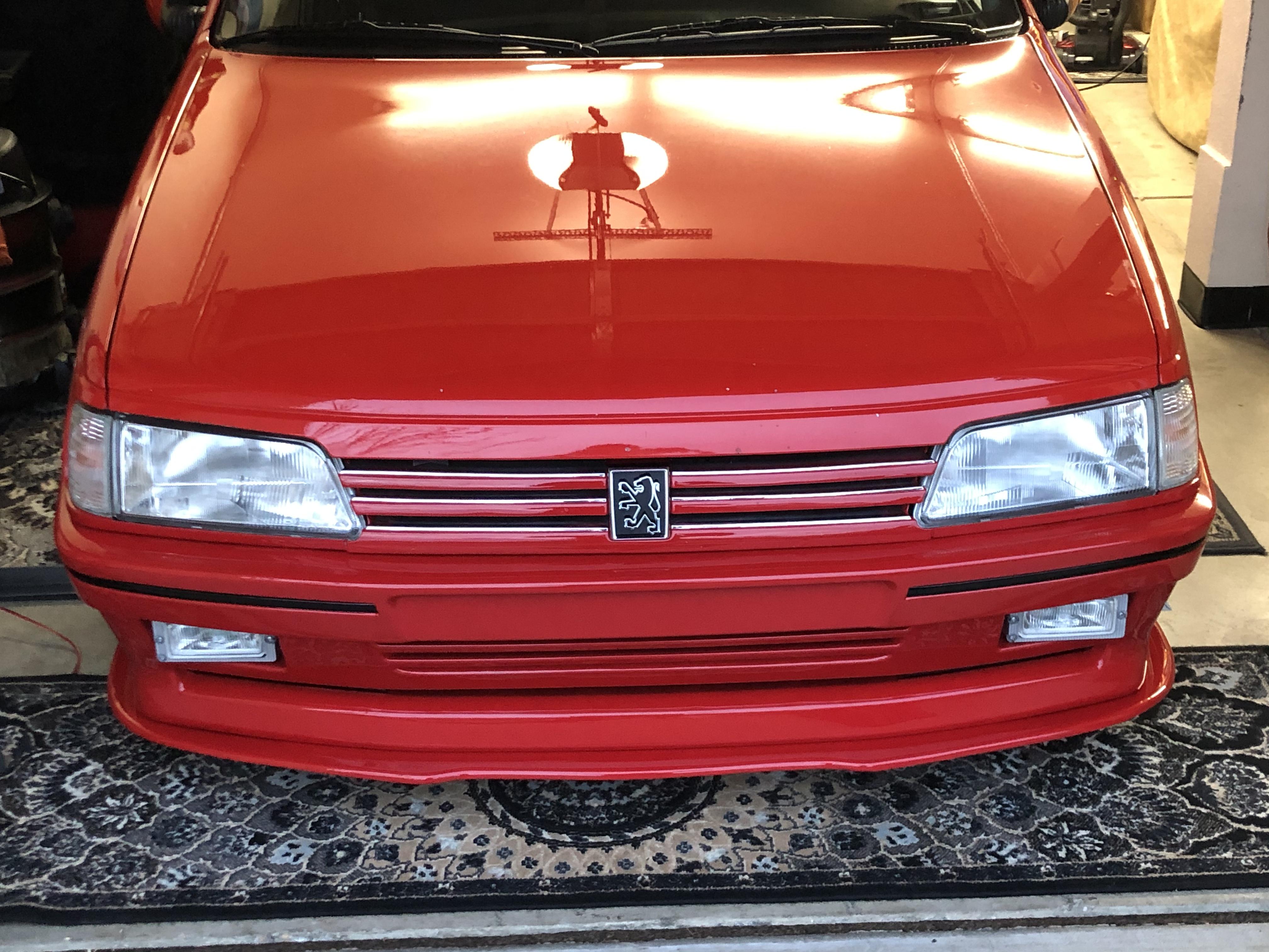

my3AWDgst Posted December 14, 2019 Author Report Posted December 14, 2019 Test fitting aftermarket front bumper lip, first impressions are flimsy AF and definitely needs trimming. Mostly like I’ll take about four inches out the middle and bond it back together, to reinforce it I’ll probably add fiberglass on bottom of lip which should make it not to be flimsy. I definitely love the way it looks. Quote

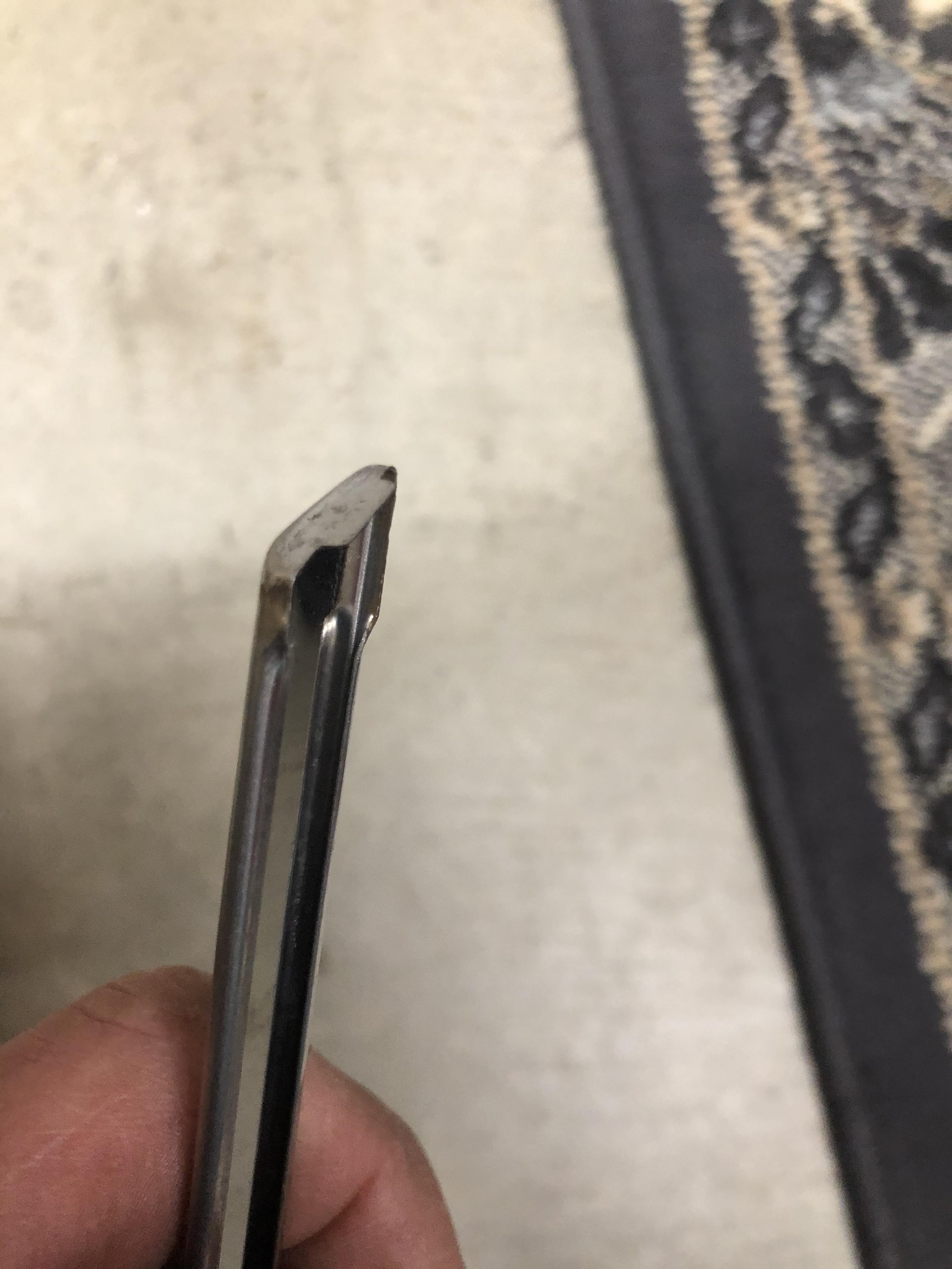

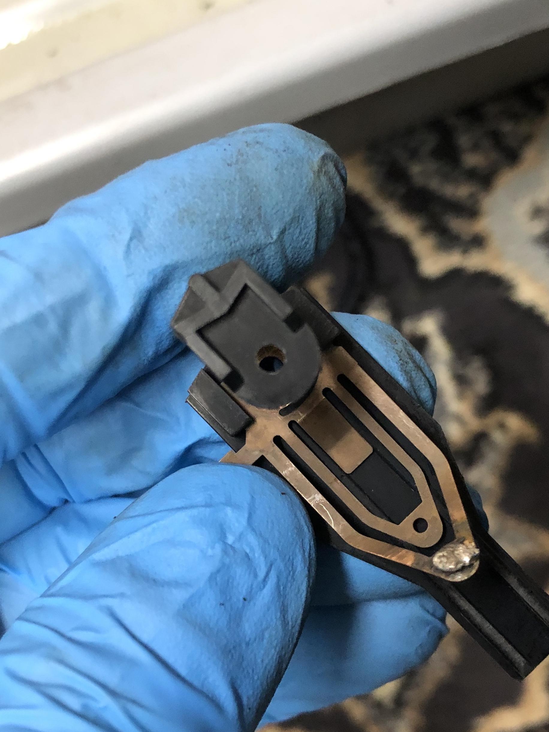

my3AWDgst Posted December 14, 2019 Author Report Posted December 14, 2019 I end up repairing my fuel gauge sending unit as well, that little arm in the picture below that moves up and down lost one of the contact tabs and did not make any contacts with little resistance circuit board. I end up using it from another broken sending unit that had good working arm and contacts. Quote
Bean Posted January 7, 2020 Report Posted January 7, 2020 Curious how the lip is being attached? And is it decent quality? I'd consider something similar for my 505 turbo for an added layer of scrape protection - plus it looks cool. Rabin Quote
my3AWDgst Posted January 8, 2020 Author Report Posted January 8, 2020 You can attach it with screws, in my case I choose M6 button head bolts and flange nuts. Quality is good but it extremely flimsy, I fiberglassed under side to make it sturdy. Definitely needs to be cleaned up before I take it to paint shop. Quote

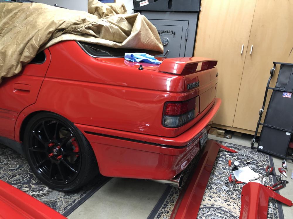

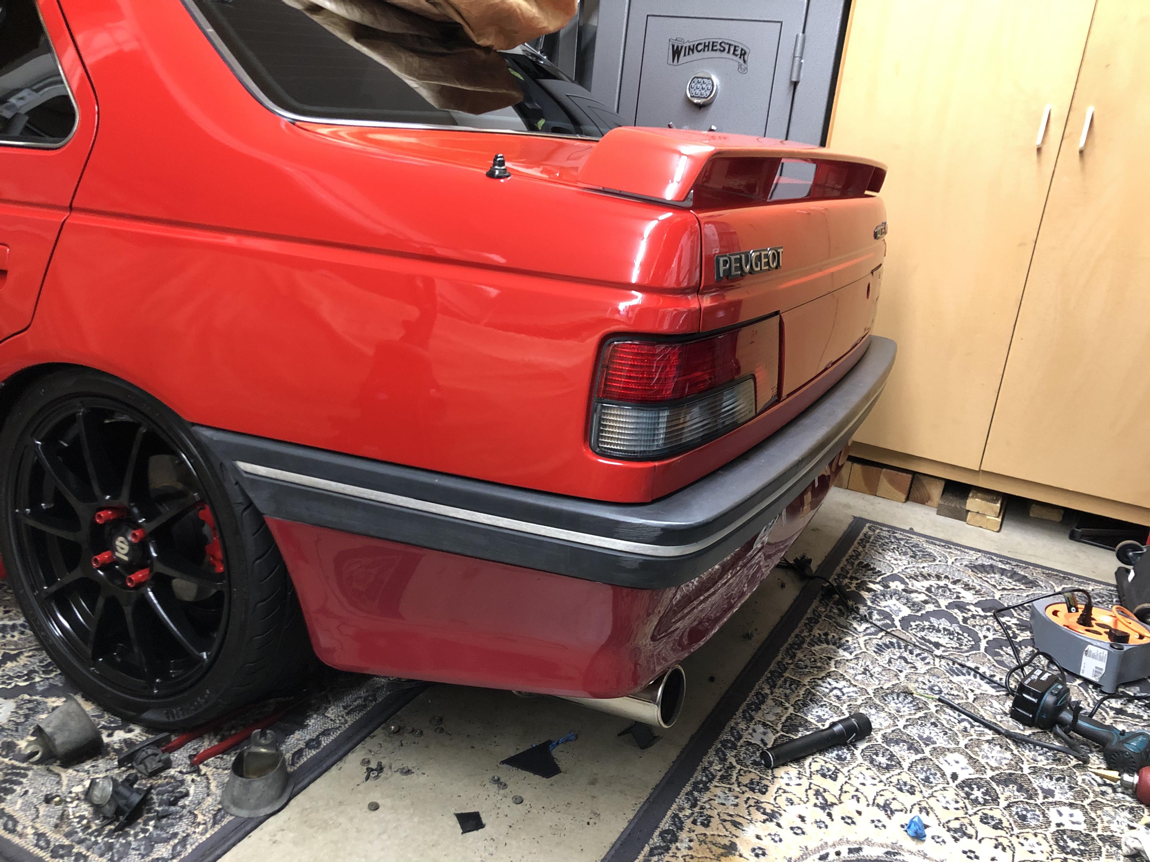

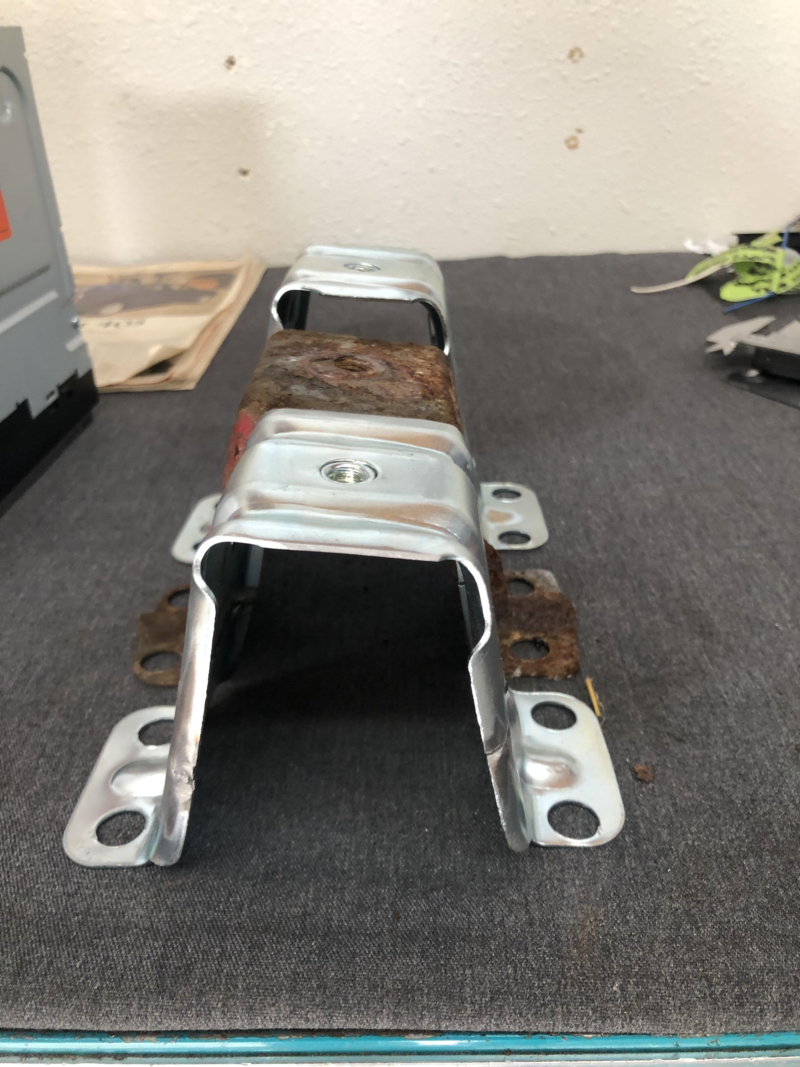

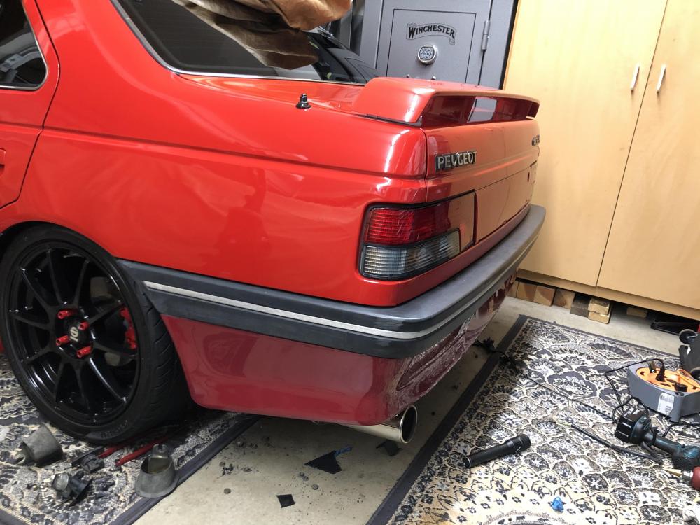

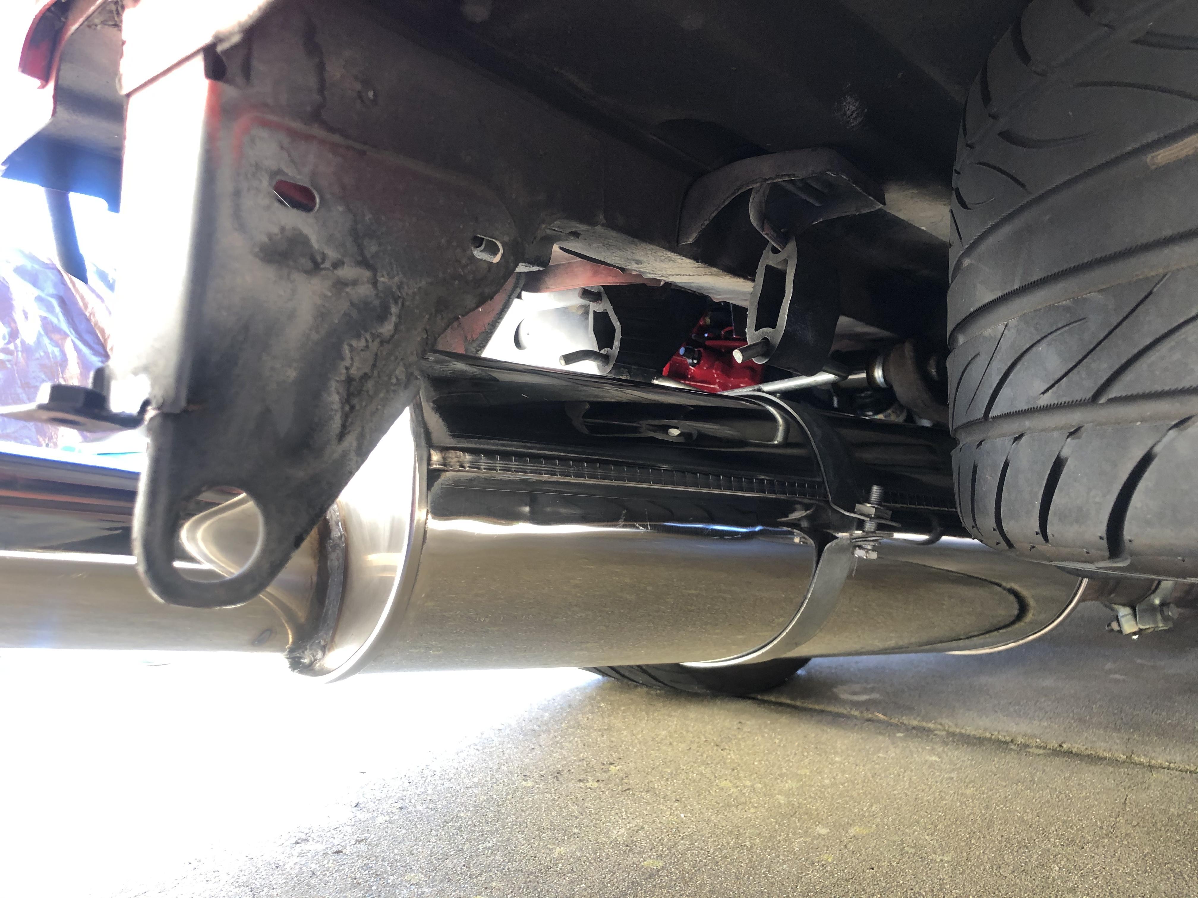

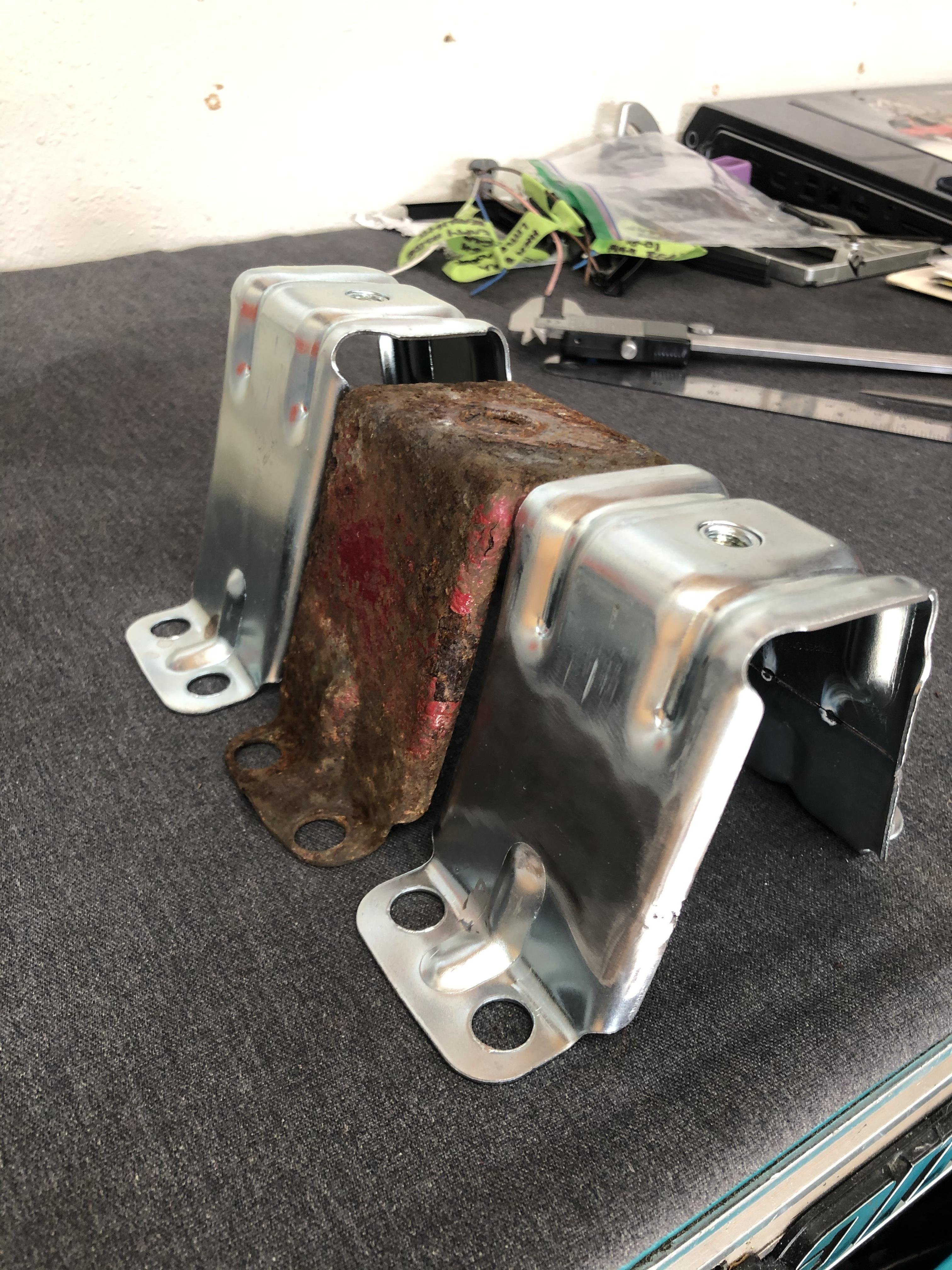

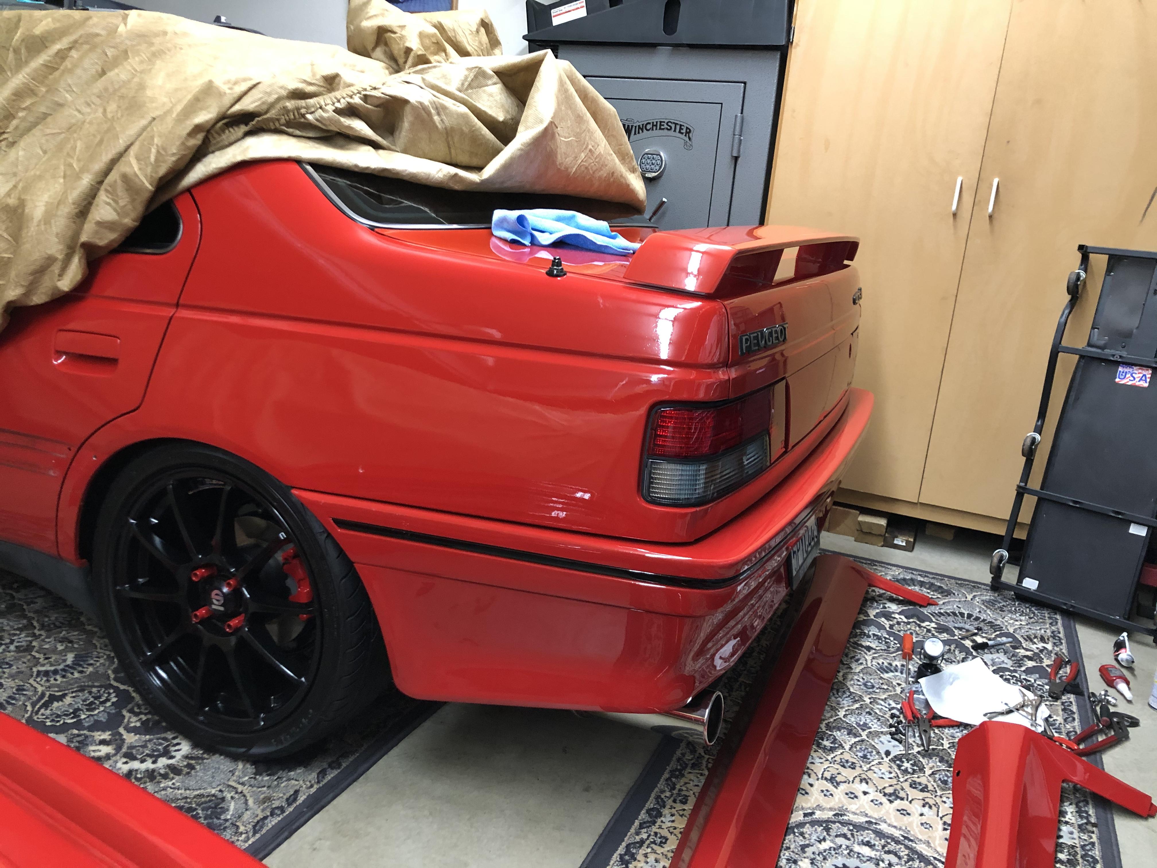

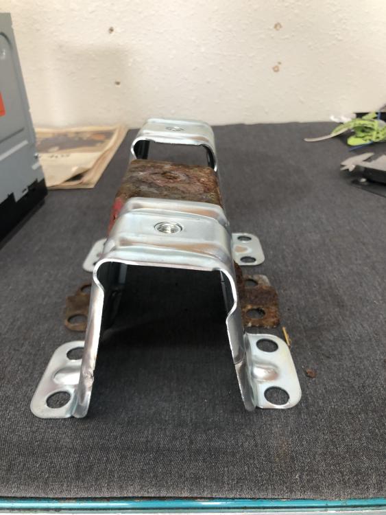

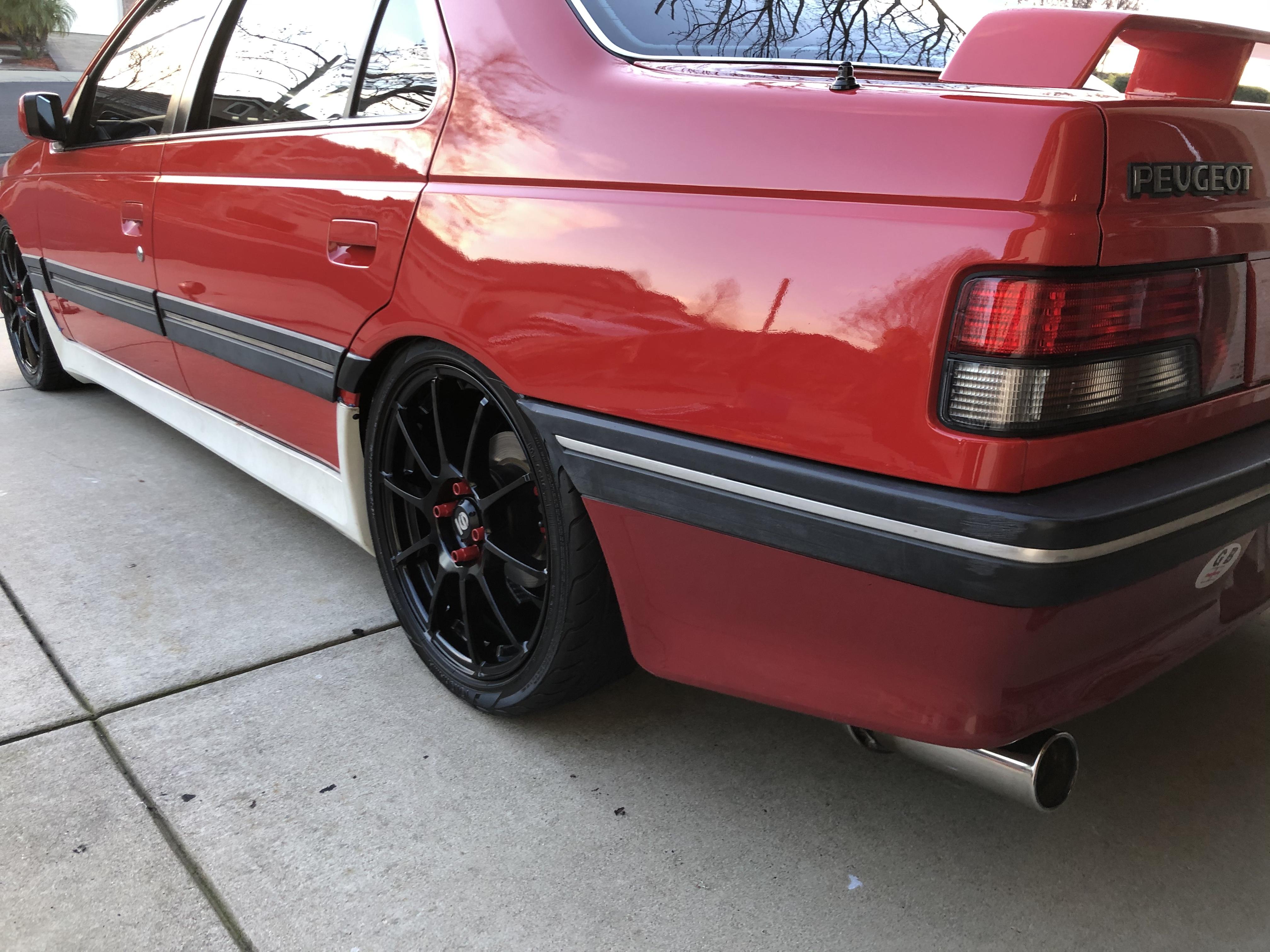

my3AWDgst Posted January 8, 2020 Author Report Posted January 8, 2020 For about five years now I’ve been waiting for this exhaust to look as it should, according to Dave at Euro Sports where I purchased it (it was new he’s old display unit) it was built in UK in early 90’s on Euro platform so with US bumpers it would look short. Tail pipe was tucked in under rear bumper and I did not want to extend it as I knew this day would come when I would have proper bumpers on it. I made some small adjustments on it as it’s more visible now, muffler just needed to be rotated up and to the left to look like it was in center. It really looks perfect now, tail pipe has about 10mm clearance between bumper and it sticks out about 15mm so it looks just right like it should. Now one more problem that I ran in to is that US cars have rocker panels painted dark gray with texture on to of it so when you add Euro side skirts that texture is visible and it’s gonna need to be painted in color of the car. Paul has included new front bumper side brackets and unfortunately they were about 10mm to long, so instead of having original rusted ones stripped and coated I decided to cut out 10mm out of new brackets and have them welded and powder coated. Quote

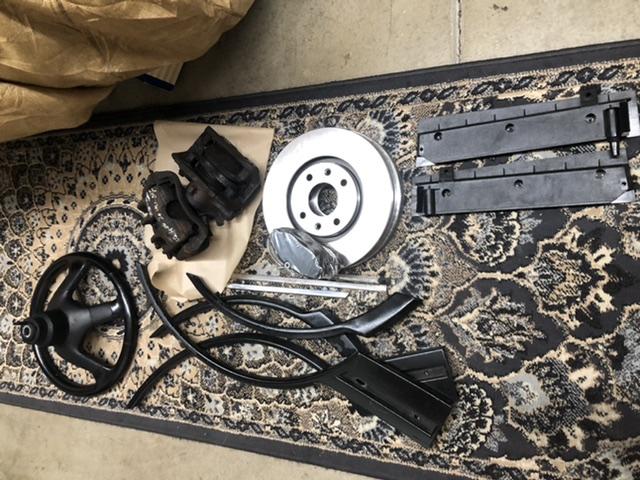

my3AWDgst Posted January 9, 2020 Author Report Posted January 9, 2020 Arch trims came in today, big thanks to Paul Gritton to make this happen. Brakes calipers came from 406 HDI so did new pads and rotors, these are for my Wagon. Quote

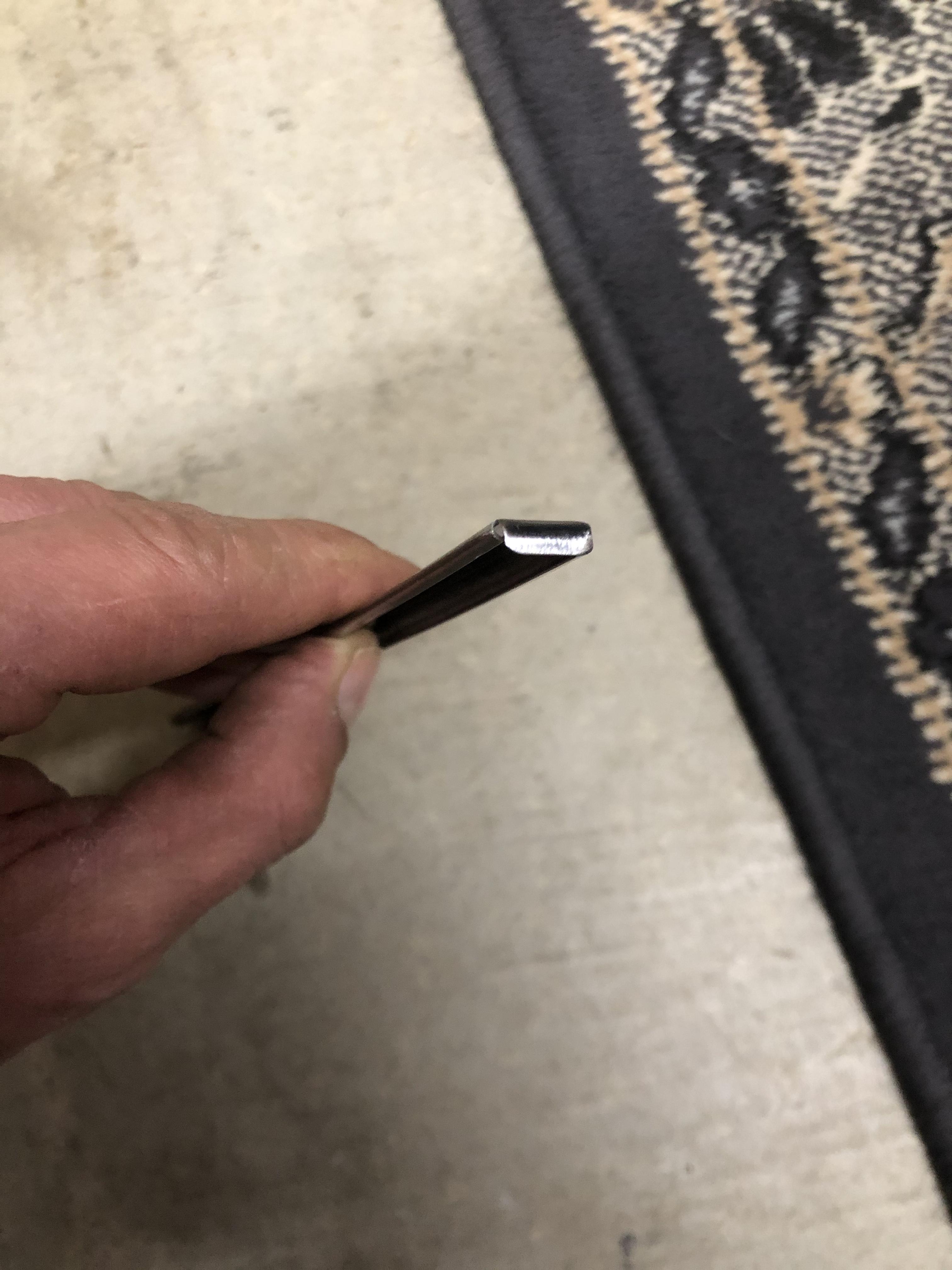

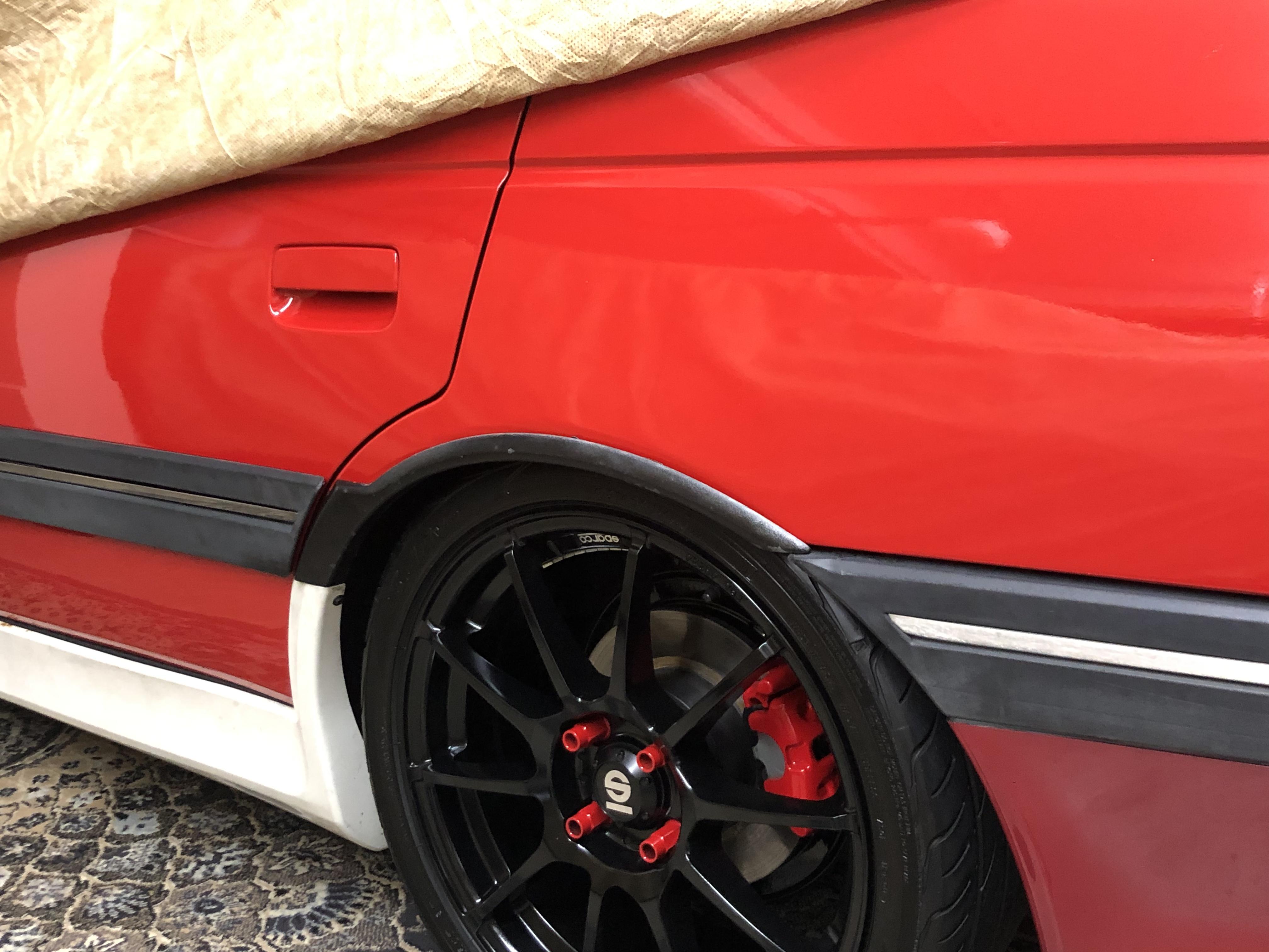

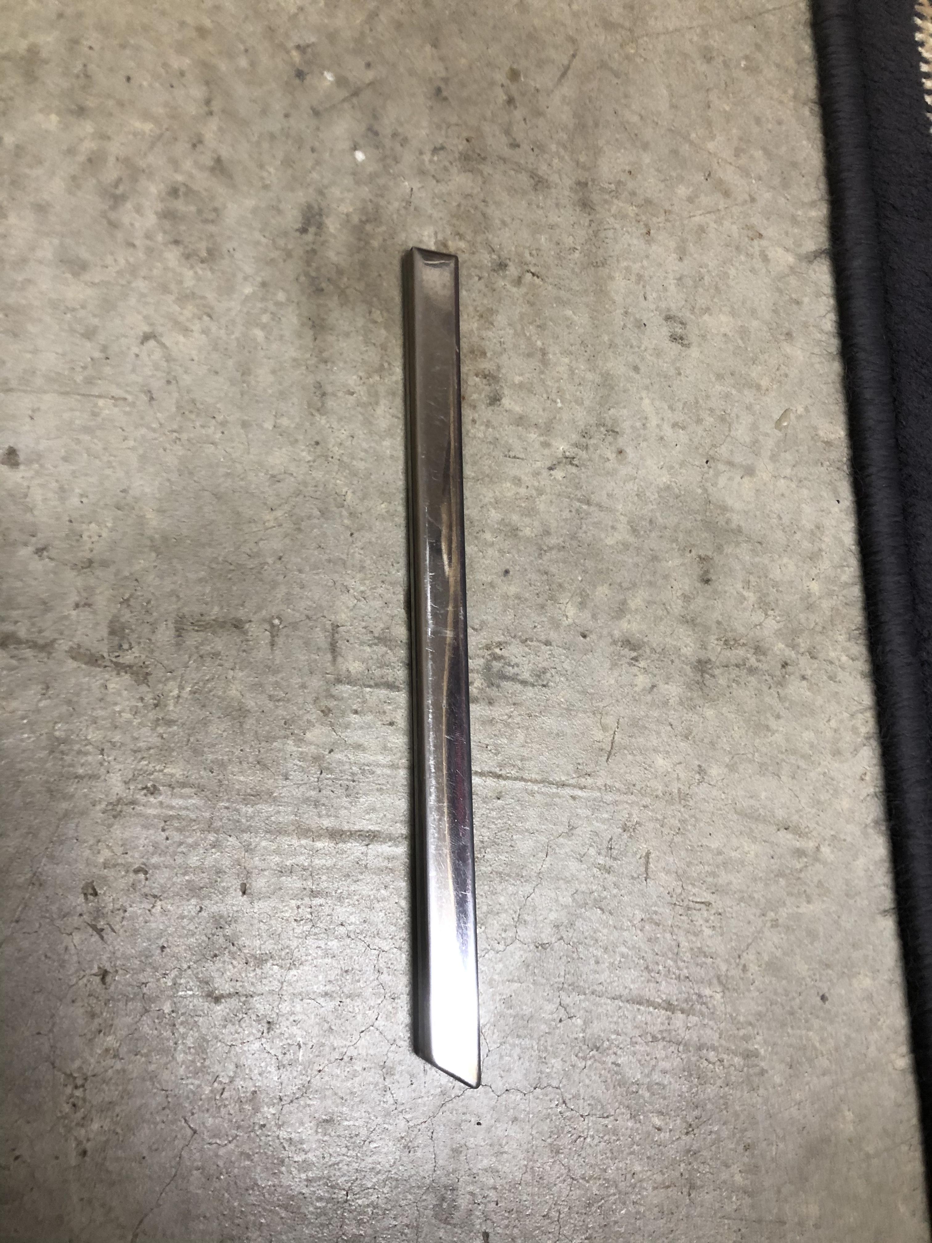

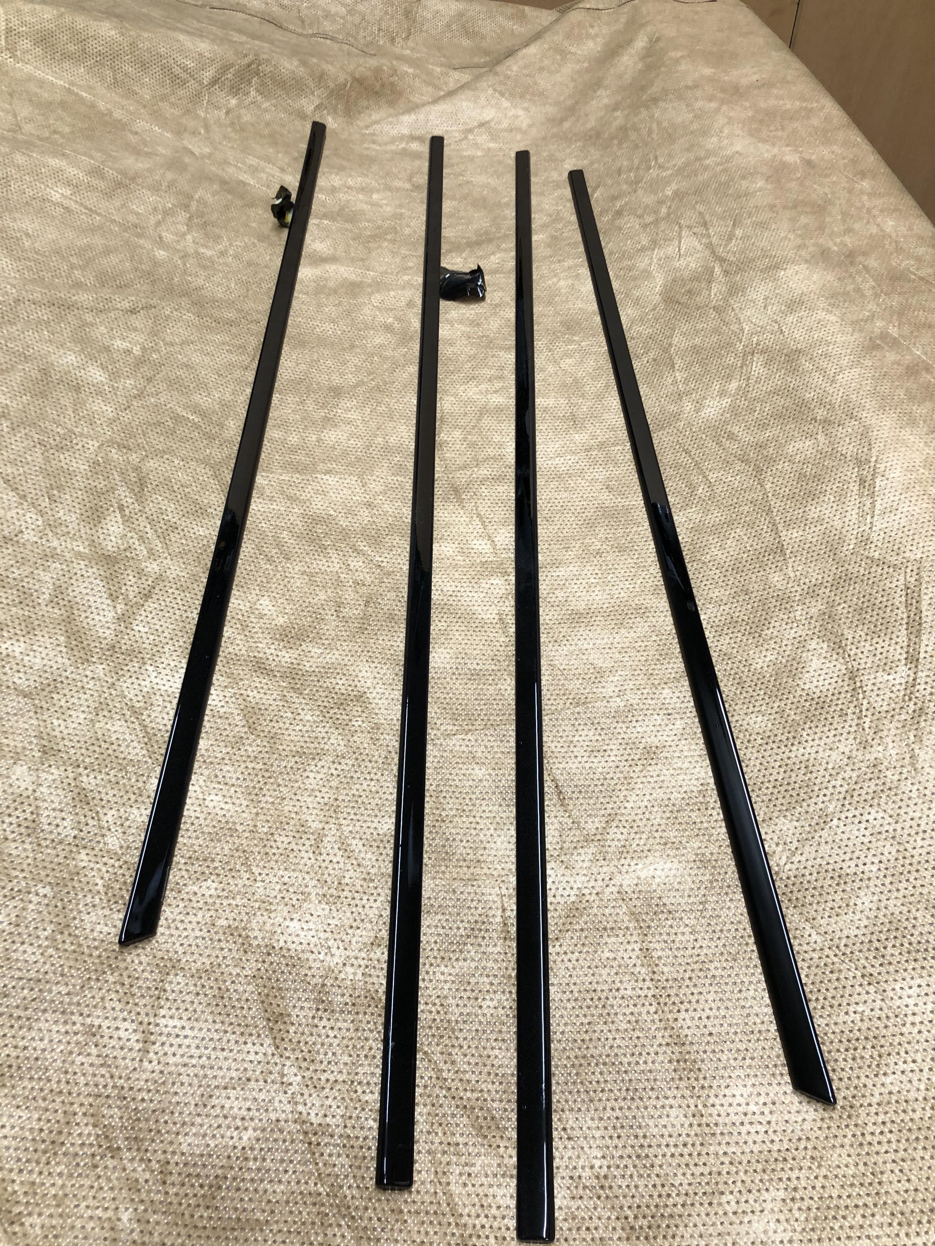

my3AWDgst Posted January 11, 2020 Author Report Posted January 11, 2020 Washed arch trims and chrome inserts today and I had to made one front chrome insert as it was not supplied by seller. Luckily Paul gave me few extra rear chrome strips so I just end up cutting it and shaped the ends of it to match original one. I’m really debating on cutting over fender trims and also I can’t make decision if I should paint them in color of the car including door moldings and bumpers. Opinions are welcome Quote
Bean Posted January 11, 2020 Report Posted January 11, 2020 If it were mine: I’d delete the rear arch trim, and paint the belt line mouldings body colour. The black trim ages the car a lot, and I think body colour just fits with the cars look better. If the plan was to change the looks to be more of a restored stock look - I’d still delete the rear arch trim ‘cuz it looks like a Pep boy’s stick on piece, and the front arch doesn’t have anything. Rabin Quote
SRDT Posted January 11, 2020 Report Posted January 11, 2020 I would keep it stock, or maybe paint the chrome inserts red. The arch trims are a tribute to the 205 GTI: Quote
Bean Posted January 11, 2020 Report Posted January 11, 2020 Does the front have arch trims? On second look they are wider than I first though, and that 205 SRDT is pretty choice looking. Tough call! Rabin Quote
SRDT Posted January 11, 2020 Report Posted January 11, 2020 Front and rear indeed, on the 405 it's more of a gimmick but on the 205 they are very much needed and you need to cut the body to fit them. Quote

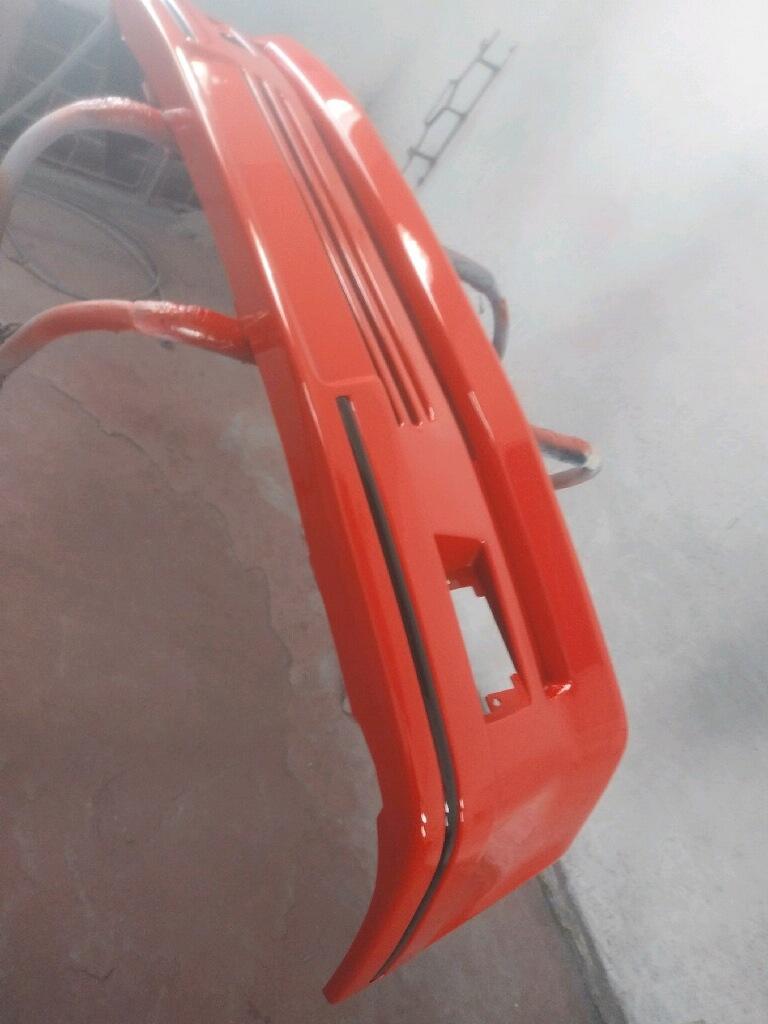

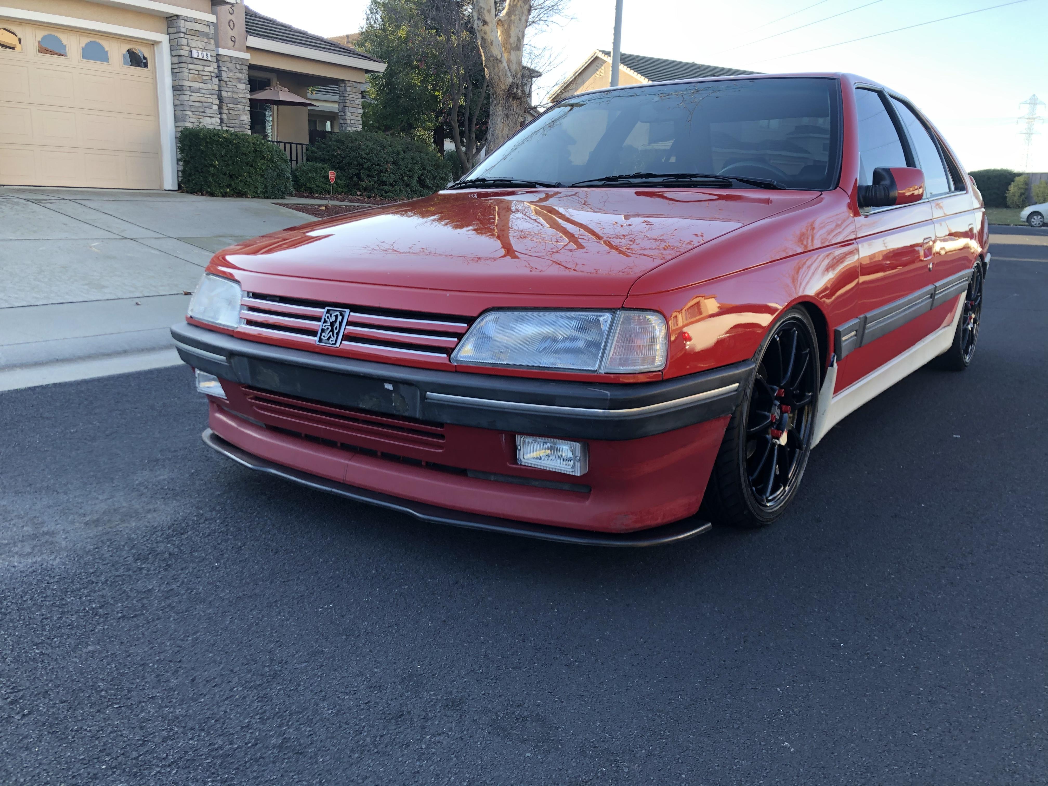

my3AWDgst Posted January 21, 2020 Author Report Posted January 21, 2020 Sneak Peak Painter send me few pictures today, most likely I’ll pick it all up tomorrow. Quote

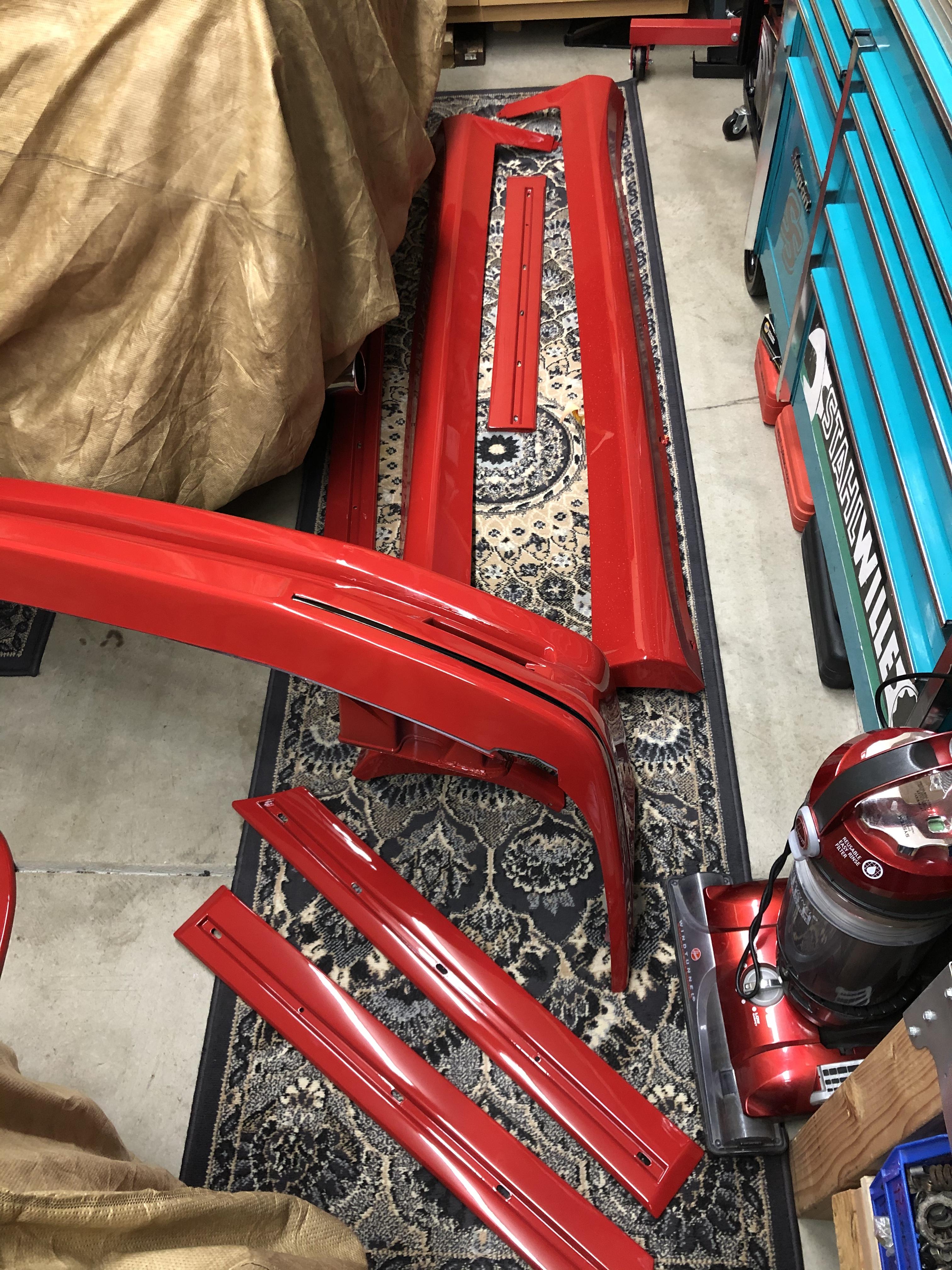

my3AWDgst Posted January 23, 2020 Author Report Posted January 23, 2020 I end up picking it up on Tuesday and on Wednesday I installed rear bumper, I’m satisfied the way it all turned out. Earlier today I noticed that rear arch trims are missing I called my painter and he looked trough the shop and did not fined them, supposedly he will look more thoroughly tomorrow. Hopefully they surface up otherwise I’ll end up getting another set from UK. Quote

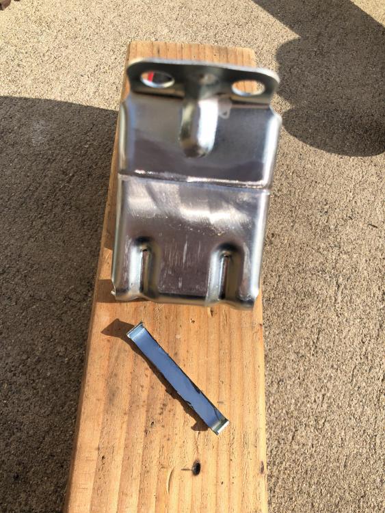

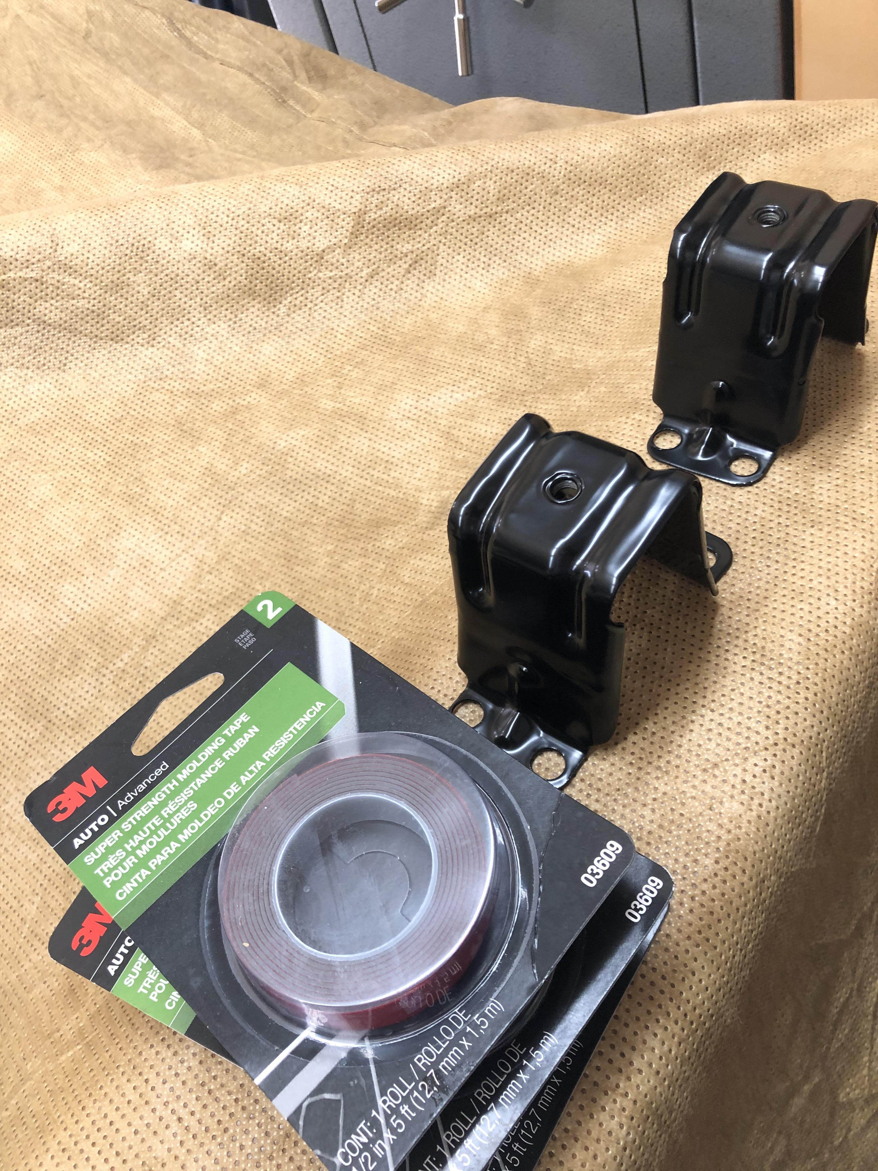

my3AWDgst Posted January 25, 2020 Author Report Posted January 25, 2020 Picked up brackets from powder coater and purchased double side tape that supposedly is made only for automotive trims and it had high strength glue. Quote

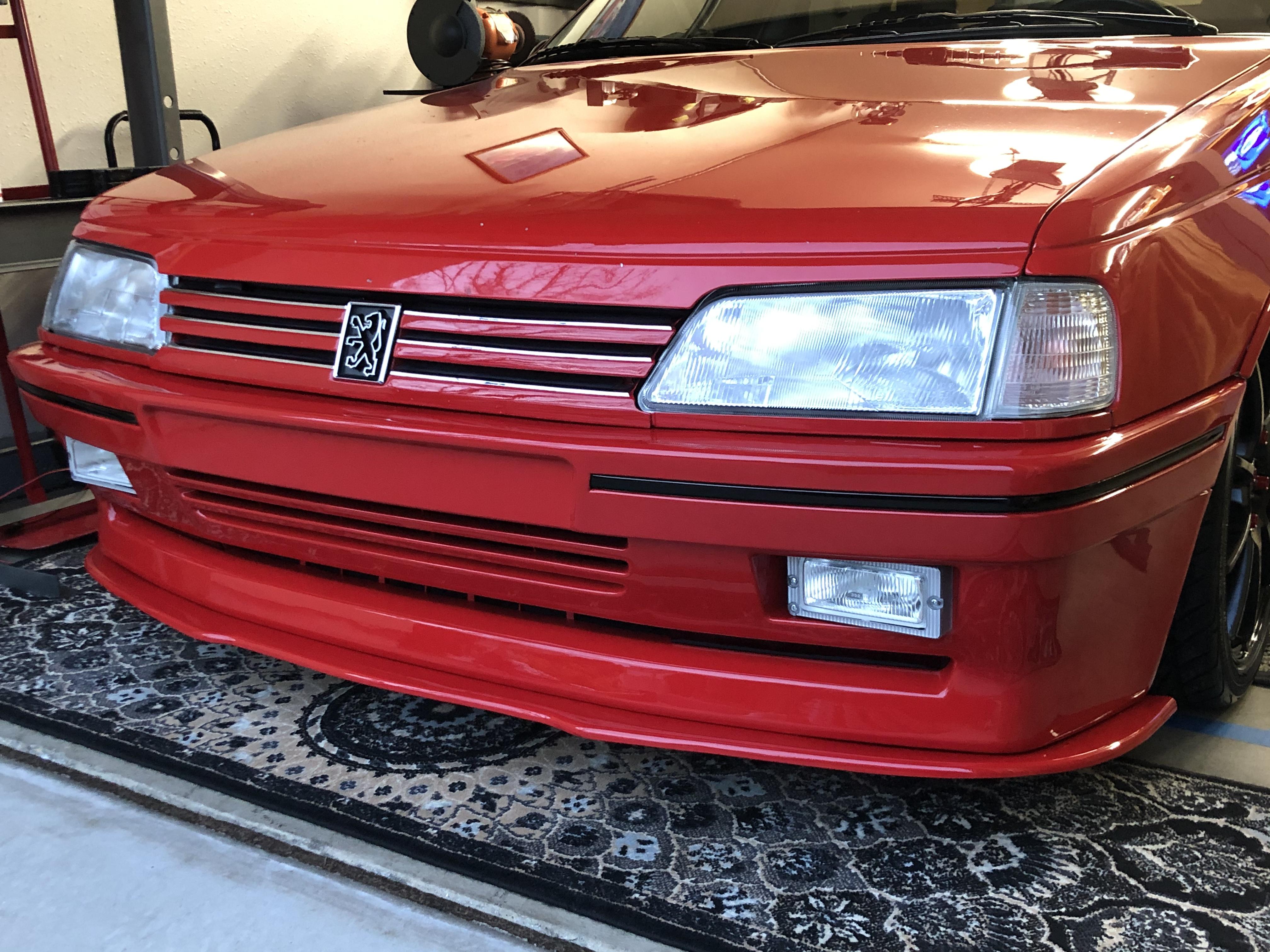

my3AWDgst Posted January 26, 2020 Author Report Posted January 26, 2020 I got the front end assembled today, unfortunately it took about six hours to get it all together, I really like how it turned out. Quote

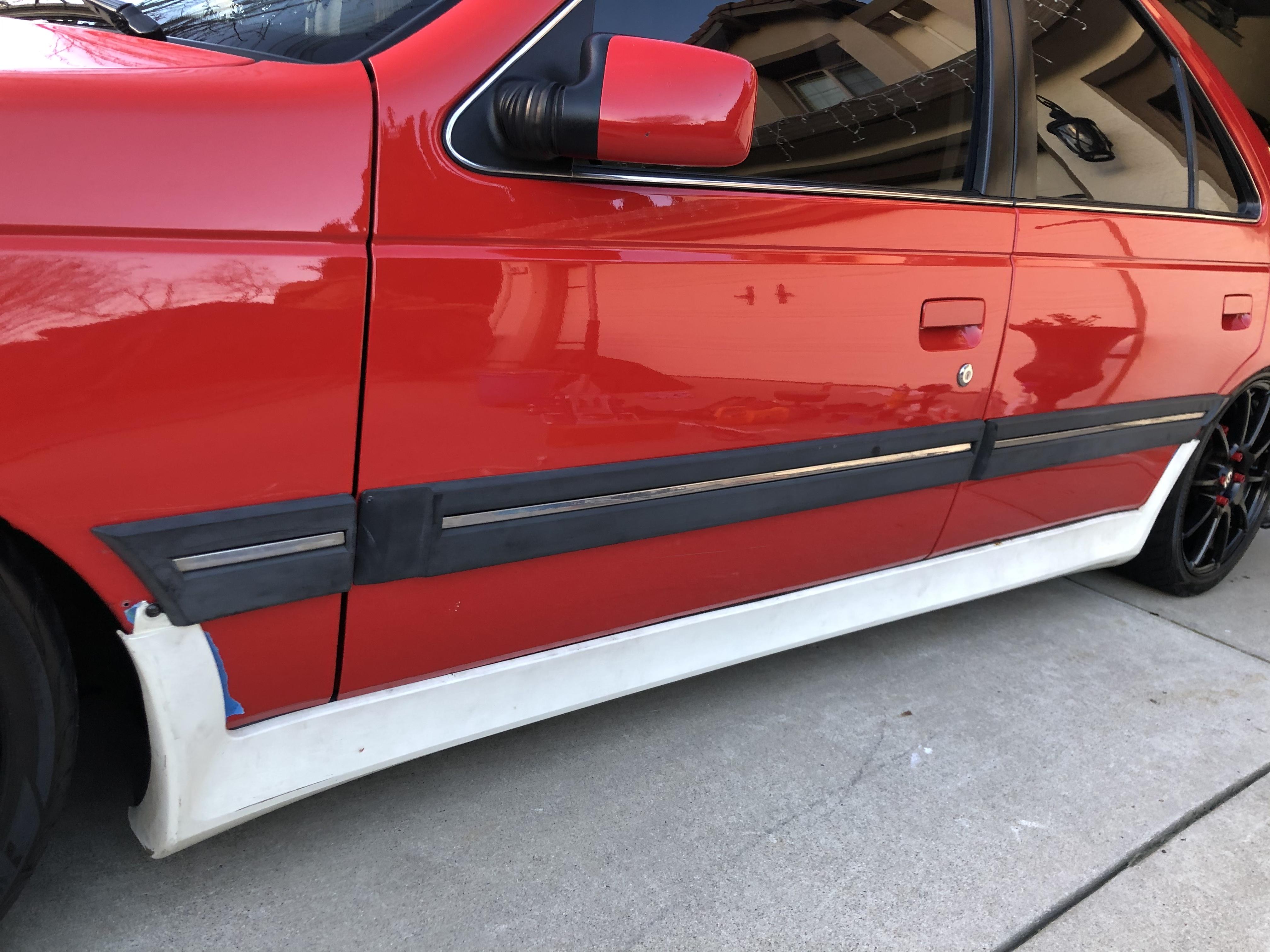

my3AWDgst Posted January 26, 2020 Author Report Posted January 26, 2020 Door moldings and arch trims need more adjustments but it’s pretty close. Quote
N9TE Posted January 27, 2020 Report Posted January 27, 2020 Nice nice nice nice That's one awesome car you're ending up with there. Quote
Bean Posted January 27, 2020 Report Posted January 27, 2020 Absolutely stunning! And spot on with the colour matching with black accents - Totally made the right call. Did the rear arch trims show up? Rabin Quote
my3AWDgst Posted January 27, 2020 Author Report Posted January 27, 2020 Thank you guise IT definitely turned out better then expected. I can’t get my eyes of it Yes Rabin he did end up finding them, should be done by end of the week. Quote
Goce Posted February 2, 2020 Report Posted February 2, 2020 I'm a bit late but i agree also it looks beautiful and knowing how many times i've hit my bumper should last longer than any aftermarket bumper. Good work on fiting them Savo, they did not fit that good from the factory. Quote
my3AWDgst Posted February 4, 2020 Author Report Posted February 4, 2020 ^^^ I’ve noticed that when I was looking at Bryan’s Euro car, gaps around side skirts are terrible. For a while I was thinking it was my installation error but it’s just bad fit from factory, I’m also glad that I tucked in my rear bumper, looks way nicer without 10mm gap. Quote

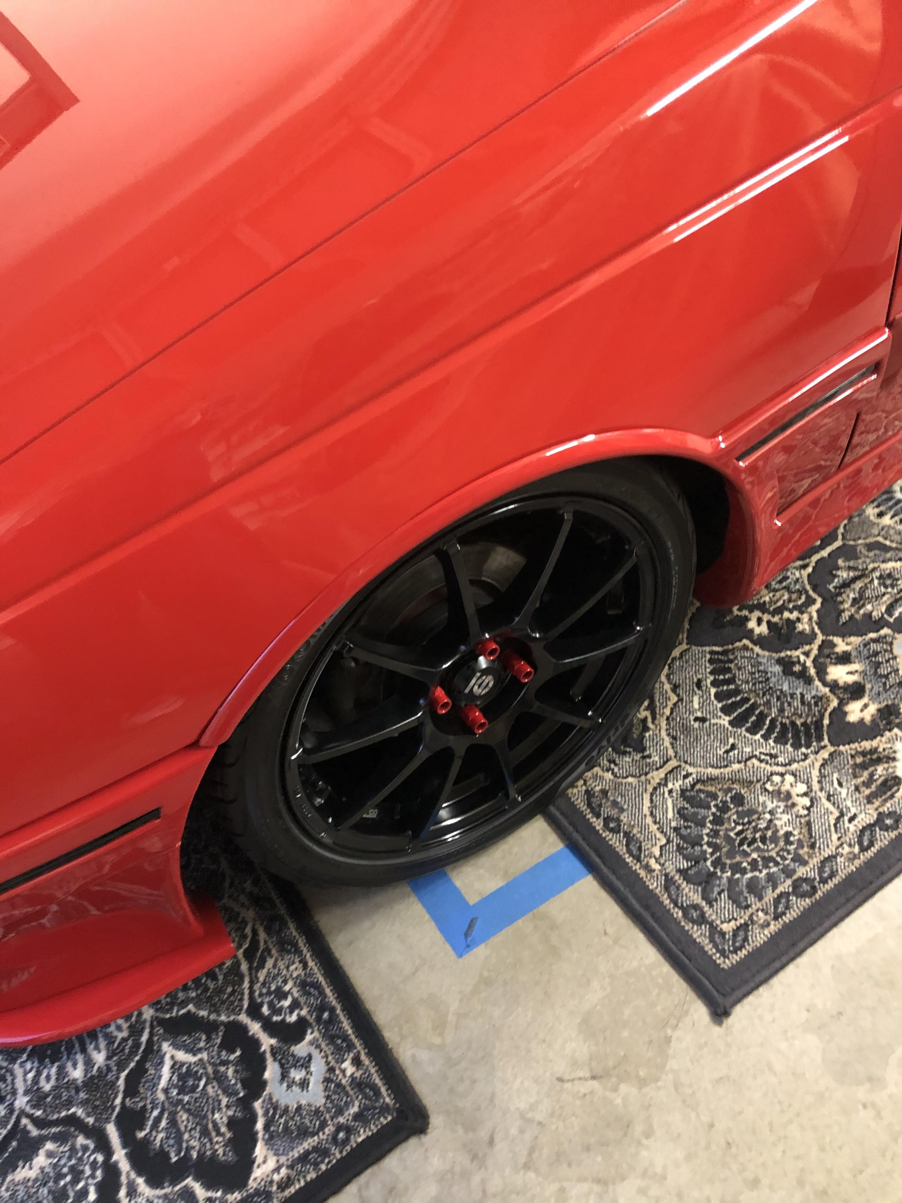

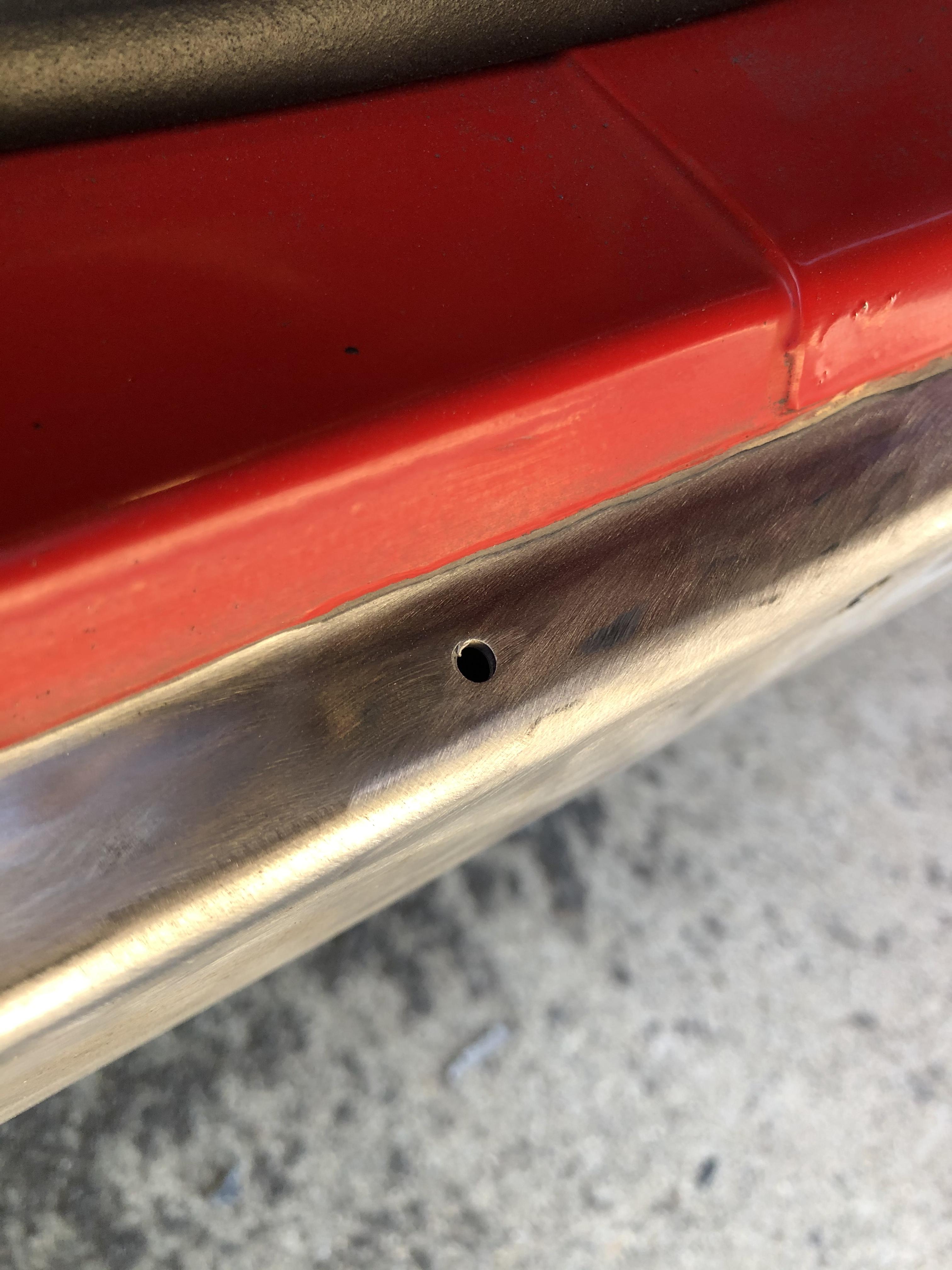

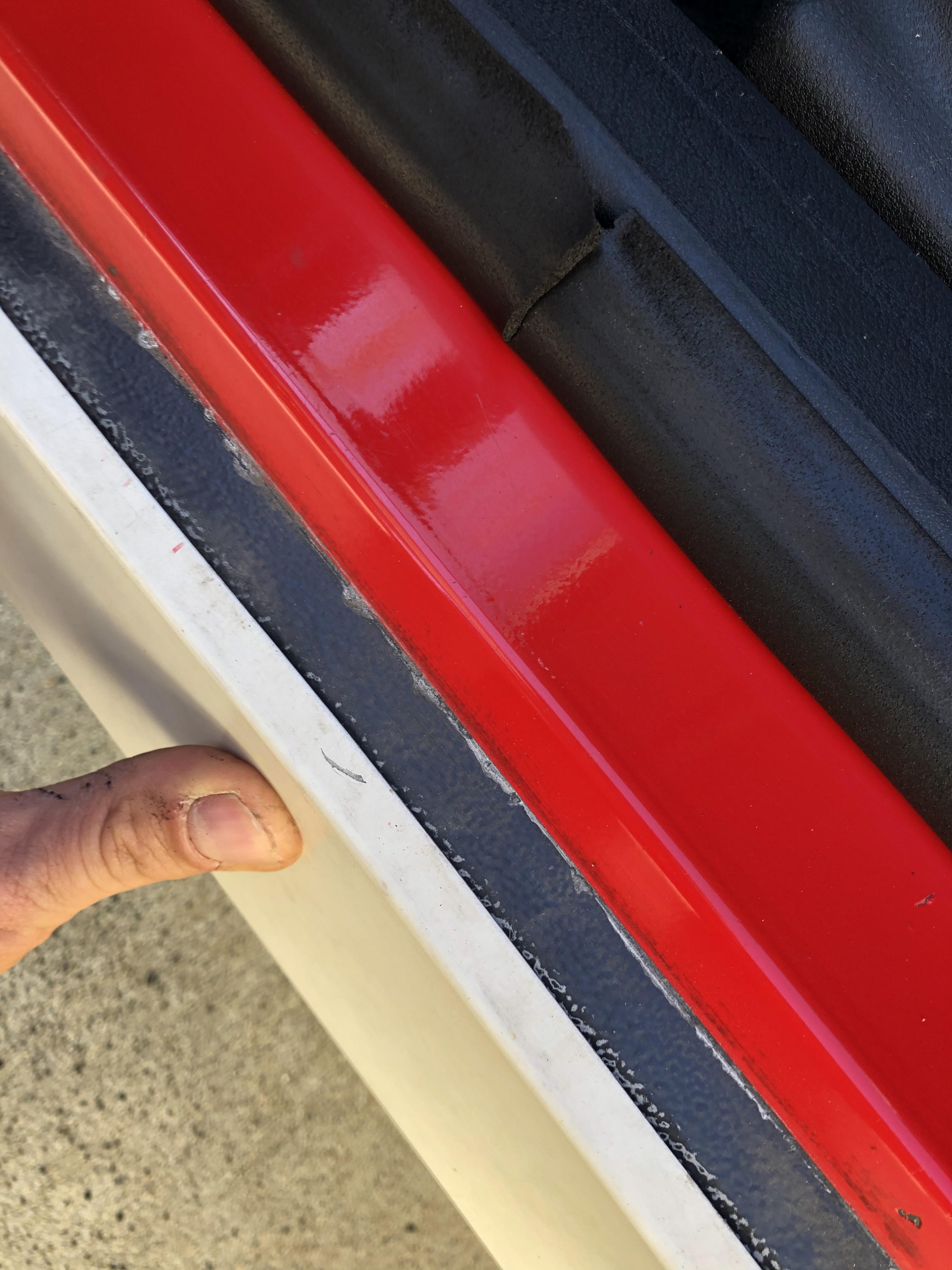

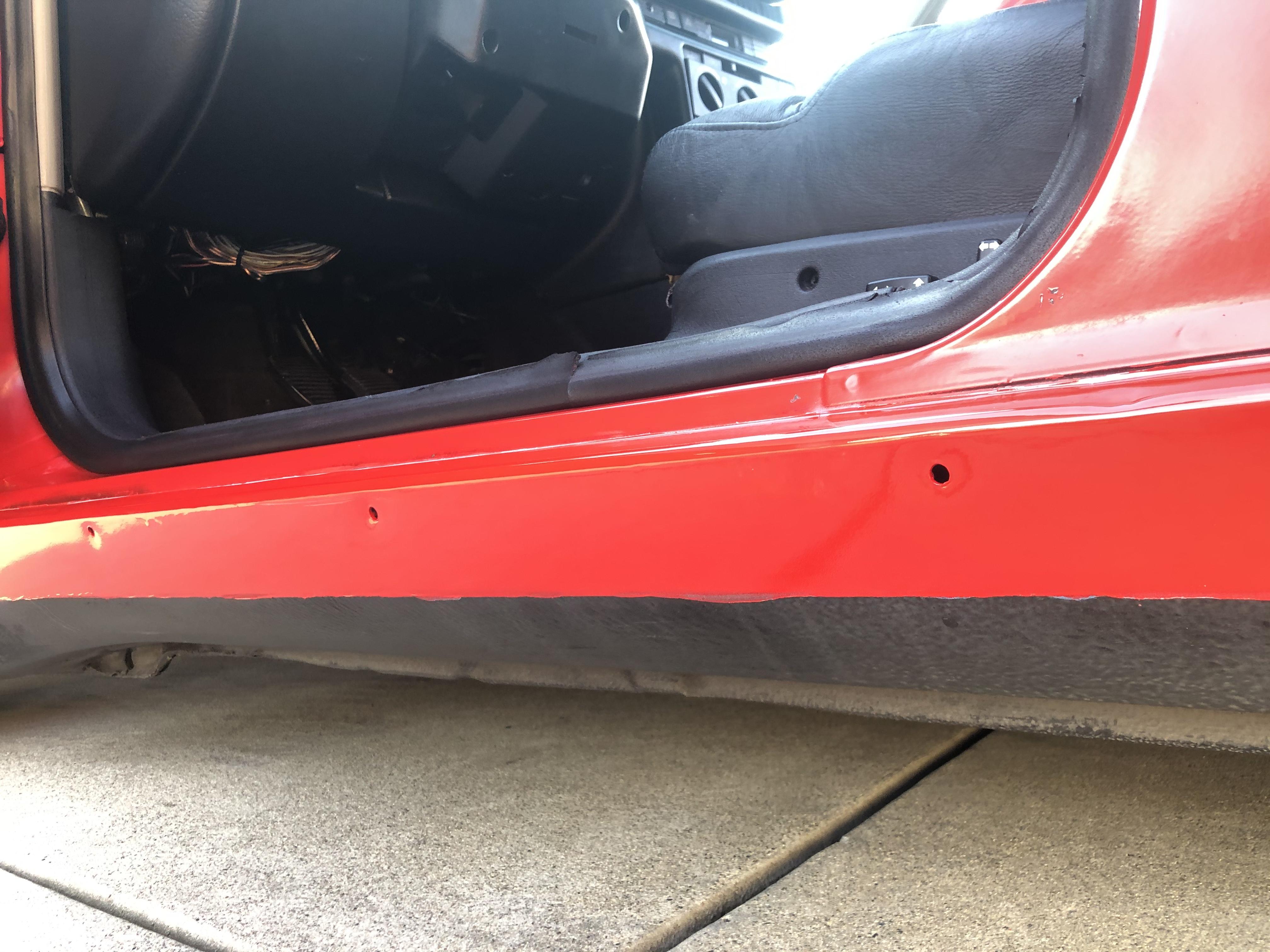

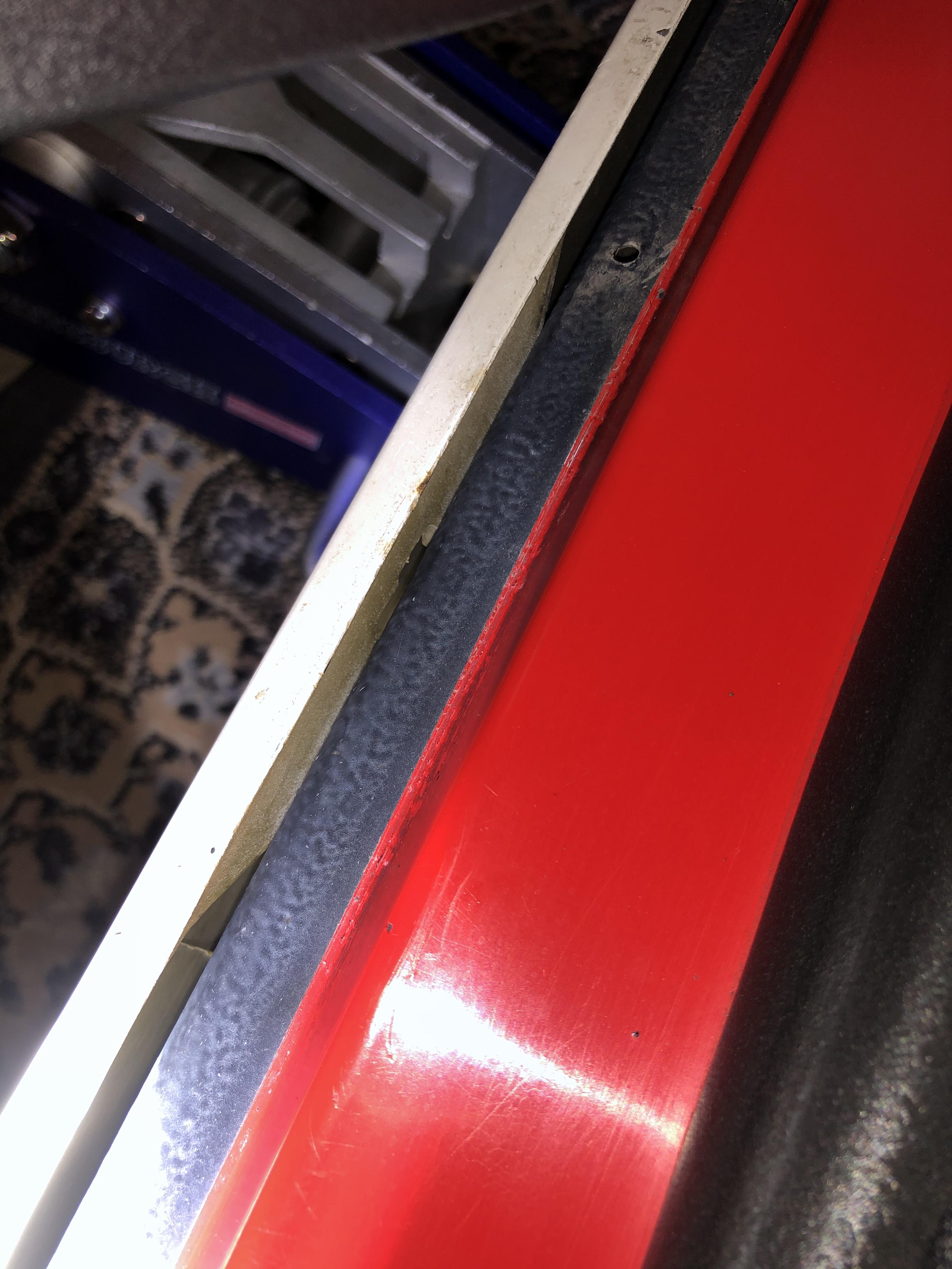

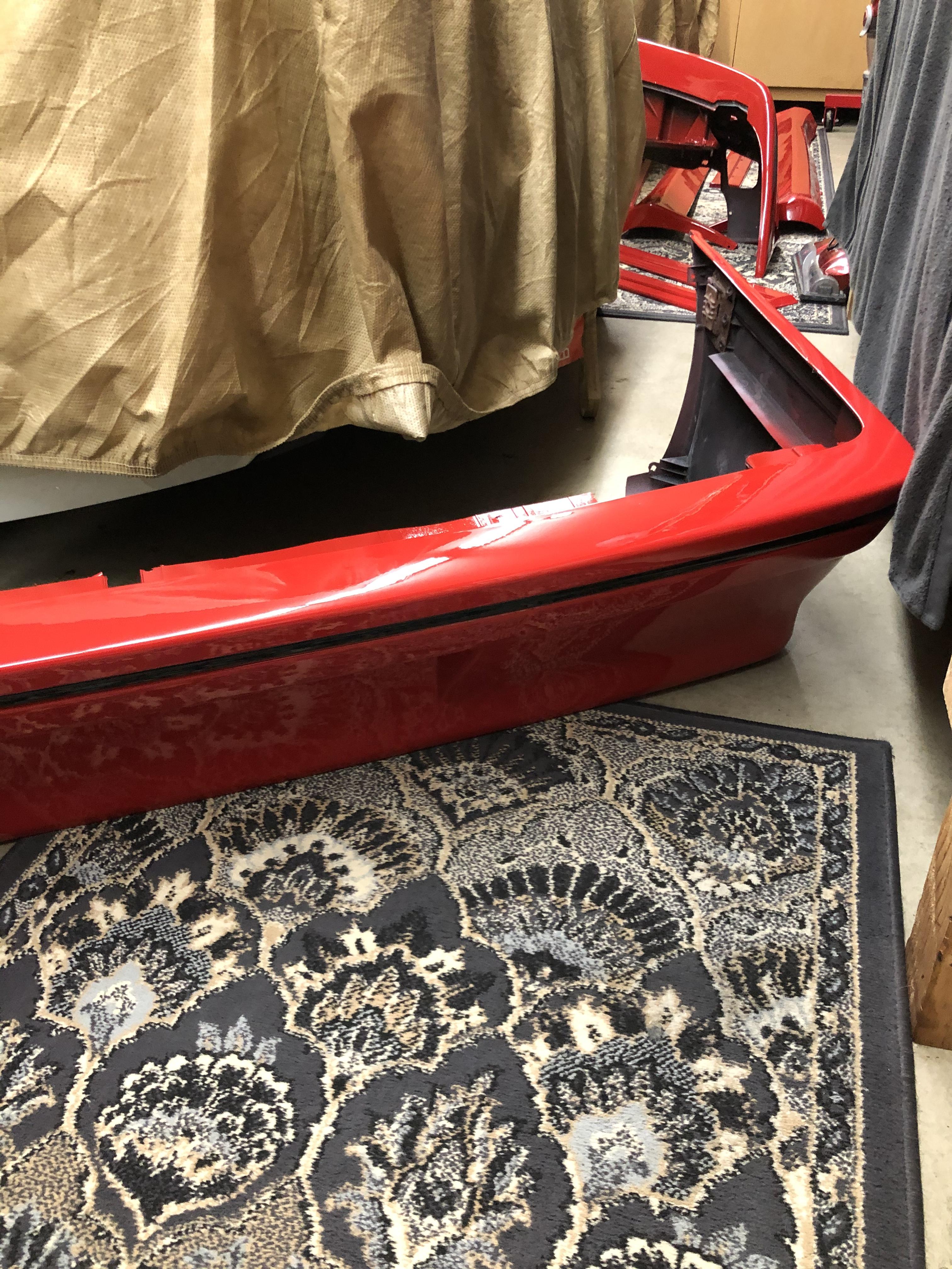

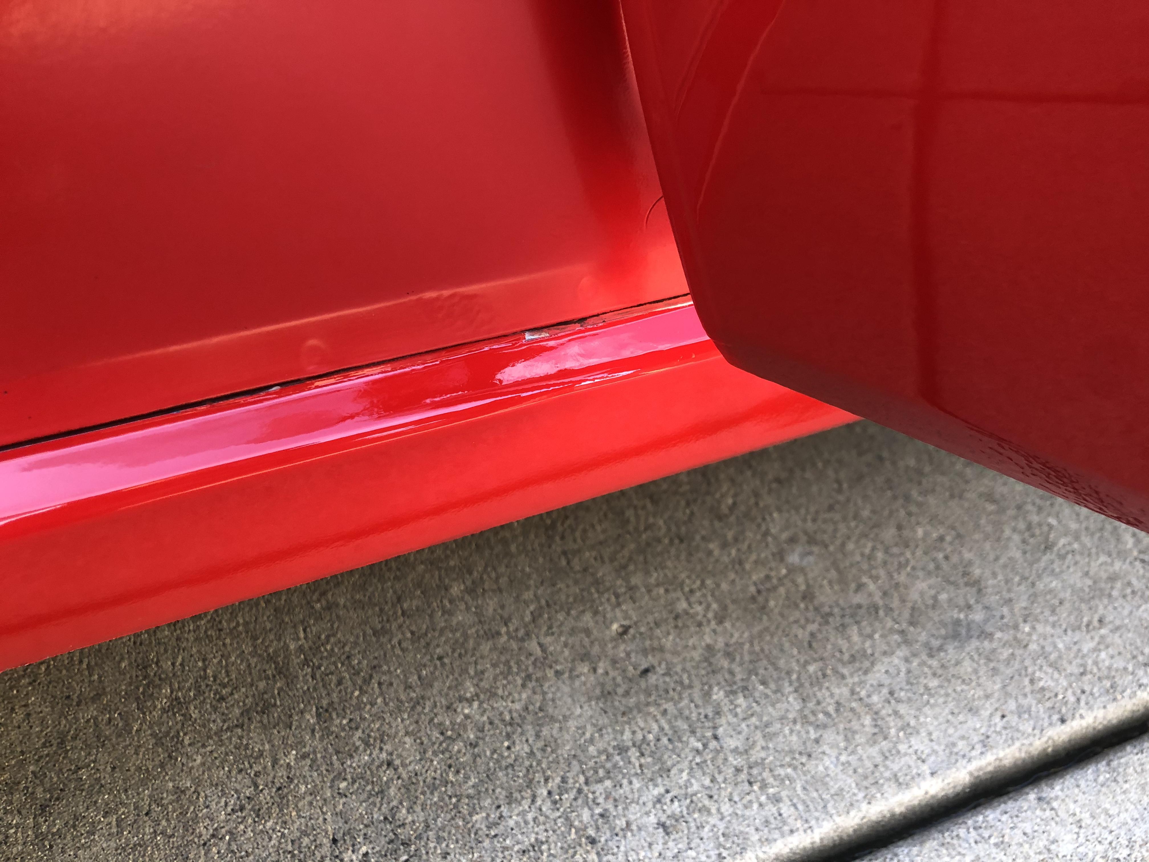

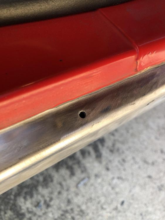

my3AWDgst Posted February 18, 2020 Author Report Posted February 18, 2020 This last weekend I finally end up painting rocker panels and it took lot longer then I was expecting. If you guise remember US cars have rocker panels coated in black under coating and when Euro skirts are mounted most of top black coating is visible and it just doesn’t look good in my opinion. I end up leaving other half portion of coating on rocker panel as this coating is thick and it’s great protection and way better then paint. I should also add that I drilled holes for Euro skirt mounting clips and welded those little holes that were holding US body kit, nice and flat now. Quote
