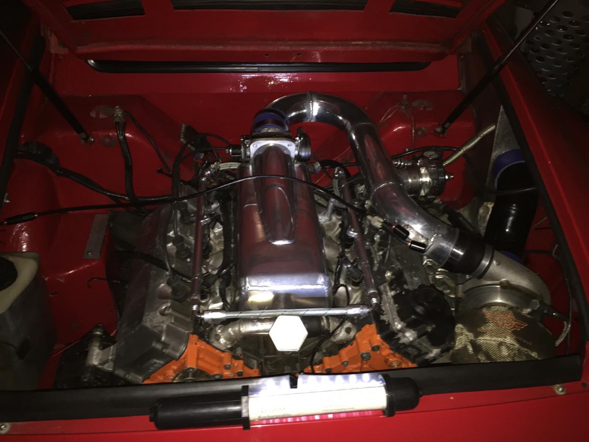

Guest glen Posted December 3, 2015 Report Posted December 3, 2015 I don't know anything of the 505, other then Alpine A310. But I do know a great deal of the PRV, and of tuning them, specially with turbo. ......3,0 24v. If you want to go big power, you will need to change pistons and rods. Do some nice flowing work on the cylinder heads. Custom build the exhaust system and custom build the intake system. Other engine management system. Big injectors. Better water-cooling. Hard pressure plate for big torque, and cinder metal plate clutch. High end gearbox. Huge turbo, Precision turbo. And a hole lot of other stof, small bit and pieces. 550 bhp and 500 fpt. But most important, a lot of time and big money pile........ Have a nice day, Glen Quote
Bean Posted December 3, 2015 Report Posted December 3, 2015 Oh dear God Glen - that looks AMAZING! Have you documented your build anywhere? I'd love to just pour over the details of that all went together. Your power results are staggering too! May ask what ECU you're using? Rabin Quote
SRDT Posted December 4, 2015 Report Posted December 4, 2015 Impressive, lots of mods and whe only see the top. Are you using a chargecooler built in the custom plenum? Quote

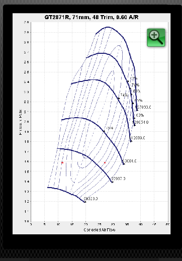

Stewart Posted February 19, 2016 Report Posted February 19, 2016 I just checked Garrett boost adviser for you. For 300hp and 50% intercooler efficiency a GT2871rs is a fine choice. The map here was generated for midrange at 2700rpm and max power at 6400rpm for a 2.9l engine and 300 hp peak. 50% intercooler efficiency. It tells me from here that in midrange at .6 bar the turbo is in it's 72% efficiency island. 75% appears to be the best area for this turbo so it should spool nicely here. Now add a little more boost to 0.8 bar and both red dots move closer to the best efficiency island. I close enough turbo number to explore for this option or one that is better. Notice at the 2.0 on the left, that means 2 bar absolute or 1 bar boost. At 1 bar boost the turbo runs nicely through the best efficiency  island. Not bad to start with. The Dynosim calculates a good projection. Looks good to start with. Quote

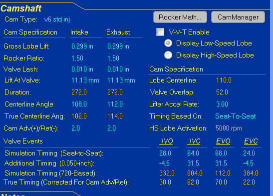

Stewart Posted February 20, 2016 Report Posted February 20, 2016 With a little closer real world intercooler at 50% efficiency, for street use in hot weather seee wher the dots sit on the map now. Bean is much better at this than me, but it might give you a place to start looking. If you can get 2850 Volvo injection cams they had 11mm or so valve lift which is spot on. Advance the cams 2 or 4 degrees and you have a pretty nice turbo cam profile! A duration of 260 or 270 with 220 at 0.050" I recall. I'll have to check for you. Maybe Mr John Lane has better info on that though. Quote
