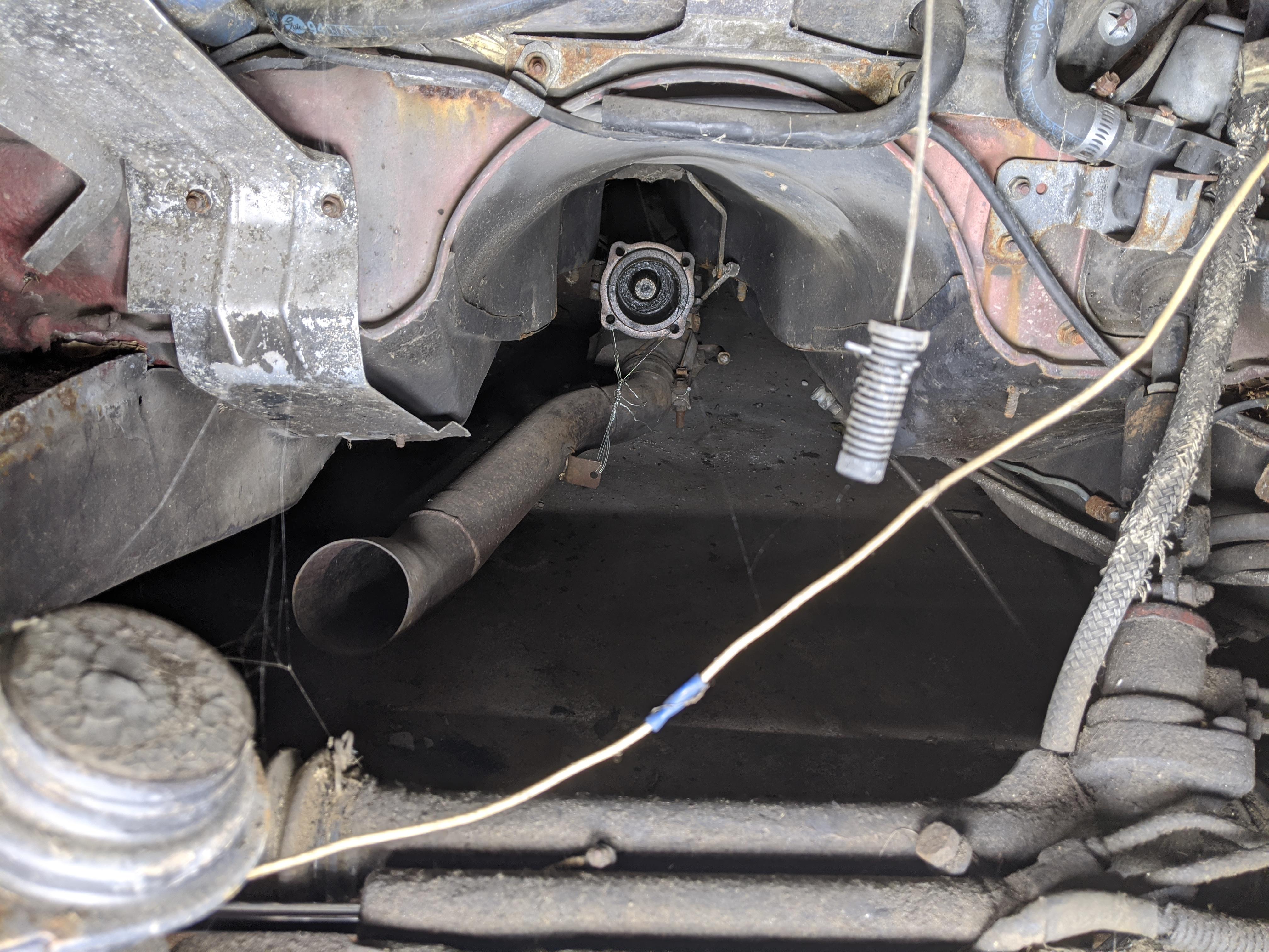

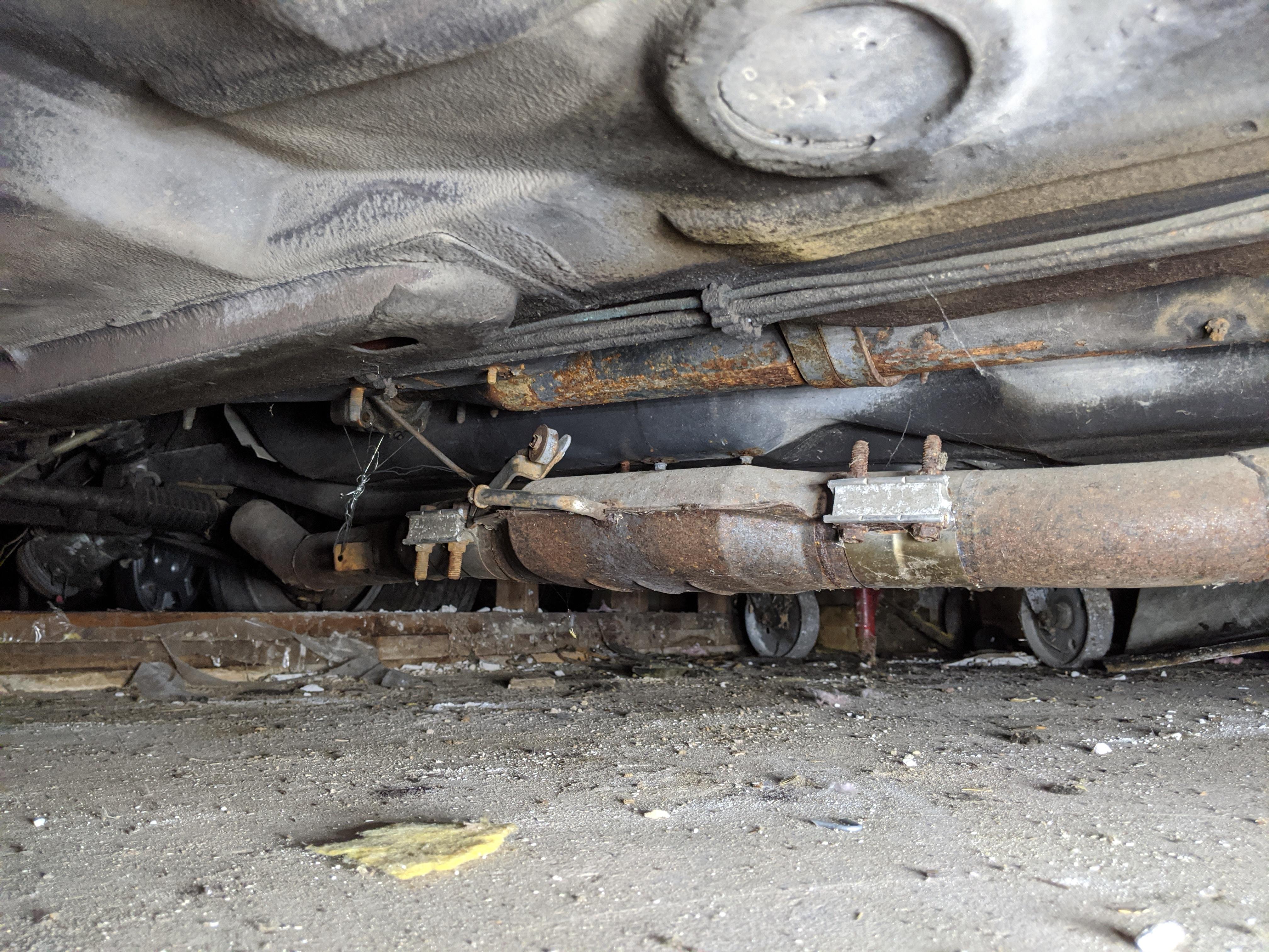

@TimV @Bean This is awesome! I am definitely still interested in getting this project going, whatever documents, calculations and emotional support you can provide while I attempt to get through this would be great! The STX had a set of brand new ABS rotors slapped on it before it sat in the lot for a few years, along with a new clutch, slave and master, so I'm hoping I can get the rotors turned or blasted as I remember Bean suggesting if that's the route I end up going. So what would make this simpler? using the entire front suspension and subframe from the STX, figure out a trans mount in the rear and determine the length of extension/shortening of the tail shaft or possibly modifying the U joint to compensate? I see Tim mentioning that there were 2 lengths for the wagon tail shafts, it would be a blessing to have any dimensional data, schematic references and such. I've got a million questions, but now have a little better understand of what I'm getting into. The STX has to be stripped regardless, and the wagon has no drivetrain, so I'd say a 1/4 of the work is done. I've rebuilt and modified ECU harnesses on mostly Japenese cars, but a lot of sensors, switches are interchangeable, and I've got the theoretical/hands on knowledge from Avionics, coming from a technical background I think if I've got the support from you guys, and the confidence from Tim that he enjoyed the Auto PRV in the wagon, that the 5 SPD PRV wagon would be an enjoyable car. My first 'winter' car/daily was our 89 SW8 in navy blue, just like Tims old car, (do you still have it? What happened?) while the 89 5 SPD turbo Sedan hibernated in the garage, theres Peugeot in my blood, and I've kept these cars for too long to just give up on them, but still need all the motivation I can get!

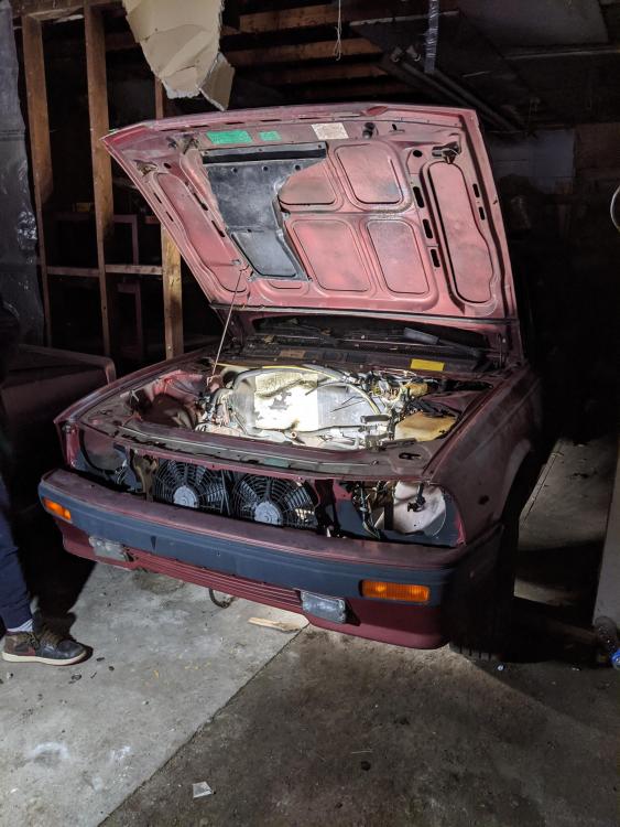

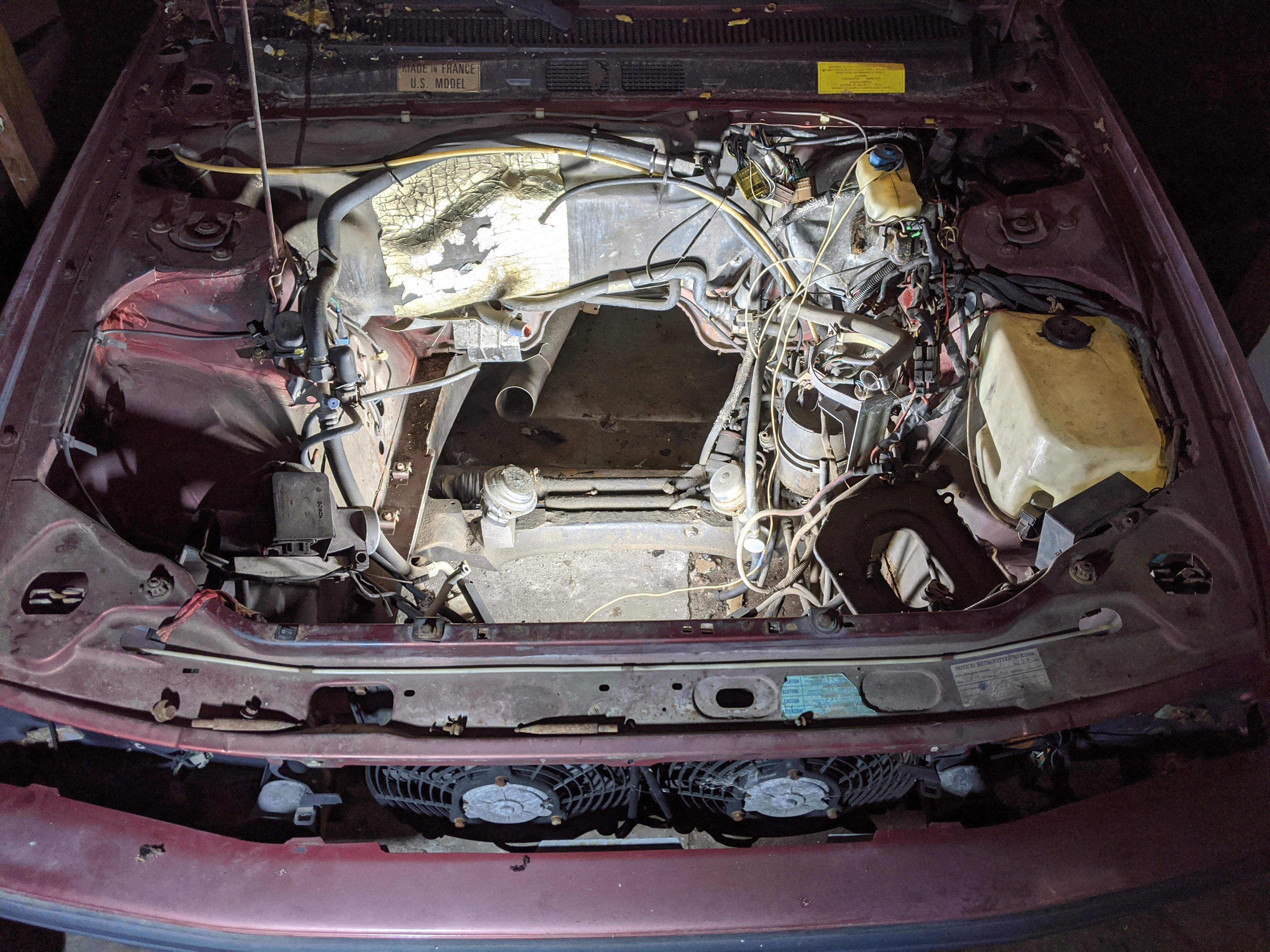

Hi guys, So Ive got an 89 Wagon (originally Automatic-Turbo) rolling shell (no engine or trans), and an 87 5 speed (manual) STX (V6 PRV) that is ugly and rusty... What I would like to do is swap the PRV 5 speed combo from the STX into the 89 wagon. Is it even possible? What tail-shaft would be best suited? (Ive been trying to find the Diff Ratio chart i thought i saw on the forum many moons ago) Some of the info Ive gathered so far, the PRV motor sits too far back when using the original N9TEA subframe and would require modifications to the firewall. I would like to swap this setup in with as little fabrication as required. (hopefully, otherwise I will likely dismantle both of the cars and keep what i have space for) Reading through some previous posts from 2014, I found that this swap has been done, but required modifying the front control arms when using the STX subframe and also a custom/modified tail shaft. If I understand correctly, (haven't been under either car recently) the auto wagon, (or any 505 wagon?) has a U-joint at the tail of the trans, whereas the STX (or any sedan) does not require the Ujoint. What do you guys think? Any help would be appreciated..
