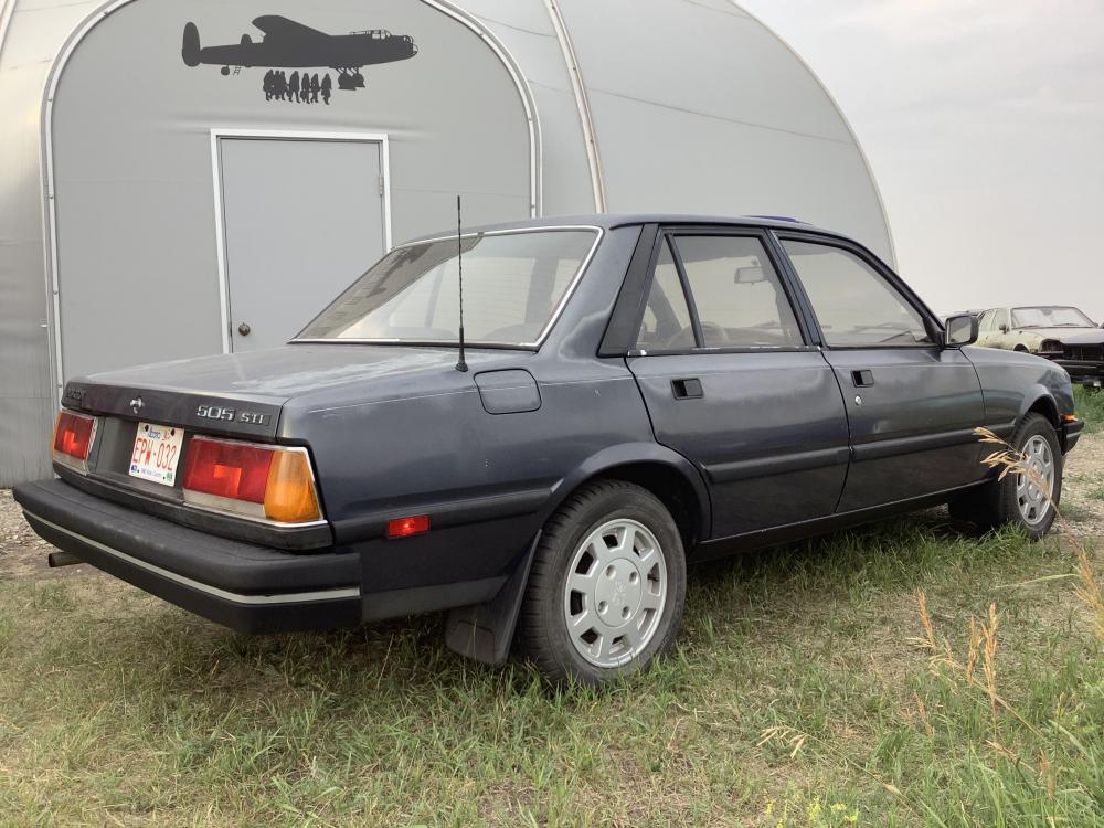

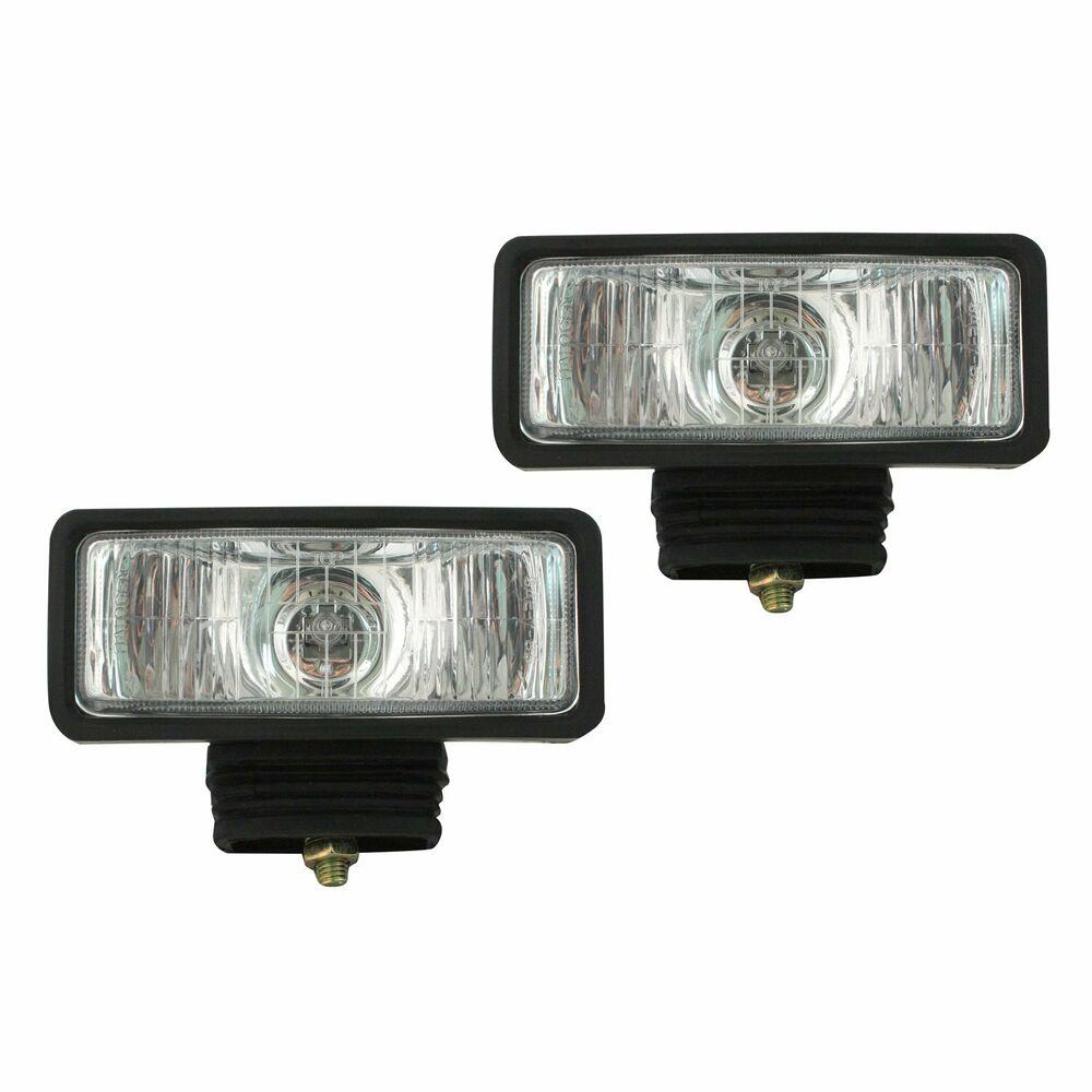

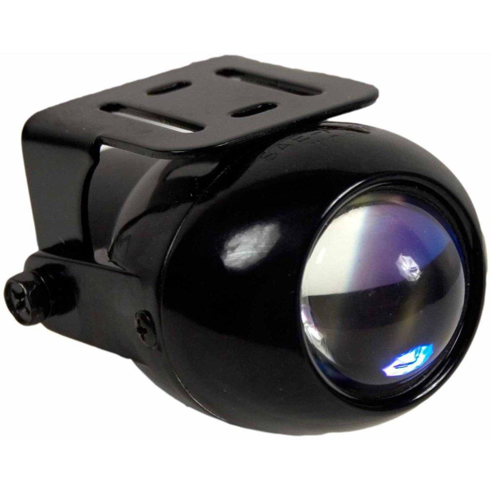

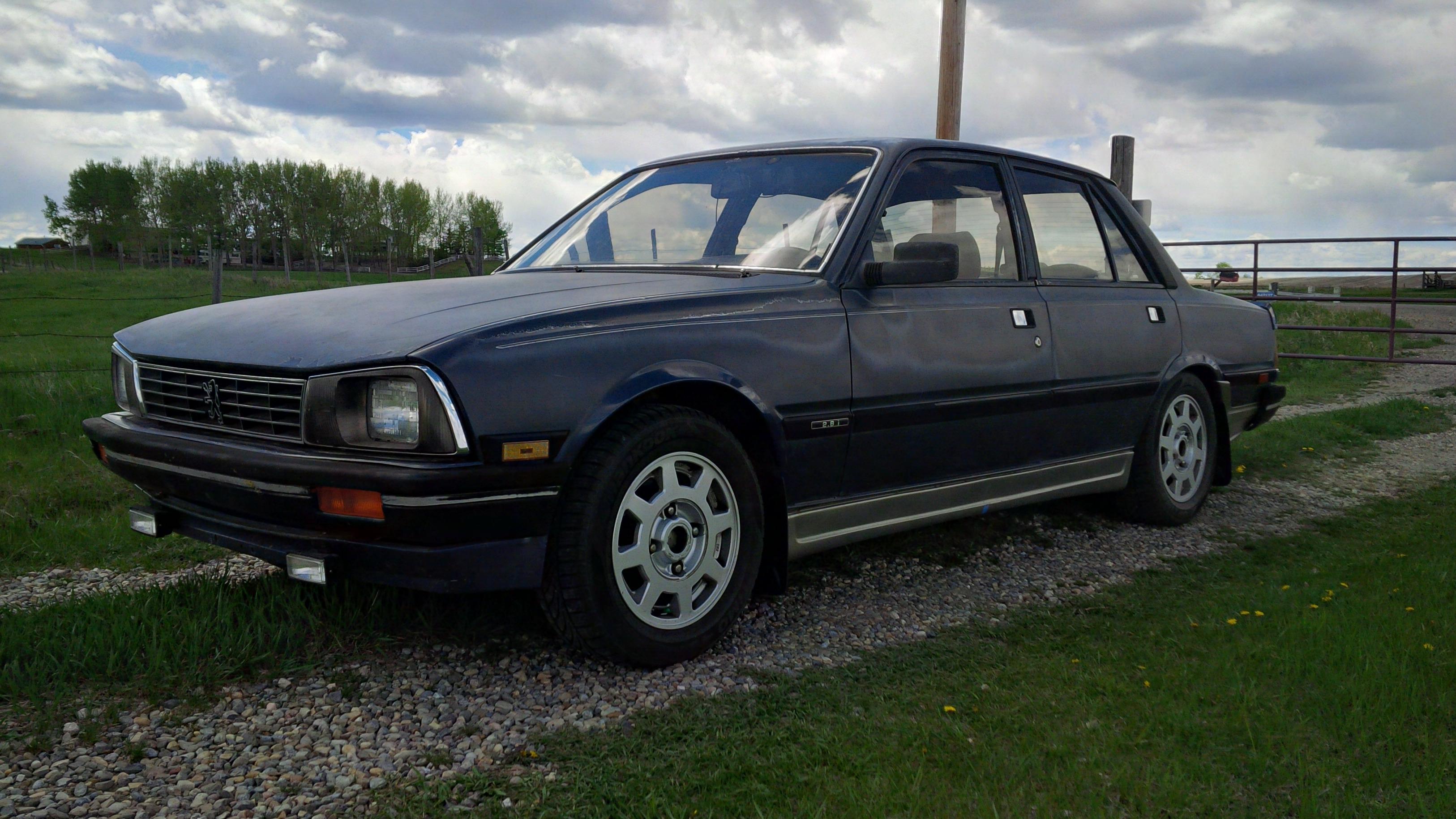

  12. I've been looking through a few old pictures from years ago, and it's surprising how a few cosmetic details alter the look of a car. This is a picture of the STI taken back in 2015. At that stage it was wearing some rather shabby-looking 504 wheels that could have used a coat of rust paint. Late 15" alloys, new mud guards, the tucked bumper and the air dam have really transformed this vehicle. While at work up here near Pond Inlet, Nunavut, I've been planning next steps. I have a few different sets of driving and/or fog lights I can mount at the ends of the air inlet in the air dam, but I'm having a hard time deciding between a set of Blazer projector fog lights: ...and a set of Pilot Automotive halogen reflector driving lights: I've actually got two sets of each, and I'm honestly torn. The Pilot units look pretty good on a 505, as seen on my STX: ...and they're probably more period-correct for the car. But I also want to replace the halogen sealed-beam headlights with a set of projector inserts, like so: So now I face the dilemma of picking one...or the other...or something else entirely. I'm embroiled in similar questions around switches, gauges, and other things. Details matter, and I don't really like doing things twice.

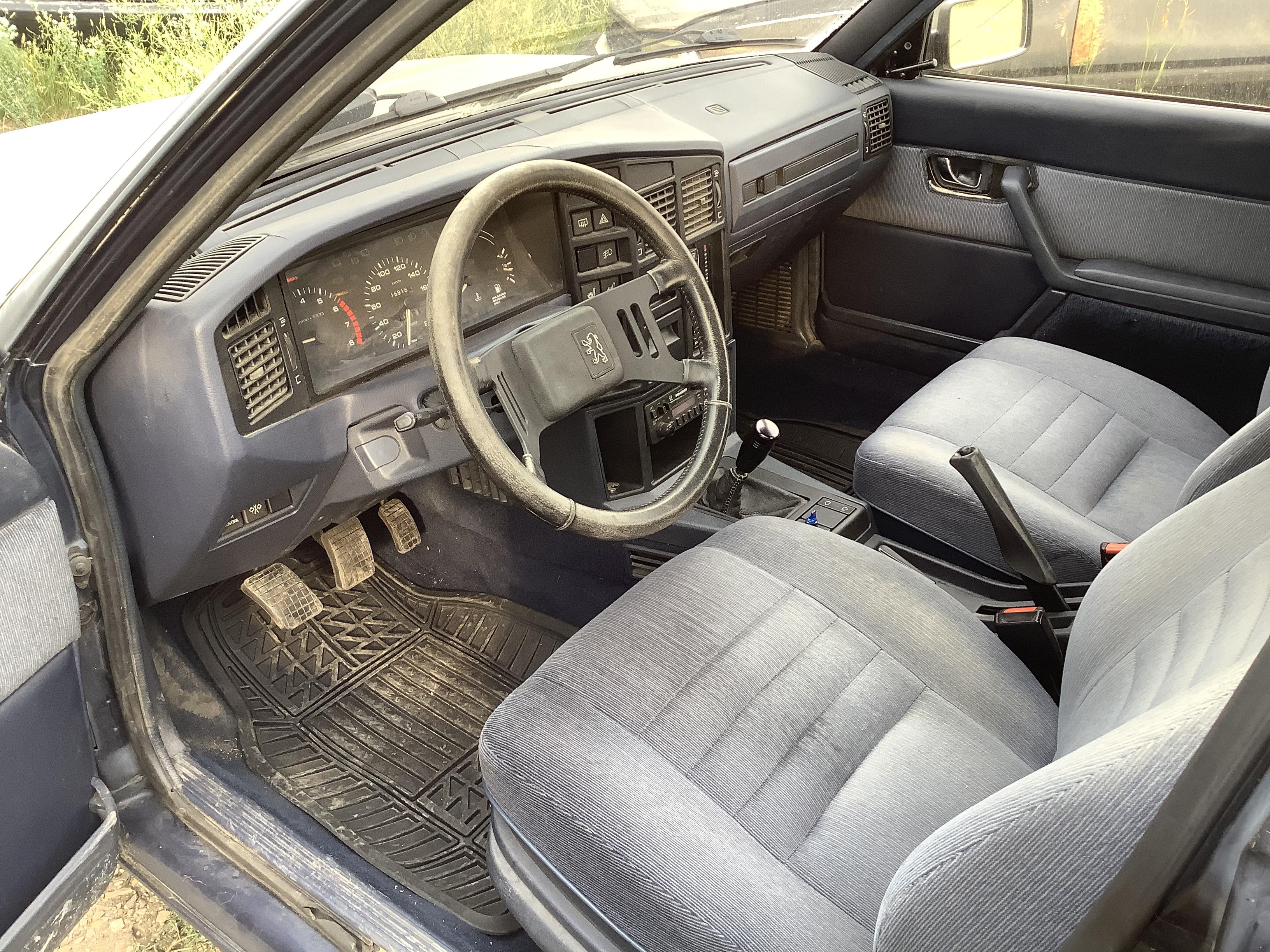

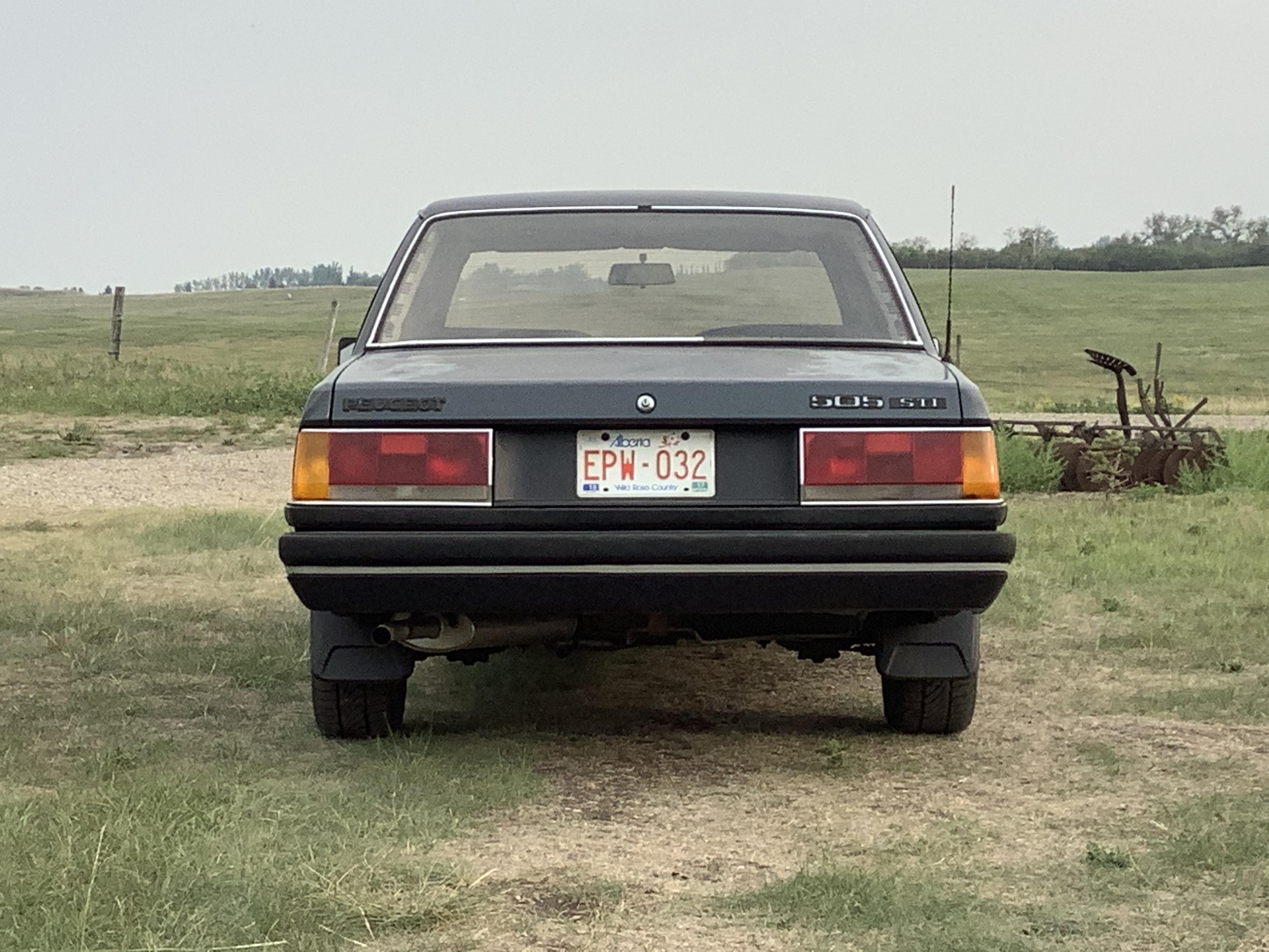

  13. Lots of little details accomplished this week, and although I now have to go back to work for basically the rest of August, I’m happy with what I managed to get done while I was home. In no particular order, here’s what I did: - found and installed a good set of basic sun visors from one of my parts cars. - installed new front LED side marker lights (Princess Auto items). - replaced cracked and non-functional RR side marker with good unit from a parts car. - installed the correct rear seats for this car, to match the fronts. I still haven’t located the tub with the headrests in it, but that’s on the list. - changed the oil and filter, and greased the propeller shaft. Second such service since I reactivated this car, and I’ll be changing the fluids in the hydraulic system, transmission, and differential soon. - replaced all four exterior door handles with black aftermarket units from Argentina. Lubricated latch mechanisms while there. - removed power trunk lock. (This caused some fun for me, as I then stupidly closed the trunk and couldn’t open it. The power lock mechanism works by inserting a plastic arm between the plunger and the latch. If it’s not there, there is no way the plunger will ever actuate the latch. I finally managed to trip the latch by removing the RH licence plate light. I then changed the plunger and its keyset to one from an earlier car without the power trunk lock. Problem solved, after a bit of consternation on my part.) - temporarily refitted the door cards, just to make the car presentable for now. When I’m home next, I will be switching the window regulators to manual crank units, in keeping with my philosophy of simple, light systems with this project. I don’t know if I mentioned it in an earlier post, but the power door locks have already been removed. -cleaned and repainted the rocker panels with rubberized rocker guard. At the same time, I found and addressed a few areas of minor surface rust that I didn’t deal with in years past. Happily for me, southern Alberta is so dry that a car parked for years in a field will not rust any more than it already had before being parked. So at least I’m not dealing with a nightmare in the wheel wells and elsewhere right now. - tweaked the position of the shift knob so that it sits 1/2” higher. I like the look better, and it’s an easier reach to fifth gear now. - installed a simple fixed antenna to replace the unserviceable power antenna. Other than that, I spent a fair bit of time planning next steps. Driving and/or fog lights are on the agenda, as well as some additional instruments. A new dashboard is in the future too. I’ve been looking into projector headlight housings that will fit into the spots currently occupied by the 7”X6” sealed beam headlights. I have a trailer hitch that is earmarked for this car, and it will also get 505 Turbo suspension, steering, and brakes at some point. I have a pretty clear vision for this car now, and it’s merely a question of time, effort, and a little money. By the way, I’ve decided that I will not be painting this car. I’ll do what I can to shine up the existing paint, but it’s going to wear its 35-year patina proudly. That said, I will paint things like the window frames and wiper arms, and all those elements will be flat black. I like the look. More to come in September! For now I’m off to the high Arctic to fly around and count whales for three weeks.

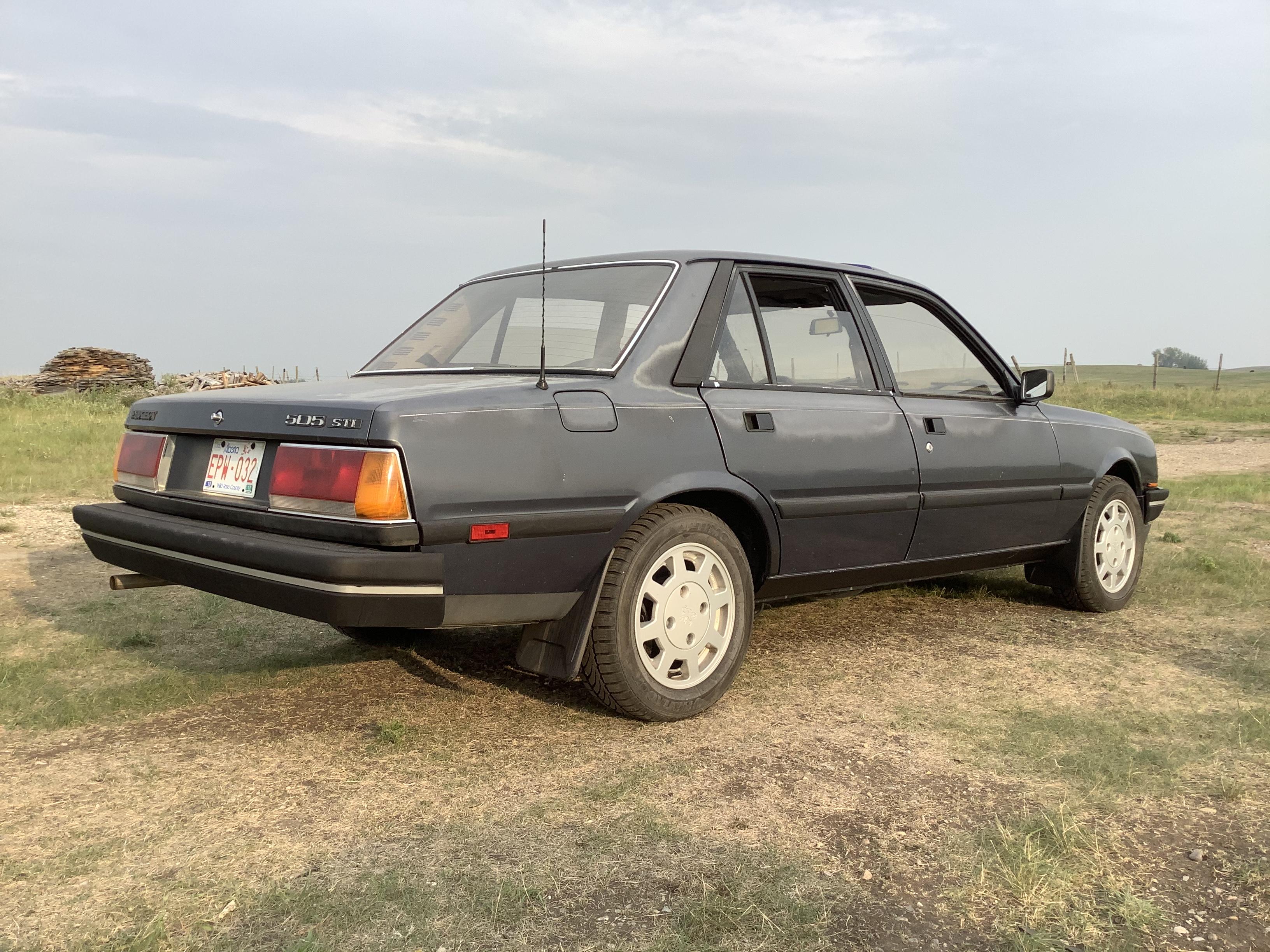

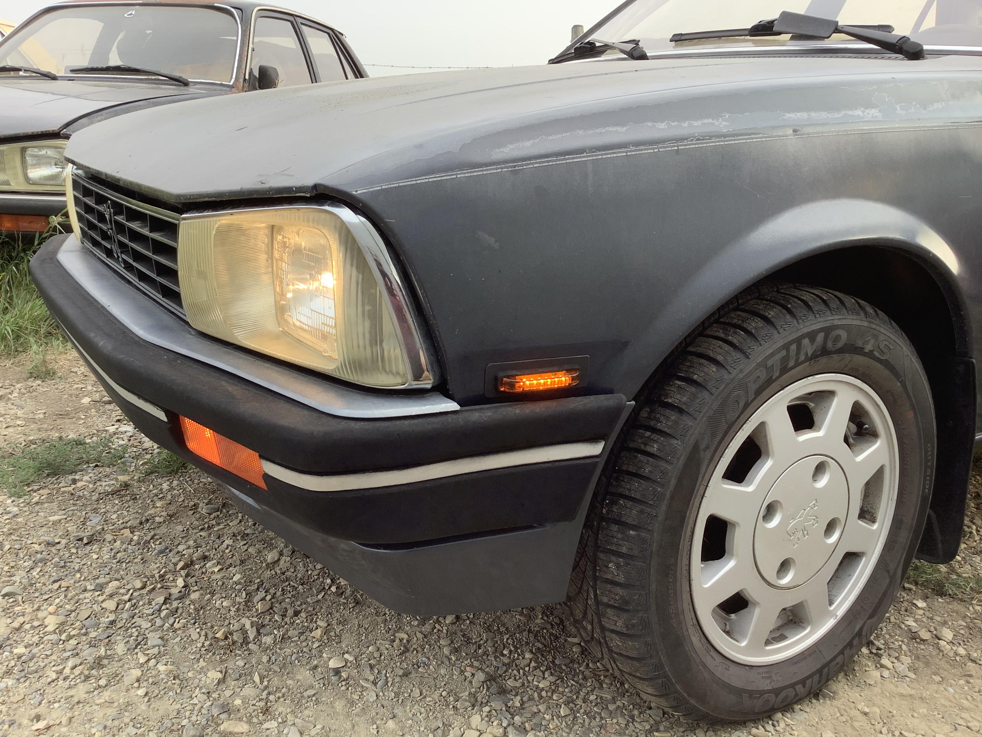

  15. Well, a few changes to the STI as of today. Chief among these was the fitting of an electric cooling fan, which was cheerfully donated by one of my parts cars - in this case, a Renault Sportwagon 2.2. The Renault fans move plenty of air, and they use a wire frame with no shroud, which makes the installation easy and clean-looking. I’ve used them before, and always been happy with the results. While I had the front end apart, I fitted a 505 Turbo air dam and I tucked the front bumper. While not quite as tidy as the Euro bumpers or the 1989 NA ones, I still think it looks pretty damn good now. A set of low-profile driving lights will be fitted shortly and I’ll find some way to make the top bar on the air dam sit parallel to the lower edge of the bumper. This piece always seems to sag, and it bothers me. The front marker lights were removed, along with the side moulding that carries them. I bought low-profile LED units to replace them, which will look much cleaner. But I ran out of time to fit them today, so I put black Gorilla tape over the holes for the moment. In a few days I’ll finish the job properly. Inside, I fitted a Renault Fuego steering wheel and a new shift knob. The latter nicely matches the stalks for the manual side mirrors, which is a nice touch. I like details like that. I painted the centre portion of the wheel and its hub, and I oiled the leather wrap as well as the shift boot. I’ll use leather paint on the wheel later and restore its black colour properly. On the back end, I used black rocker guard to paint the plastic piece that mounts the licence plate and fills the gap between the taillights. And speaking of taillights, after a monumental struggle I managed to get all the lights to work...mostly. I believe there is a special place in Hell for the guy who designed those taillights. I’ll devise a longer-term fix in the near future, but for now at least I won’t get pulled over for THAT item. Overall, a very good day! More to come soon.
