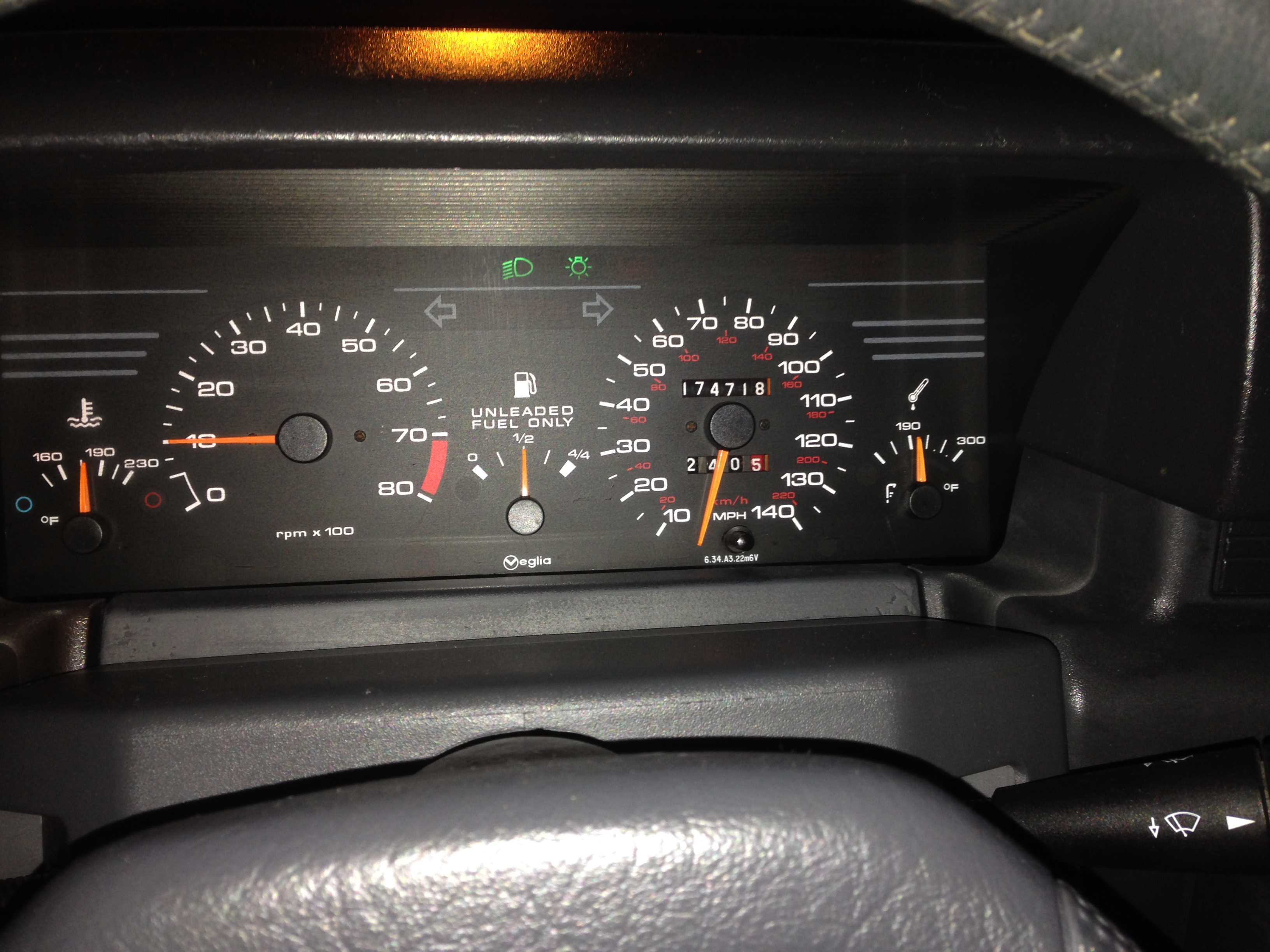

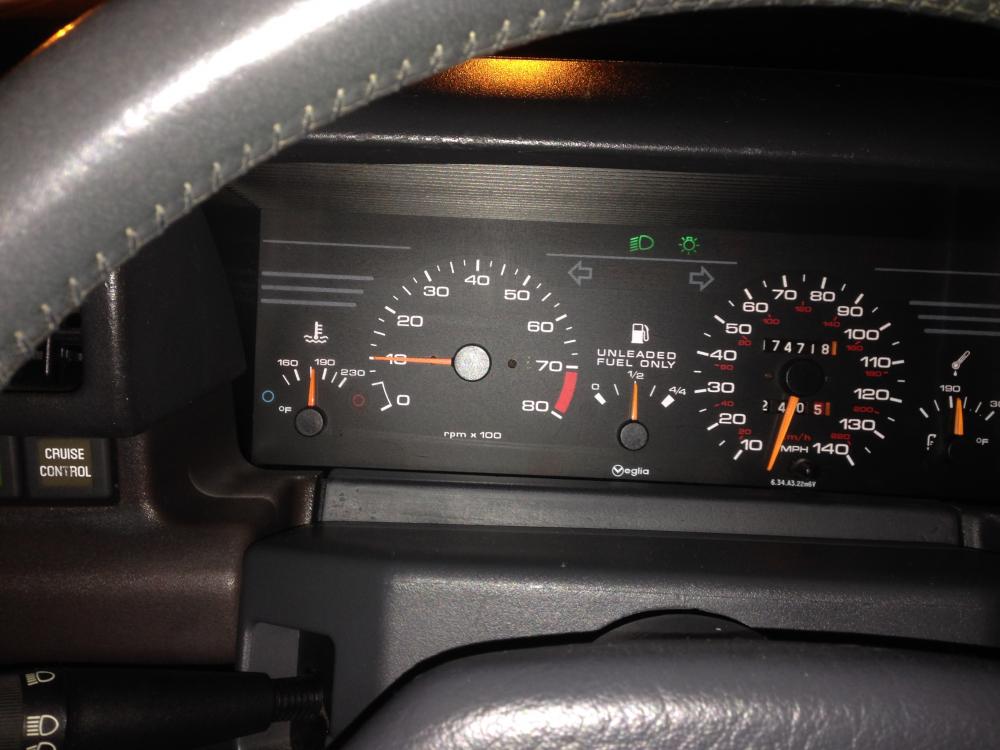

91MR2 Posted September 15, 2020 Author Report Posted September 15, 2020 Took the car for a long ride tonight, probably about 80 miles. Ran fantastic, and the oil temp. held steady at about 205-210 pretty much the entire ride. The outside temp. was a bit cooler, around 60 degrees, and was cruising mostly in 5th around 65-70 mph, with the occasional downshift and accelerating up through the revs. Posted some photos of the gauges on the way home. Coolant was around 175 the entire ride, started creeping up as I was idling to take the photos, oil was again pretty much right in the middle between 190 and the next dash (assumed to be around 228), so around 210ish... Quote

Mike T Posted September 16, 2020 Report Posted September 16, 2020 The oil sprayers to the underside of the pistons assure very high oil temperatures. Quote
Bean Posted September 16, 2020 Report Posted September 16, 2020 I think your oil temps are fine - you're running a decent synthetic and it's running under 300F - I confirmed with multiple sites referencing 220-240F being optimal for oil temps as that's when the oil has it's best characteristics and the least amount of parasitic loss. Over 240F is still safe to 300 - they just advise that extended temp intervals shorten the life of the oil. Initially I thought the car was reading incorrectly, but now it's probably best that it's not! Still worthwhile knowing what temps you are hitting for sure, but it's likely by design. Fun fact: I was curious why my BMW had no temp gauges or anything - turns out BMW didn't want people to see how hot the car was running by design! It has an electronic water pump and tstat so it's constantly varying temp for whatever is ideal for the conditions of the car is experiencing. If they had a gauge / readout people would freak out over the wildly varying temps as well as how hot they actually ran the engine sometimes. Rabin Quote

91MR2 Posted September 16, 2020 Author Report Posted September 16, 2020 18 hours ago, Bean said: I think your oil temps are fine - you're running a decent synthetic and it's running under 300F - I confirmed with multiple sites referencing 220-240F being optimal for oil temps as that's when the oil has it's best characteristics and the least amount of parasitic loss. Over 240F is still safe to 300 - they just advise that extended temp intervals shorten the life of the oil. Initially I thought the car was reading incorrectly, but now it's probably best that it's not! Still worthwhile knowing what temps you are hitting for sure, but it's likely by design. Fun fact: I was curious why my BMW had no temp gauges or anything - turns out BMW didn't want people to see how hot the car was running by design! It has an electronic water pump and tstat so it's constantly varying temp for whatever is ideal for the conditions of the car is experiencing. If they had a gauge / readout people would freak out over the wildly varying temps as well as how hot they actually ran the engine sometimes. Rabin Rabin, good info., I found the same regarding safe (and even preferred) oil temperatures. I'm chalking my more recently higher temps. to it being summer, until I can get a hold of an infrared thermometer (stopped at harbor freight again today, still out of them). Going to take another long drive tonight. And you're right re. car companies not putting these gauges in anymore, as it would def. wig out the average driver...well, if they bothered to pay any attention to them in the first place... Quote
91MR2 Posted September 17, 2020 Author Report Posted September 17, 2020 Took another long drive last yesterday, oil temps. were a little higher this time, closer to the dash after 190 (assumed to be around 228) prob. running around 220ish for the duration of the drive. Higher than the other night, but again still a "good" temperature to run at... Quote
