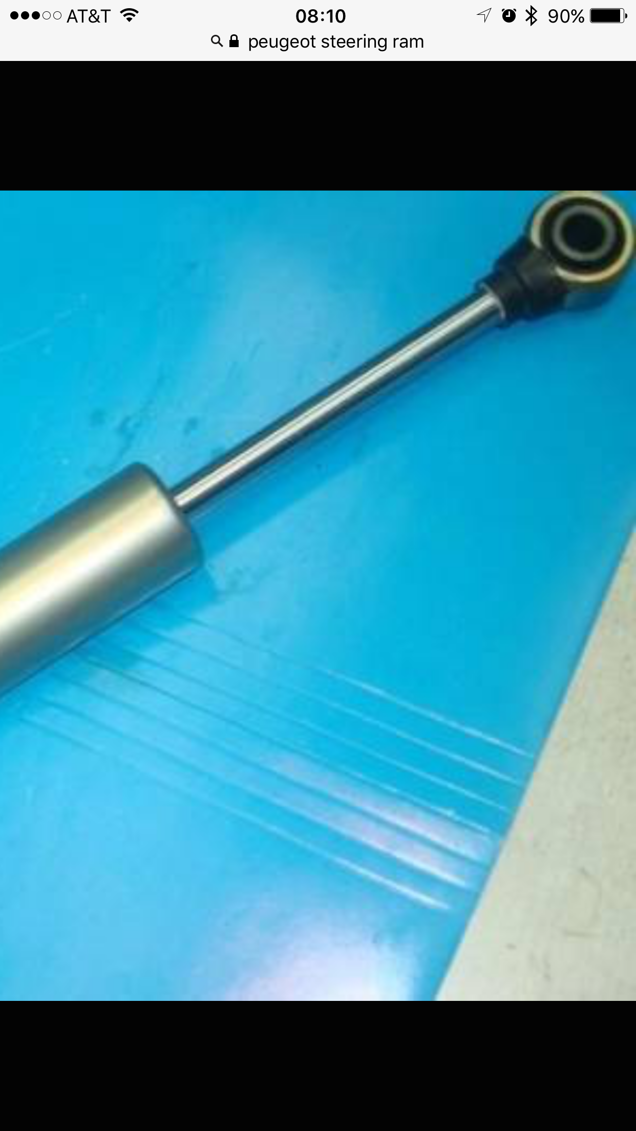

my3AWDgst Posted September 19, 2017 Report Posted September 19, 2017 Does any of you know if anyone is making power steering ram bushing? This bushing failed on my wagon and steering ram is still good it's not leaking at all. Thanks Quote
Bean Posted September 19, 2017 Report Posted September 19, 2017 Might be possible to get one machined up out of bronze if you can get the old one out.... Rabin Quote
my3AWDgst Posted September 19, 2017 Author Report Posted September 19, 2017 Old one is not existing any more,I'd prefer polyurethane but that's a long shot. Looking for easy replacement,unfortunately I'm short on time now days. Quote
Bean Posted September 19, 2017 Report Posted September 19, 2017 Sorry - I thought you meant the end bushing in the rack itself (they failed on my Volvo). Is this a mounting bushing? Rabin Quote
my3AWDgst Posted September 19, 2017 Author Report Posted September 19, 2017 Steering ram is mounted to steering rack just like on 505. Quote

Bean Posted September 19, 2017 Report Posted September 19, 2017 What about using 3M Window Urethane to build a new one. OR maybe seeing if you could press in a spherical / heim joint into the end? Rabin Quote
my3AWDgst Posted September 19, 2017 Author Report Posted September 19, 2017 9 hours ago, my3AWDgst said: Old one is not existing any more,I'd prefer polyurethane but that's a long shot. Looking for easy replacement,unfortunately I'm short on time now days. ^^^ that Rabin. Jürgen has two in stock so this will do for now. Quote
Bean Posted September 20, 2017 Report Posted September 20, 2017 3M Window Urethane is comparible to 90 durometer polyurethane, and if done well is quite robust. Sure I wouldn't want to do it in situ - but it's dead simple and it costs ~$20 for a tube. Proper replacement is way better of course - I was just spit balling if you needed it asap. Rabin Quote
