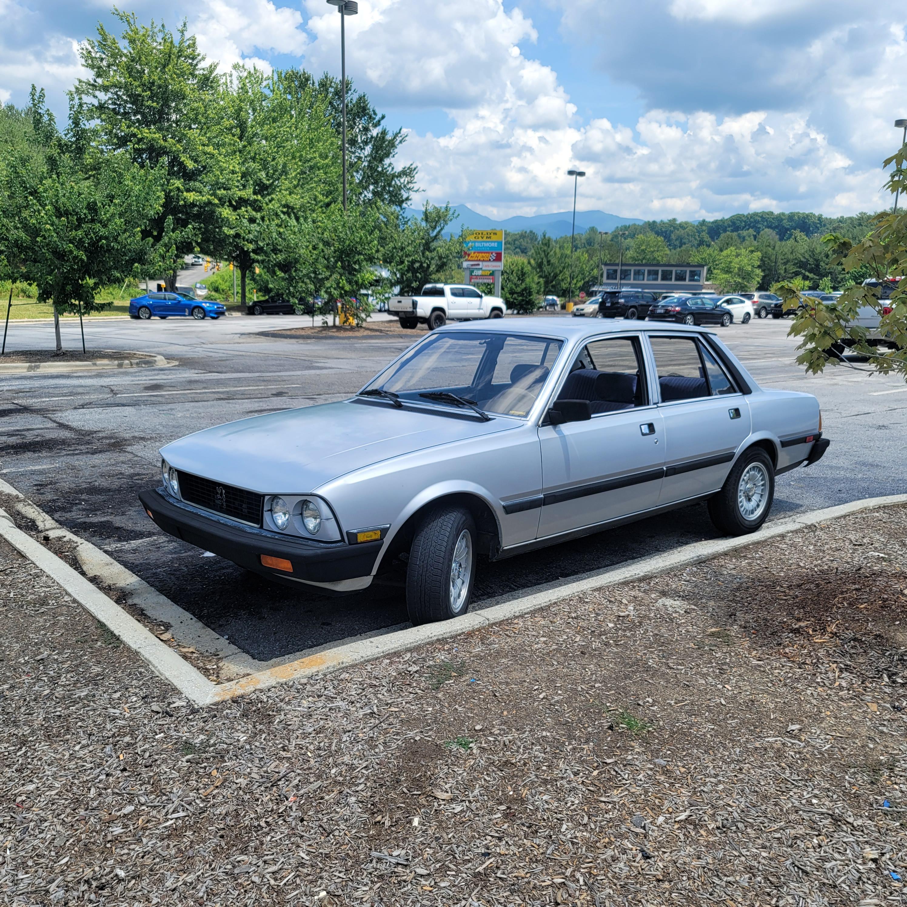

LBC28730 Posted June 27, 2022 Report Posted June 27, 2022 Hello everyone. I am so very excited to be days away from bringing home my first French car: 1 owner, locally purchased, 1981 505 Turbo diesel with 87k miles. I randomly came across this example in Asheville, NC, and it was originally purchased here when the dealership still existed. It comes with all the original paperwork and it appears everything works properly and I could not be more excited. I know the 505 in general is pretty hard to come by, and I wondered if anyone had resources as to how many were actually imported into the US? I look forward to learning so much more and hope to be able to contribute to the forum in the future, as well. Quote
Bean Posted June 27, 2022 Report Posted June 27, 2022 Congrats and welcome to the forum! Car looks to be in fantastic shape - Is it auto or manual? I love the early 505’s with the quad lights, inset grill, simple interior and the super comfy seats. Keep us posted on progress! Rabin Quote
