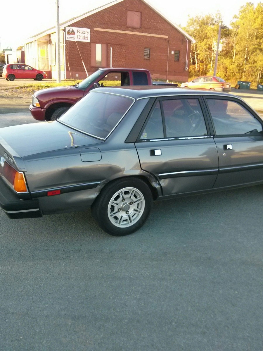

yhzman Posted October 10, 2016 Report Posted October 10, 2016 Hi All, after much time invested in traveling to the US and importing a 1986 505 Turbo 5 speed, I was hit in the rear door/quarter panel about 2 weeks after I got the car up to Canada! I've taken the car in to a local collision repair shop and waiting to hear back what the insurance company comes back with. Hopefully the valuation on the car is high enough that I can get it repaired without being out of pocket, but I'm not holding my breath. I posted pictures in the registry of what the car looked like before. Here is what it looks like now... I saw an '89 on bringatrailer.com that recently went for $6k US, I may be canvassing the board to see what their nice examples are appraised at should I need to contest the valuation I receive. Quote
Bean Posted October 10, 2016 Report Posted October 10, 2016 .Ouch! Sorry friend - but they will almost certainly deem it a total loss. Rear quarter, dog leg, and rear door is a large repair. You will need to focus on getting a good settlement so that you can replace the car. (You can always negotiate the car back and attempt repair via your own if you know someone, or as a parts car for the next one.) Dog leg and quarter panel will be toughest repair - but if it helps I can send you the body repair section from the factory service manual. Flip side is you do have a parts car that can donate the panels to repair (If it's rust free), but even still - finding a body guy good enough to do the repair and repaint will still be a costly endeavor unless you have some connections. Rabin Quote

Goce Posted October 10, 2016 Report Posted October 10, 2016 Sorry to hear that, as Been said be careful with the insurance company, try to get what you can. On a happier note the car is totally repairable, i've personally been in more than 20 accidents, i've crashed my cars way worst then this, at the end if you can get past the thought that it has been wrecked that is no difference it the way car drives, a good body shop can fix the original quarter panel and the trim is in good shape, for the door is easies to replace it , and the wheel arch is easy to be pull, in my country this will be 100 euro repair + door , don't lose hope after 4-5 accidents you just don't care, keep us inform. Quote
Bean Posted October 10, 2016 Report Posted October 10, 2016 Auto body repair in Canada is HUGELY expensive - especially when going through insurance. That repair would easily be $3500 - $5000 here in Saskatchewan. I also think it's totally repairable if you have the skills to do it yourself - or if you have the connections to have it done by friends. Quarter panel / dog leg replacement could likely be pulled, but personally I would pull the dents out, then replace the panel so there was little to no bondo needed. Funny enough - I will be doing essentially this exact repair on my 89. It was rear ended in its past and the trunk was pushed down and the passenger quarter panel was kinked. Idiot who 'repaired' it just cut out the kink, rivetted replacement metal in, and bondo'd it up. Proper fix will be to have trunk pulled out, then cut out and replace quarter panel as per service manual. Rabin Quote
