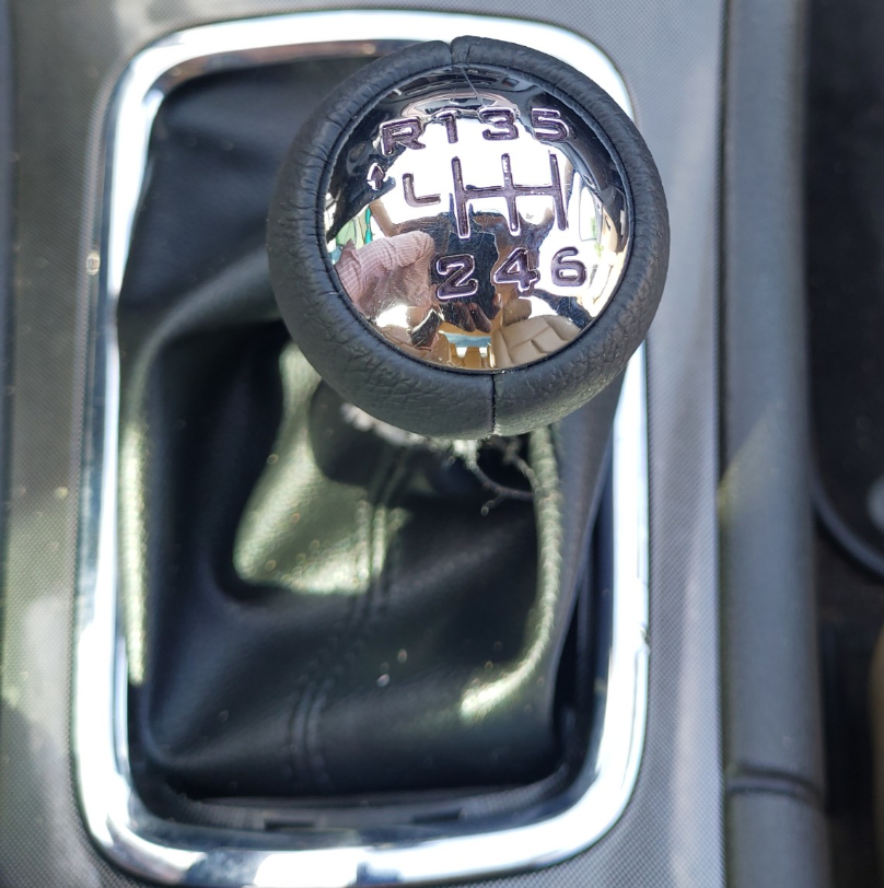

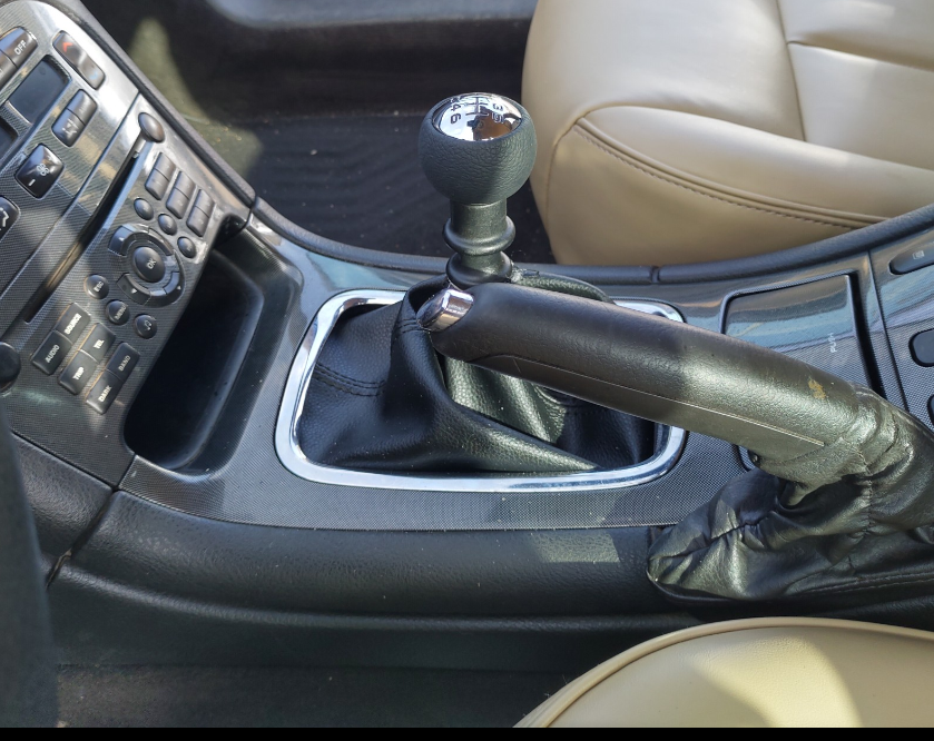

Ikenna Posted June 26, 2020 Report Posted June 26, 2020 *ABOUT THE SUCCESSFUL CONVERSION PROJECT OF MY PEUGEOT 607 V6 PHASE II (Z9) FROM AM6 AUTOMATIC TO MANUAL TRANSMISSION.* The project of the new born maniac started on 08/01/2019 and ended on 30/05/2020 (17 months). A tough excited project, considering every part of the vehicle system was designed to work with just Automatic transmission (AM6). It appeared no one else has done this Conversion before I did (since I couldn't find any online yet). There could be though, for I really want to hear from those that have done it too and their experiences. I originally set out to convert with 6-speed Manual gearbox, but decided to go for 5-speed Manual, since my excitement couldn't keep me waiting for 6-speed Manual box that was taking too long to locate. However, I needed to do the conversion to work with both 5-speed & 6-speed Stick-shift, Incase the 6-speed turns up in future. For that, I had to study or researched on parts for such conversion to be a reality. To successfully do the conversion to turn out the way I want, my findings led to parts from about 3 different Peugeot models. A tough challenge and exciting one too. Almost everyone I told about the project said the project will destroy the car, except one or two men that were excited when when I told him about the project, in our usual private chats/discussions, that reside outside Nigeria. I never listened or gave a rip about public opinion anyway. If I wanted something that has nothing to do with anyone else, it's done. It's a question of when, as long as the financial and physical strengths are there. 30/05/2020 was the day I cranked the engine and it roared into life with the Stick-shift box for the first time. The drive that followed after was unforgettable. The car now move like a different car: less weight, quicker, less fuel consumption and most importantly, *PREDICTABLE* , just like my other Stick-shift V6 lions. Words cannot describe the fun part of the drive. I get to now play with the pedals, while I watch the 3.0i ES9A 290 Nm torque surge the car forward like a maniac he has become. Thanks to the brand new Valeo clutch kit and Total Manual Transmission Fluid Gear 8 75w-80. Even with the complex electrical system of the car, wired to work only with Automatic Gearbox, I did the Electrical part of the conversion so well that the car now work as if it originally had manual transmission from new. No warning sign on the instrument panel. The ABS, ESP, Variable steering, variable suspension, engine cooling fan, instrument panel, Multifunction display, etc, everything works the same way before the conversion took place the previous week (yet to make out time to reconnect the parking Aid though). I now have a perfect Z9 V6, exactly how I wanted it from the beginning. The AM6 6-speed Automatic Gearbox was still running like new at 77,000 km mileage before I removed it, but wasn't part of my dream Z9 V6. As new and good as the AM6 gearbox is, it's not for Lion King - Monk. It denied me self Expression Behind the Wheel I couldn't ignore or live with. What about the original intention of 6-speed Stick-shift box? Few days of driving the lion with the 5-speed Stick-shift has been so exciting that I no longer care if I see or don't see the 6-speed box. But I am still looking out for one. I can't wait to conclude other projects on my other lions as well. So many good things in this physical life for men to choose and enjoy. I mean, if you find life so boring or uninteresting, get rid of your car and get a fun one, for you can only find yourself in that frequency/condition when you surround yourself with boring things. Or at least, do something about it. Just yesterday, I took the new maniac for another drive, applied some skills on the pedals and gear lever and found myself screaming *YEEHAW!* I drove back home and closed the celebration with a bottle of 1759. I mean, I beat my chest, pointed to the car and said *I DID THAT!* (boastfully). One of the best part of masculinity which I am proud of. Ikenna351, Lion King - Monk. Quote

SRDT Posted June 27, 2020 Report Posted June 27, 2020 Really nice. If you are using a ML5C gearbox the 6 speed swap shouldn't be too hard. I remember that a guy did the first 6 speed V6 swap when Peugeot just started using the ML5C on the V6 and the ML6C on the 2.2 petrol engine. It was on a 406 V6 with a ML5T so he ordered the ML5C V6 bellhousing, found a used ML6C, ML6C shifter and made a custom clutch disc. Quote
Ikenna Posted June 27, 2020 Author Report Posted June 27, 2020 5 hours ago, SRDT said: Really nice. If you are using a ML5C gearbox the 6 speed swap shouldn't be too hard. I remember that a guy did the first 6 speed V6 swap when Peugeot just started using the ML5C on the V6 and the ML6C on the 2.2 petrol engine. It was on a 406 V6 with a ML5T so he ordered the ML5C V6 bellhousing, found a used ML6C, ML6C shifter and made a custom clutch disc. Yes, you are right. That's why I opted for the V6 ML5C gearbox and it's accessories which is not as common and easily available like the ML5T in Nigeria. So that whenever I get the V6 ML6C, the gearbox swap will be easy and cheaper, without replacing any other parts other than the gearbox. Ikenna351, Lion King - Monk. Quote
Ikenna Posted June 27, 2020 Author Report Posted June 27, 2020 7 hours ago, SRDT said: Really nice. If you are using a ML5C gearbox the 6 speed swap shouldn't be too hard. I remember that a guy did the first 6 speed V6 swap when Peugeot just started using the ML5C on the V6 and the ML6C on the 2.2 petrol engine. It was on a 406 V6 with a ML5T so he ordered the ML5C V6 bellhousing, found a used ML6C, ML6C shifter and made a custom clutch disc. Just to clarify. You meant the used ML6C gearbox the guy used for the 6speed V6 Conversion the 2.2i ML6C, apart from the ML5C bellhousing? The custom clutch will be a challenge for me, I think. I can easily source for used V6 ML5C bellhousing and 2.2i ML6C complete gearbox. 407 V6 Coupé have a 6-speed manual Gearbox (ML6C). Hopefully I will get one. Ikenna351, Lion King - Monk. Quote
