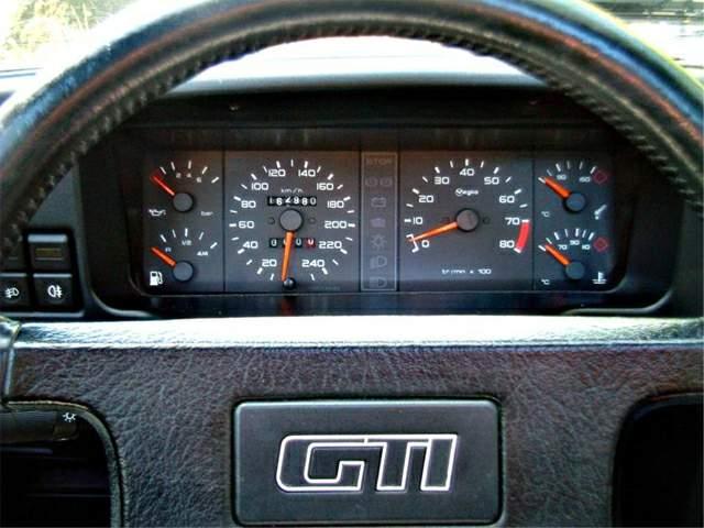

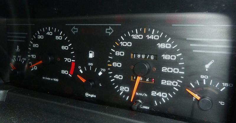

91MR2 Posted August 14, 2020 Author Report Posted August 14, 2020 3 hours ago, SRDT said: It's a 20°C increment: 90°C (194°F), 110°C (230°F), 130°C (266°F) and 150°C (302°F): Thanks for the information, numbers are similar to what I assumed with the conversion equivalency. What temperature does your car run at? Is it consistent with what I described in my post? Quote

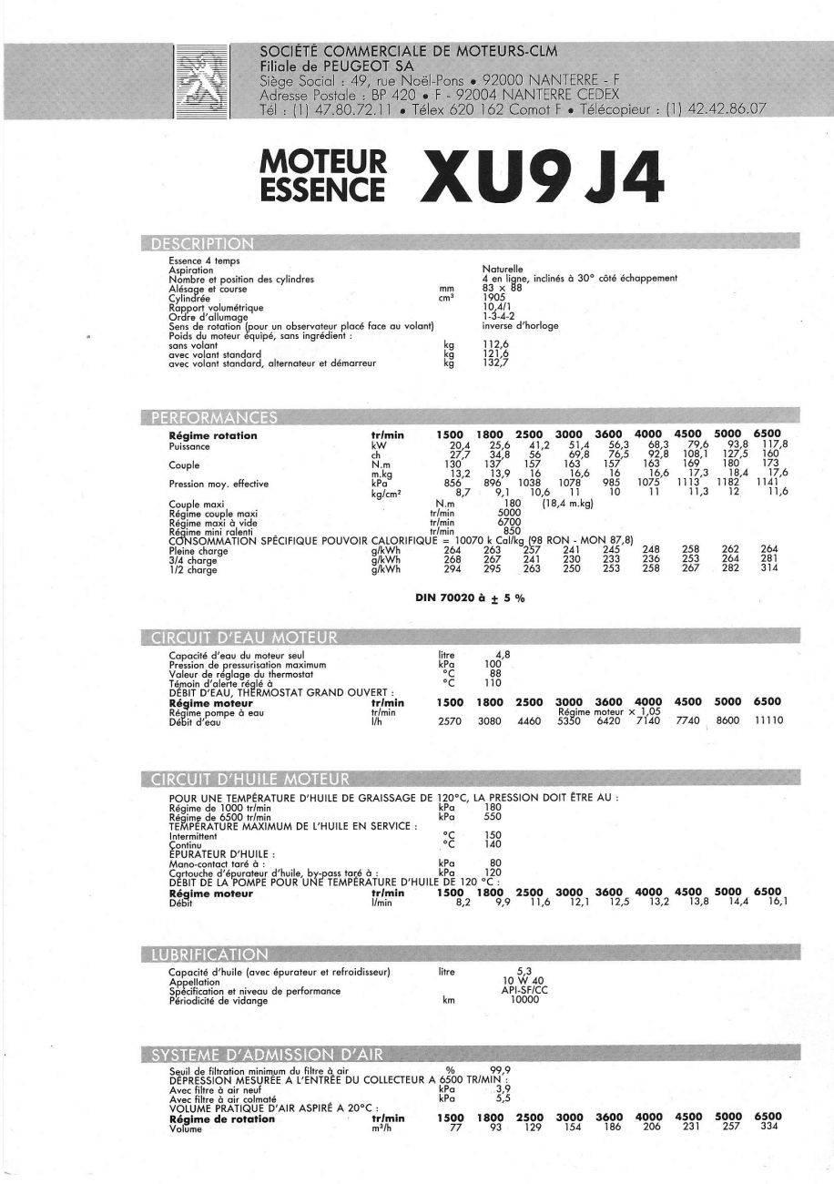

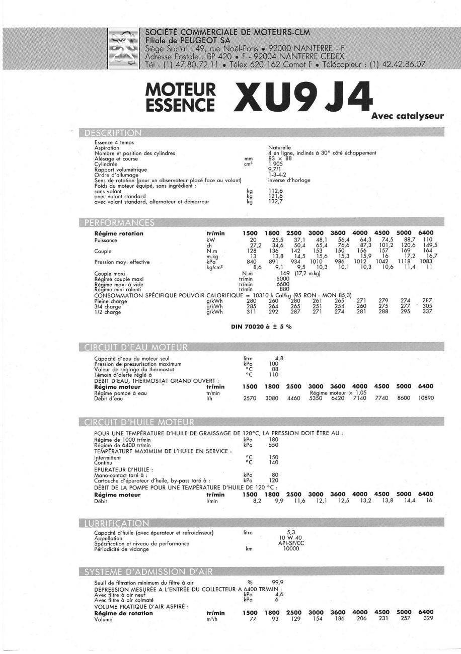

SRDT Posted August 14, 2020 Report Posted August 14, 2020 (edited) My car isn't a 405, I have the same water/oil heat exchanger but the coolant system isn't the same and mine looks like it was moded to run a bit cooler. As for max oil temp according to Peugeot at the time it should be 140°C if continuous and 150°C for short peaks. Pressure and flow values are indicated for a 10W40 oil at 120°C. Edited August 14, 2020 by SRDT Quote
Goce Posted August 14, 2020 Report Posted August 14, 2020 My Mi16x4 was at that temp 95 - 100 degrees C (200-230 F) i've gotten it very hot 150 C once or twice, racing up hill the engine has no problem it can cope with the heat. If you are doing lots of high rpm driving then keep your eye on the temp otherwise don't worry about it. External oil cooler is the solution to keep the temps down but on a street car with factory power there is no need. Quote

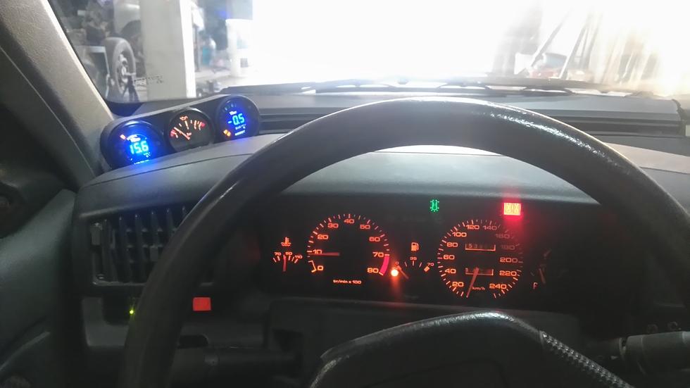

SRDT Posted August 15, 2020 Report Posted August 15, 2020 Speaking of gauges the 405 cluster lacks the oil pressure, there is one on the 309 and on this car you better look at it if you're driving it hard. Quote
Goce Posted August 15, 2020 Report Posted August 15, 2020 Peugeot, did installed oil pressure sender, but is not connected to anything, when i did my RWD conversion i installed a gauge. Quote
SRDT Posted August 15, 2020 Report Posted August 15, 2020 The BX instrument cluster had oil pressure and even oil level before starting the engine, because of that every engine had the sensors no matter the car. Quote
Goce Posted August 15, 2020 Report Posted August 15, 2020 Now you mention it, the 405 mi16 have oil level, is the same oil temp gauge, before starting the engine, not many know about it. Quote

SRDT Posted August 26, 2020 Report Posted August 26, 2020 For me a temp over 230°F isn't a problem, the tiny dot before 300°F should be 140°C so as long as you don't go beyond that the engine can run all day with no damage ; and that's with the oil they had 30 years ago. Quote

91MR2 Posted September 2, 2020 Author Report Posted September 2, 2020 Also, worth mentioning, the oil temperature gauge hit around 240F on the way home. Going to try and get a hold of a thermal camera, per Rabin's advice, going to see if these temperatures are to be believed...if true, going to look into an oil cooler set up... Quote
SRDT Posted September 2, 2020 Report Posted September 2, 2020 If you can find a bigger heat exchanger that's the easiest way, but then again 240°F is lower than 140°C (284°F) so it's still a safe temp. Quote
