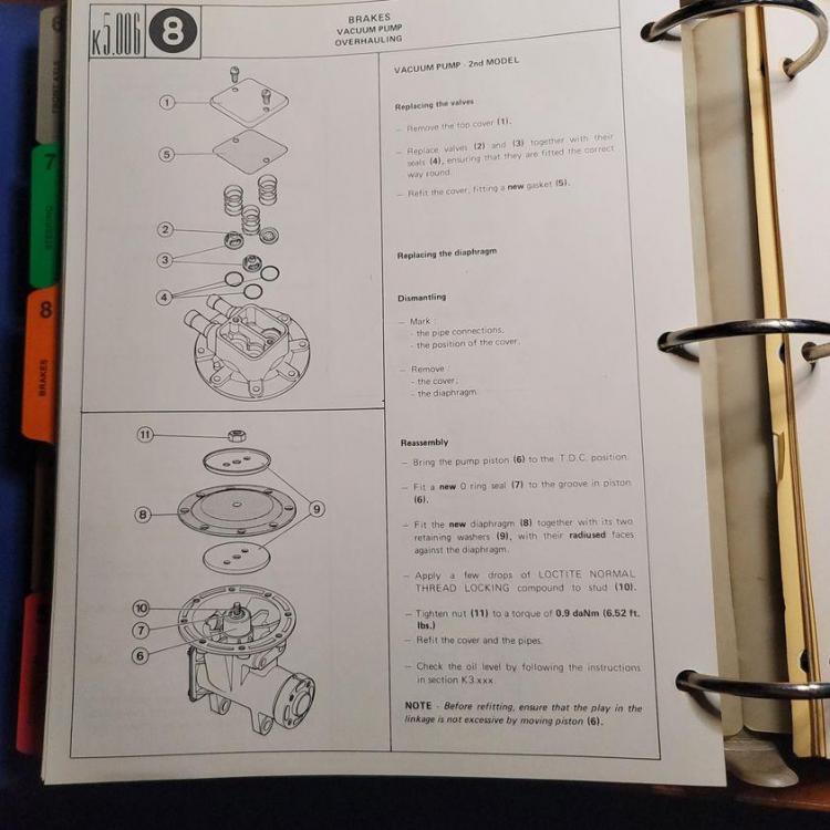

LBC28730 Posted July 25, 2022 Report Posted July 25, 2022 Brakes were really stiff as if booster wasn't functioning. By the process recommended in the factory service manual, the first step was testing the vacuum pump and it failed, even after being topped off with oil. Although I am not having much luck finding exactly the proper parts by Peugeot reference, I have come across a diaphragm that looks like it would be perfect. This diaphragm is a "Febi 2442" and is typically listed for Mercedes of the same year range. Has anyone else had experience with rebuilding this? I have also found some valves for the upper section (Febi 8491) and for not much money, I think I'll give those a try. Thanks for any input. Quote

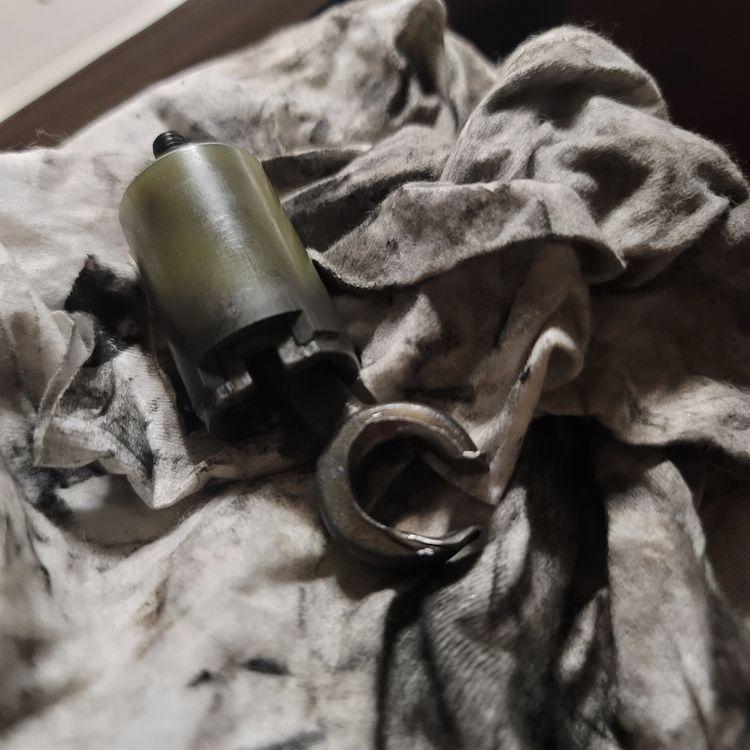

LBC28730 Posted July 25, 2022 Author Report Posted July 25, 2022 Well scratch that. Valves and diaphragm look great but I definitely found the issue. Anywhere I can find one of these pump pistons?? Quote
LBC28730 Posted July 25, 2022 Author Report Posted July 25, 2022 Well, piston will do no good, the lower section is damaged as well. Just ordered an electric vacuum pump and I'm going to see if I can sort that application out. I'll update if I have any success. Quote
