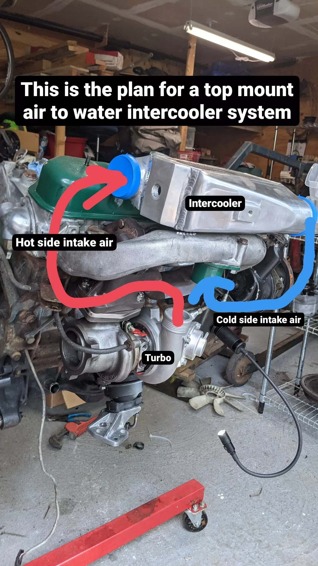

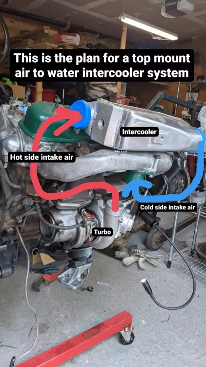

wadehilts Posted March 31, 2021 Author Report Posted March 31, 2021 Update on my scheming: https://www.frozenboost.com/air_water-ic/small-liquid_air-intercooler-p-210.html I found this water to air intercooler. It's 11x9x3.5" in size, which is quite compact - I bet I could squeeze that in if I take out the air filter!. It says it's rated up to 450 CFM / 350 HP. I ran the XD3T stats thru a CFM calculator that gave me about 420 CFM max for the 2498 cc with a volumetric efficiency of 2.0. Another rule of thumb is to multiply the HP by 2.5. If I do that I get 375 CFM. So it looks like this intercooler would be big enough for the XD3T with 15 psi of boost and making 150 HP. Happy to hear if anyone else has opinions or thoughts on that. As far as heat exchangers go, their standard option for theĀ intercooler I'm looking at is a 19 row 10.75x11x2" radiator. I'm wondering if I could maybe get away with their next size smaller which is a 13 row 7.5x11.5x2 or even the next size down 10 row 5.75x11.5x2 - which would fit very nicely under the bumper at that size! Quote
wadehilts Posted March 31, 2021 Author Report Posted March 31, 2021 OK! After some more measuring I think I found the solution that FrozenBoost would formally approve of: I can mount the heat exchanger they offer specifically for the water to air intercooler that is a 30-row, 10x13x2 radiator right in front of the radiator on the drivers side. If I remove the old 12" A/C fan and replace it with a 10", that would give me plenty of room. Then its just a matter of shoe-horning the intercooler in anywhere, which I have plenty of space to make that happen and routing the intake hoses. I think we've got a winner. Quote

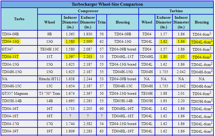

wadehilts Posted May 6, 2021 Author Report Posted May 6, 2021 OK I kept doing my research on upgrading the turbo and learned a bit on how to read turbo flow charts.Ā For the 2498 cc XD3T, I assume a max rpm of 4150 (shop manual's max power rpm) and a VE of about 2.1 to correspond to 16 psi. That lands me at an absolute max of 384 CFM of airflow (which by the 2.5 rule, corresponds to 154 HP - sounds about right). It will most likely be a good amount less than this due to inefficiencies in the intake/exhaust but I'll call it a good upper limit. Looking at compressor charts for the vd04hl-13G and 13T, it looks like both turbos would probably work. The 13G taps out at around 365 CFM and the 13T more comfortably hits 400. I think I'll probably just go with the 13T so I have a little wiggle room and am not getting close to any limits that may result in smoke. It should still spool nice and fast too which is something I definitely want, while also leaving room for hitting that 150 hp / 280 ft lb target handily. Quote

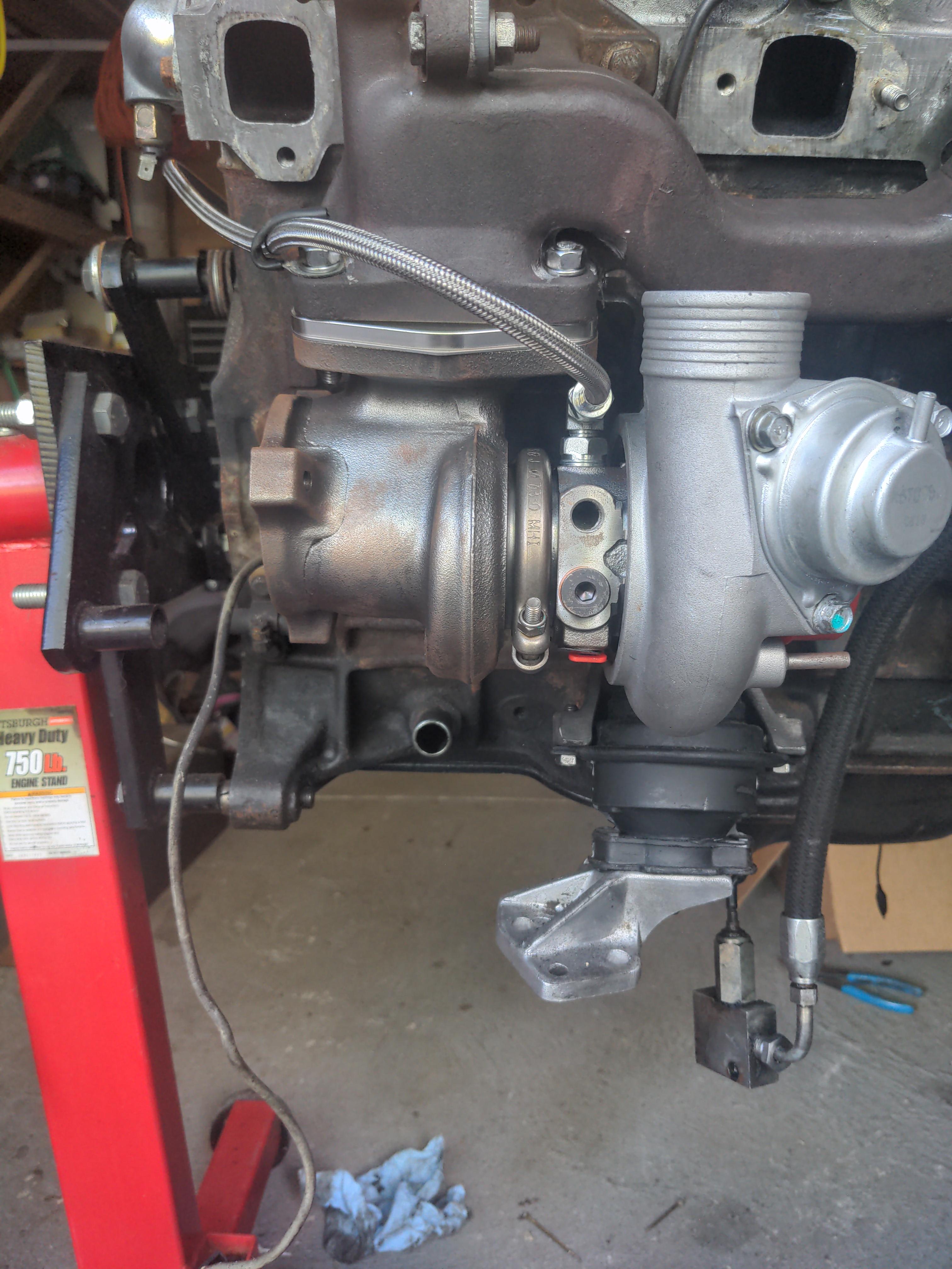

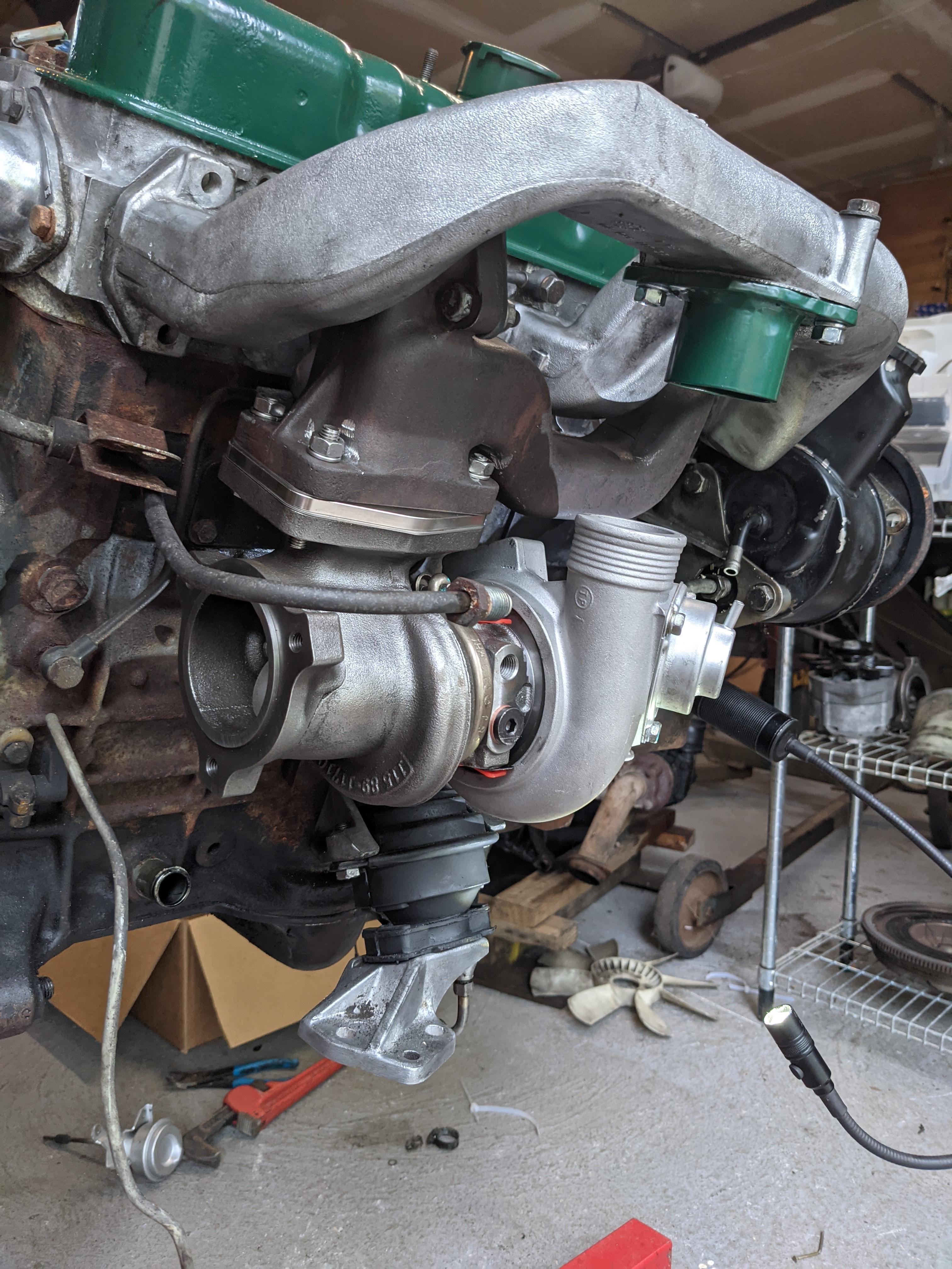

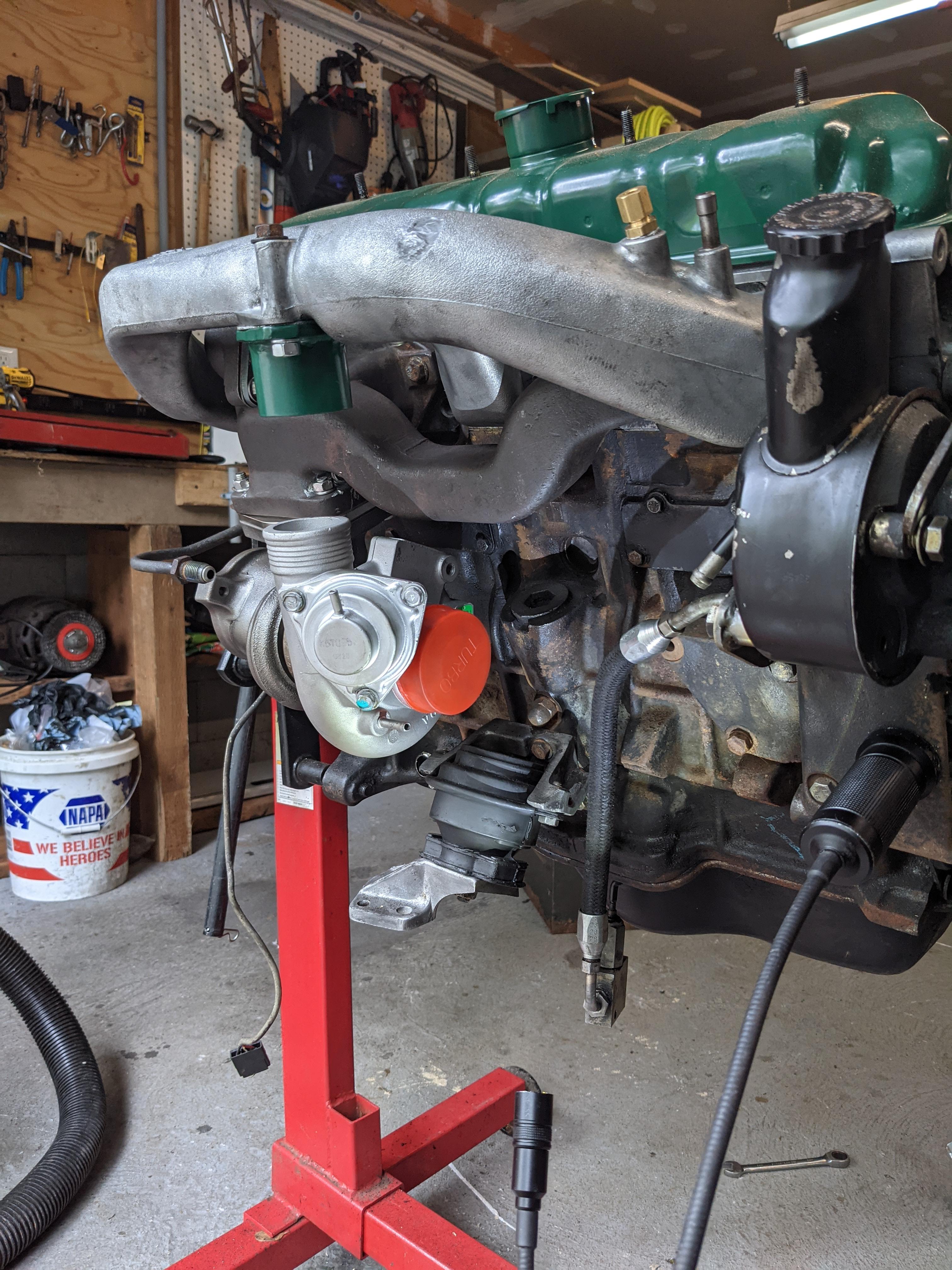

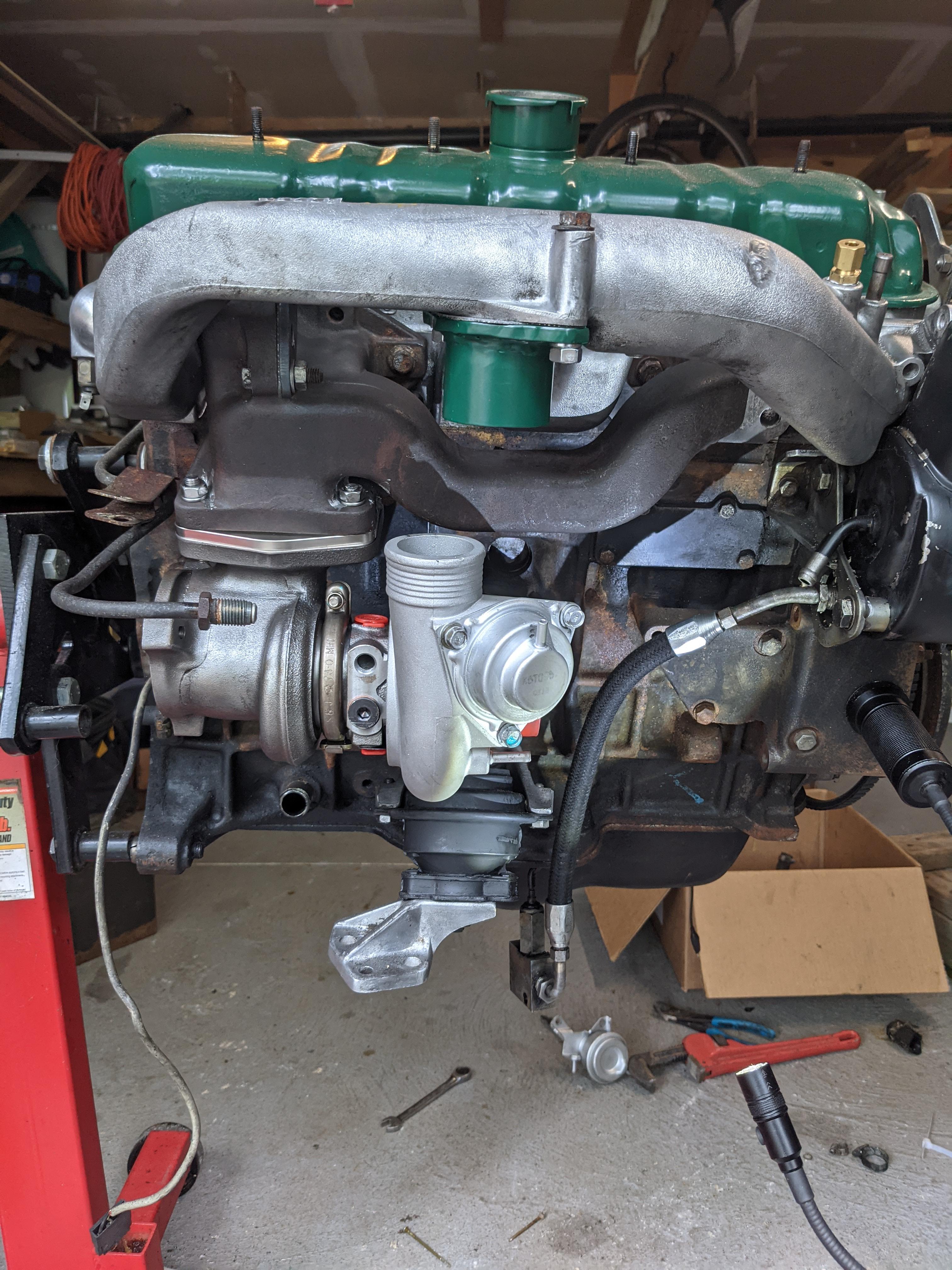

wadehilts Posted August 9, 2021 Author Report Posted August 9, 2021 Hey all, Build update! Big thanks to @Beanfor giving me tons of advice and informing much of my decisions in this build! I've settled on my project plans, and hope I can get 160 hp / 290 ftlbs out of this XD3T. Here's what I've done/am doing: Having Giles rebuild VE pump from an XD2S (they have a 10 mm pump head, where XD3T pumps had a 9 mm) to support 20 psi of boost. Putting in a Volvo TD04HL-13T, with an 11 blade billet wheel. I was able to use a T3 to Volvo adaptor plate for the exhaust housing. I also had to use the straight flange from a different TD04 to get things to fit better. I used the frozen boost air to water intercooler and plan to mount it above in the intake manifold (see pictures). Here are some pics of my progress so far! Still waiting on the VE pump to be finished. Rabin, as you've seen on the facebook threads, there has been some concerns raised about the BA10/5 getting lunched by nearly 300 ftlbs of torque. Hugh Logie seemed to recall that the rated torque for the BA10/5 was only 220 ftlbs. Although I do know that the 4.0L Jeep straight sixes put out 224 ftlbs in 1988 and they were in front of a BA10/5. I am probably going to be the guinea pig on this at the end of the day. I was considering doing EBC too but currently don't have that set up. Quote
SRDT Posted August 9, 2021 Report Posted August 9, 2021 It's not only about the pump head diameter, you should also check the cam plate lift. If the engine output isĀ roughly the same then the big head pump probably has a smaller cam. Quote
wadehilts Posted August 9, 2021 Author Report Posted August 9, 2021 Ah that's good to know. I sent Giles pictures and information about each pump. I think he does a lot of internal modifications, but I'm not sure exactly what they are. His recommendation was that I go with the XD2S pump but he was aware that the XD2S engine was smaller displacement and had less power output. Quote
Bean Posted August 10, 2021 Report Posted August 10, 2021 Piston diameter: Ā From my research the 9mm pump was from manual cars, and the 10mm pump was from automatic cars. Ā You can see the difference in the plates in my stock pump compared to the AAZ cam plate that was used in my pump. Ā 10mm pump is totally the way to go if you have one. BA10/5 torque: Ā My research had the torque limit of the BA10/5 at the 300-350 ft*lbs range, and oddly enough the BA10/4 is supposed to be stronger yet according to Thanos who built some amazing 504 V6 historic rally cars. Ā Key to it living will be power delivery, but the tires will also be a fuse of sorts so the tires will spin before the trans blows. Ā The case deflection theory is due to the gear profile - the comparisons to the super production cars isnāt quite accurate as I understood those cars used straight cut gears which donāt exert the same separation loads that taper cut teeth can under load. Intercooler: Ā Iād strongly recommend mounting the cooler vertically beside the engine, clock the turbo compressor housing so the exit is horizontal and run it into the bottom, the exit out the top can route into the intake. Ā Iād also consider having the intake modified so the inlet is pointing horizontally as well. Ā Biggest reason is since itās liquid cooled youāll never get the IC completely full unless you have a tank thatās even higher which I doubt you can do with it mounted on top. Ā By mounting it vertically the IC will be easy to keep 100% full, easy to bleed, and it even keeps the weight down lower if you really want to squeeze out positives. Ā Secondary benefit will be much cleaner and shorter piping with fewer bends, which means less restrictions. turbo fasteners: Ā Make sure theyāre turbo spec fasteners as the heat they see will cause even metric 10.9 hardware to fatigue and loosen. Boost control: Ā AEM Tru Boost is a very sweet electronic boost controller that should work very well for managing / tuning boost levels. Ā I wouldnāt do a manual controller. Ā Alternatively I bet there is arduino code somewhere if you wanted to save some bucks and build a DIY controller. Ā Ā Looks amazing BTW! Ā Pretty stoked youāre able to put these ideas and plans into action! Ā Quote
wadehilts Posted August 10, 2021 Author Report Posted August 10, 2021 Hey @Beanthanks for your input! Some great advice. Some responses:Ā Piston Diameter: I did a fair bit of research on this and the VE pump part numbers show that XD2S were all 10 mm and XD3T were all 9mm (for the VE pumps at least). This is explicit in the part number. E.g.Ā VE4/10F2125R67-1 has the application code R67, and the -1 demonstrates automatic. Automatic Transmission models have a different cam speed, e.g. 2125, than the manuals - but pump head is the same. The manual and automatic XD2S have the same 10 in the part number for the piston head diameter.Ā BA10/5: good news there! hopefully I'll stay just below anything catastrophic Intercooler mounting: you're right about the bleeding. My current setup is going to be tricky at best. My problem is that with A/C and the 604 engine bay I don't have very much room to work down there. I think for now I'm gonna just have to wait until I can drop the engine back into the car to see how everything fits. Worst case, I may have to route my IC coolant hosing and everything such that the IC can be repositioned to bleed it upon install without cracking open the system. Gonna be a headache for sure.. Turbo fasteners: good call there! like an idiot I had used stainless. A little metallurgy research showed me that was a bad idea. Best I could do at the hardware store was 10.9. It's a bit of a pain because the T3 flange takes M10 bolts and the volvo takes m8, and they each require studs at the same spot. I went with M8s and used the M10 holes as pass thru holes but that definitely came with its own set of challenges and it was tricky to get everything assembled. Now that I'm less nervous about the BA10, I'm down to do boost control. Why not! I'll look into the product you recommended. I have a manual boost actuator kit that has variable spring sizes for different boost levels and well as actuator arm length. It is pretty tight back there so the OEM actuator was an impossible fit, especially after re-clocking the turbo. Wade Quote

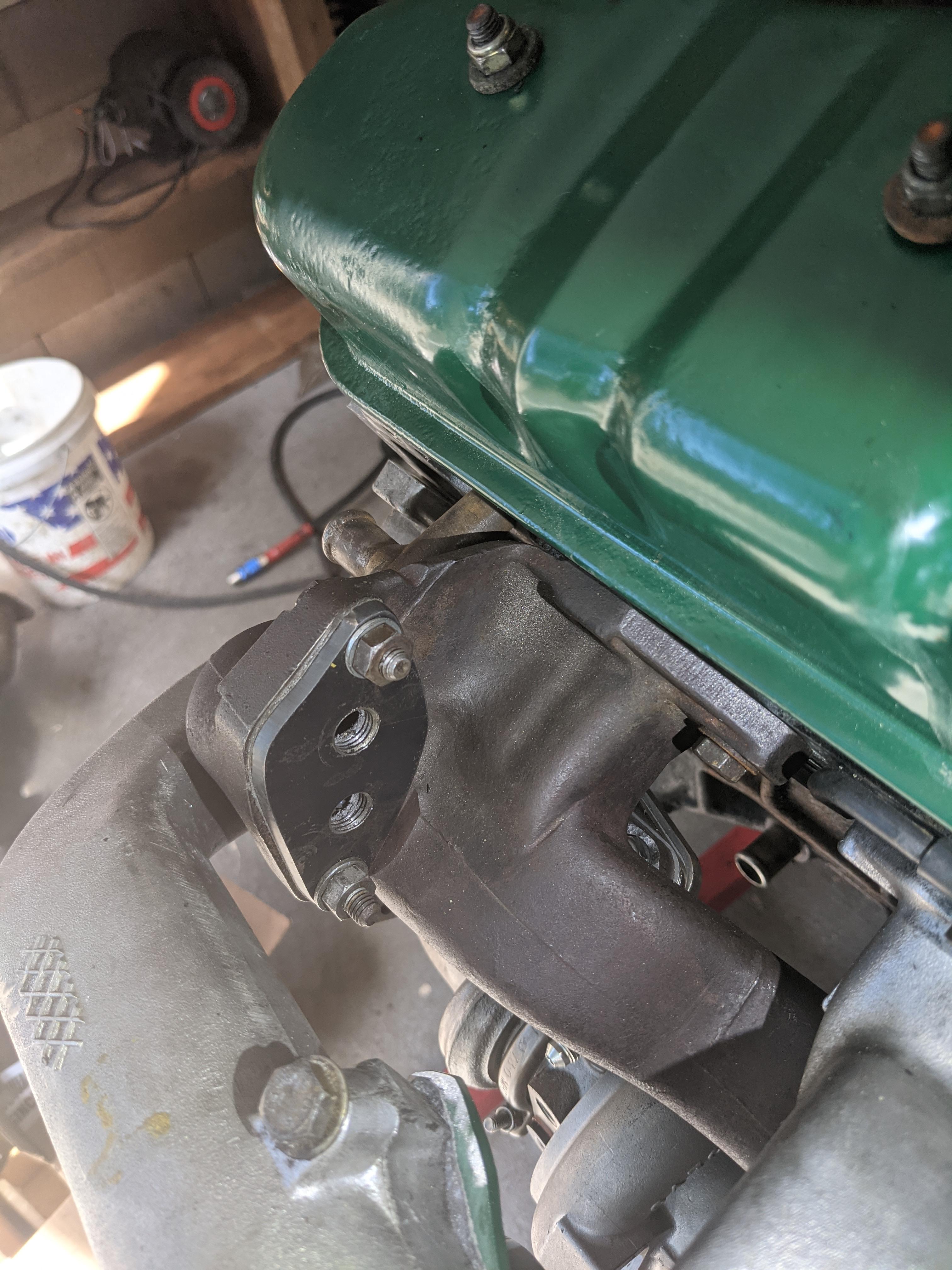

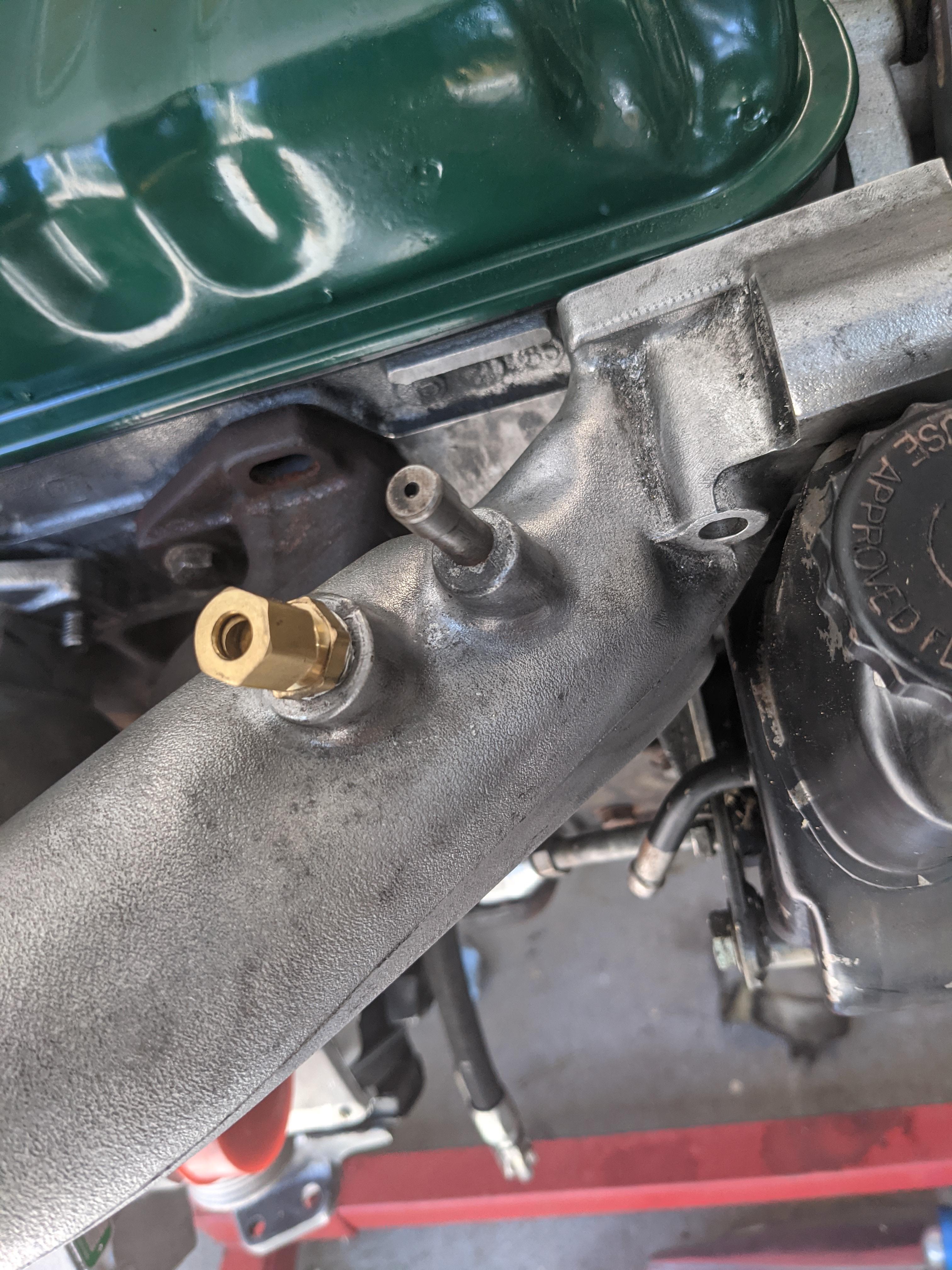

wadehilts Posted August 11, 2021 Author Report Posted August 11, 2021 I wanted to share another couple neat things I've done so far. I used the opportunity of my EGR block off plate to tap two 1/4" NPT fittings. I got some ISS pro gauges that will display EGT, Exhaust Back pressure, and turbo boost. Since I'm doing EBC, I'll have a redundant boost gauge that is also the boost controller. But I may hide that anyways.Ā My biggest technical concerns now are: How the hell do I time the pump? I will just have to go by ear? I'm using a XD2S pump with an XD3T engine. Worried about first start up going smoothly tbh Fitting the intercooler and plumbing in a spot that is easily bled / makes sense / works. Quote
