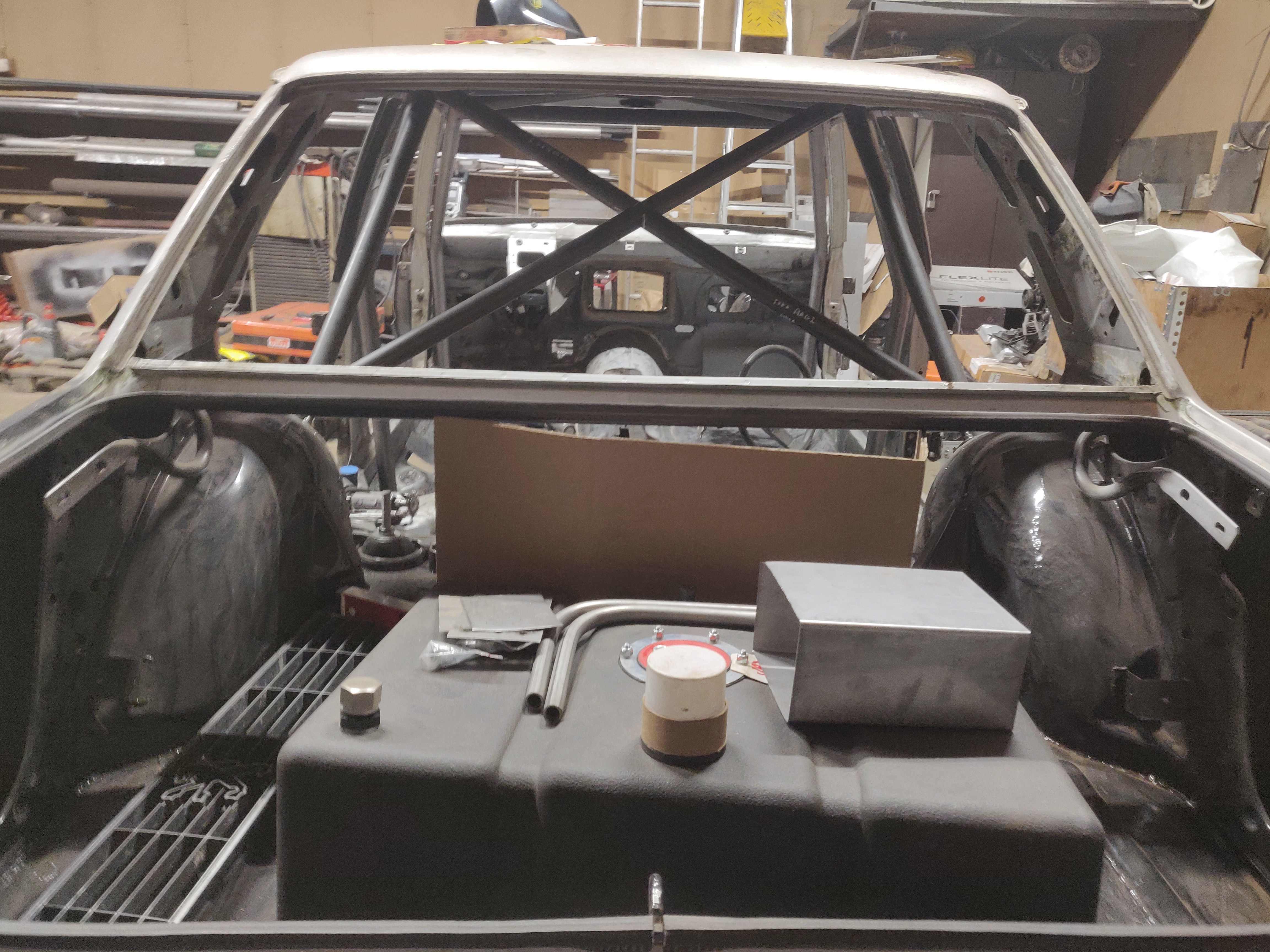

@Wales  Love the idea of moving the rear bulkhead back so the rear shocks mounts are accessible from inside.  Double check the rule book on the material allowable with a fuel cell inside the trunk, rules here would require the bulkhead between the cell and the passenger compartment to be metal, with most going with a bolt in sheet of aluminum that had some breaks for rigidity.
Interesting mods in the front wheel well for the side exit - is it exiting out in front / ahead of the passenger door?  That makes for a very short exhaust run - assume this would make it not road legal then?  Or will it turn and go back along the side?
You are right. The rules for motorsport do require the rear bulkhead to be "un-burning". I was thinking to make 2 sets of the bulkhead panels, one set made from carbon fiber and one set made of aluminium and attach them with bolts or pop rivets to the aluminium frame.

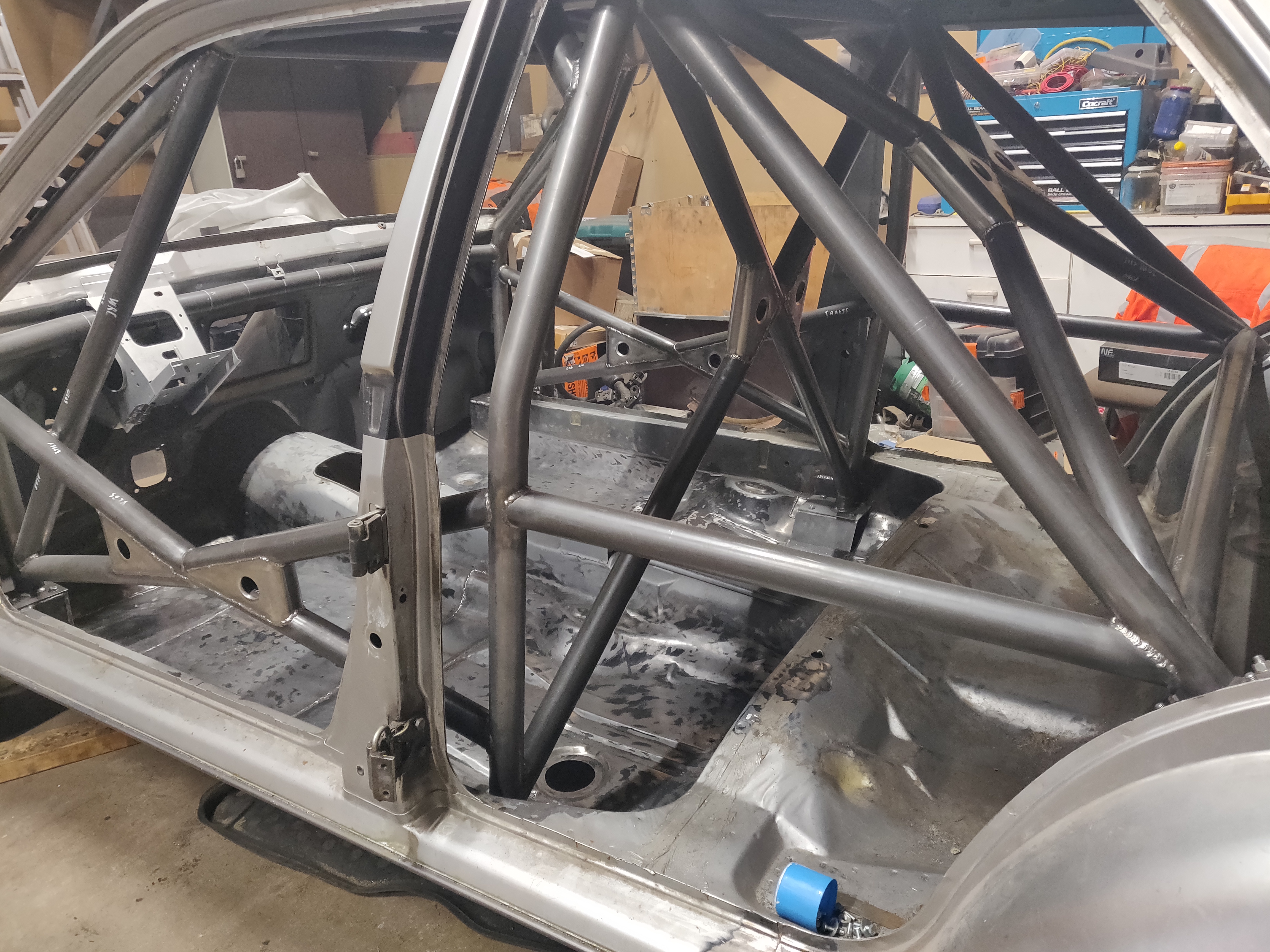

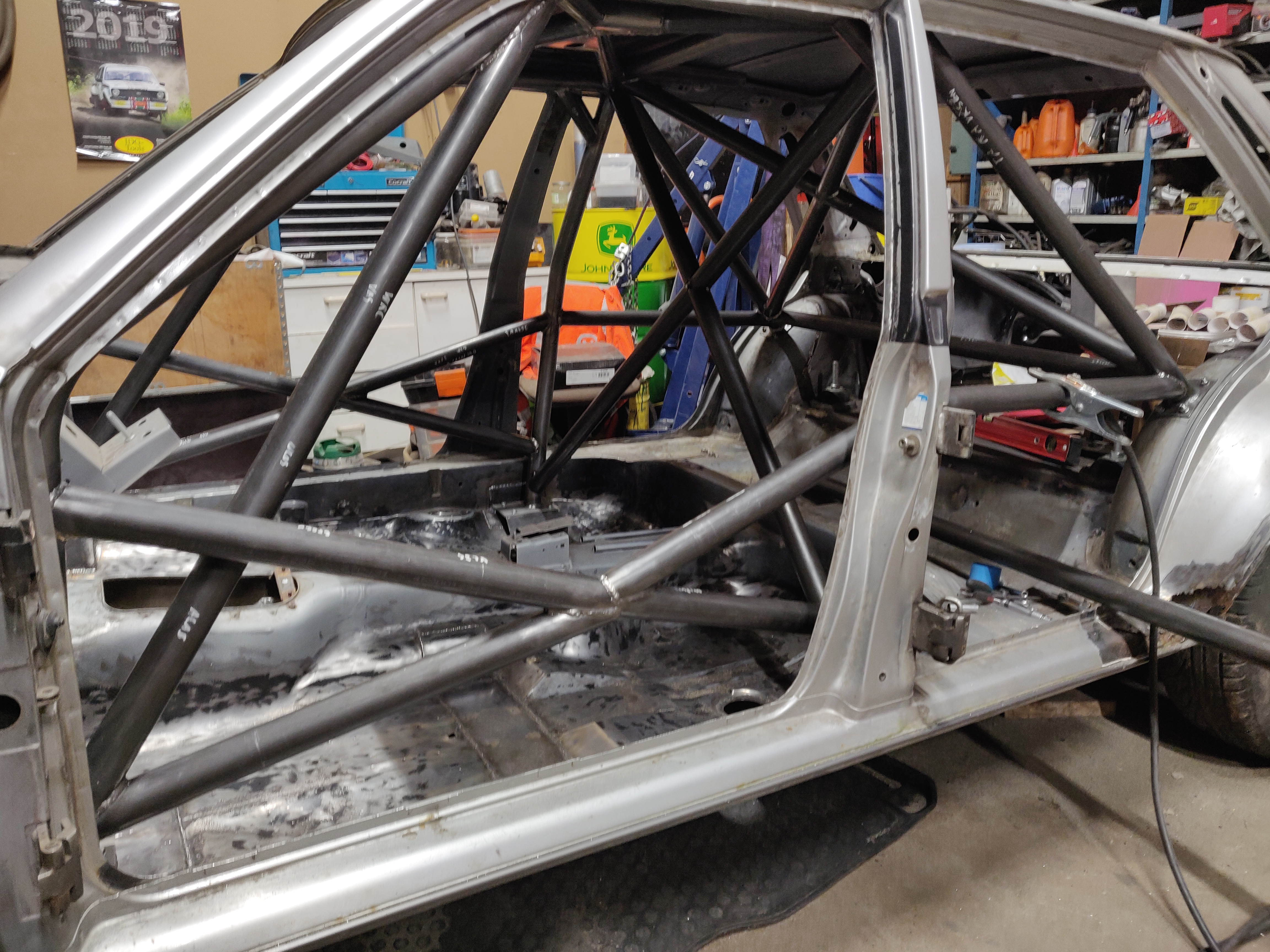

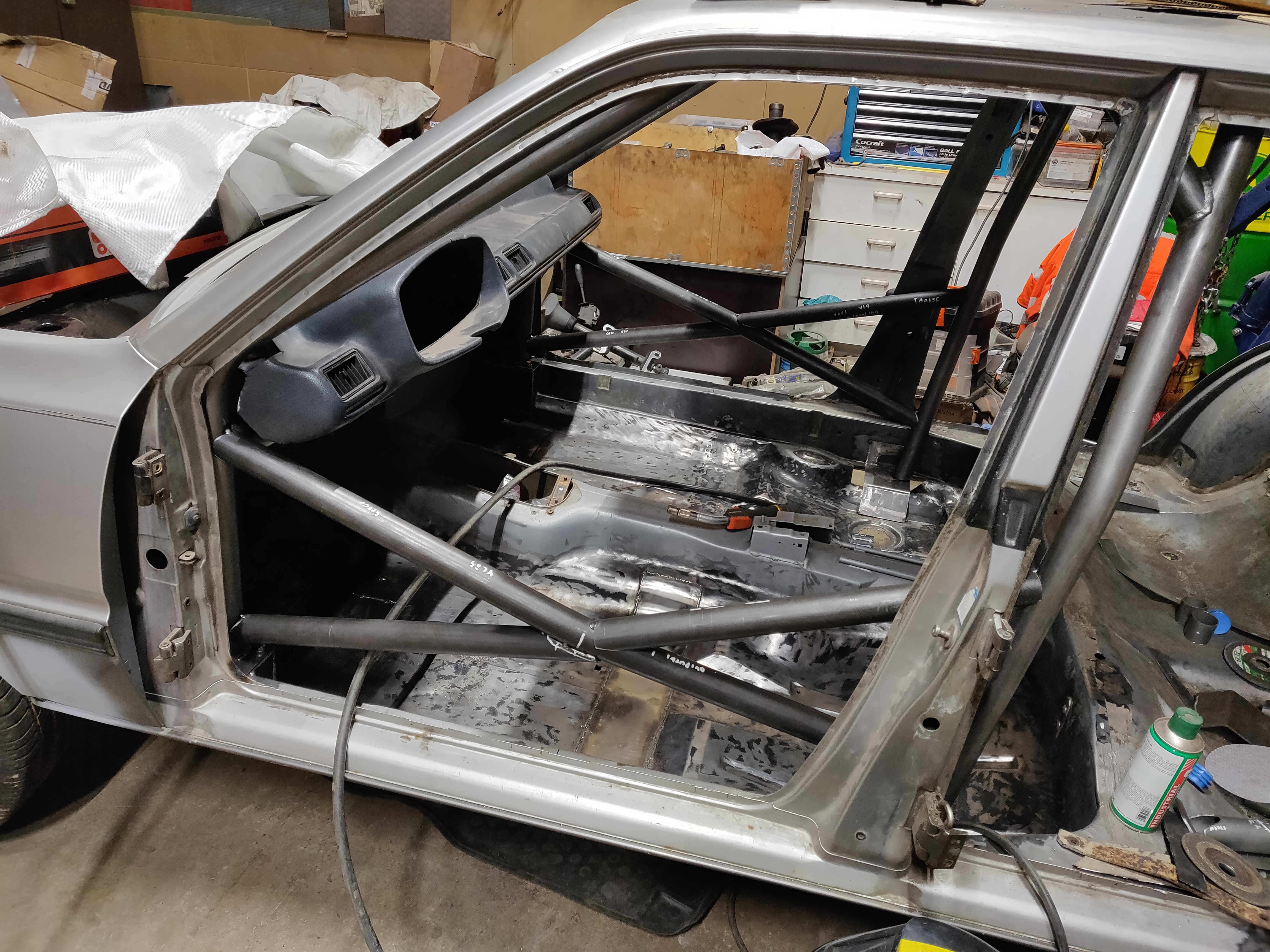

Quick update about the rollcage.
I ended up welding it with MIG as it is much faster and I think it looks good enough for now.
The roof fortification:

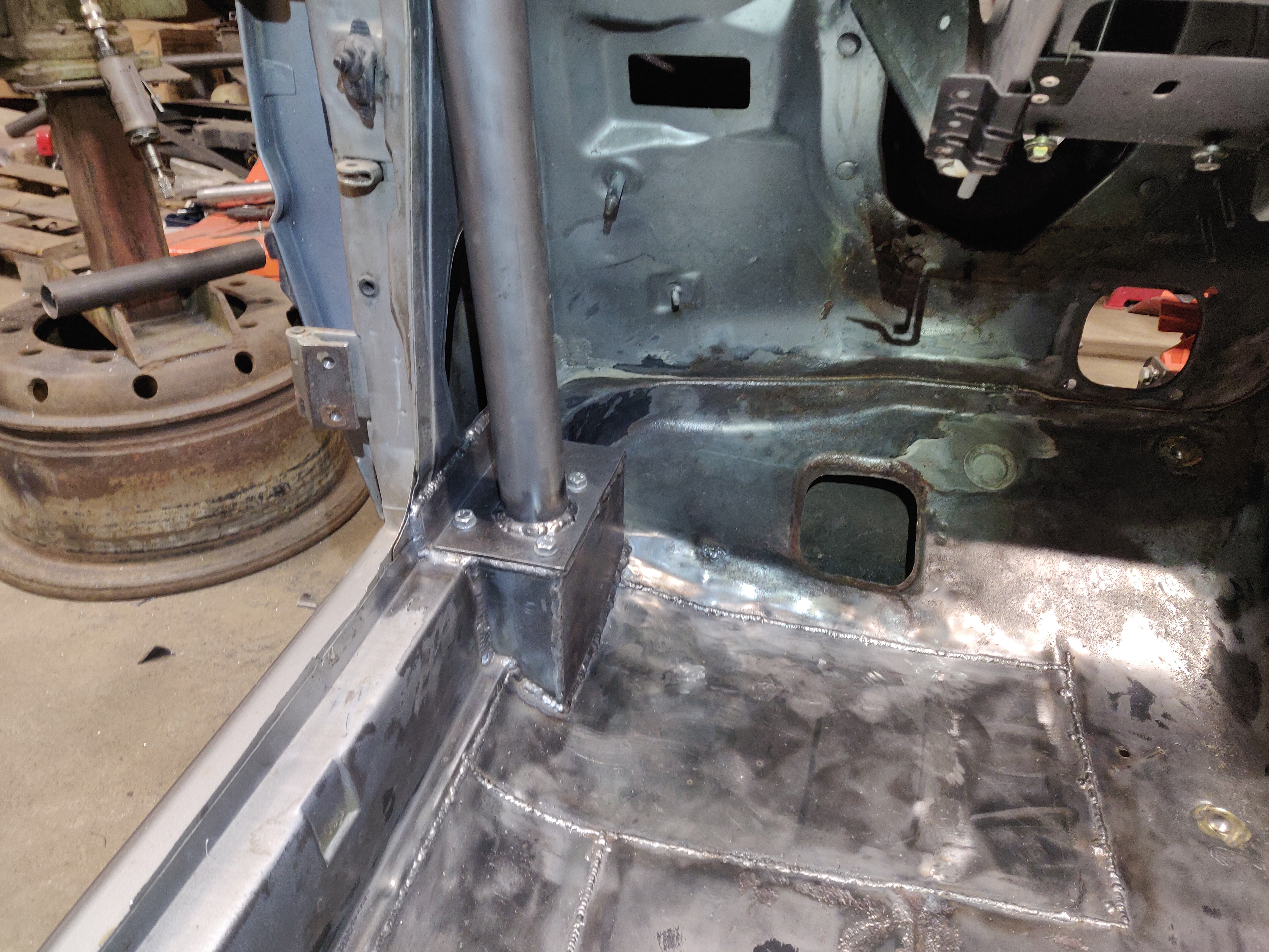

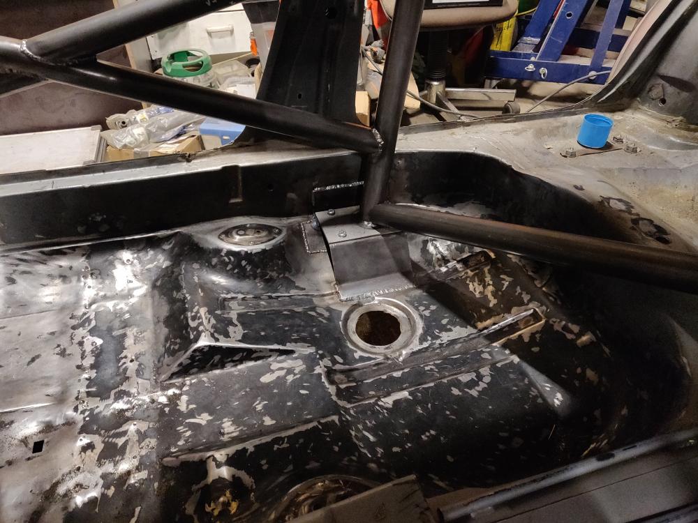

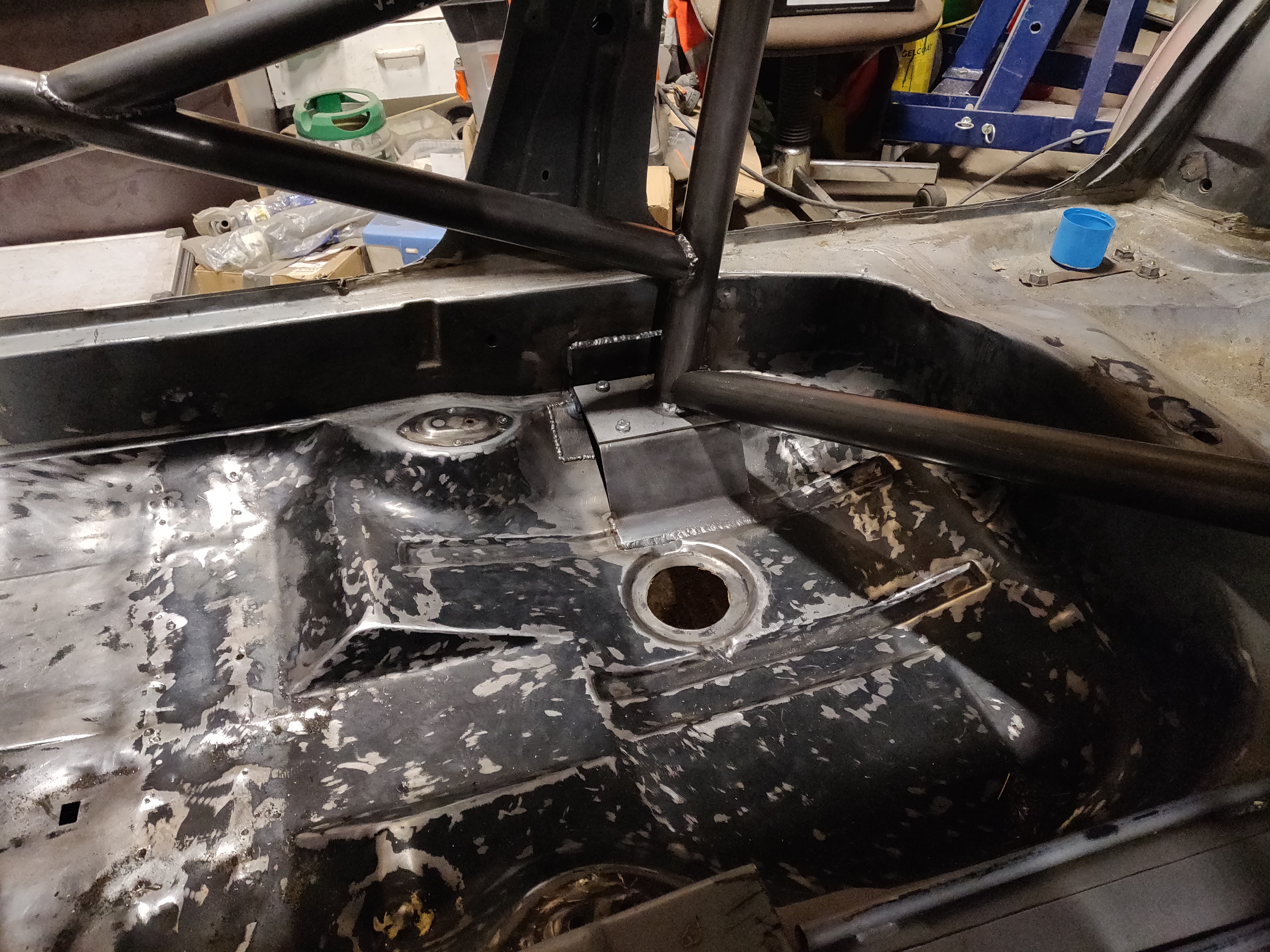

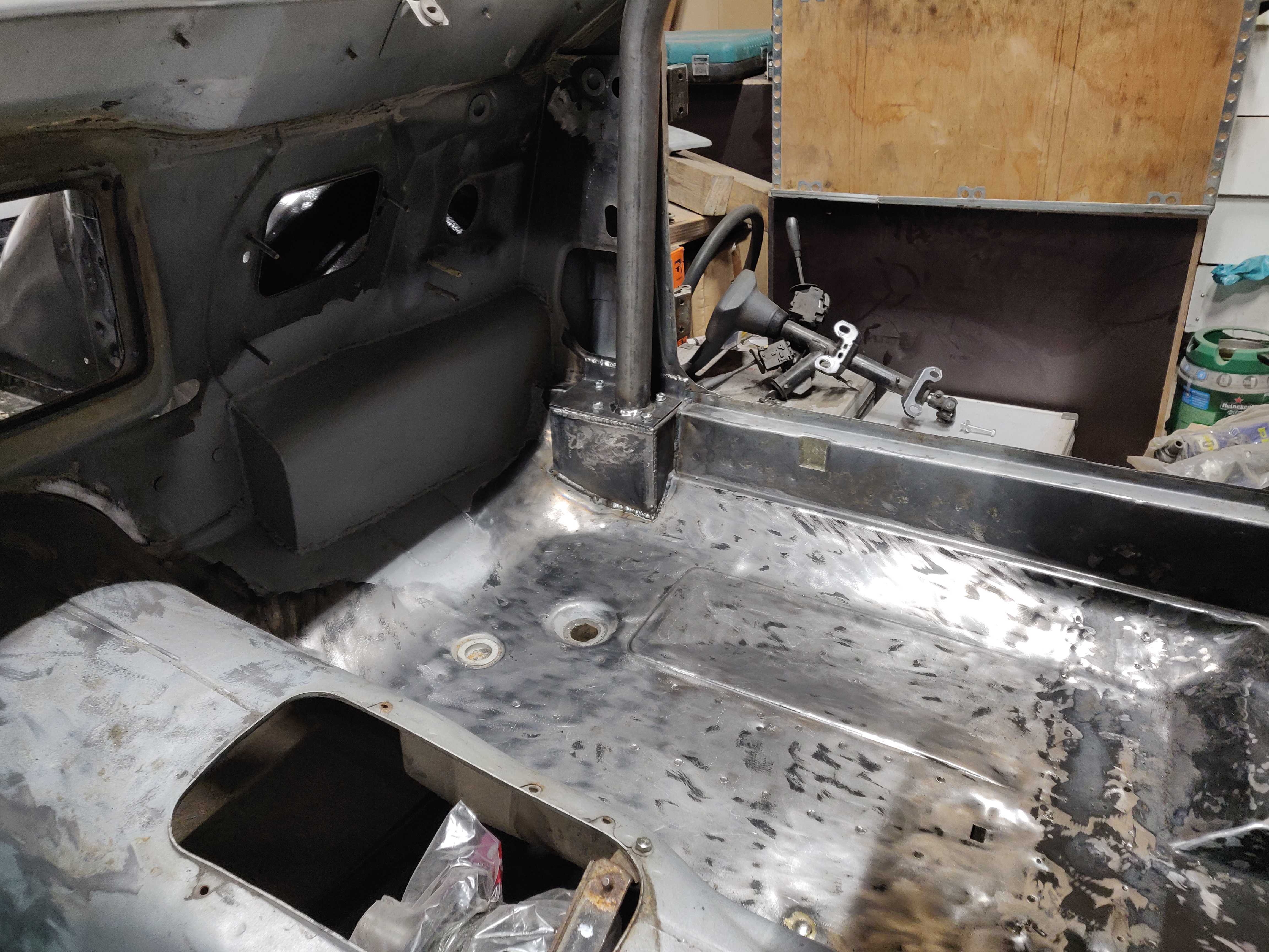

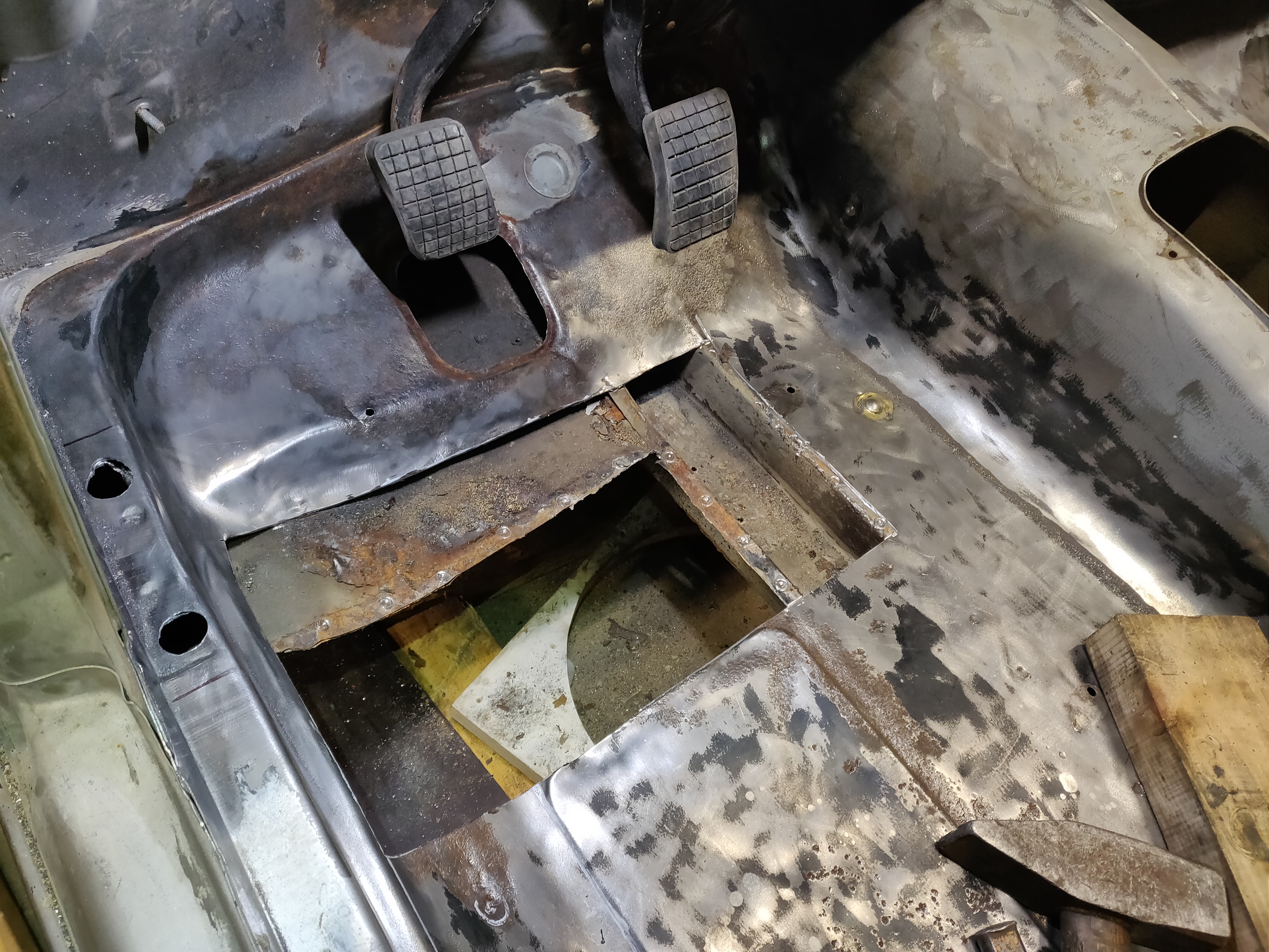

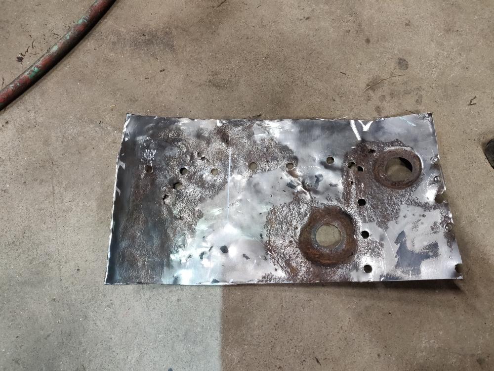

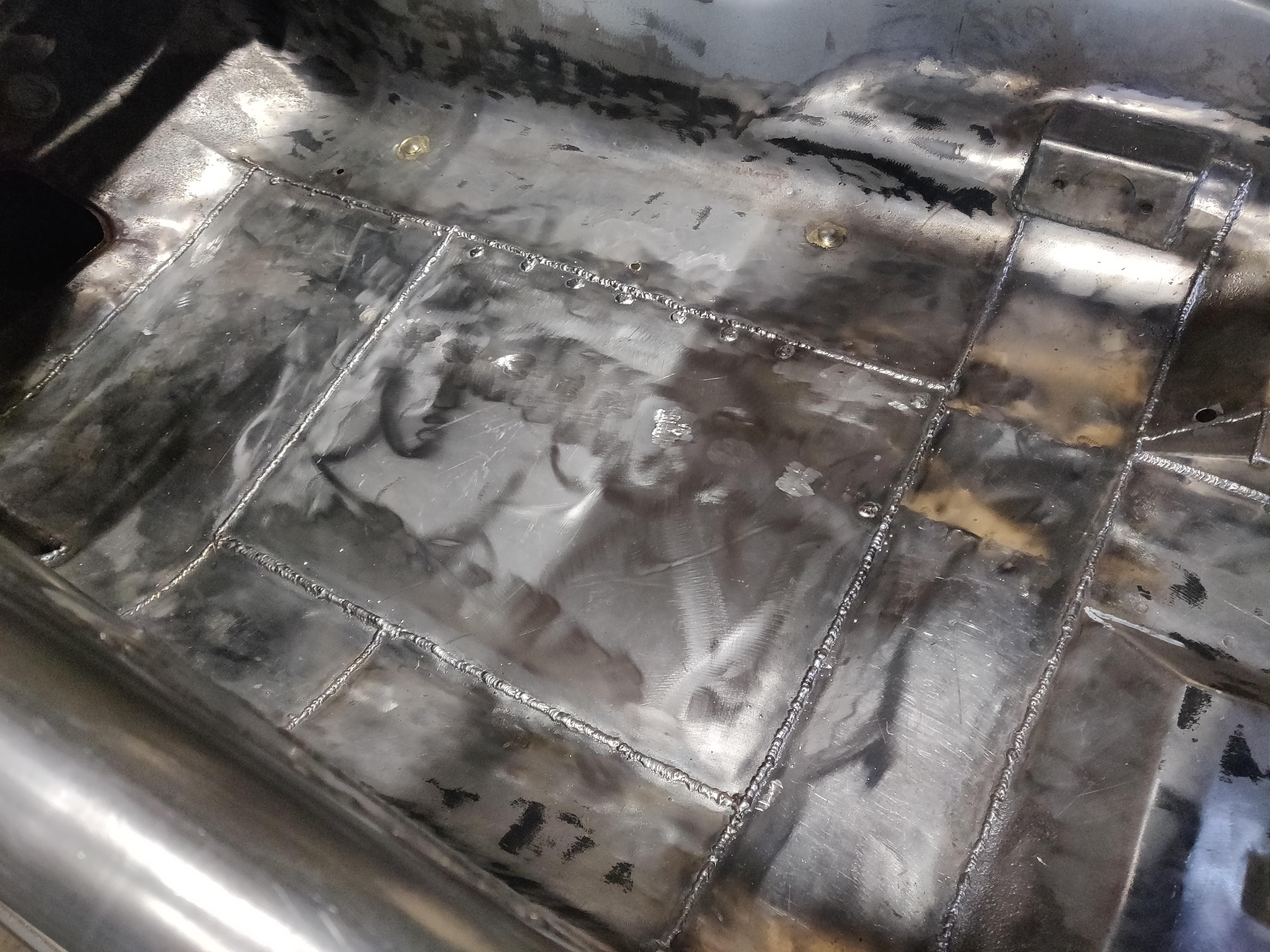

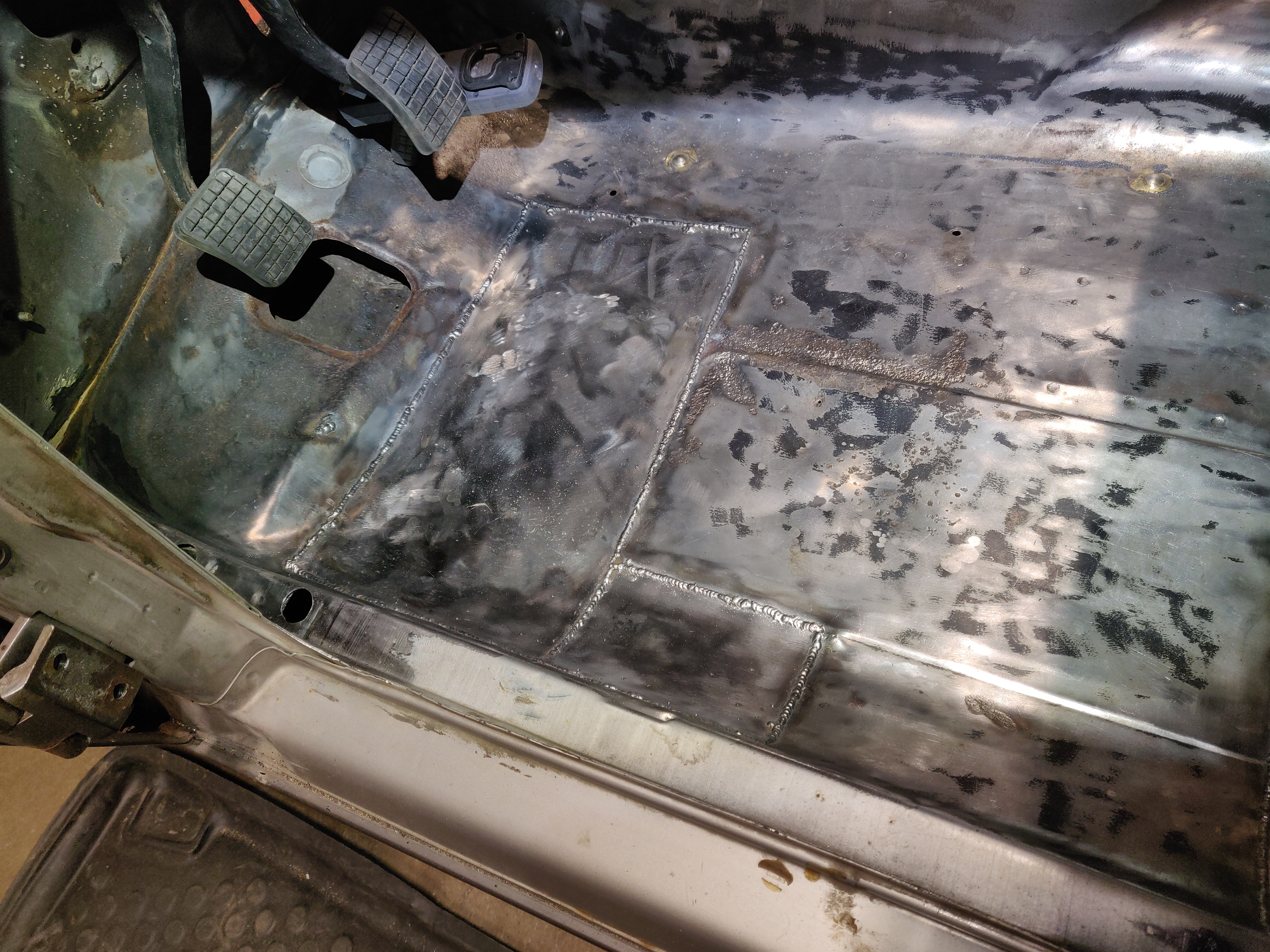

Before attaching the rollcage to the car for good I needed to repair the rusted floor on the drivers side:
The repair work itself took 7 hours to accomplish since I removed all the rust on the panel below the floor also and fixed the underside panels as they were deformed really badly. The deformation doesn't show on the pictures, but there is more on the underside of the car. I think someone has driven this thing in the quarry or something. I think I will fix the remaining small rusted areas on the floor after I have finished the rollcage.

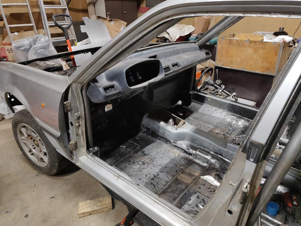

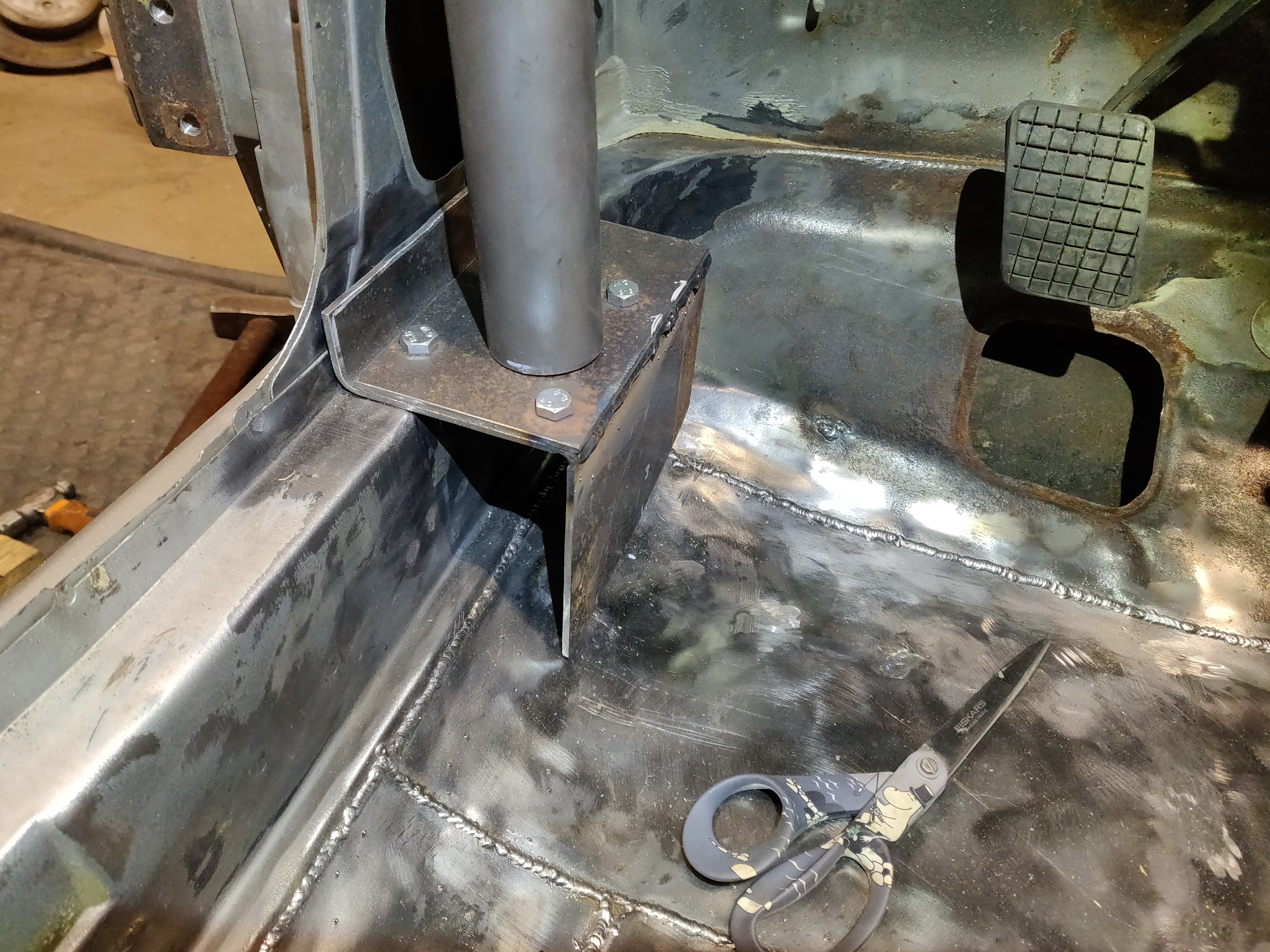

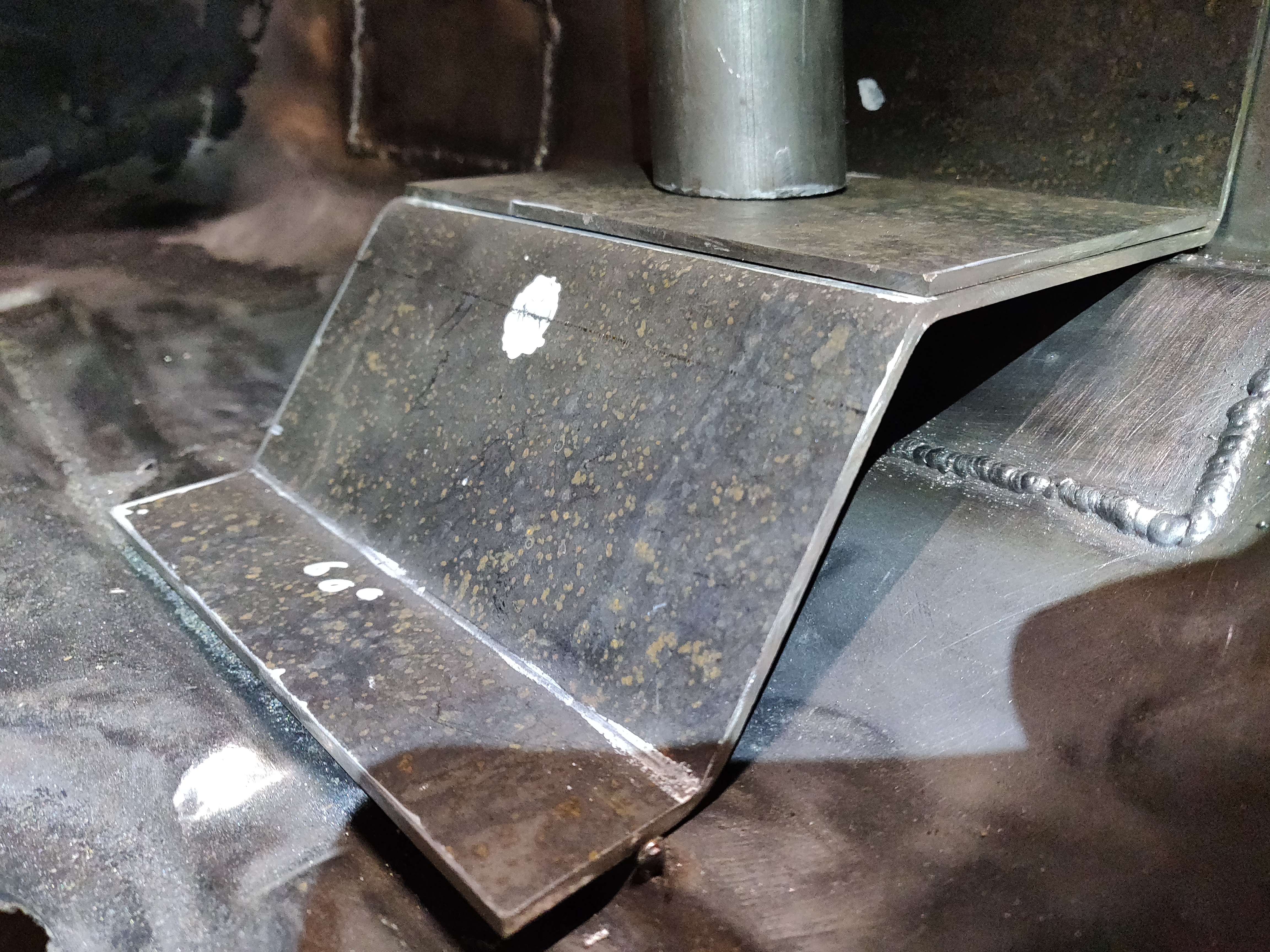

After fixing the floor piece, I could start manufacturing the proper rollcage front attaching points:
I also modified the dashboard to fit the rollcage:

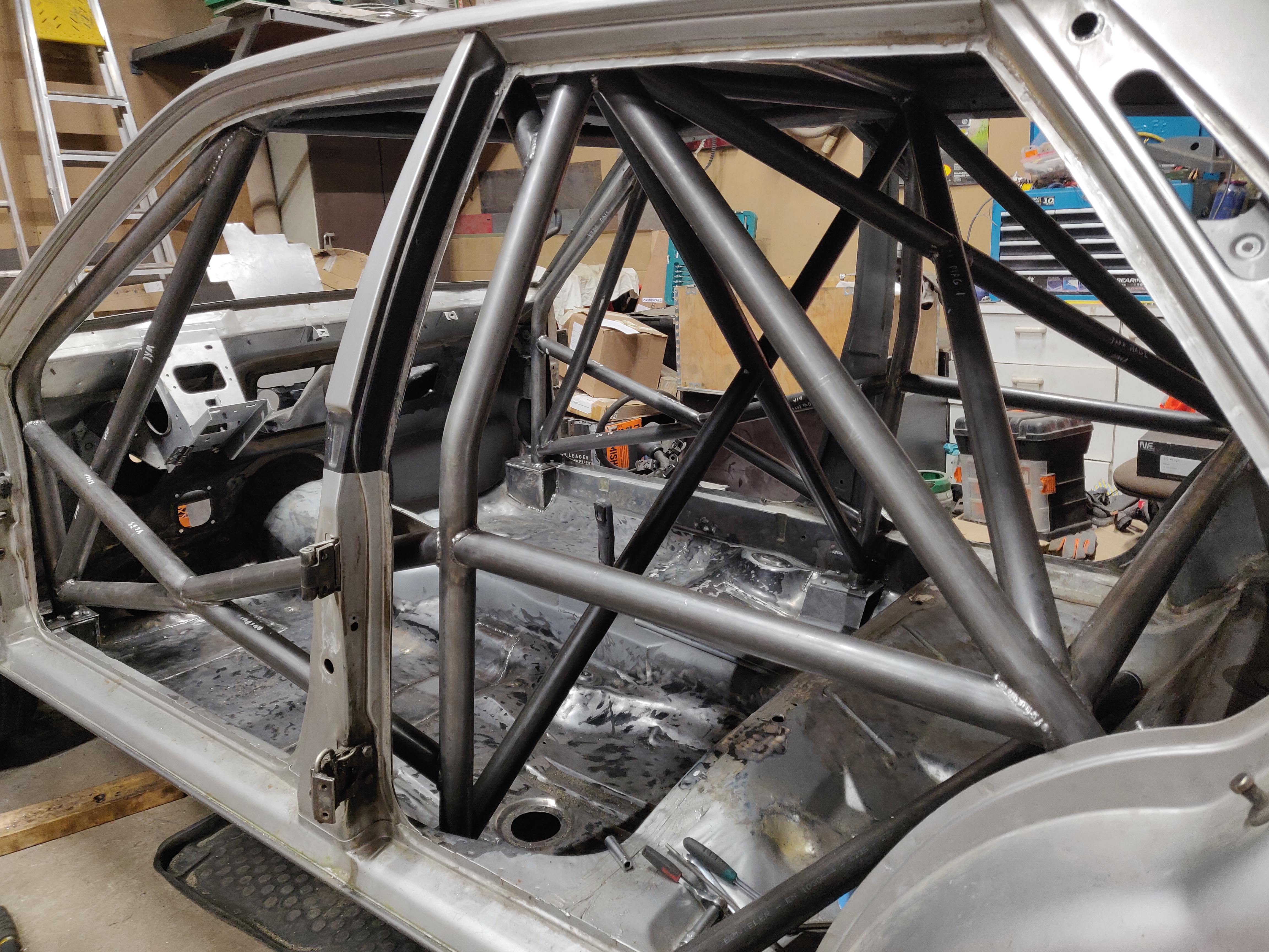

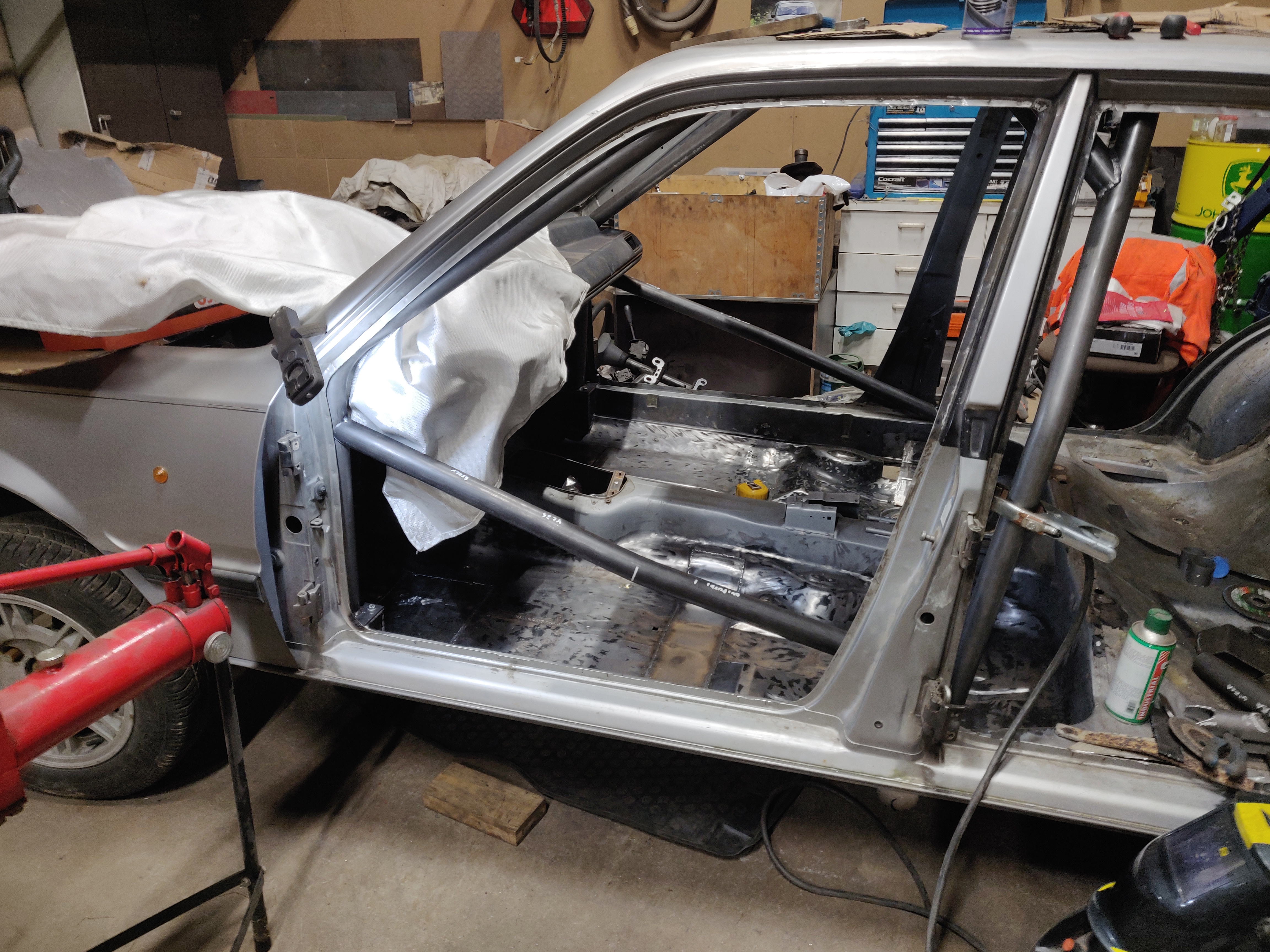

Next I did cut, bend and notched the door tubes and fortified the main arc to the side tubes:
After this I added the windscreenpilar stiffening tube, also know as the "WRC" tube:

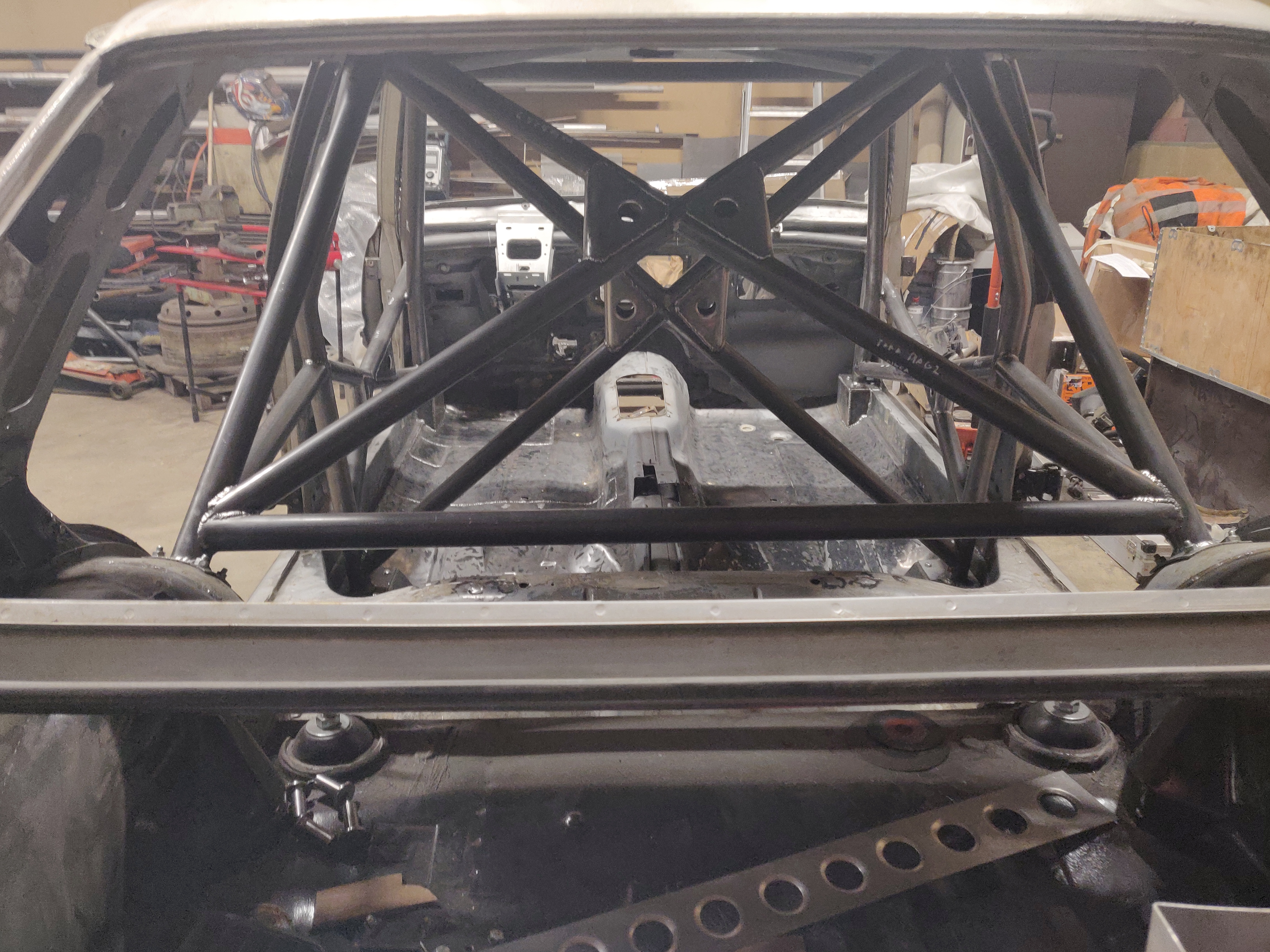

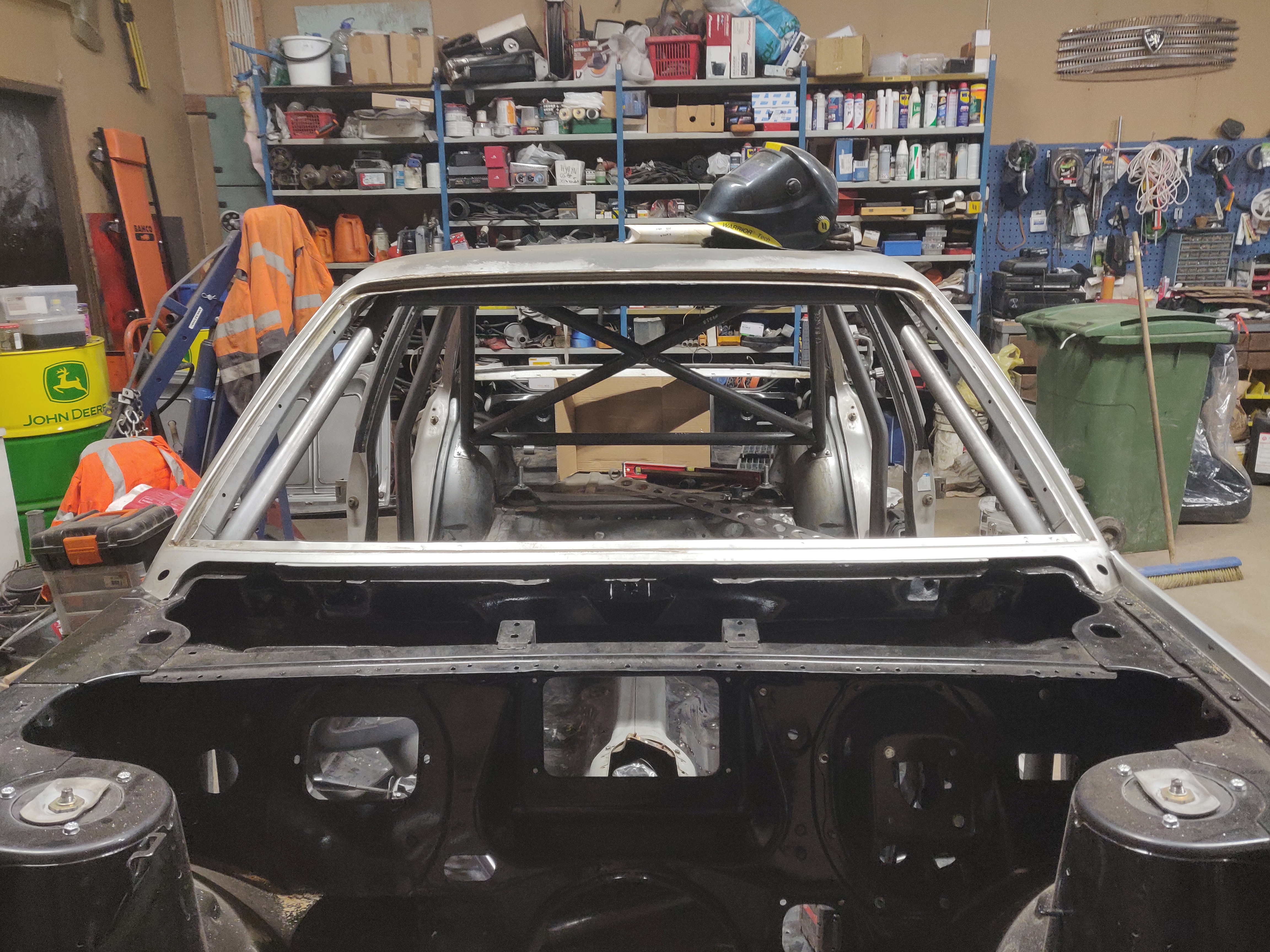

All the seams on all tubes you could see from the pictures are also now welded. Also the back tubes are installed and welded. I need to take pictures about them next time I am able to go to work on this project.

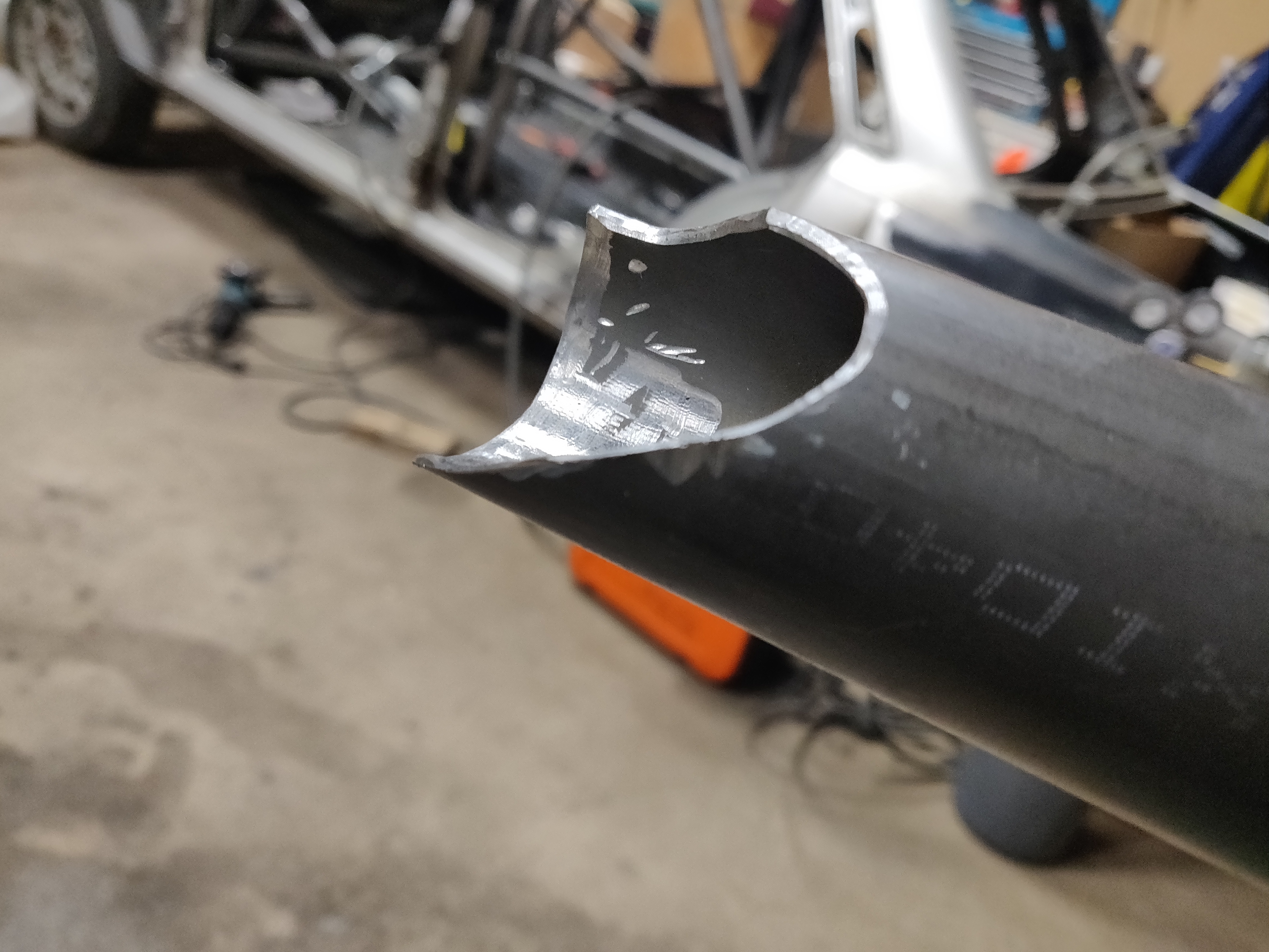

There is total of 29 invidual tubes in the rollcage and 52 different tube ends to be notched, some of them ending to be really interestingly shaped:
Only 3 tubes out of 29 remaining to be manufactured and welded.
Only 2 of the 6 attachment points remaining.
10 of the 14 required fortifications remaining.
I hope that by the end of this week I am done with the rollcage, I have notched way too many tubes during last week :D

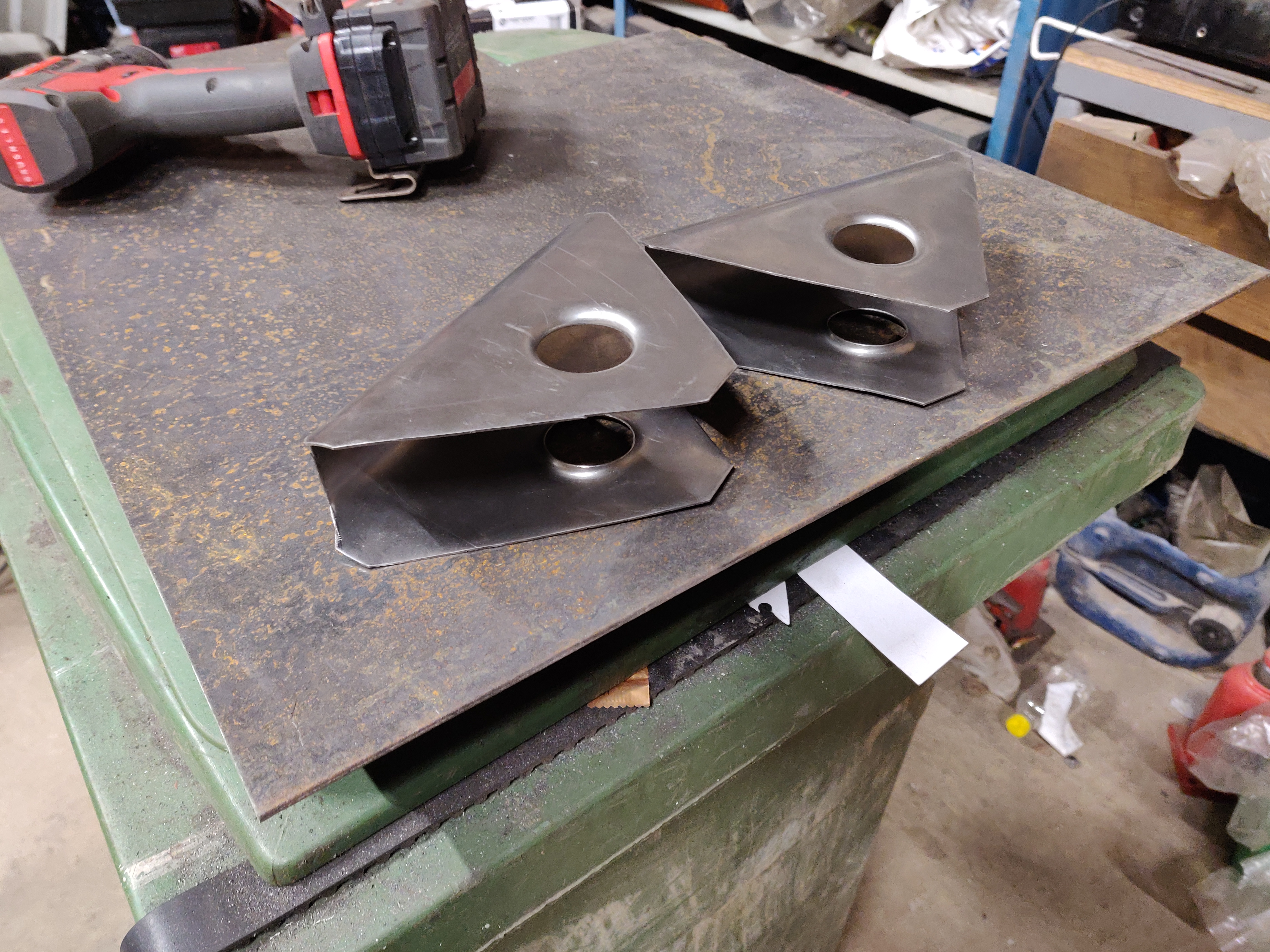

Will you be doing chassis to cage punched panels to attach the a and b pillars? What gusset design are you using between tubes - Taco gussets?
*Oops - I see now you used taco gussets in the roof bars*
Looks great!  Car is coming along very nicely.
Correct.
"Taco" type gussets on to the following at least:
Main arc diagonal middle joint
Door tube middle joint
"WRC" tube to the door tube
Those are required at minimum, but I think I'll also fortify the rear cross joint.
40mm wide punched panels on to the a and 80mm wide on to the b pilars.

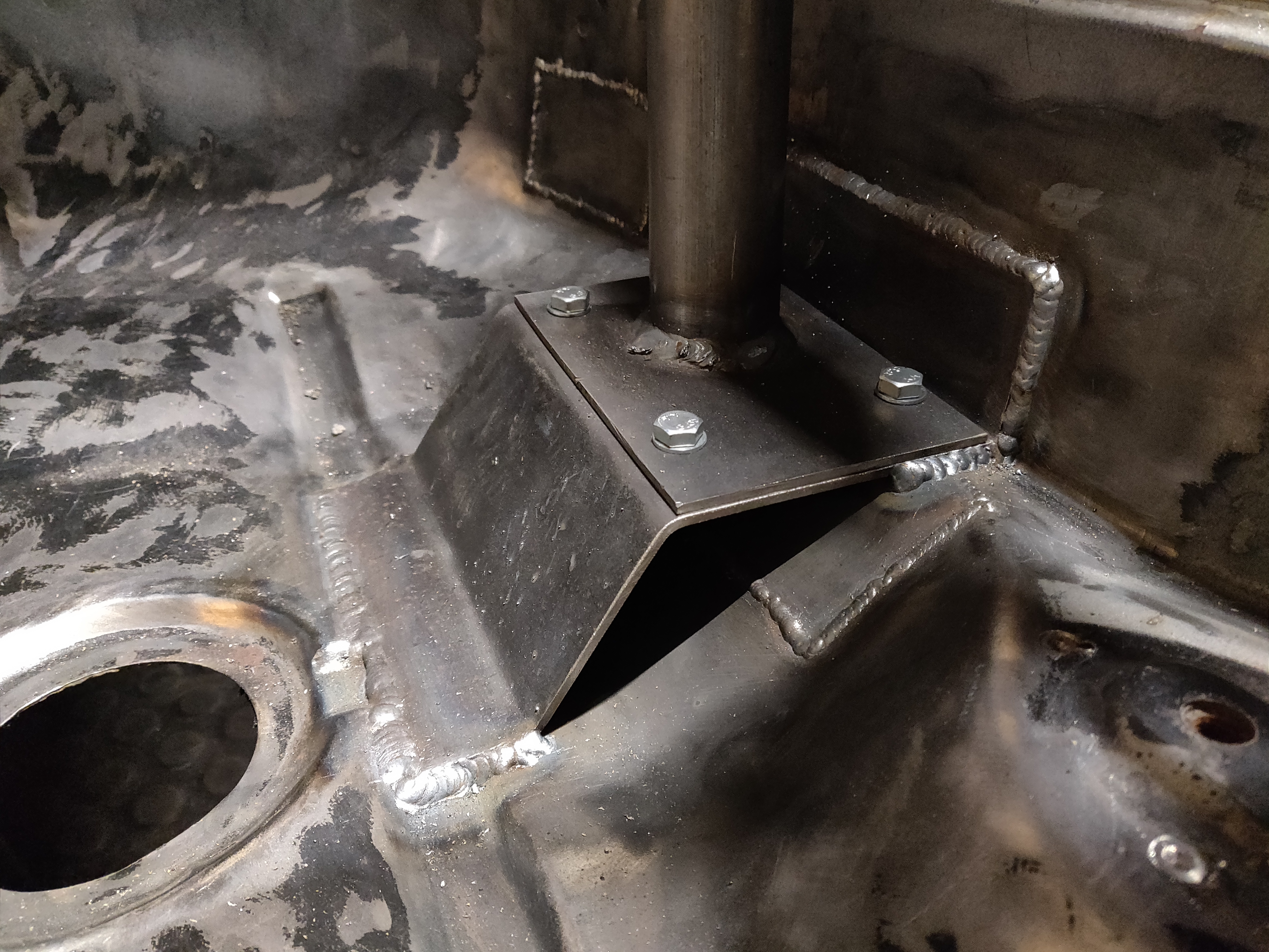

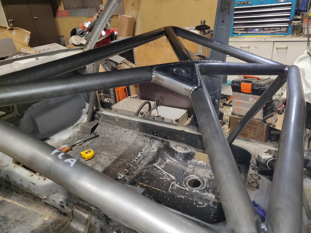

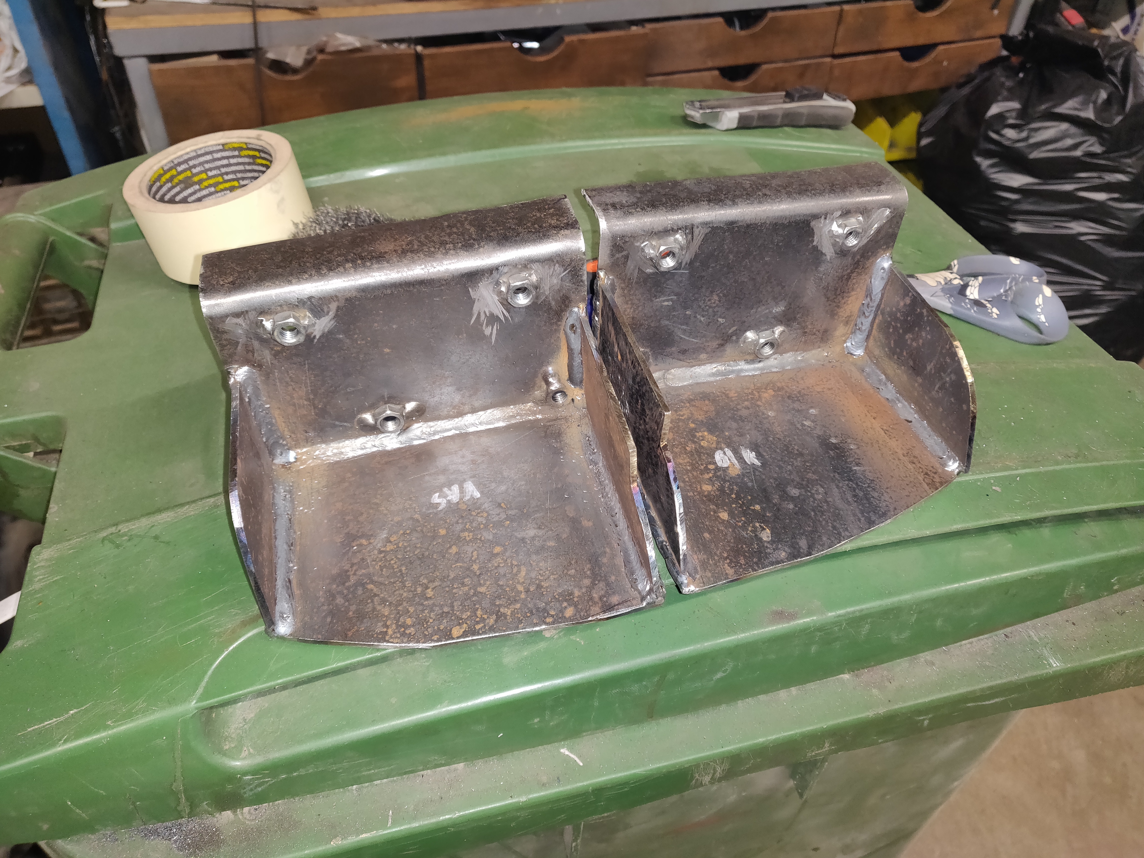

The main arc has been properly attached to the car body:
Two of the four bolts go through the 3mm steelplate and two of them go also through the floor.

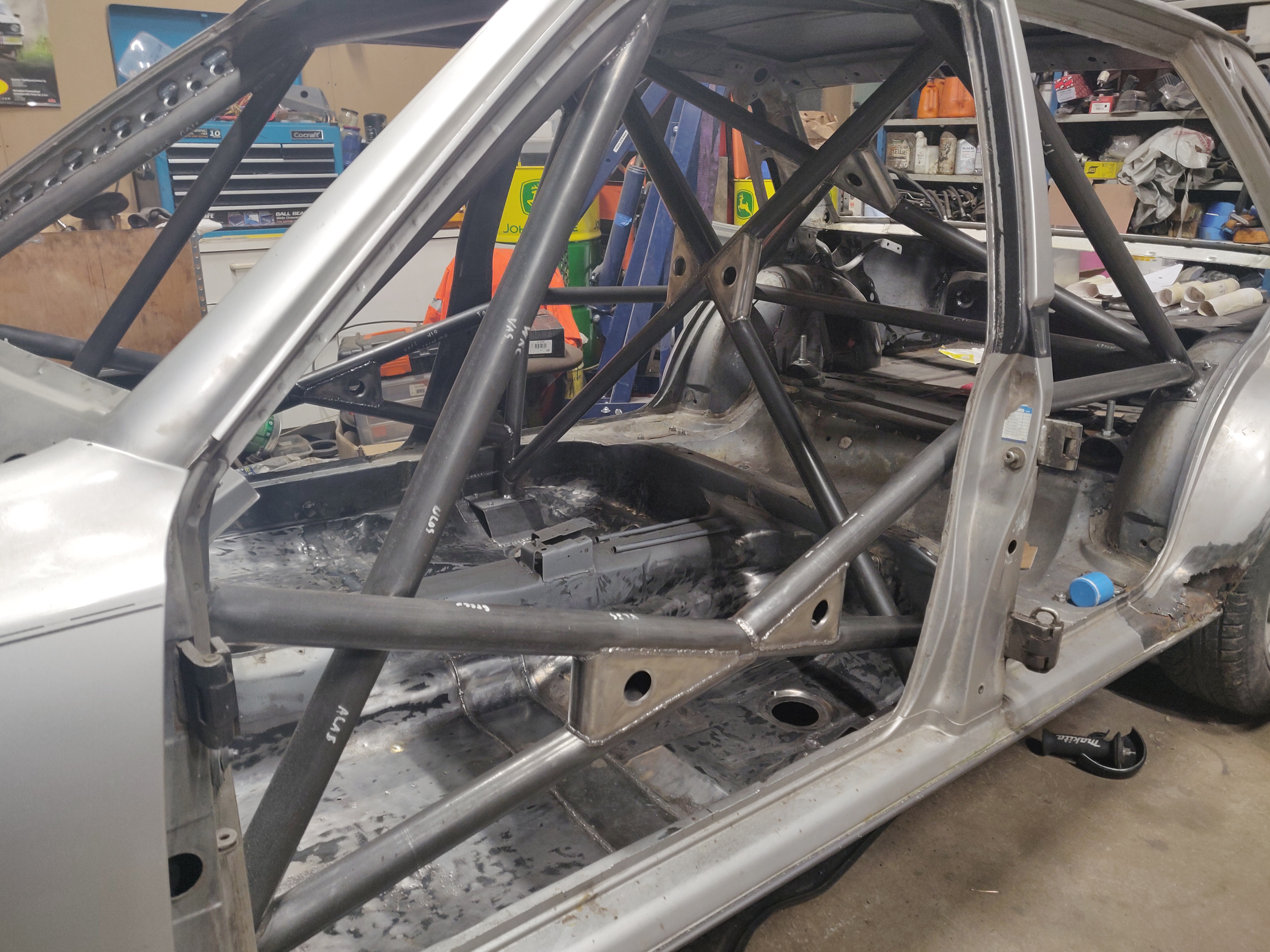

Main arc diagonals:
Home cooked gussets (1 mm thick, 80 degree, for 45mm tube):

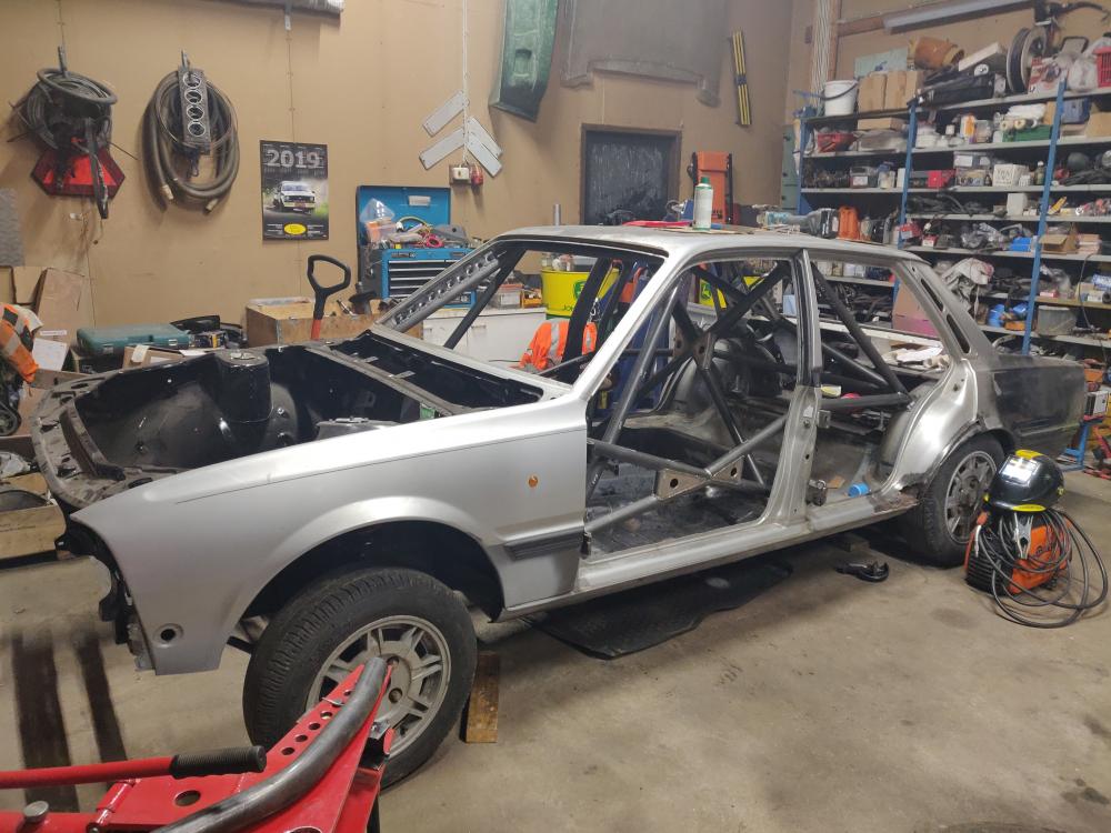

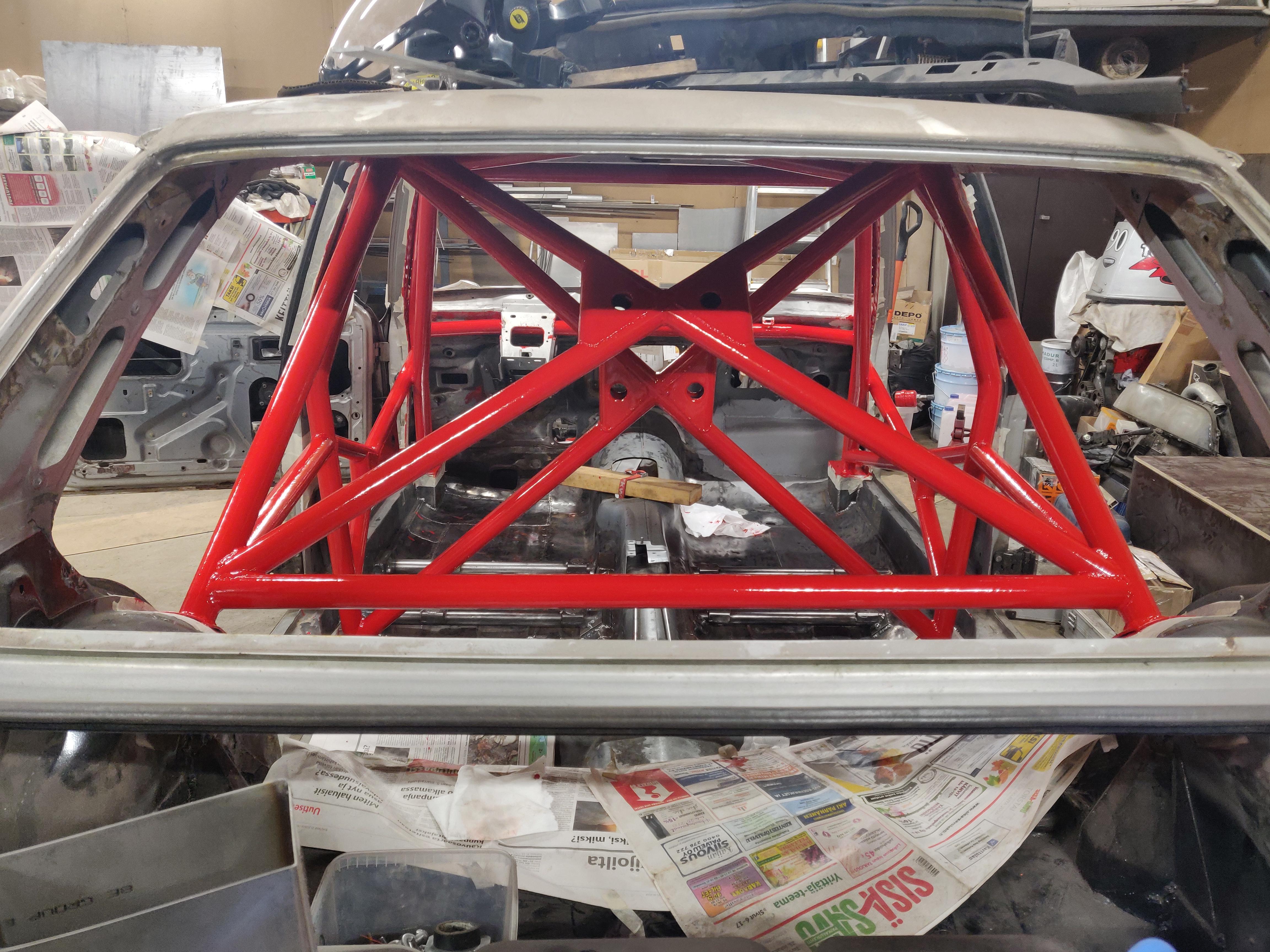

And the current state of the rollcage (Please note the tranverse tube in the front, below the dash):
The tranverse tube in the front was really PITA to fabricate as it has 6 bendings and you could you see if it would fit only when it did it fit.
The rollcage is nearly finished. Some minor fortification weldings still missing, like the b-pilar steel joint.
Looking forward to getting the seat attachments installed. After that removing the rest of the old antichip and fixing the remaining rusted areas.

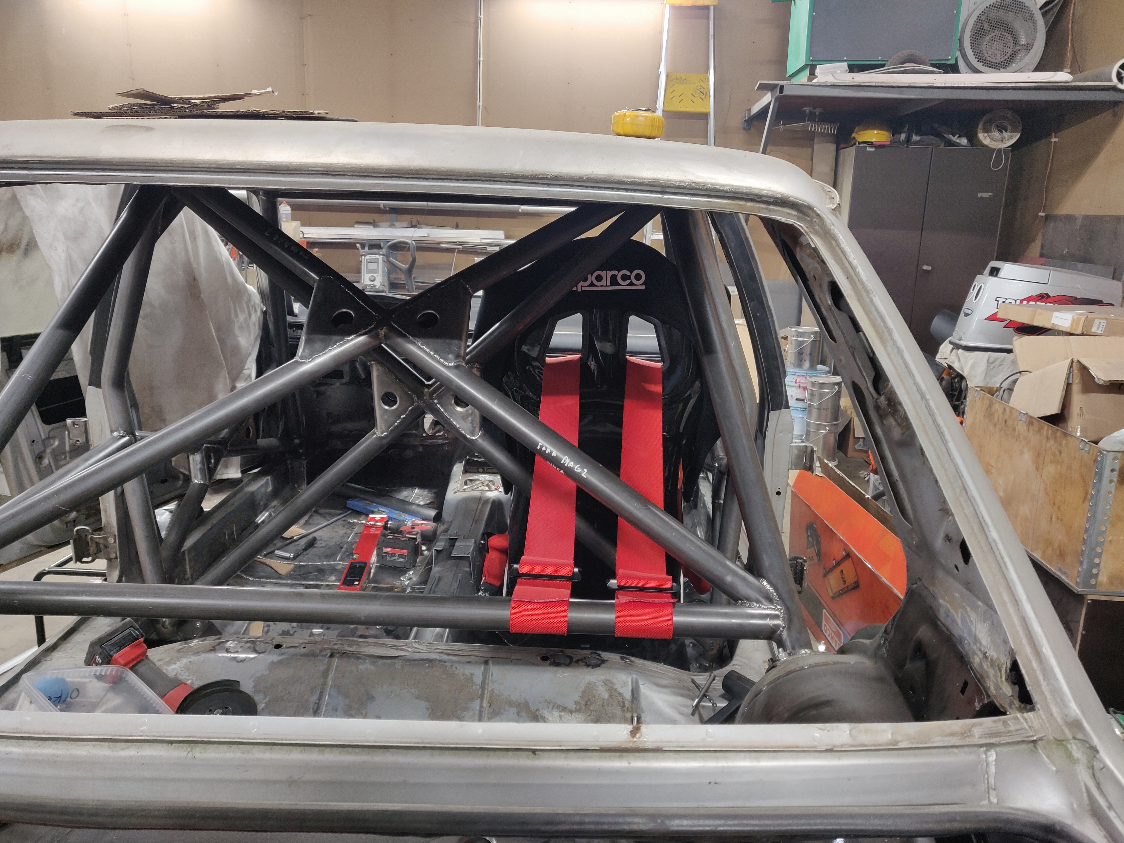

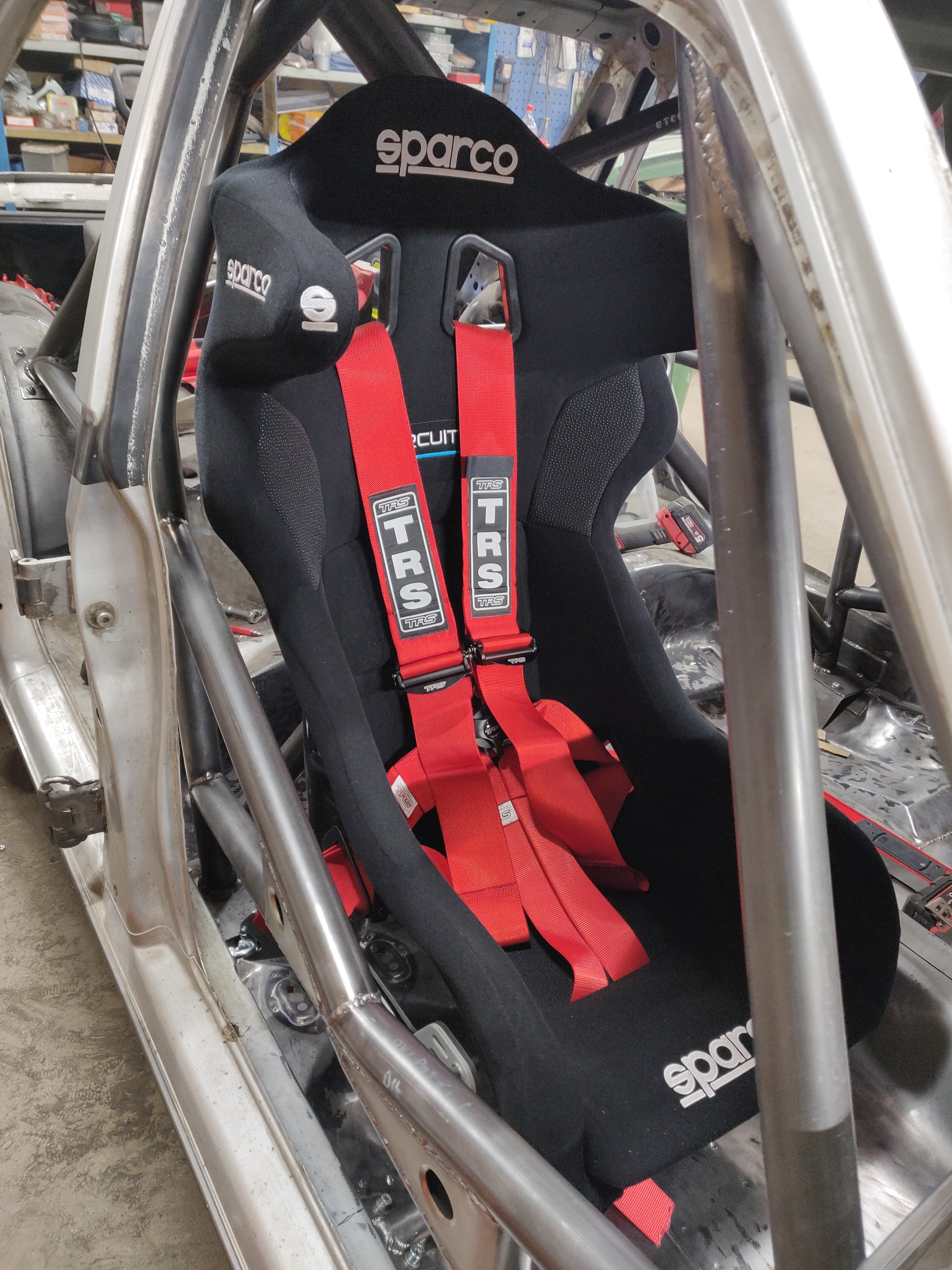

Also, I managed to make the co-drivers seat mountings and try on the harnesses. The seat and the harnesses fits really nice. I will cover the making of the mountigs in the upcoming Youtube video.

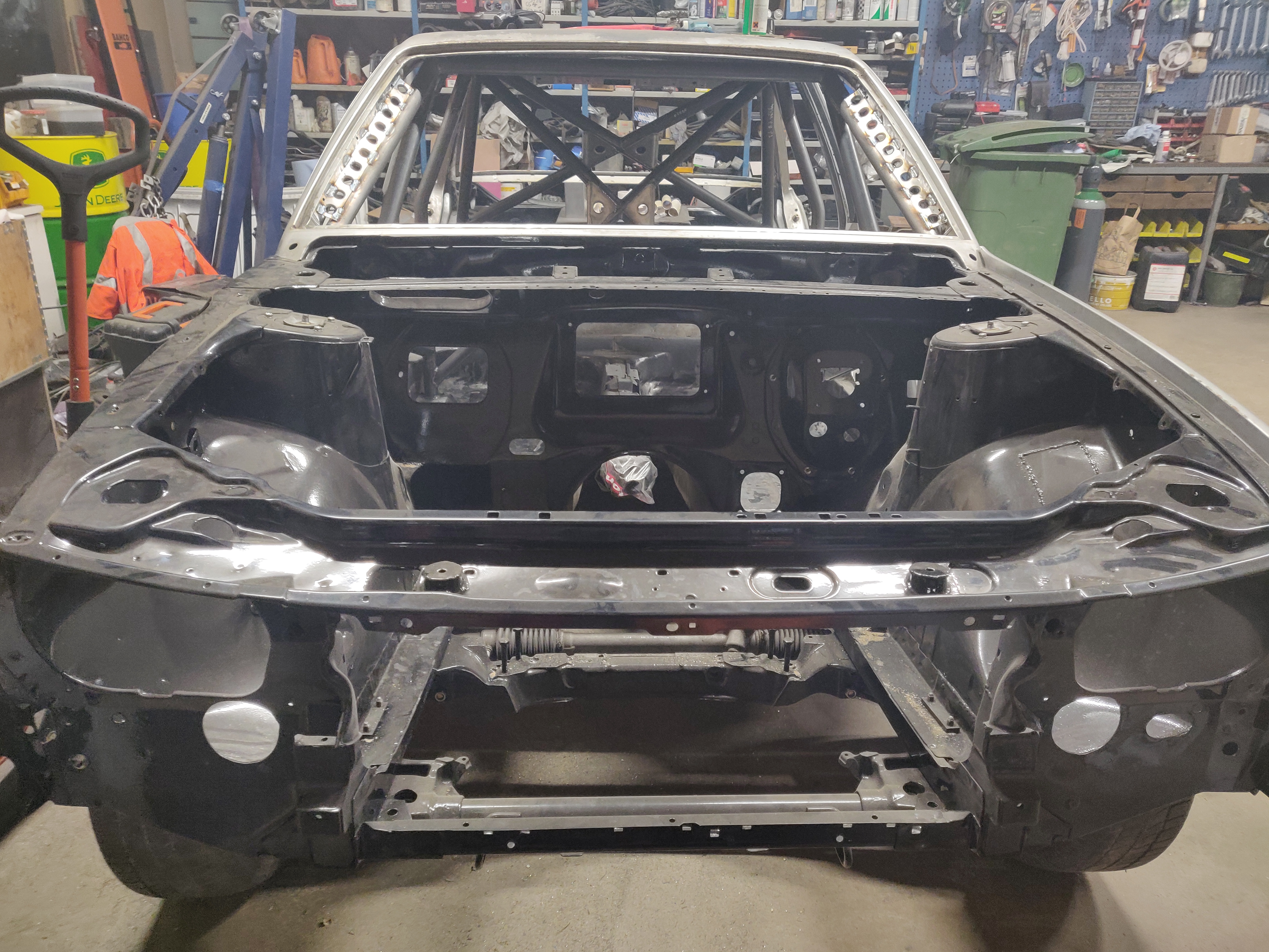

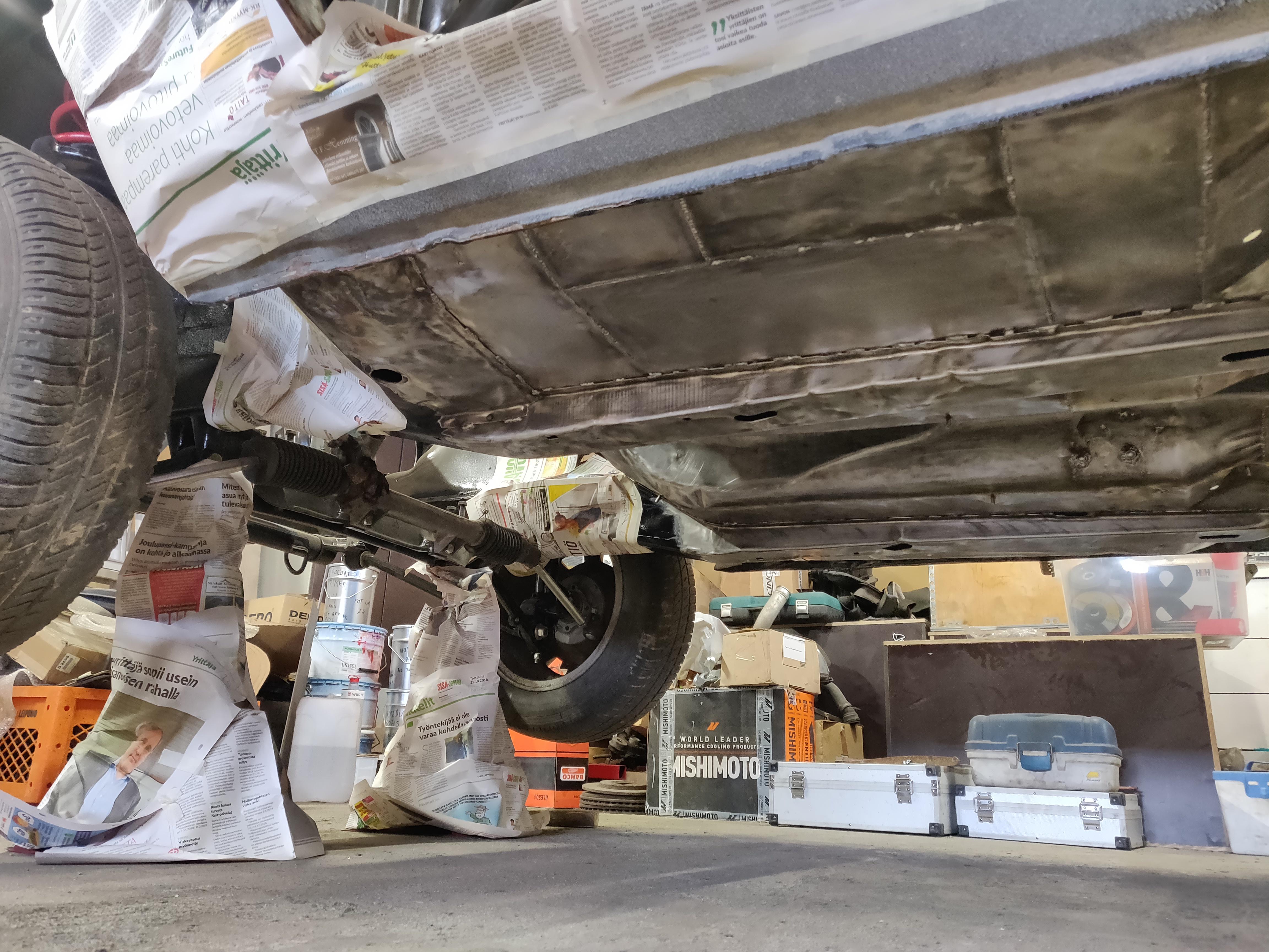

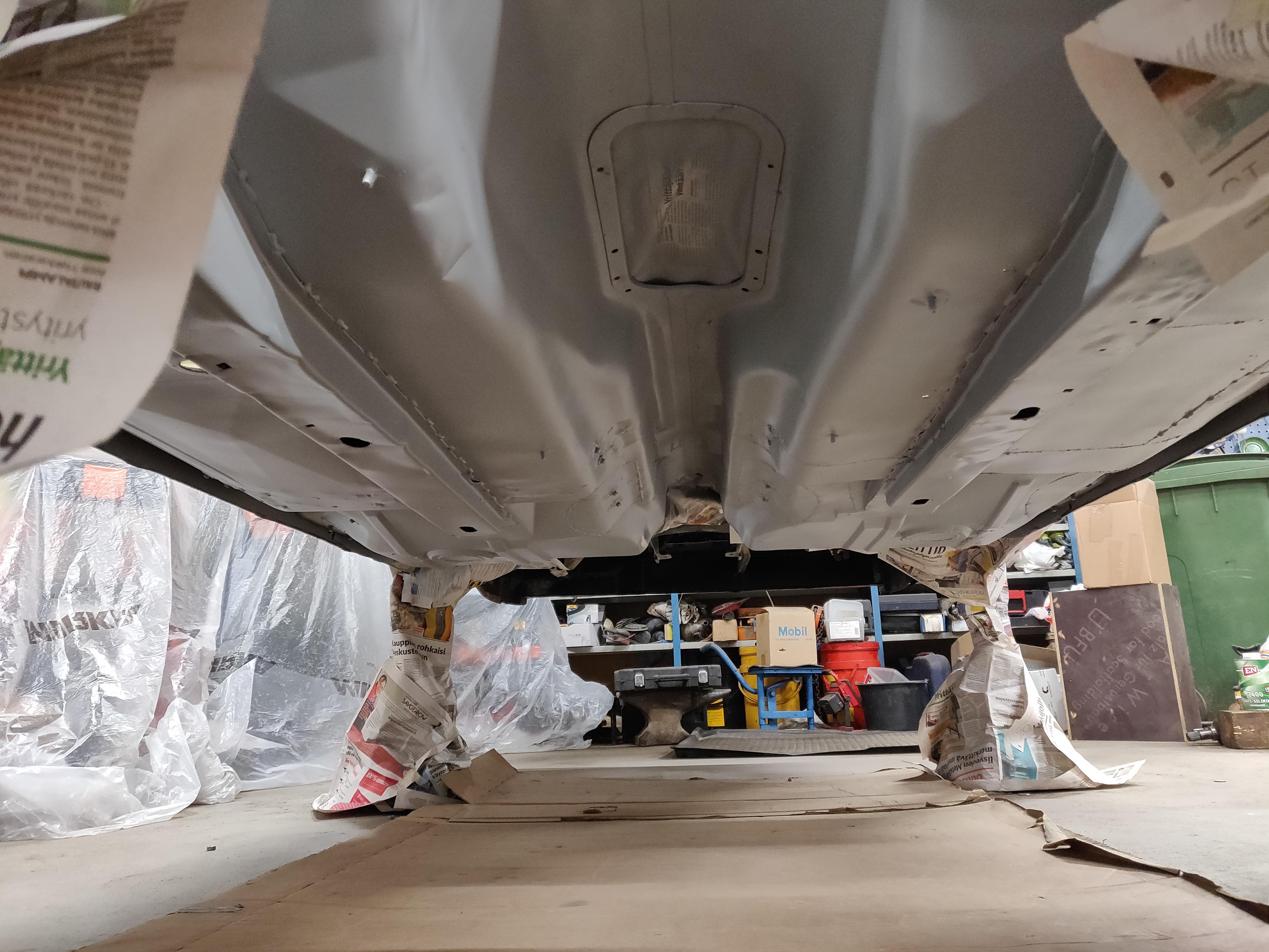

Anyway, I ended up fixing the drivers floor section and I did paint the the underside of the car with epoxy primer and U-Pol Raptor bedliner polyurethane paint in May this year. Unfortunately I do not have a picture of the finished surface, but here is one picture of the underside before the painting and one picture after the epoxy primer:

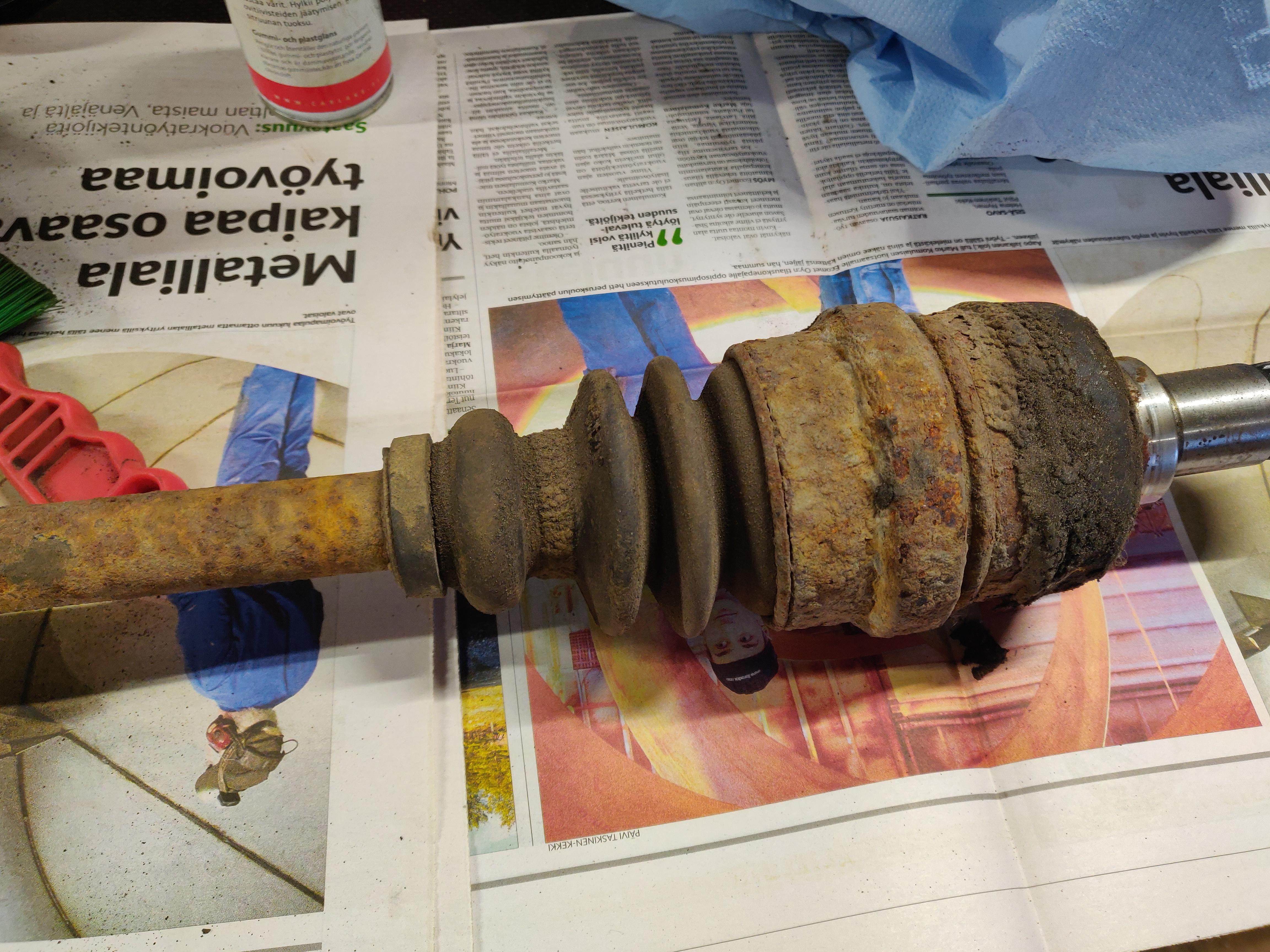

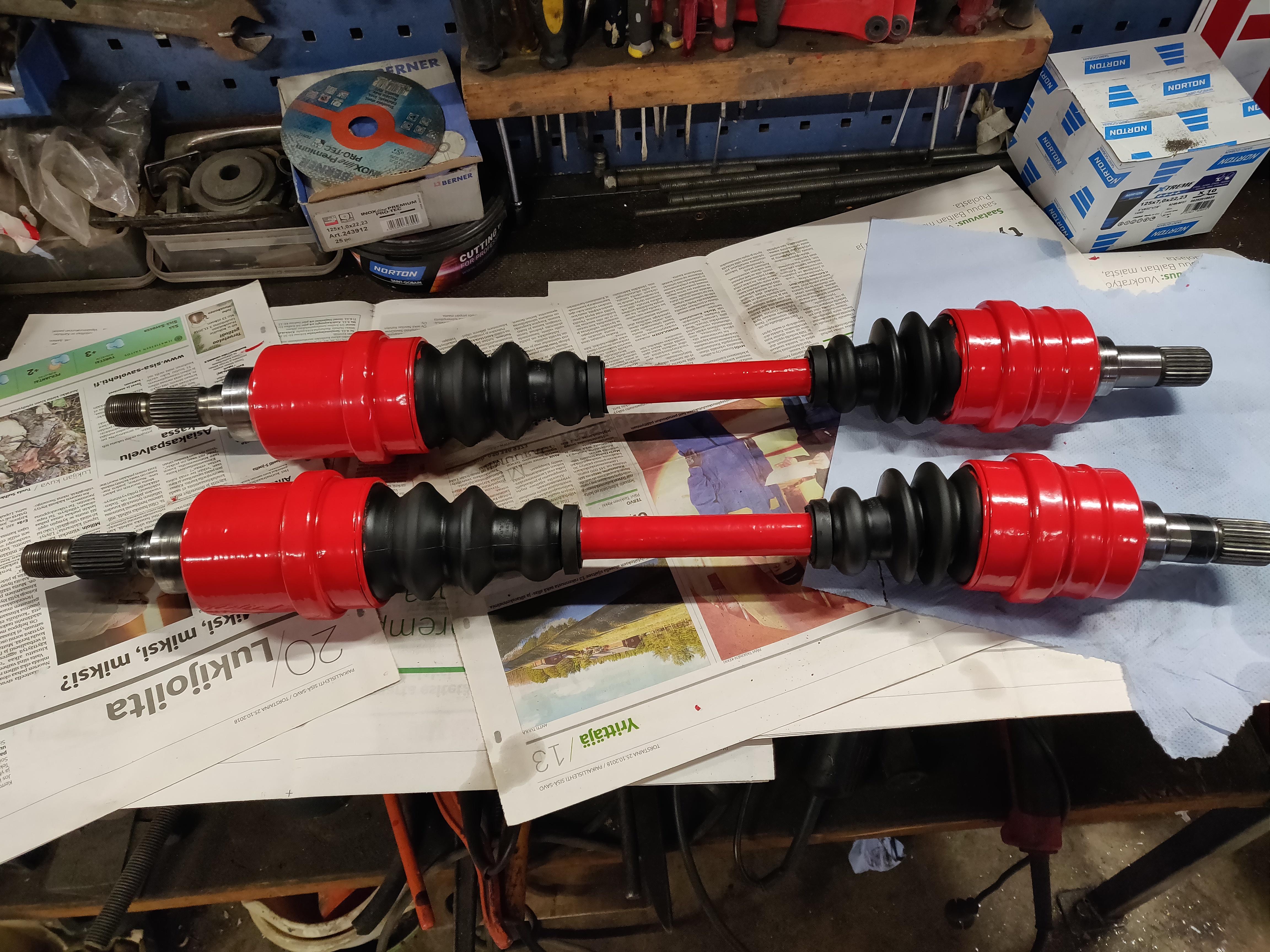

Also, I managed to renovate the drive shafts:

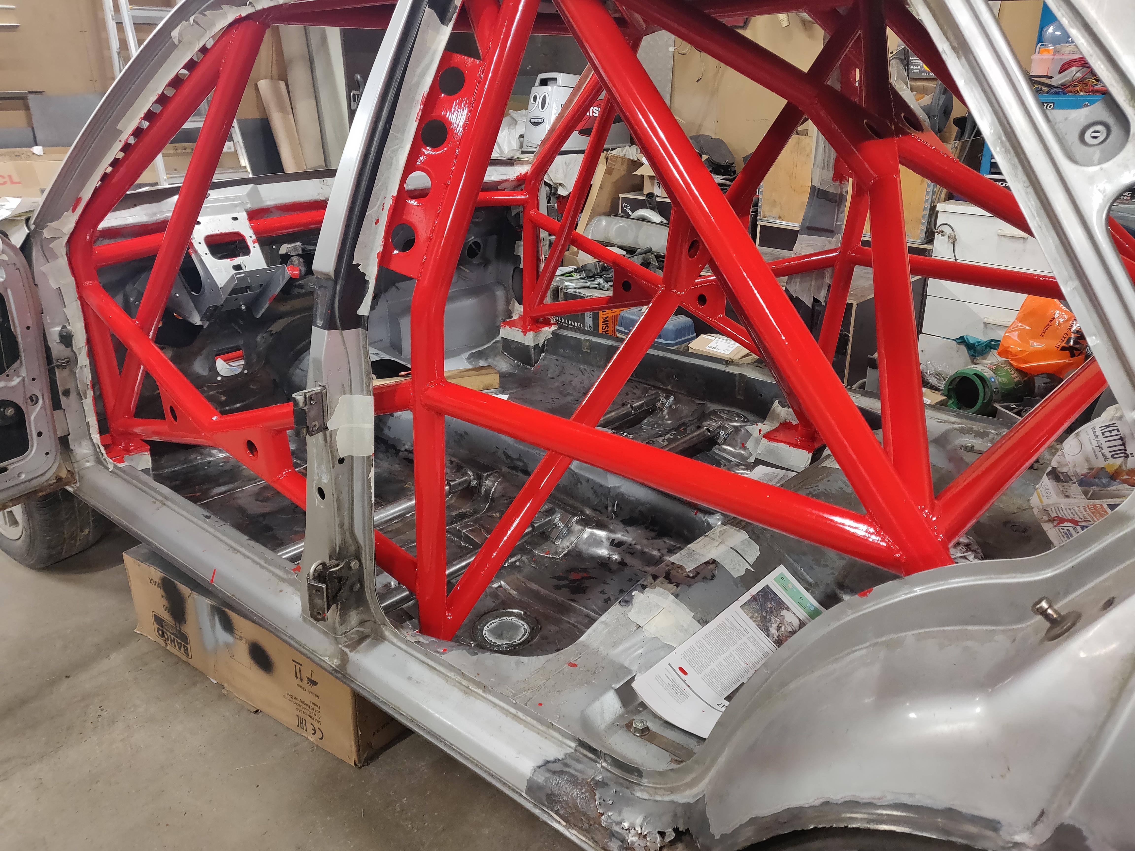

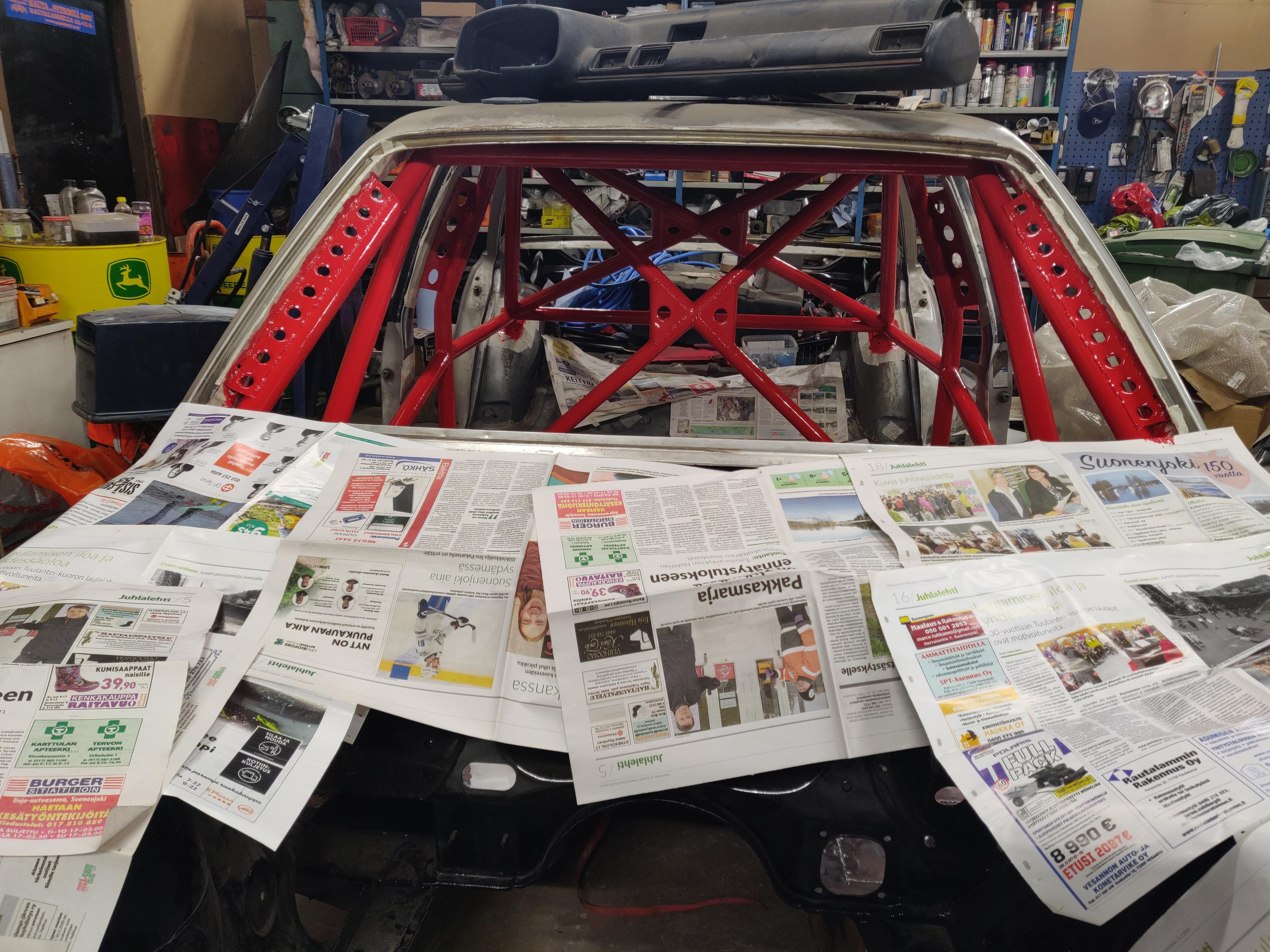

And lastly but definitely not leastly I did find time to paint the whole rollcage:
After painting the rollcage, I have shilded the rollcage with protective paper so that the rest of the passanger compartment can be painted with the spray gun. It has been sitting like this for 3 months now, hopefully I am able to find time to proceed with this project soon... At least at the wintertime I do have more time on my hands so if not earlier, then at the winter would be the latest...
