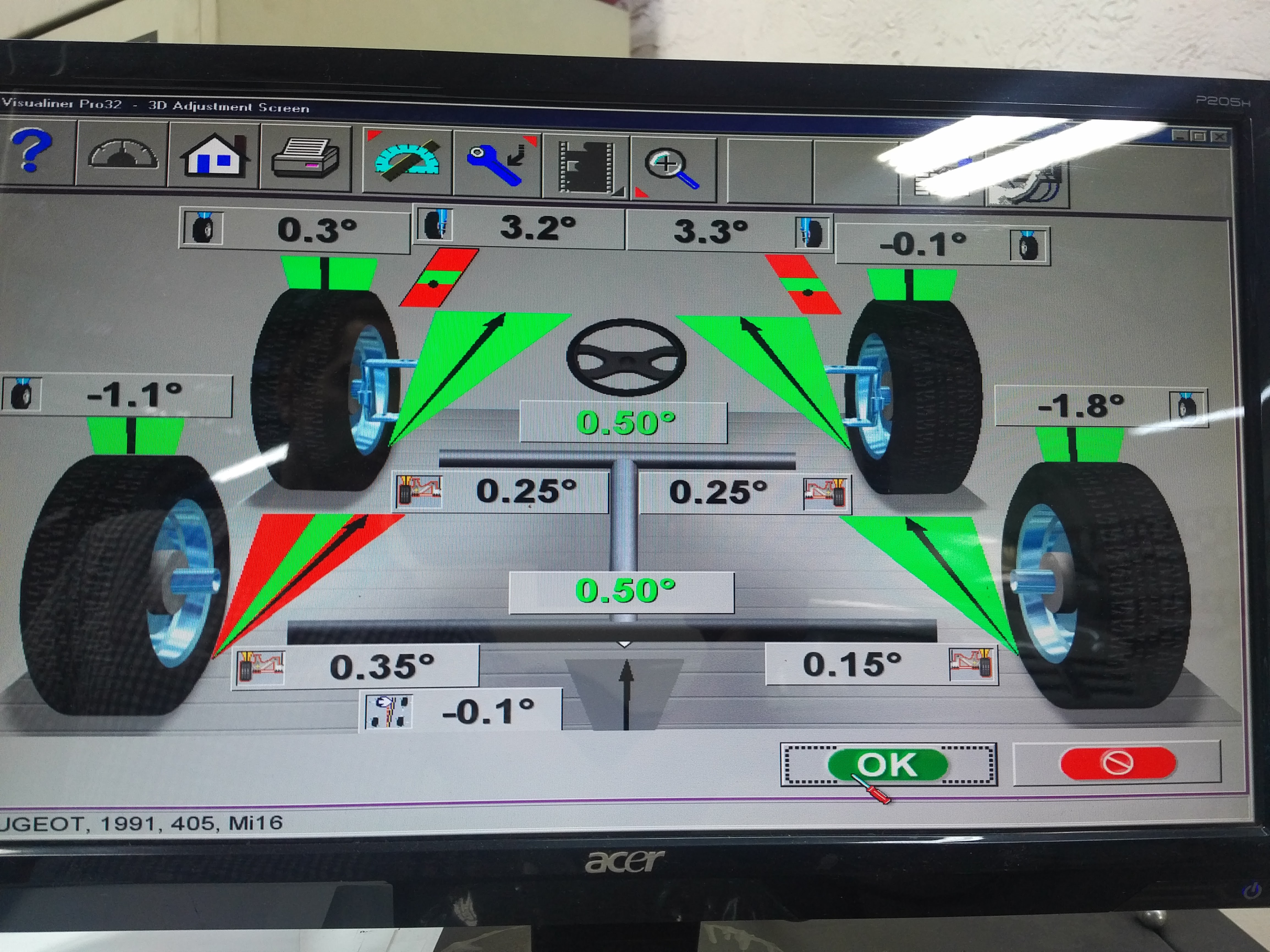

robotic Posted January 3, 2018 Report Posted January 3, 2018 First post- I've owned a '91 Mi16 for about 4 years now. It was in decent shape when I bought it, but I'm just going through a long list of relatively minor fixes. After replacing front end suspension and control arm bushings as well as tie-rod ends, an alignment was in order. I know there isn't really any adjustment for the rear, so I suppose this is more of a baseline to keep an eye on the rear camber. I'll have to double-check the Peugeot specs, but the rear right camber is out spec, leading me to believe I'm starting to have some bearing wear. I haven't felt any free play yet, but I was curious if anyone has feedback. I actually have the bearings but if I can delay this I wouldn't mind postponing this a while. Thanks! Quote
Bean Posted January 3, 2018 Report Posted January 3, 2018 There's a needle bearing in the trailing arm pivot that's known to develop play as well - or did you mean wheel bearing play? There's a procedure to drill the trailing arm bearing housing to install a grease zerk to get grease into the bearing to prolong it's life - but that'll be a crap shoot at this point. I'm sure Savo or Goce can provide better insight though since they're 405 guys. Rabin Quote
robotic Posted January 4, 2018 Author Report Posted January 4, 2018 You are correct Rabin, to clarify, I was referring to the needle bearings for the rear trailing arms. If I need to replace them I'll consider installing a grease fitting while I'm at it. Savo, what kind of issues are you seeing on the rear wheels at your ride height? Quote

robotic Posted January 4, 2018 Author Report Posted January 4, 2018 Any chance the camber is from the needle bearings wearing out? Were you able to notice a big difference between camber before and after lowering? My car is at stock ride height currently, and my tires are wearing evenly at those numbers. I wouldn't be opposed to a slight drop in height though. Those shims in your build thread look like they move the entire wheel outboard. I don't see how they would impact camber or toe, unless I'm missing something? Quote
Bean Posted January 4, 2018 Report Posted January 4, 2018 Shims would be slightly wedge shaped to affect camber/alignment - but it's moot since the 405 has a fixed spindle in the rear axle as per the pictures. Another potential cause option could be sag in the rear cross member itself. I worked on a 505 that had been "fixed" by a shop that essentially bent the cross member until the alignment was back into spec. Different suspension - but the idea would be the same. BTW: Grease fitting is for extending/saving the life of the bearing already in place. If it hasn't already deteriorated - adding grease will save the bearing and likely extend for the life of car. I wouldn't really wait until replacing them unless you plan on replacing them right away. Rabin Quote
Goce Posted January 4, 2018 Report Posted January 4, 2018 I've had to replace the rear axle bearings on almost all the 405's i've owned, if the beam axles are undamaged is an easy on the car repair, not more difficult than lowering, if they are damaged, then it's a bigger job, decent size hydraulic press is a must. And funny enough driver's side seems always to be the first to fail. Quote

robotic Posted January 4, 2018 Author Report Posted January 4, 2018 Thanks for the replies. I thought there might be a point at which you could tell when is a good time to change the bearings by looking at the camber, but as Goce mentioned, prolonging the work could be making it a more involved job down the road. The lack of adjustment can be annoying when it comes to tuning, but overall the rear end design seems to be a decent compromise between trunk space and fun handling. Just saw this when doing a bit of research, granted it isn't a 405-specific part, but bronze bearings would make the trailing arm something you'll never need to think about: http://marxxon.com/newsinfo/665.html Quote
