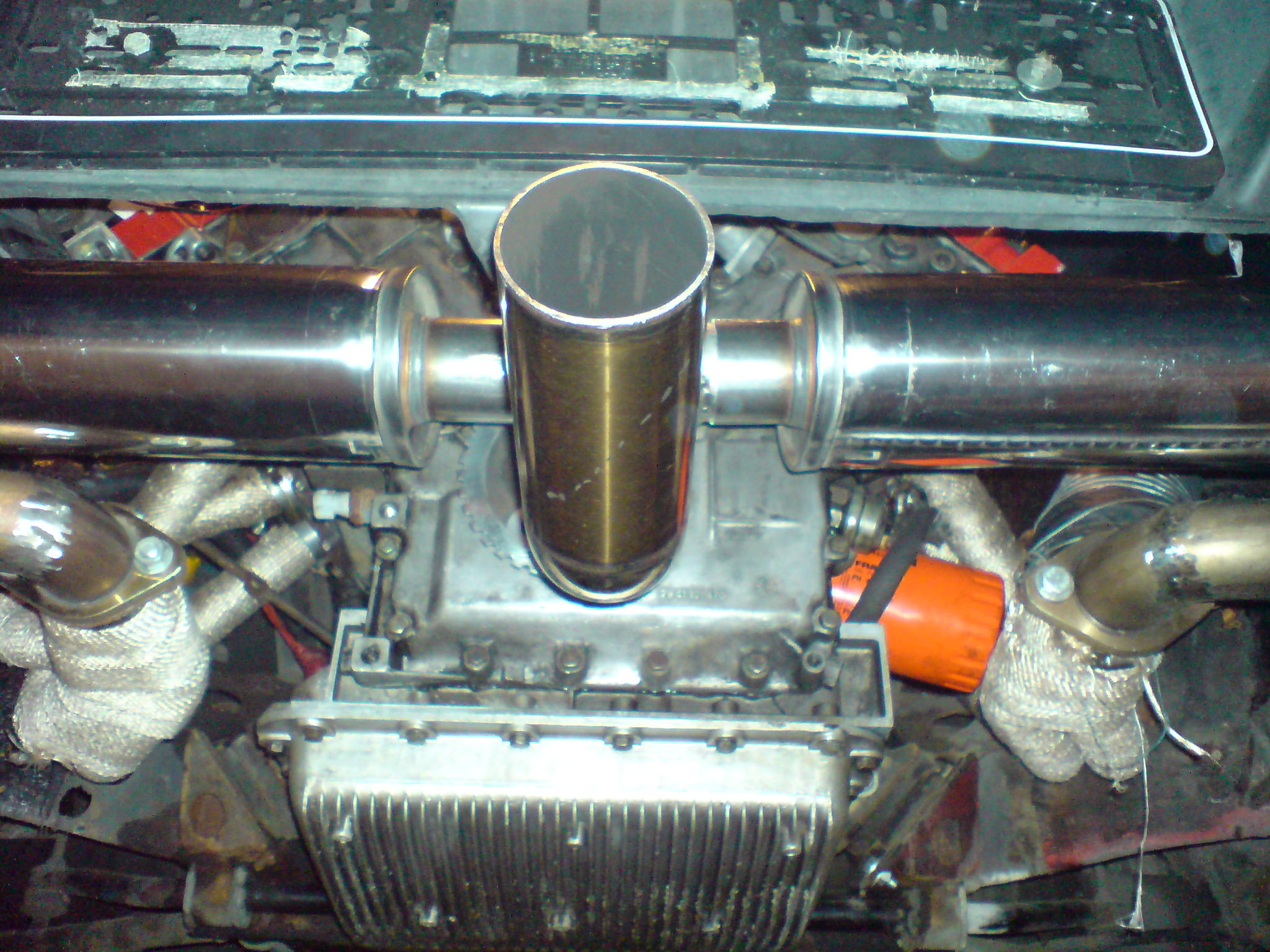

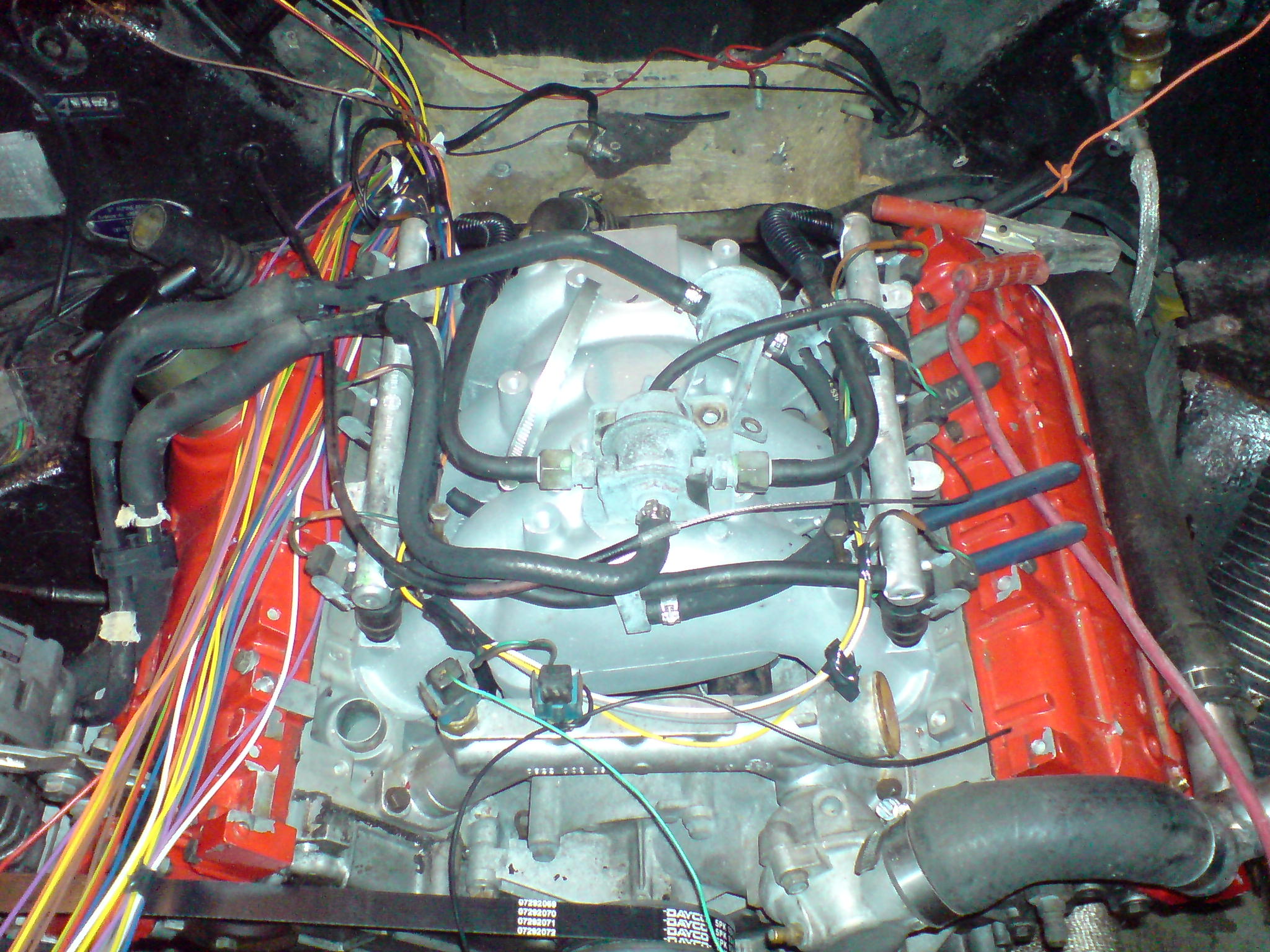

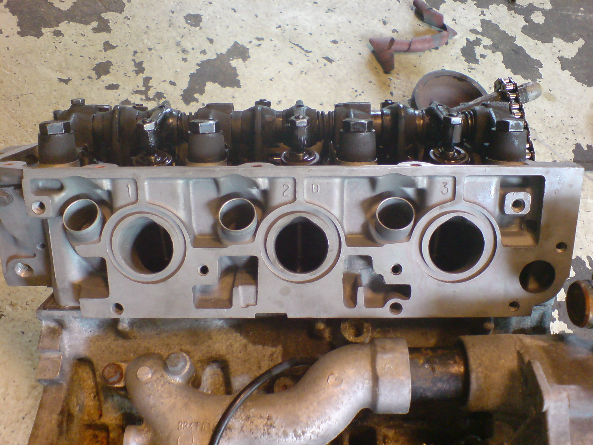

I have been reading your corespondens for some time now, and would like to participate. About 5 month ago I bought an Renault Alpine A310 S with a prv v6 2,7L engine making only 150bhp. That is going to change, so I have been working on a prv 3,0L 12 valve from a XM 1994. I am looking for someone with experience in prv engines? I have been rebuilding almost the whole engine, the compression ratio is now about 11/1, headers compleetly done and modified, 296 cams, special engine manegement system, intake system very modified made with 90mm airintake, prepared for turbo (by making oil preparation at the engine bottom) and modified exhoust system.
My goal is 220bhp without turbo. I know that the engine compression ratio must come down, if and when the turbo comes on. My question is all so: I am looking for special pistons, crankpins and crank made for high boost???
