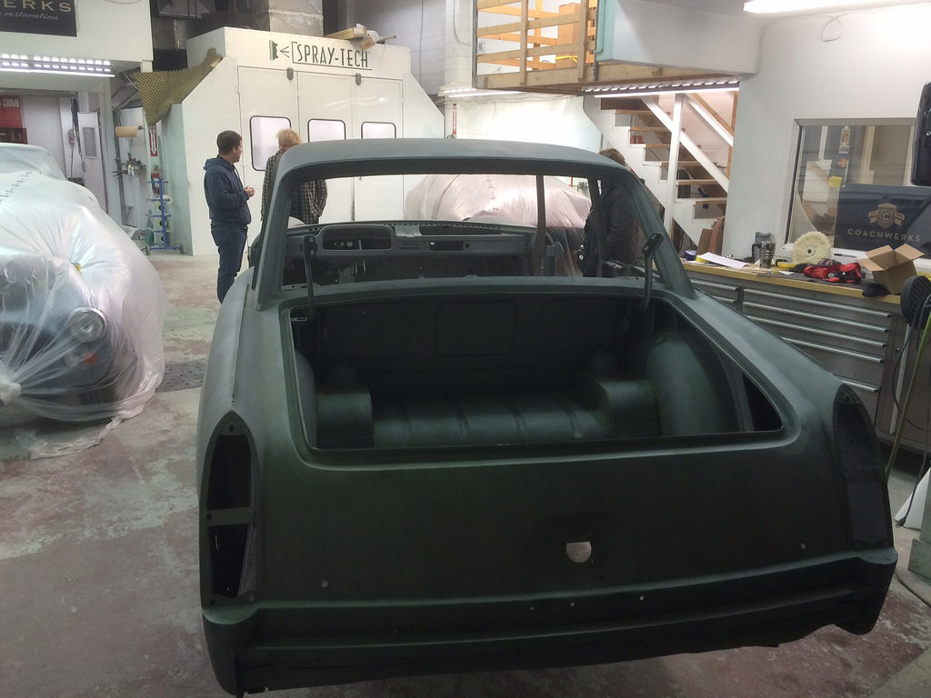

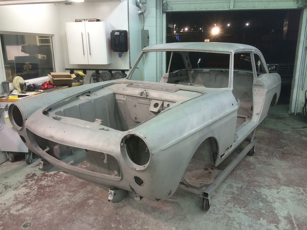

The paint has all been stripped from the shell now and the car is back at Coachwerks in Victoria.  Still waiting for the spare panels and opening panels to come back.  Today it was sunny here so it was a perfect day to move a bare metal shell the 22 km from blasting shop to the restoration shop!

Curious if the car is worked in bare metal and primed when metal work is complete?
Looks fantastic - And I think I'll have to side on it being dark blue... :)  I prefer dark colours on most all cars.
One picture is worth thousand words, than said the coupe looks great without any color, the typical rust spots but structurally looks great no sings of accident damaged, a straight car, which is a rare thing this days.
Yeah it's really straight, a couple little dings but that's it for bumps.  A good starting point!
