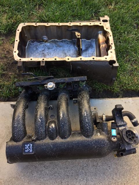

Bean Posted September 24, 2016 Report Posted September 24, 2016 Just out of curiosity - can you tell me the port spacing on that intake? Definitely a casting work of art! Rabin Quote
my3AWDgst Posted September 24, 2016 Author Report Posted September 24, 2016 19 minutes ago, Bean said: Just out of curiosity - can you tell me the port spacing on that intake? Definitely a casting work of art! Rabin Rabin are you talking about ports where intake gasket goes? Quote
SRDT Posted September 24, 2016 Report Posted September 24, 2016 Spacing should be 93mm if all is straight. Can you keep the stiffens plate and still bolt the GTI6 oil pan to the gearbox? Quote
Bean Posted September 24, 2016 Report Posted September 24, 2016 Center to center spacing of the intake ports is 93mm? I have parts to do a custom alloy intake for my N9TE, was just curious if that  manifold could be modified instead...  (even for just the plenum part...) Rabin Quote
SRDT Posted September 24, 2016 Report Posted September 24, 2016 The bore spacig of the XU is 93mm as seems to be the intake ports spacing: With 103,5mm bore spacing on the N9T using only the GTI6 plenum can still be done but could be difficult compared with a straight design. Quote
my3AWDgst Posted September 24, 2016 Author Report Posted September 24, 2016 3 hours ago, SRDT said: The bore spacig of the XU is 93mm as seems to be the intake ports spacing: With 103,5mm bore spacing on the N9T using only the GTI6 plenum can still be done but could be difficult compared with a straight design. Well done sir!!! Quote
Goce Posted September 25, 2016 Report Posted September 25, 2016 That looks familiar, i recently cut my mi16 manifold, it also has small trumpets but those are much better, Question are you modifying your intake manifold. Quote
my3AWDgst Posted September 25, 2016 Author Report Posted September 25, 2016 Not much has to be modify as it's direct bolt on. Two holes for dowel pins need to be drilled on intake manifold,hole for throttle is just  little bigger then my DSM N/T throttle body and holes are just about same spacing as DSM. I'll just need to drill 6mm holes to 8mm and tap it to 8x1.25. Also I'll grinned off casting marks like I did on my wagon so it can look smoother. Almost forgot that I need to weld resonator hole and MAP sensor as I won't be needing those any longer. Ohhh and I need to weld fuel rail brackets as well...another hard working day at SavoSpecs is ahead. Then off to powder coater. Quote

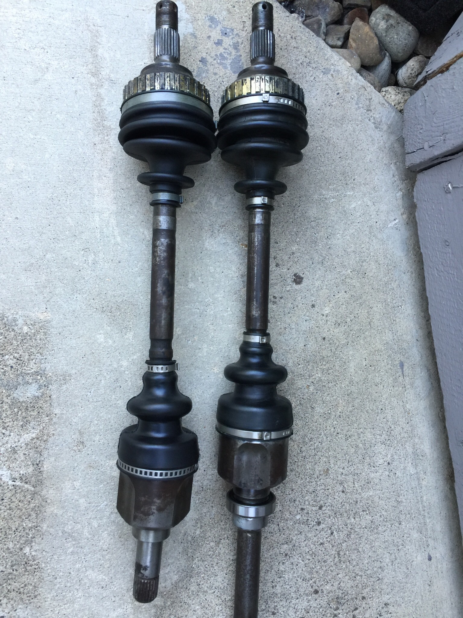

my3AWDgst Posted September 28, 2016 Author Report Posted September 28, 2016 Built my self spare set of axles for quick replacment. #loweredcarproblems Quote
andrethx Posted September 28, 2016 Report Posted September 28, 2016 very nice! i have been noticed the "clicking" Â when i turn my steering wheel all the way to the right or left, so i imagine i will be replacing the axles in the not-to-distant future....i was thinking of going with rebuilt units, i've heard good things about raxles.... Quote
my3AWDgst Posted September 29, 2016 Author Report Posted September 29, 2016 8 hours ago, andrethx said: very nice! i have been noticed the "clicking" Â when i turn my steering wheel all the way to the right or left, so i imagine i will be replacing the axles in the not-to-distant future....i was thinking of going with rebuilt units, i've heard good things about raxles.... I love any OEM axle and I'm not a big fan of rebuilt units,If I was you I would disassemble them,clean them,replace C.VÂ grease,C.V boots and intermediate shaft bearing. I'm pretty sure that will make clicking noise go away and you will be satisfied. Quote
Goce Posted September 29, 2016 Report Posted September 29, 2016 I agree with keeping the oem axles, i've changed couple axle sets on my father's 405, aftermarket axles simply don't last and you may run in different ABS ring on some of them, its a dirty job to clean them and pack them with grease but parts are cheap and should last you more miles. Quote
