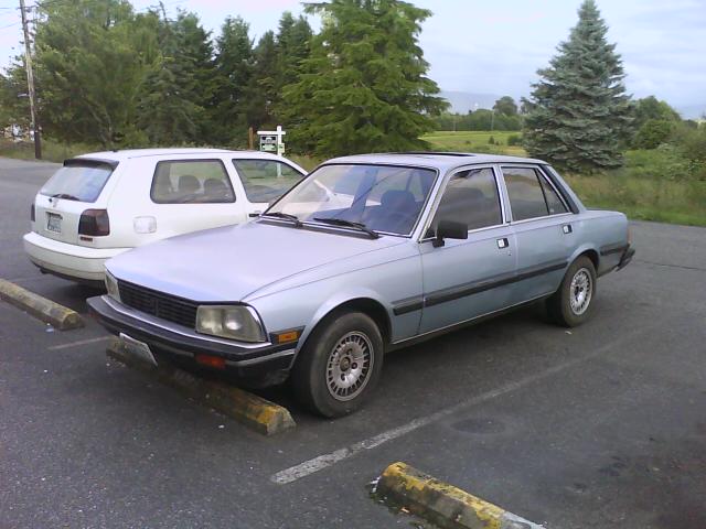

Hey everyone! my name is Jake and I just picked up my first diesel; and its also my first turbo vehicle! It has 161xxx miles on it, The body is in decent shape, the interior is pretty dirty and the really just need a good cleaning-
I bought it yesterday from a fellow in the area for $500, it runs and drives though not very well. There is a lot of shaking in the steering and the brakes are almost nothing. When I bought it the guy said there brakes were done on the front passenger side, which when i brake it pulls over there so I'm assuming drivers side is in need of help as well.
What type of maintenance does one do with a diesel vehicle? also how do you tell if your turbo is fully functioning? Does anyone has a copy of a 505 diesel repair manual or anything I could buy off them? As of right now I think that would be the best way for me to fix most of the issues and find issues at this point.

post-1235-0-22658200-1341421979_thumb.jp

Your immediate problem with your sunroof is that the sunroof cable sheath is likely split and it can't push it shut. There are ~4 plastic pop rivets on the rear facing edge of the interior sunroof panel, pop those off to see the mechanism. You should be able to see the support that the cable attaches too - and manually move it with your had to close the sunroof.
I've disconnected the cable and left the cover off so that the sunroof was usable - but the proper fix is to replace the cable itself. Best bet for that is to do something like Steffen did up: Steffen's sunroof fix

I managed to get it to move all the way forward but the part that moves the rear of the sunroof up is fighting me; not sure if I'm just moving it wrong or what.

Undo the cable at the sunroof (2x 10mm nuts) and it should move freely to close.

Yeah! well, ran downstairs to grab a few things from my daily driver and decided to move the peugeot; and found that its leaking oil. When I start it up it smokes for a second from the header area and smoked from the back but stops pretty quickly.
Leaking oil, burns oil for a second from the header area- could my turbo (gaskets?) be leaking or something along those lines to cause this?

Your car looks like a twin of mine

If you are doing the back brakes as well, be really careful with the calipers. They are easy to damage and very hard to find. The parking brake mechanism requires you to turn the slot in the piston to 1/8th turn from perpendicular to the U bolt holes, before you push it in and back to the perpendicular position for use. Failure to do that WILL damage the emergency brake mechanism. Rebuild kits do not include the parts needed to fix that. As far as I can tell those parts can not be had at any price, so if you damage them, your caliper will be no good as a core but will need to be replaced. While rebuilt calipers can be found, they are really rare, so preserve yours if you can. The front are fairly straight forward.
You should definitely change the oil and all the filters if this car has been sitting for a while. I made the mistake of not checking the air filter when I first put my car back on the road after a few years, and when I did get to it, discovered that the air filter element had disintegrated into a ball of goo. I assume you have the Nevada shaped foam air filter rather than the oil bath filter.
