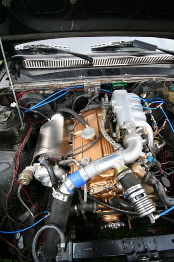

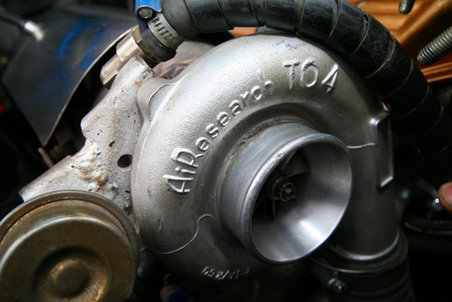

Tama Posted August 19, 2010 Report Posted August 19, 2010 Hello! I was asked to make a new topic about the engine modifications I've done to my 505 turbo. I'm sorry about my english because I dont know all the right words for every parts i've used.. I'll update the topic whenever I have time and I'll add some pictures aswell. I'm now running the engine @ 1,4 bar boost and its working very nice. No knocking or anything which could break the engine. I'm going to dyno asap so that we will see how much power this engine has. I hope that I would be able to get 300+ hp, but at this point I doubt it... The turbo might a bit too small but lets see.. Here is a short list about the engine modifications: - Volvo 2,1l Turbo (B21ET) 92,5mm Mahle pistons. (Pistons are lowered so that they come ~1mm over the block level at TDC - Block machined for those pistons - Lightened Saab 900 Turbo rods (Any saab with B or H engine (2L) from 75-> 90's, 99 and 900 model). Grinding the crankshaft to the right bearing size is needed - Grinded Dans cam + lash caps - Ported head - Head casket with separate "rings" from http://www.navalineasport.it/home_eg.htm They know N9T casket since I've sent one used casket there as a model. I've ordered several caskets from them.. to V-M as well - Garrett T03/4, comp. wheel 50mm, exh. 50mm, A/r .63 - Big cooler, custom made (about 50X40X8cm) - 3"/2,5" exhaus with one muffler - 465ml/min Bosch injectors - Lightened Flywheel - Eaton clutch set with 4 piece? sinter clutch - Vems Round Wideband lambda&EGT (EGT sensor not installed) - Megasquirt MSII (msq file can be sent if someone needs) - Ford wasted spark system (can be found from Sierra, Escort, Mondeo, Fiesta etc.) - Ford Sierra Cosworth fuel pressure regulator -Trottle position sensor changed (cant remember eather the car or the code. If needed I'll check) - 18-1 trigger wheel with Honeywell hall sensor - Ford Sierra Cosworth MAT sensor - 50mm dump valve - "Colder" spark plugs (Bosch heat rate 6) Those are the mods that quicly comes to my mind.. There are probably hundreds of smaller mods that are not listed but I'll try add them as well when they come to my mind... -Tama

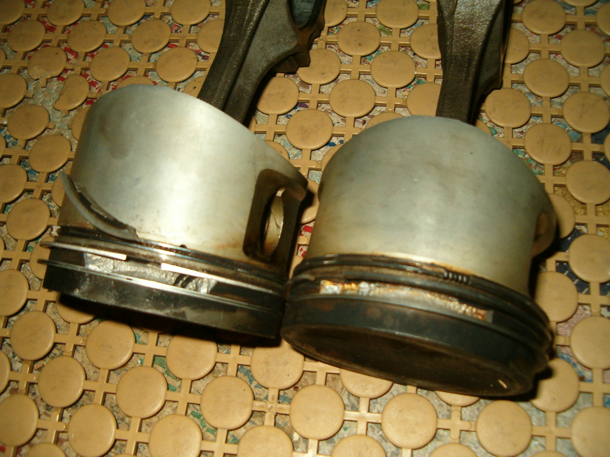

V-M Posted August 23, 2010 Report Posted August 23, 2010 must not just think pistons, it's also about the rings.... Thats the main prob with the boost with these engines Main problem is pistons, piston is allways broken first not rings. N9T piston is bad quality IMHO. I can show some pictures of pile of N9T pistons where edge between 1 and 2 ring is broken. Someting like 20 pistons I have trown to metal circulation and I still have pile of them at home. There is no that problem in Volvo pistons at all. V-M
Tama Posted August 23, 2010 Author Report Posted August 23, 2010 Main problem is pistons, piston is allways broken first not rings. N9T piston is bad quality IMHO. I can show some pictures of pile of N9T pistons where edge between 1 and 2 ring is broken. Someting like 20 pistons I have trown to metal circulation and I still have pile of them at home. There is no that problem in Volvo pistons at all. V-M I've had problems with both piston rings and pistons... Those where the main reason for changing to Volvos pistons. -Tama

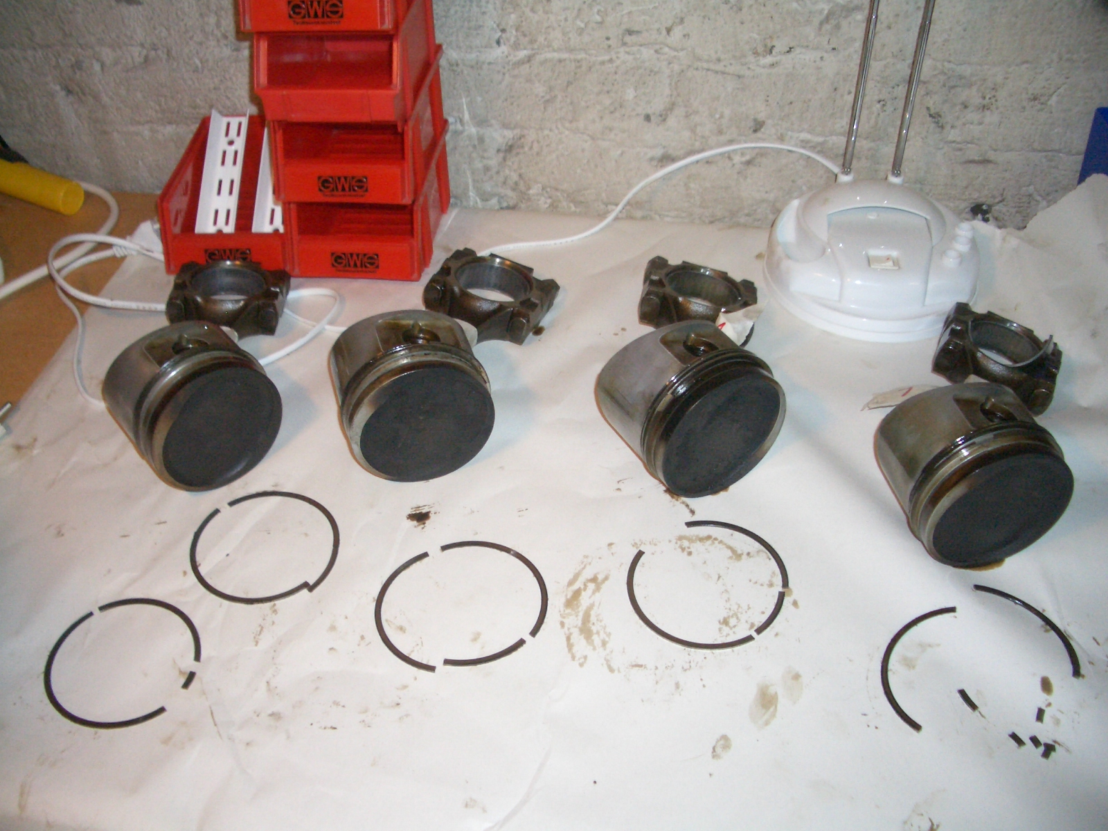

nick@nite Posted September 13, 2010 Report Posted September 13, 2010 Quote Here is a short list about the engine modifications: - Volvo 2,3l Turbo (B23ET) 92,5mm Mahle pistons. (Pistons are lowered so that they come ~1mm over the block level at TDC Want to know more about what you mean by 1mm over the block level @ TDC? Do you mean the pistons needed shaving and how much? Can't really tell in the pic if the pistons are concaved? Also I see V-M has used 95mm pistons, wondering what those are use in? I priced up the piston through my uncle that works @ the Volvo dealer, $300 for the whole 92.5MM piston kit...
Tama Posted September 14, 2010 Author Report Posted September 14, 2010 Quote Here is a short list about the engine modifications: - Volvo 2,3l Turbo (B23ET) 92,5mm Mahle pistons. (Pistons are lowered so that they come ~1mm over the block level at TDC Want to know more about what you mean by 1mm over the block level @ TDC? Do you mean the pistons needed shaving and how much? Can't really tell in the pic if the pistons are concaved? Also I see V-M has used 95mm pistons, wondering what those are use in? I priced up the piston through my uncle that works @ the Volvo dealer, $300 for the whole 92.5MM piston kit... Sorry about the bad pictures. Pistons are concaved and I made spots for the valves as well so that they dont hit the piston. I ment that when the pistons are in their most upper position they come a bit (~1mm) over the block level. hmm.. cant tell it better.. The idea is to reduce the pressure from the head caskets down side.
V-M Posted September 15, 2010 Report Posted September 15, 2010 Also I see V-M has used 95mm pistons, wondering what those are use in? I priced up the piston through my uncle that works @ the Volvo dealer, $300 for the whole 92.5MM piston kit... My was also volvo pistons 96mm from 2.3L B23ET (or B230ET I'm not sure) turbo engine. Those 92mm pistons are from 2.1L (B21et) turbo engine which is bit older volvo engines. V-M

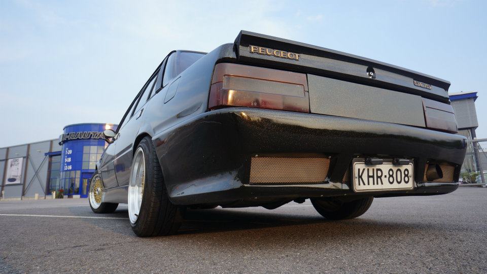

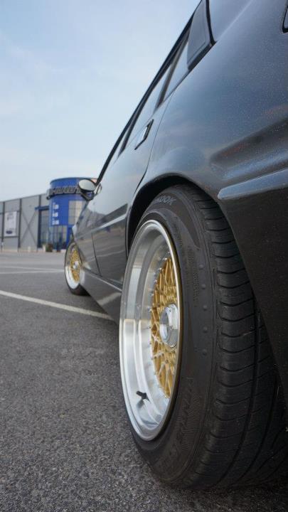

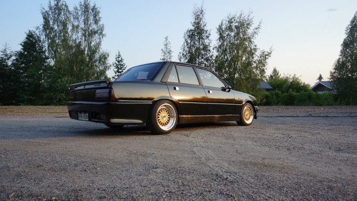

Tama Posted August 27, 2012 Author Report Posted August 27, 2012 New rims... The car has been working quite well now for more than two years with 1,5 bar boost so apparently I've done something right when building and tuning the engine.. The only problem is that I have a oil leak in the énd of the crank shaft or at the gearbox resulting to make the clutch slip with the 4th and 5th gears. The slipping appears only once in a while which makes it weard... No I tried "thicker" engine oil and it seems to work bit better.. -Tama
andrethx Posted August 27, 2012 Report Posted August 27, 2012 very nice! the gold goes very well with the color scheme of your car. these rims are not 140 pcd, are they? do you use adapters or have you modified your hubs? tama, it gets very cold in your part of the world, doesn't it? do you have a separate set of wheels and tires for winter, or do you not drive the car at that time of year? it's very exciting to see such a well-loved, heavily modified 505! andré
ohms Posted August 30, 2012 Report Posted August 30, 2012 damn, that is just too sweet. well done tama!
