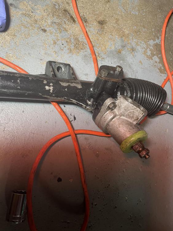

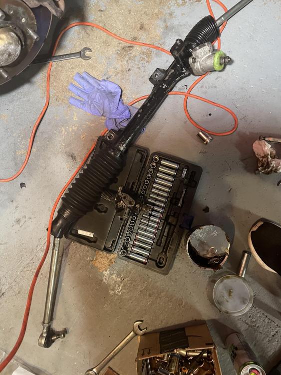

I feel like the issue may be a bad pinion. Or just a bad rack itself. I didn’t have any of these issues before changing that rack and pinion.

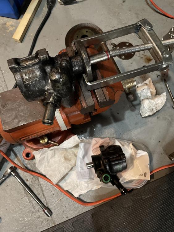

so far I jacked the car up, drained the power steering fluid. With no fluid in the Peugeot, when I turn the tire , I don’t feel like locking. I refilled it, reconnected the high pressure hose. Reconnected the battery, turned the car on and there it is again, feel it in the steering wheel. Turn the car offc manually turn the tire, and feel it locking again.
so right now I’m changing the pump. Though I don’t think it’s that, it’s something to rule out.
