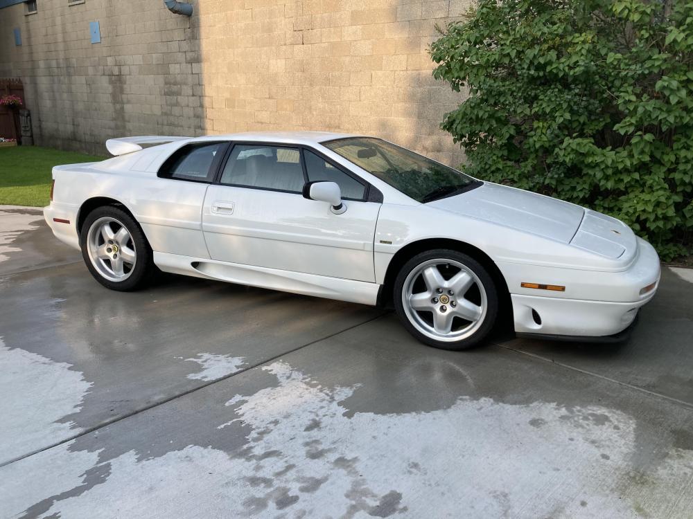

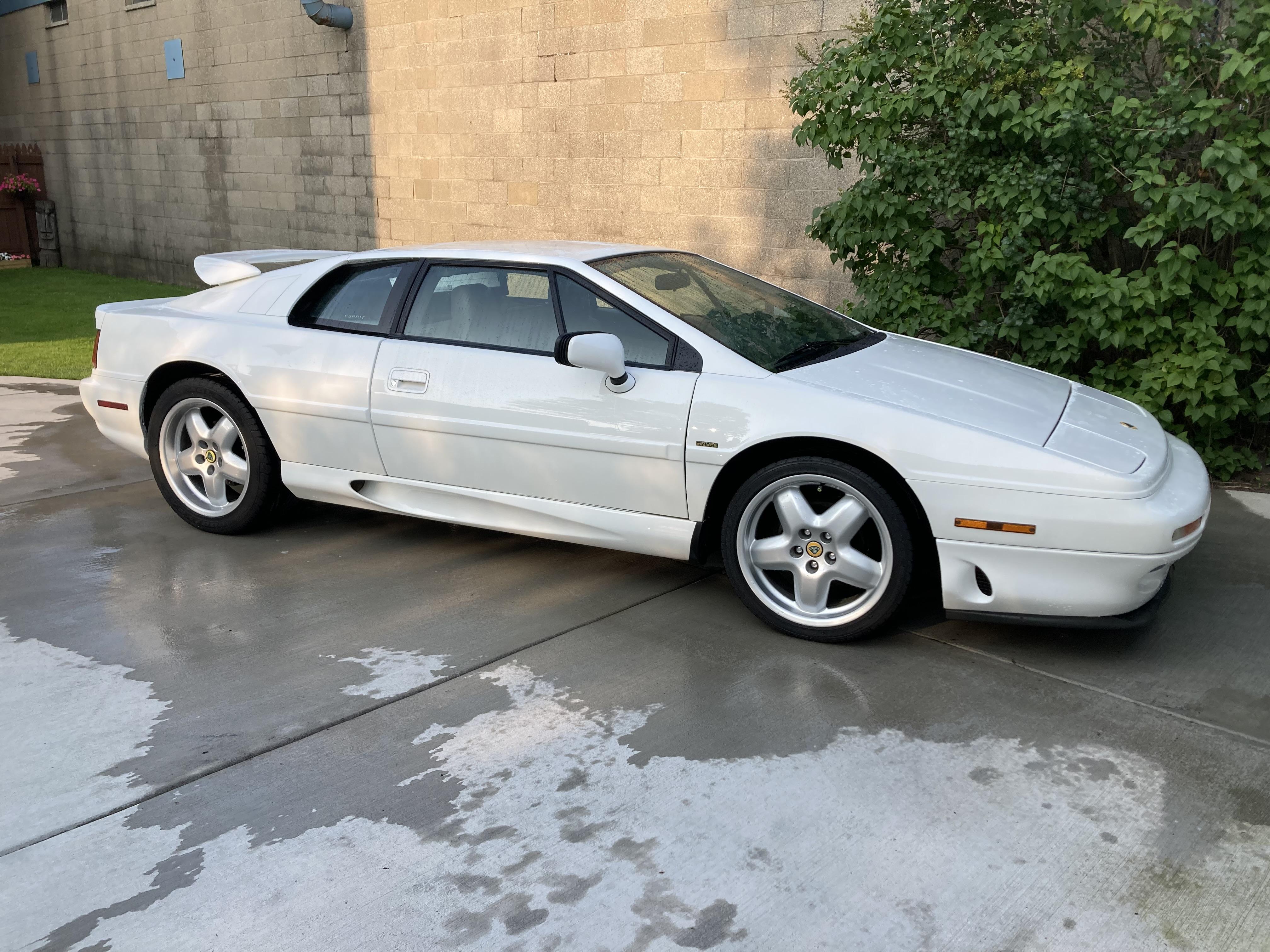

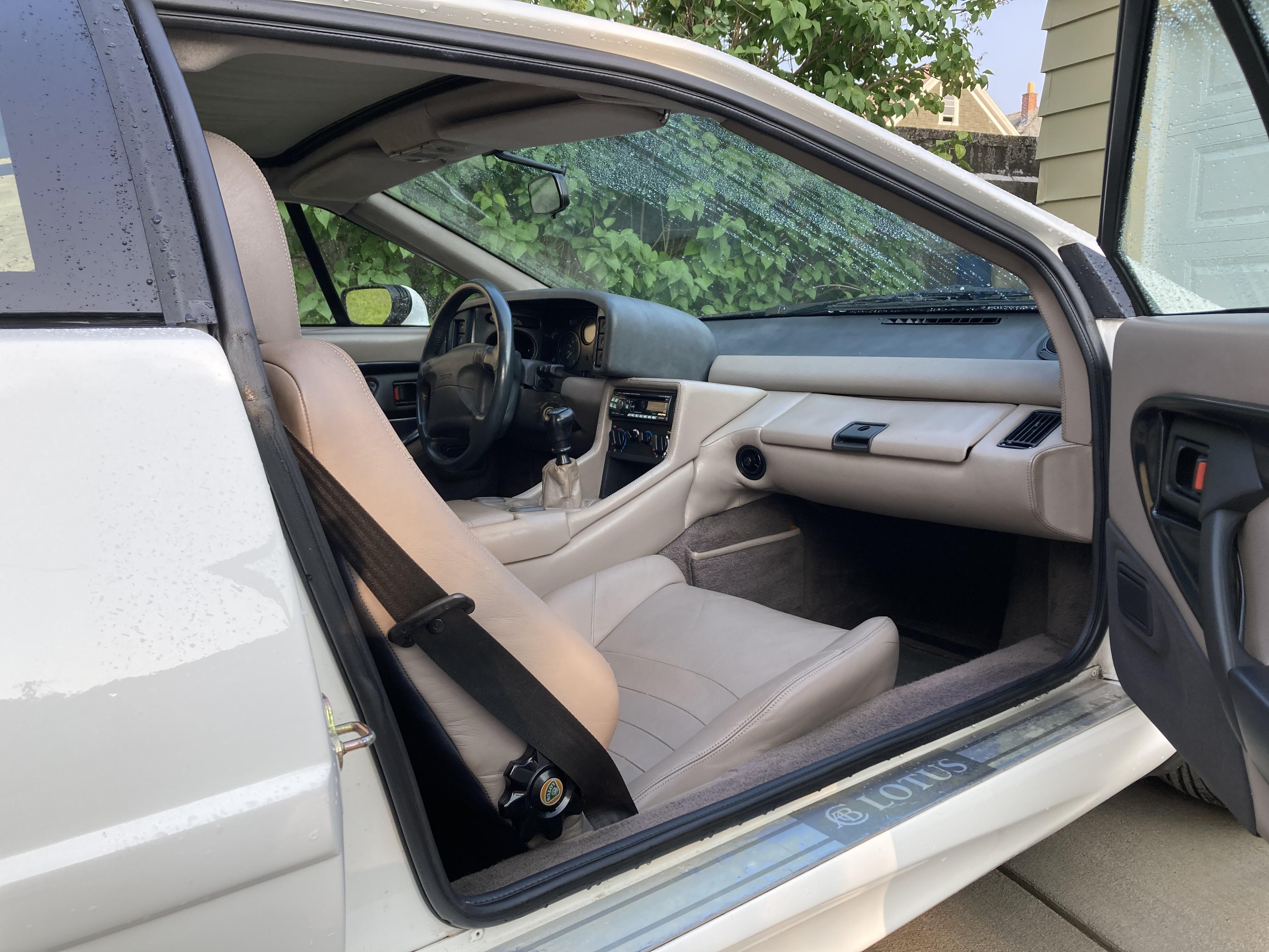

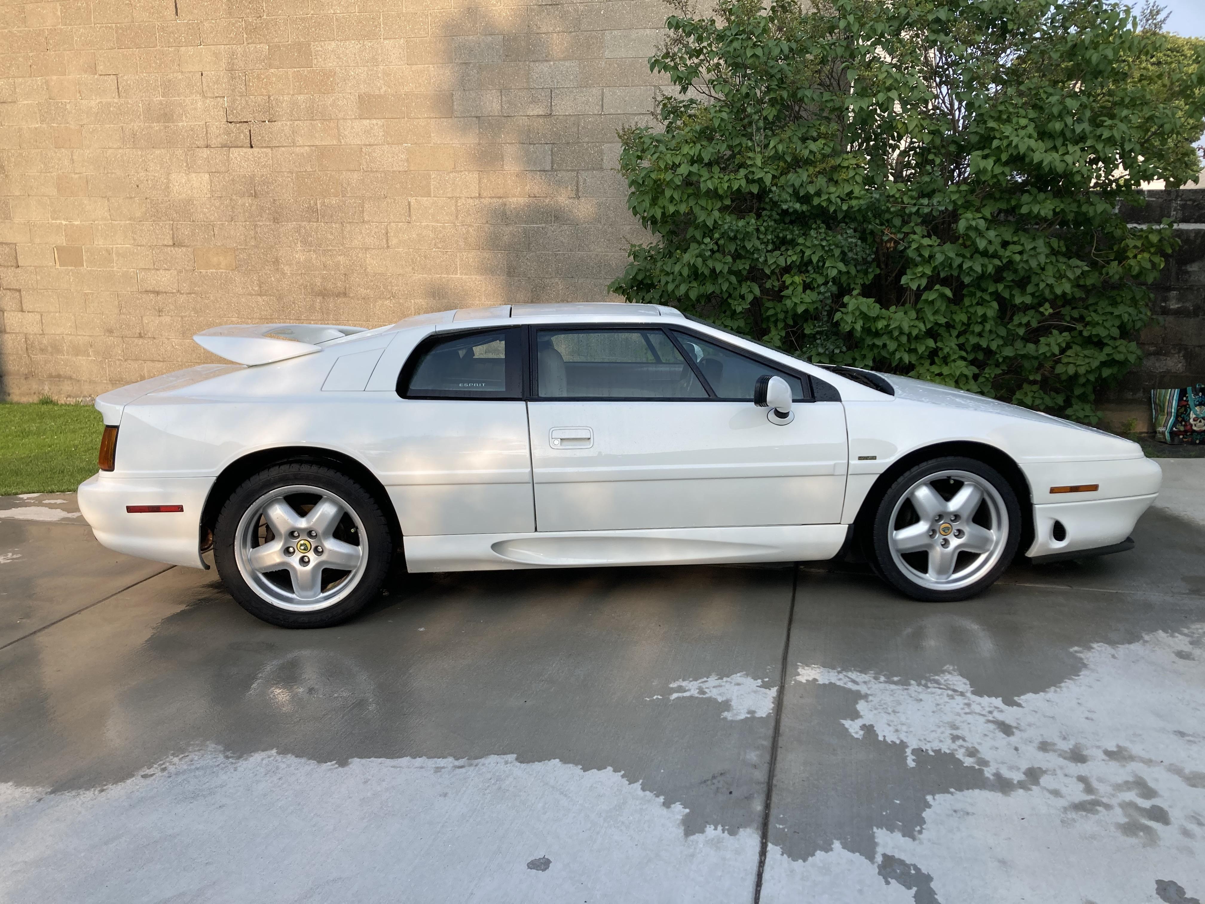

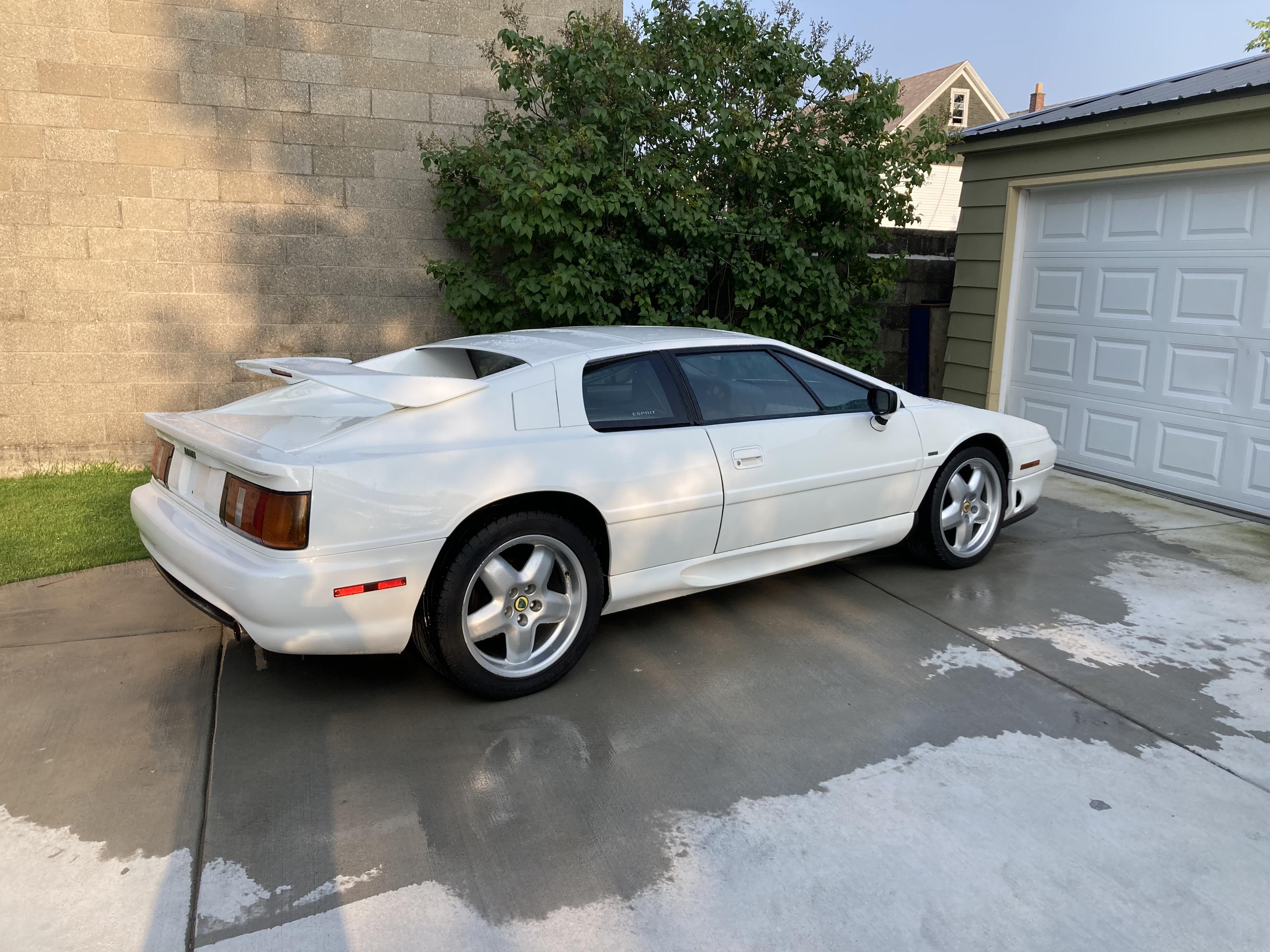

  2. Gentlemen, been a while since my last check in... There has been almost no Peugeot content to share since my last update, just seems to be one of those years. Also, some other cars joined the fleet, namely my new to me 1987 Lotus Turbo Esprit. This was not a planned acquisition, but it will be a great fall/winter project. More details to come, but here are some shots of it as it sits now. And yes, we will be making a Bond car replica (on a budget of course)... For reference, to the younger crowd: https://supercarnostalgia.com/blog/lotus-esprit-turbo-for-your-eyes-only

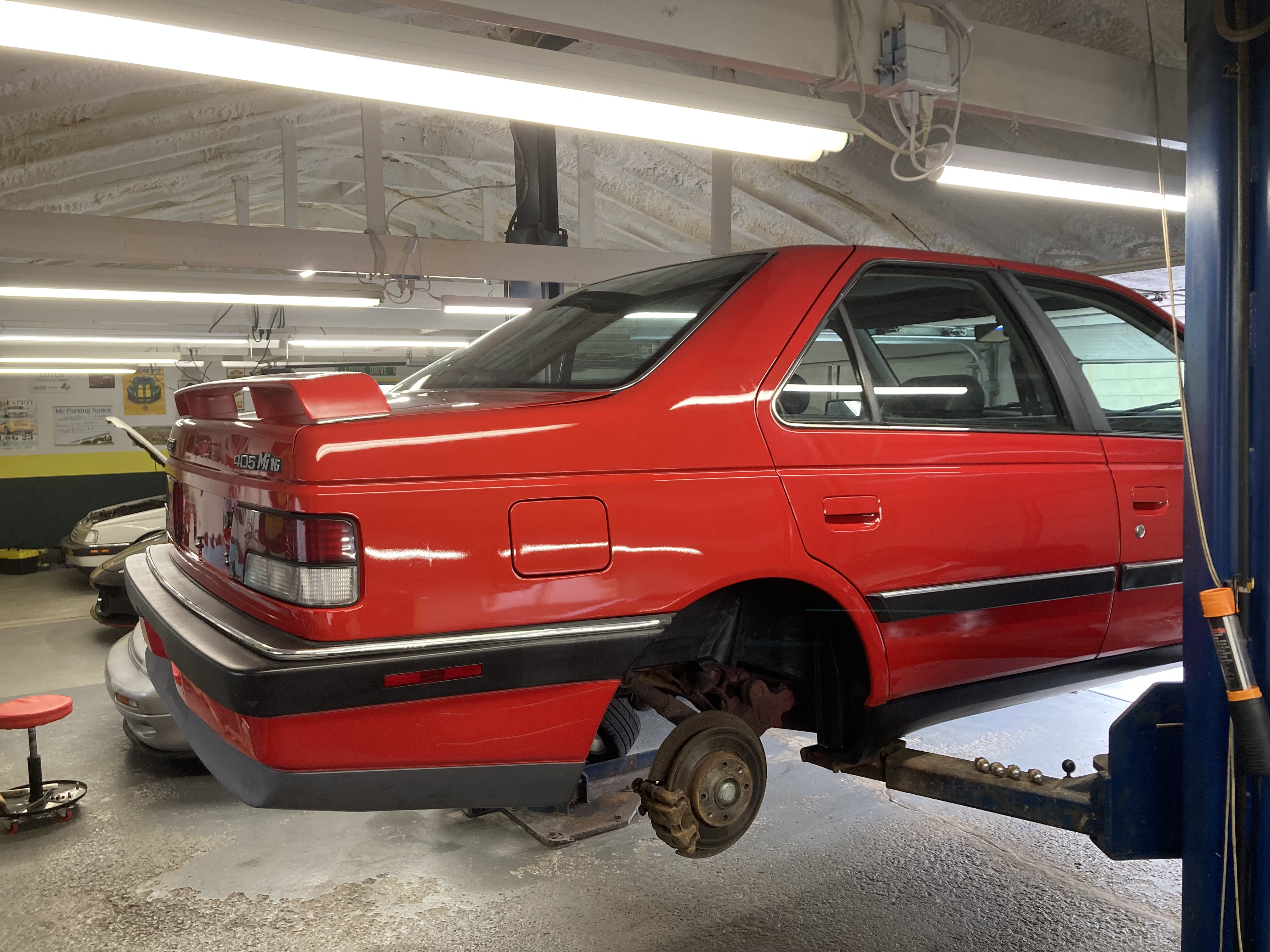

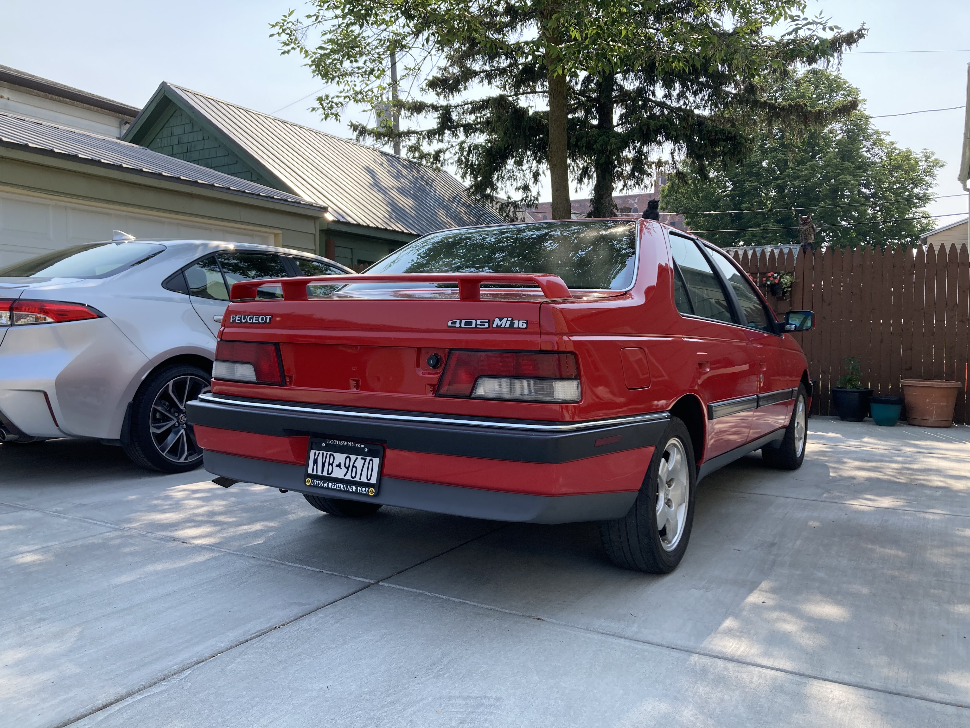

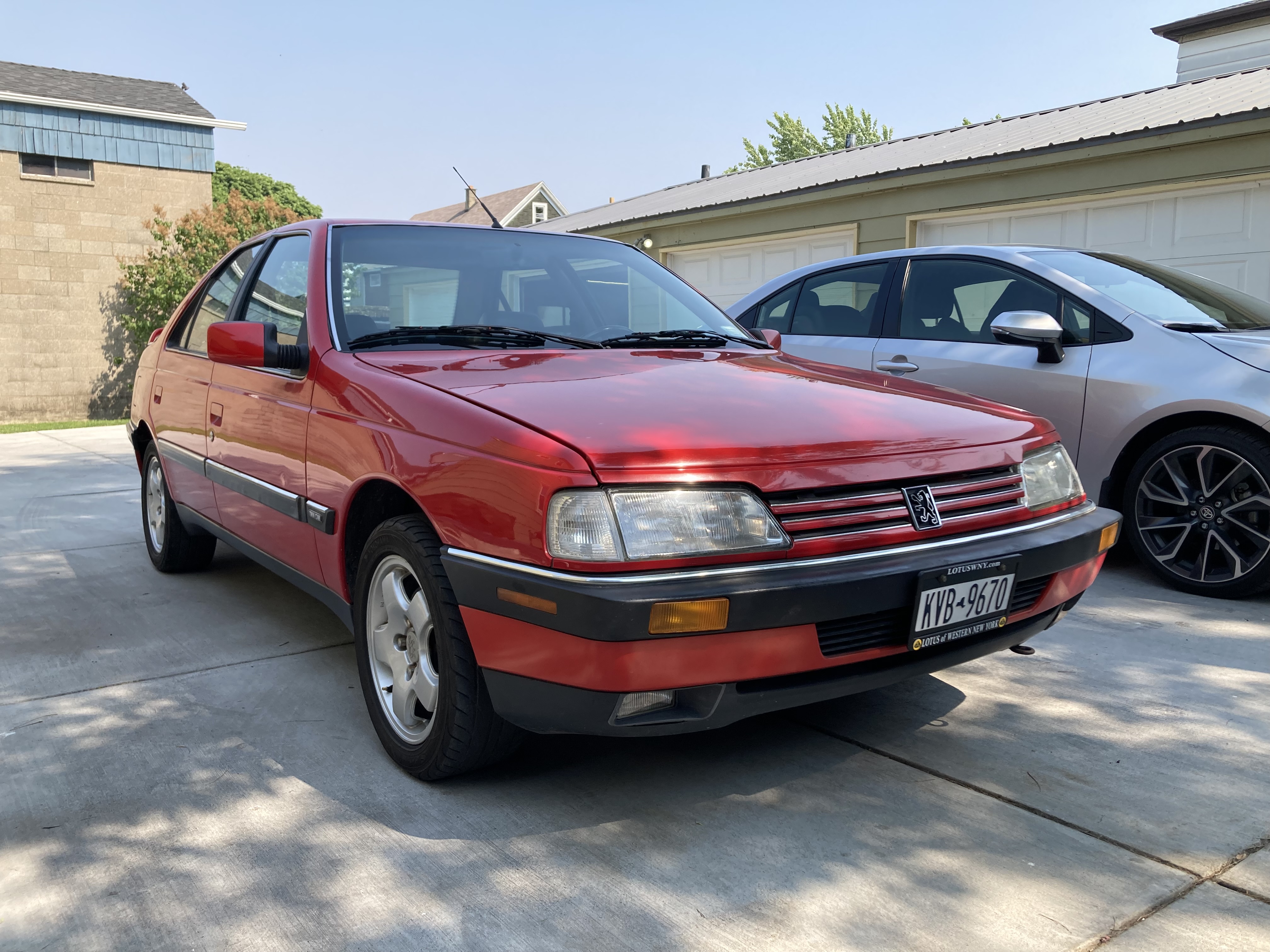

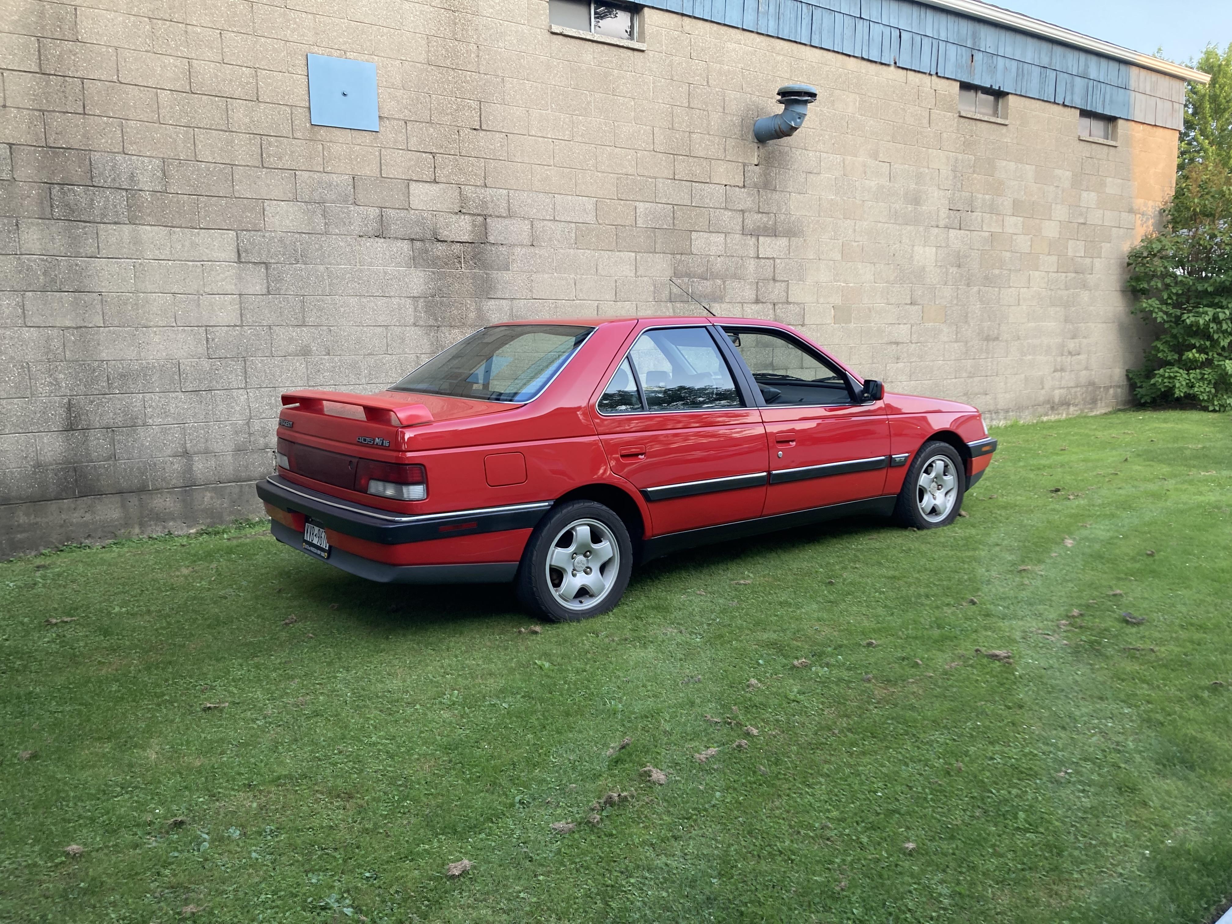

  3. Haven't done much car stuff lately, too much work this time of year... Ultimately though, these cars (all of them) are *pretty much* done. Little odds and ends of course to keep them fresh and updated with fluids/consumables are all that's really going to be needed from here on out. Here's my shortlist for the 3 cars at the moment. 1990 Sportwagon - New VCG, new set of injectors, paint the door handles. 1991 Mi16 - Try and sort the erratic oil temp gauge, have the hood painted (still have the plasti-dip, holding up well). 1992 Mi16 - Adjust/replace/address rear e-brake cables and/or rebuild rear calipers, replace driver front flexible brake hose (already did passenger side), bleed brakes, new set of injectors, maybe sort the leaking exhaust manifold.

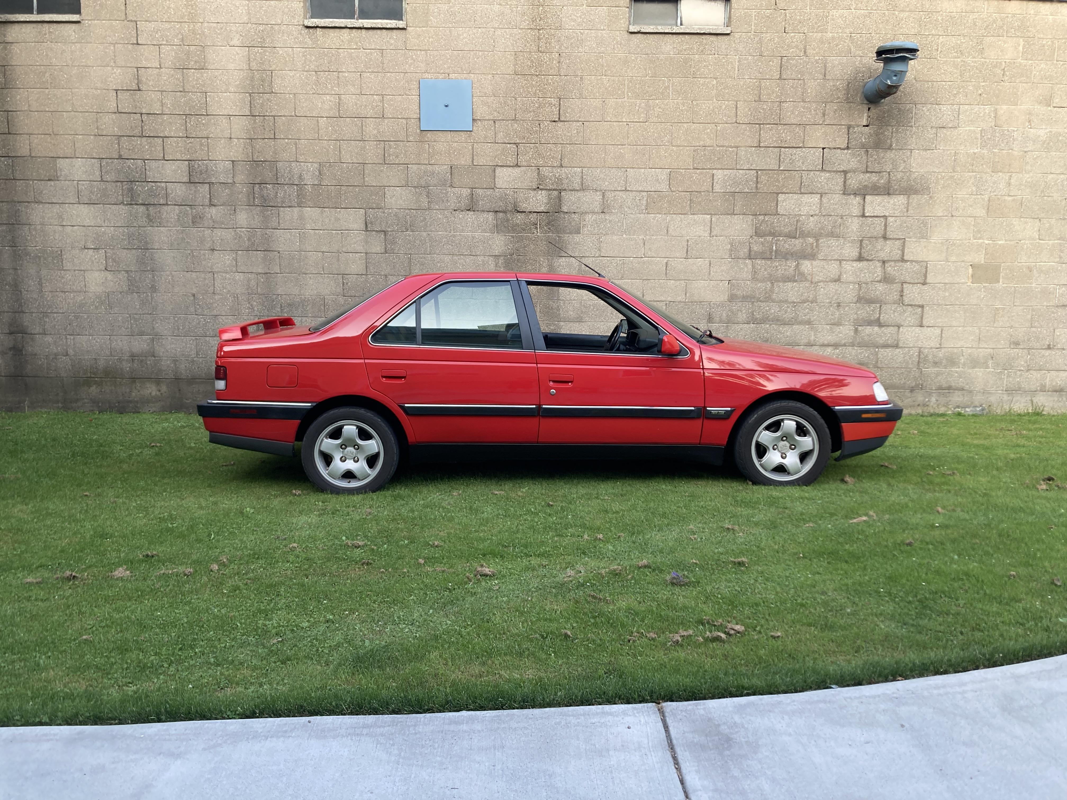

  5. Cargo carrier test fitting, roof rails will be staying on either way for easier mounting...
  6. Test fitting roof rails and first night drive since re-assembly...
