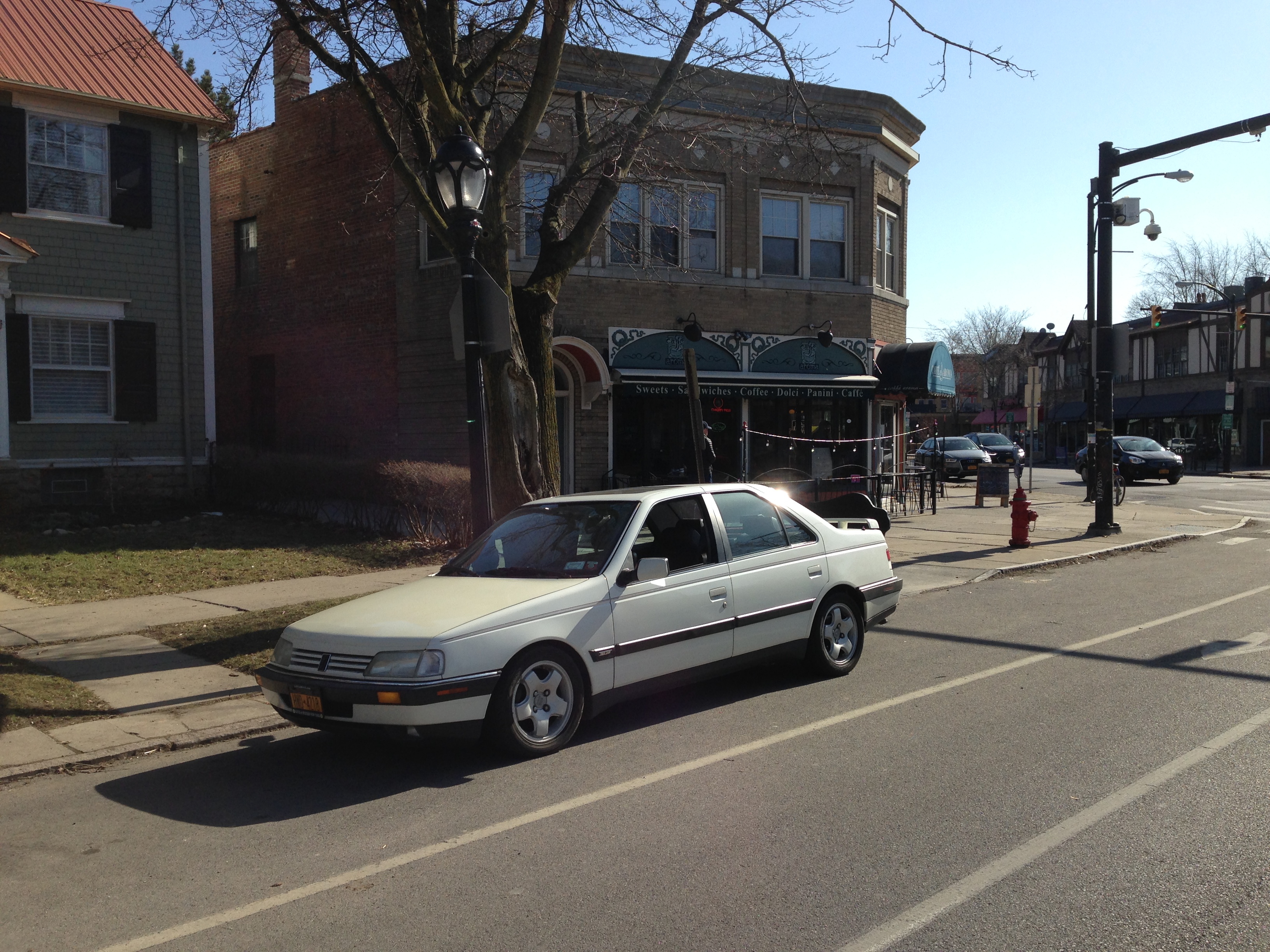

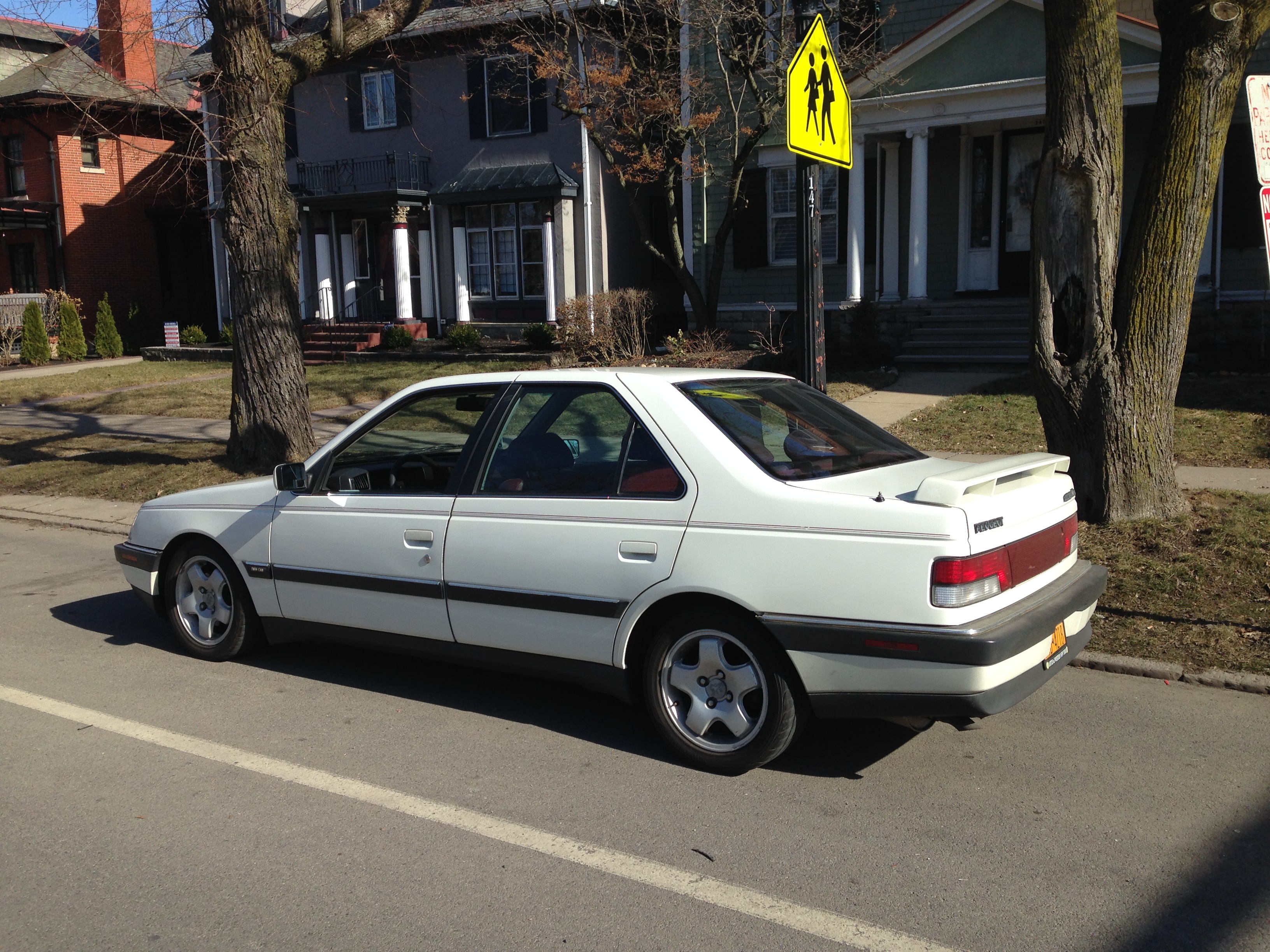

Thanks for the input guys. I took the car out for a ride today, and in the daylight, it actually doesn't look as bad as I initially thought. Still not great, but passable for now. I think I will peel it off later in the season, and just do what Mike said and spray it myself. It's simple enough to do. Here's the photos from today. -

Well, 10 coats of peel paint later, and here we are. It's both better and worse, but mostly better. This peel paint doesn't lay so great, leaves some splotchiness (this a word?), but the color match is certainly much better, and I was definitely after that. The other issue is that even though it's gloss white, the finish is quite flat. May have to buy a can of clear to finish it off. I'll drive it for a bit this way and see how much I can tolerate it...either way, not a bad investment, worth a try for $25... -
