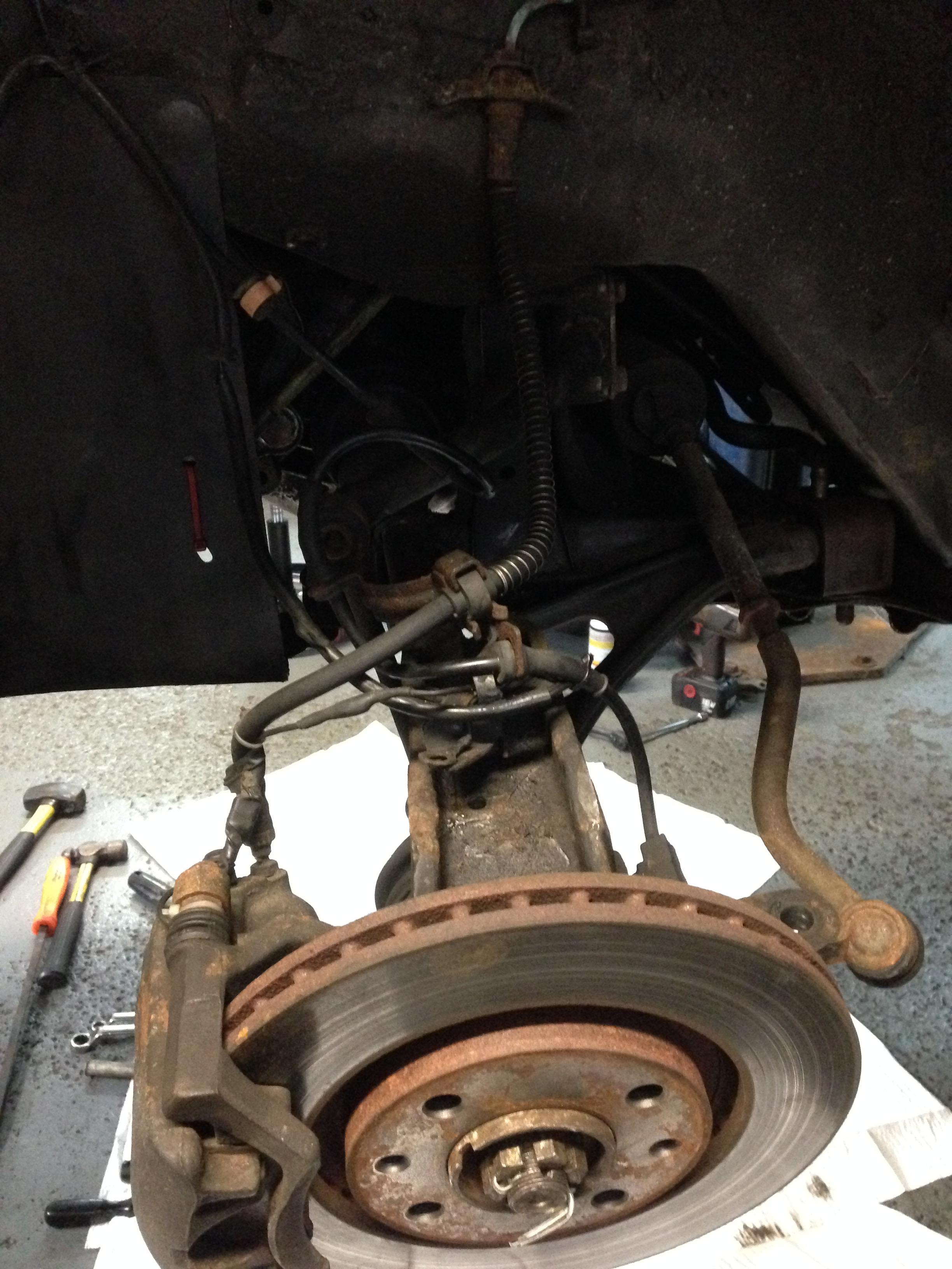

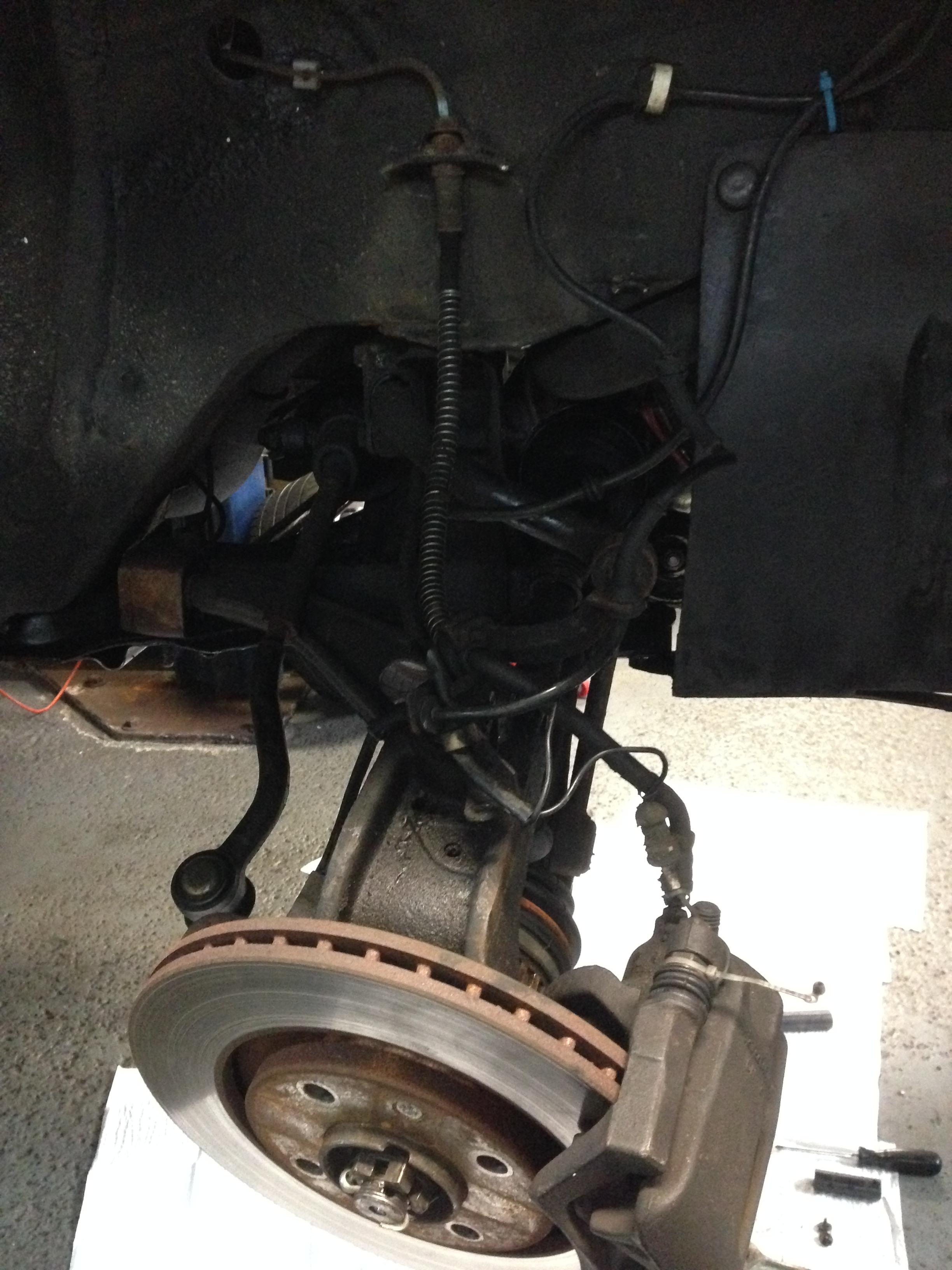

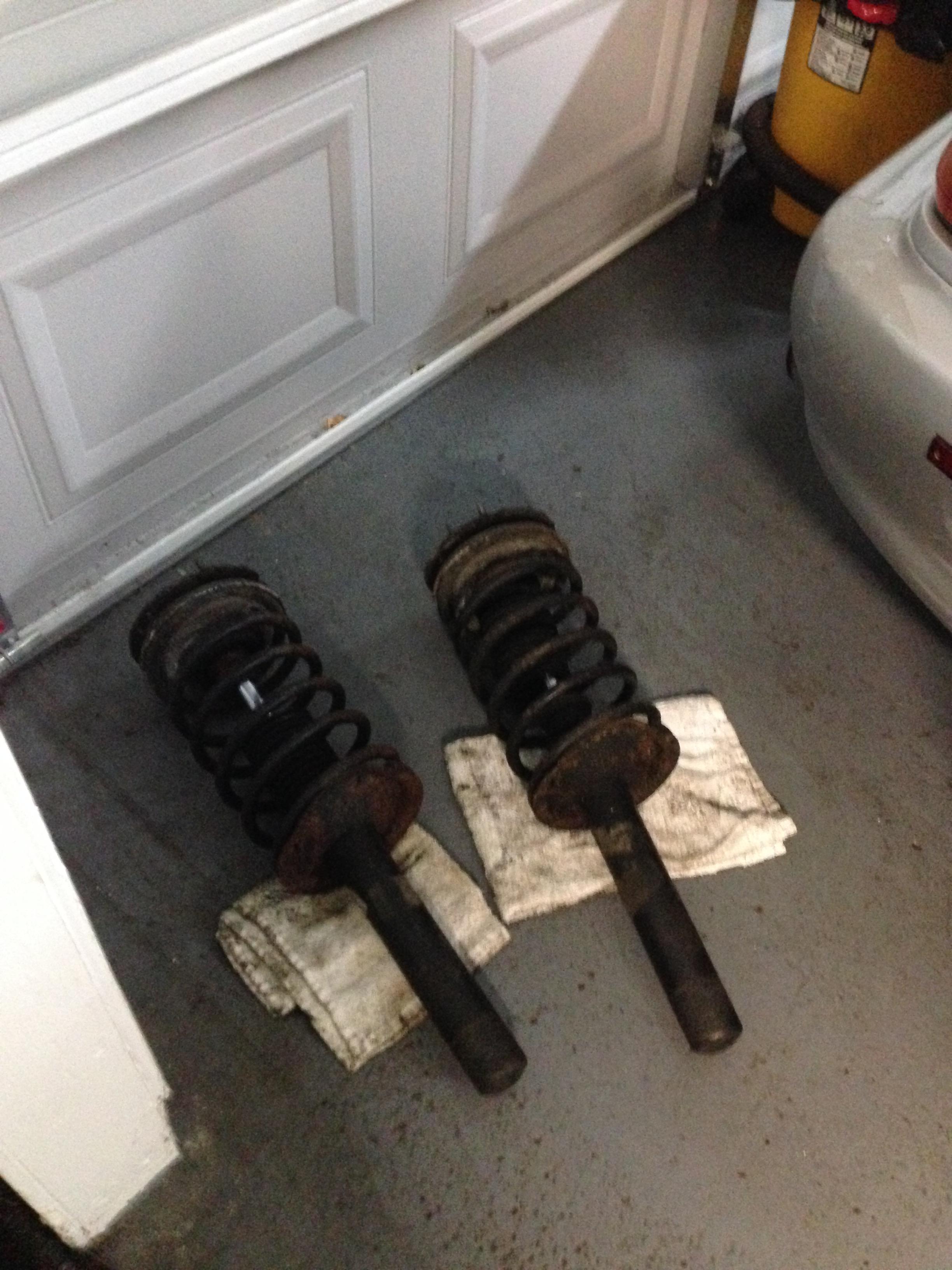

  1. Yes, Savo, thanks very much again. I have not even tackled the brakes yet, as the rotors are good all around and the pads are like new. Going to clean them down and then flush/bleed them. I'll make it a point to pick up those pin boots, thank you for that. On a different note, regarding stock OEM struts/shocks. I've now been told by 3 avid Mi16 enthusiasts that they never really need to be replaced??? I've never heard of this in my life, most oem shocks/struts need replacing by the time you're at 100K miles, if not sooner. I'm sitting at 170K, and while the ride is still great, and none of the shocks seem worn/leaky, is it safe to assume this is correct that they last forever?

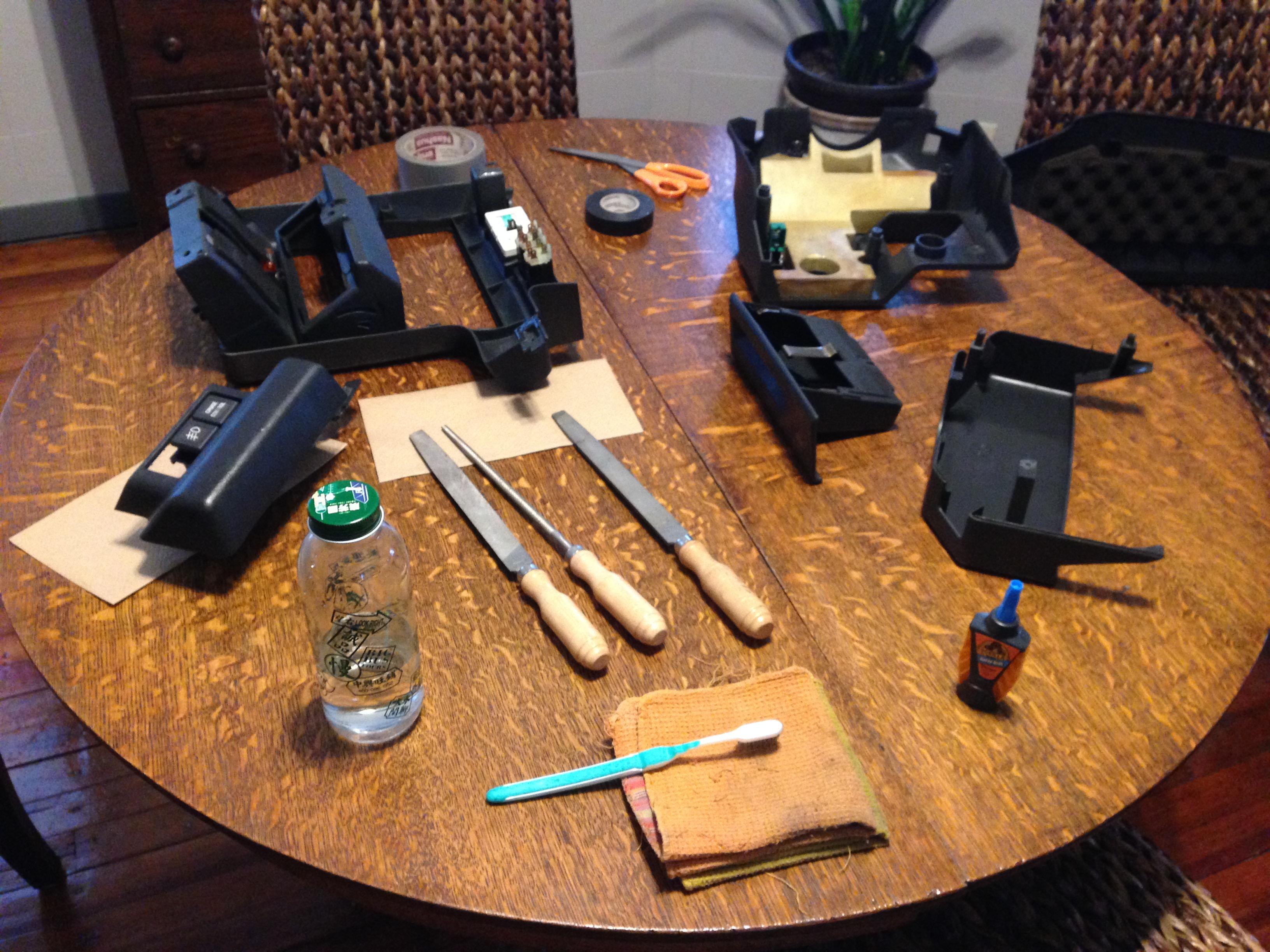

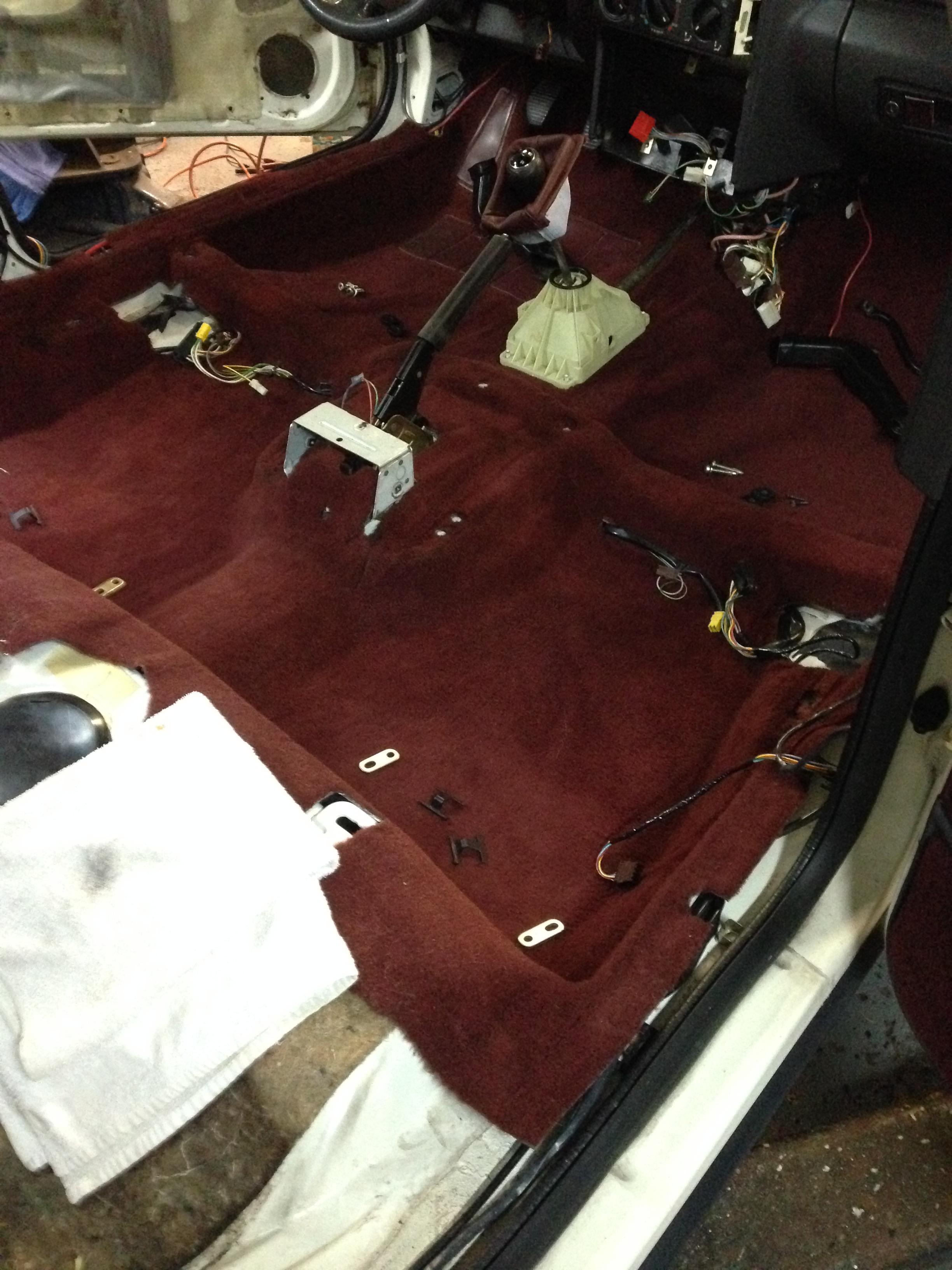

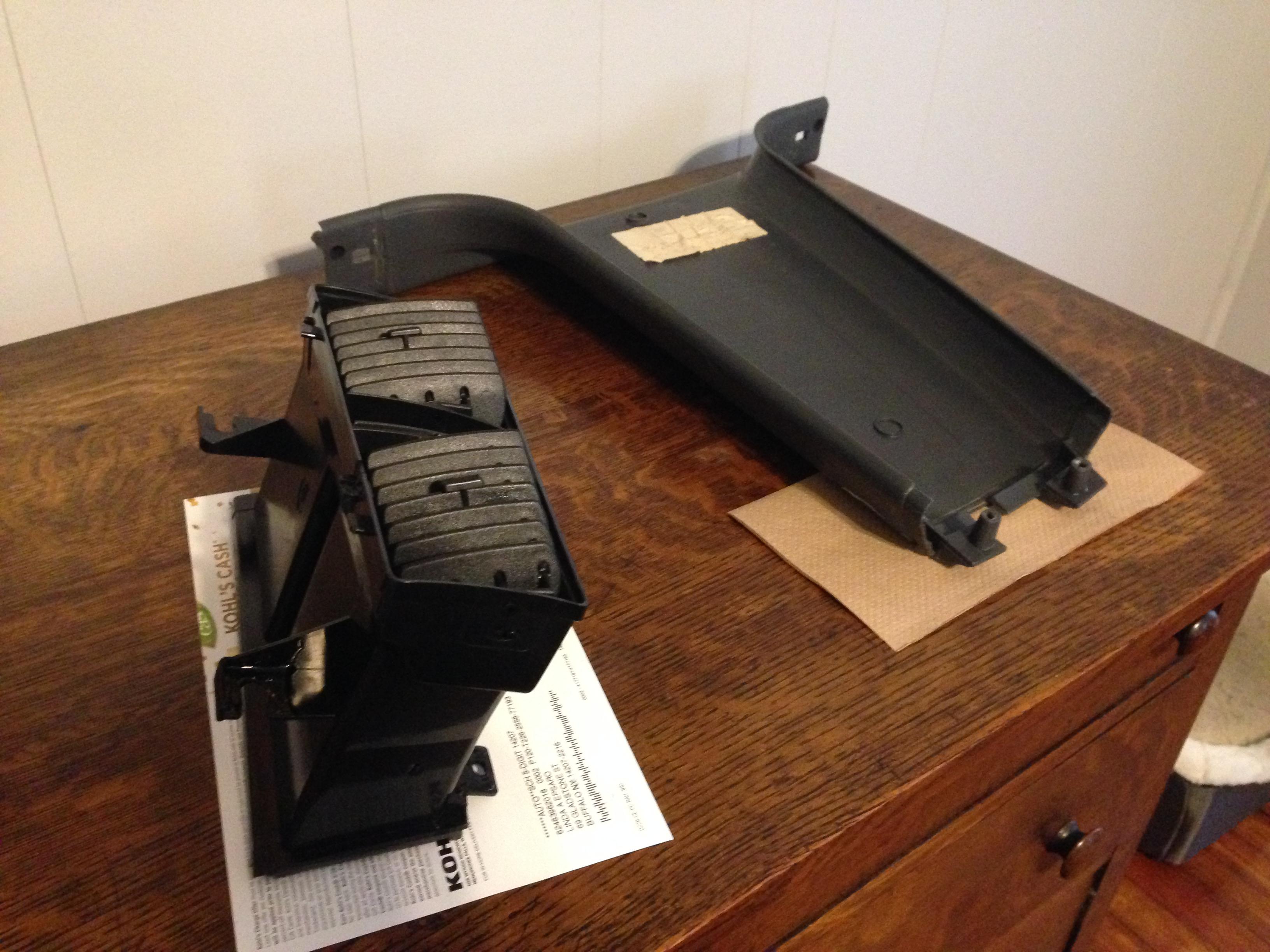

  3. I had to repair a few plastic tabs, but no big deal, I used gorilla glue to re-attach, filed down, and then did a glue matrix around the entire area that had been compromised, that way the entire area has new strength. Very annoying and tedious, but well worth it in the long run...

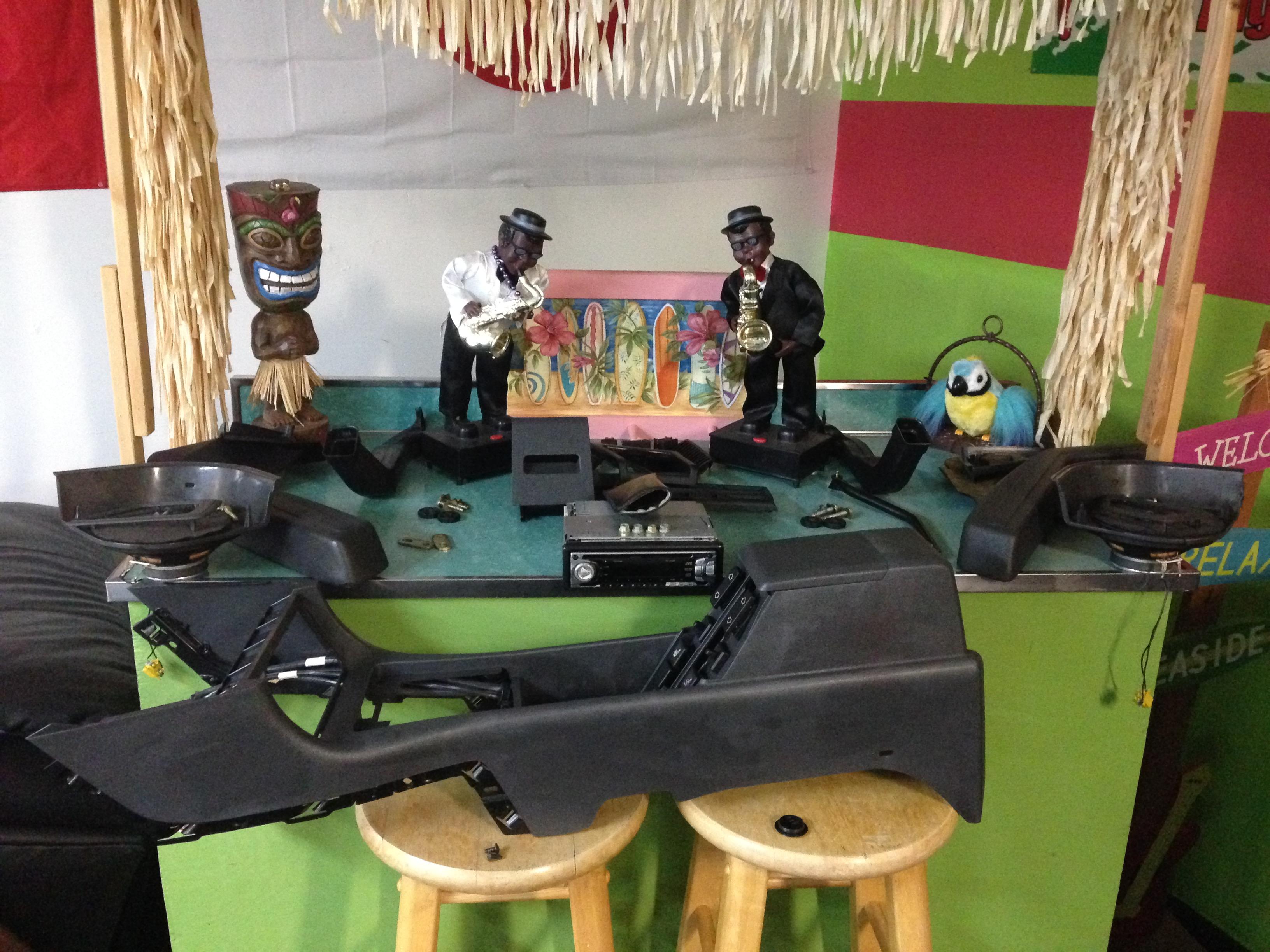

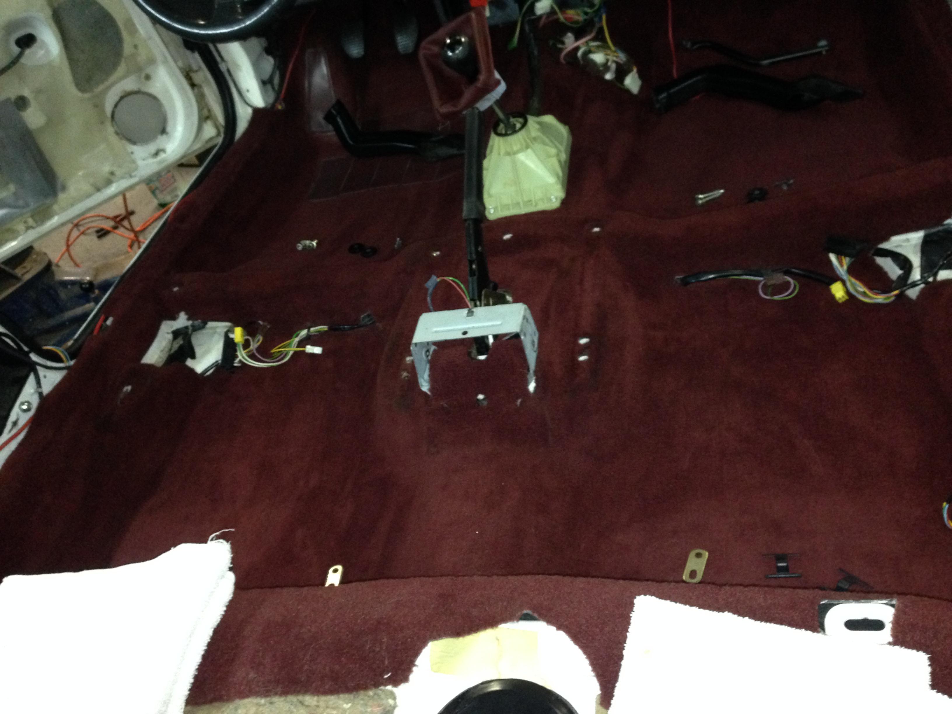

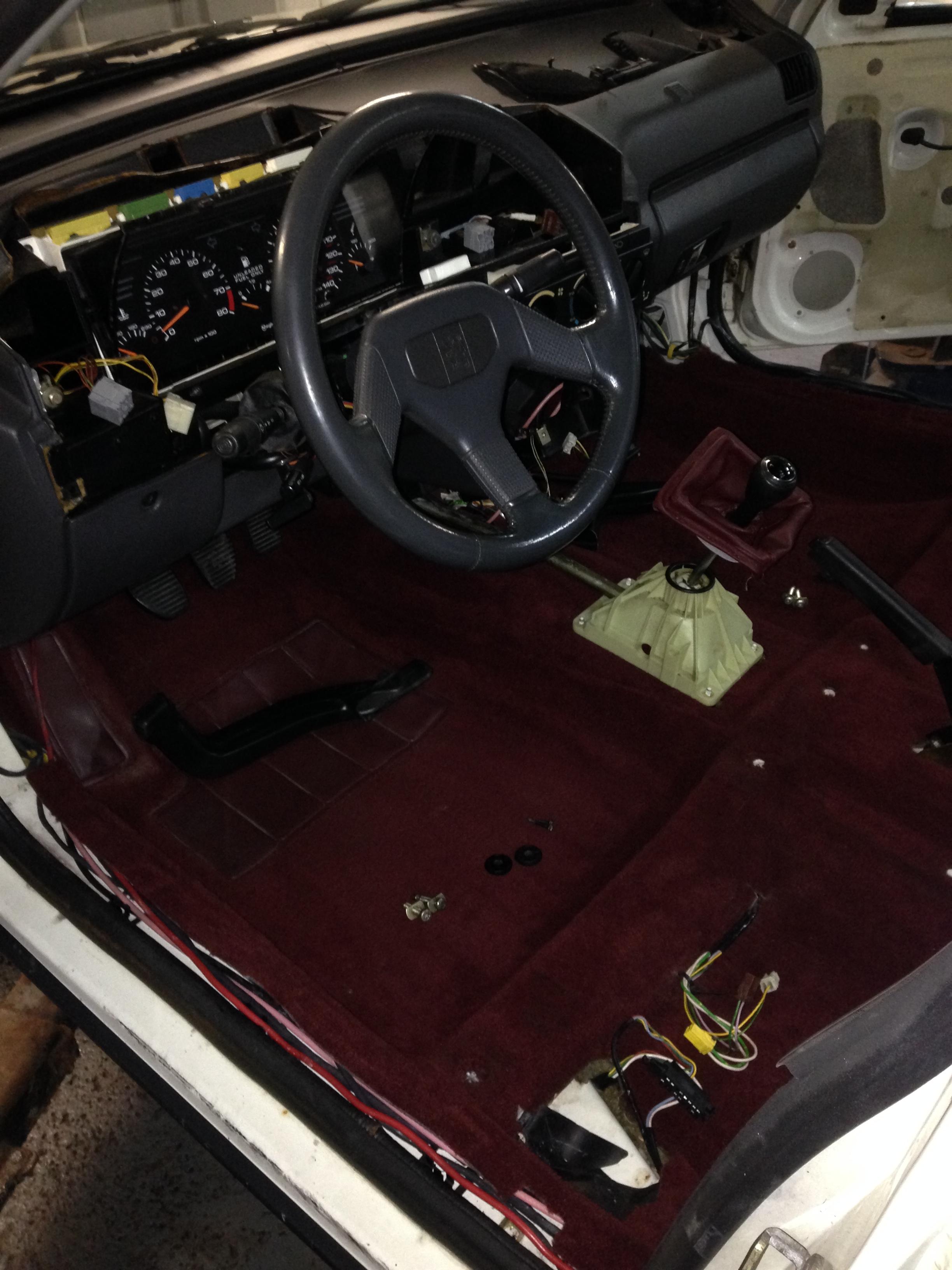

  4. I should add, before we started on any suspension work, I started an interior removal to do a deep clean, and fix all the rattles (love the interior design, but man is the dash arrangement a poor quality...). The whole entire interior, and actual dash and carpet will be removed again probably at the end of the driving season, but for now I want to get it back together so I can drive it. I hate doing work twice, but this does make the most sense at least for now to get back on the road. And it's a good thing I did this now, as all the dash parts that easily come off had not been put back on properly, most likely due to the goofy radio/amp set up that one of the prior owners had done. Either way, all good now...

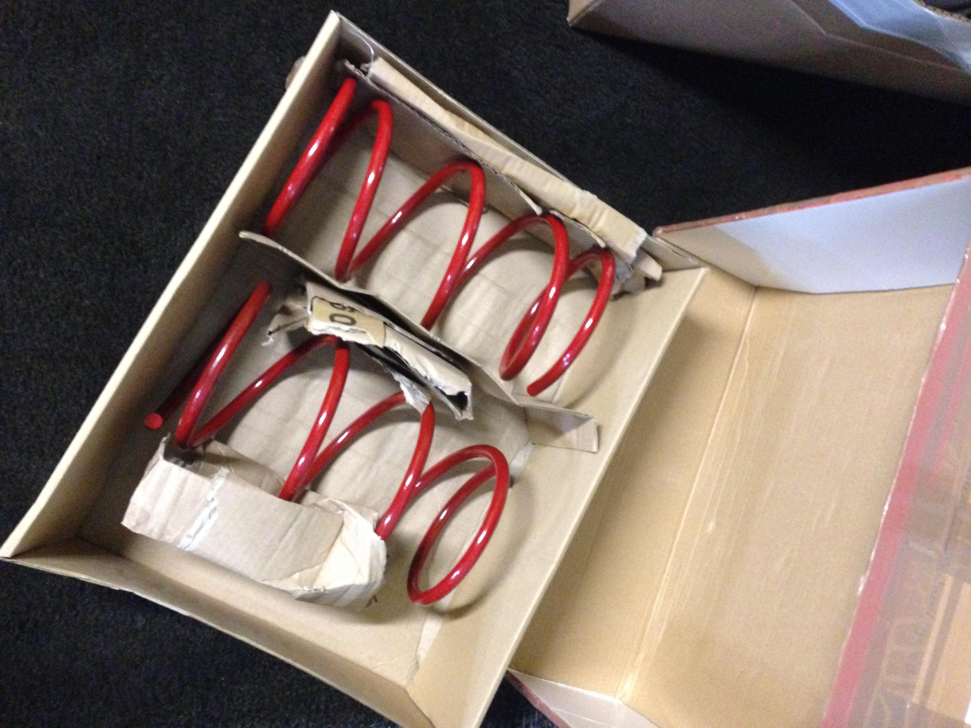

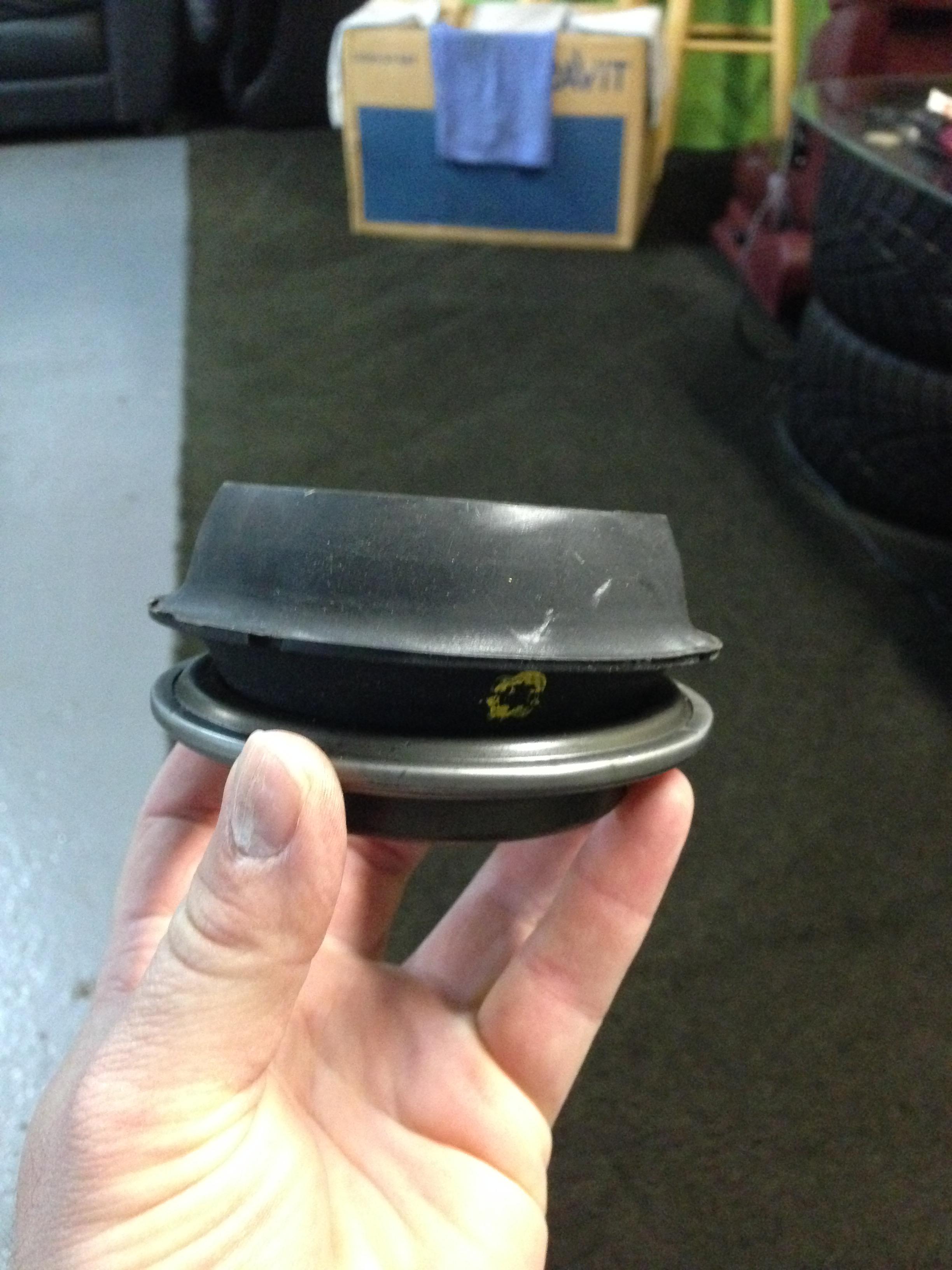

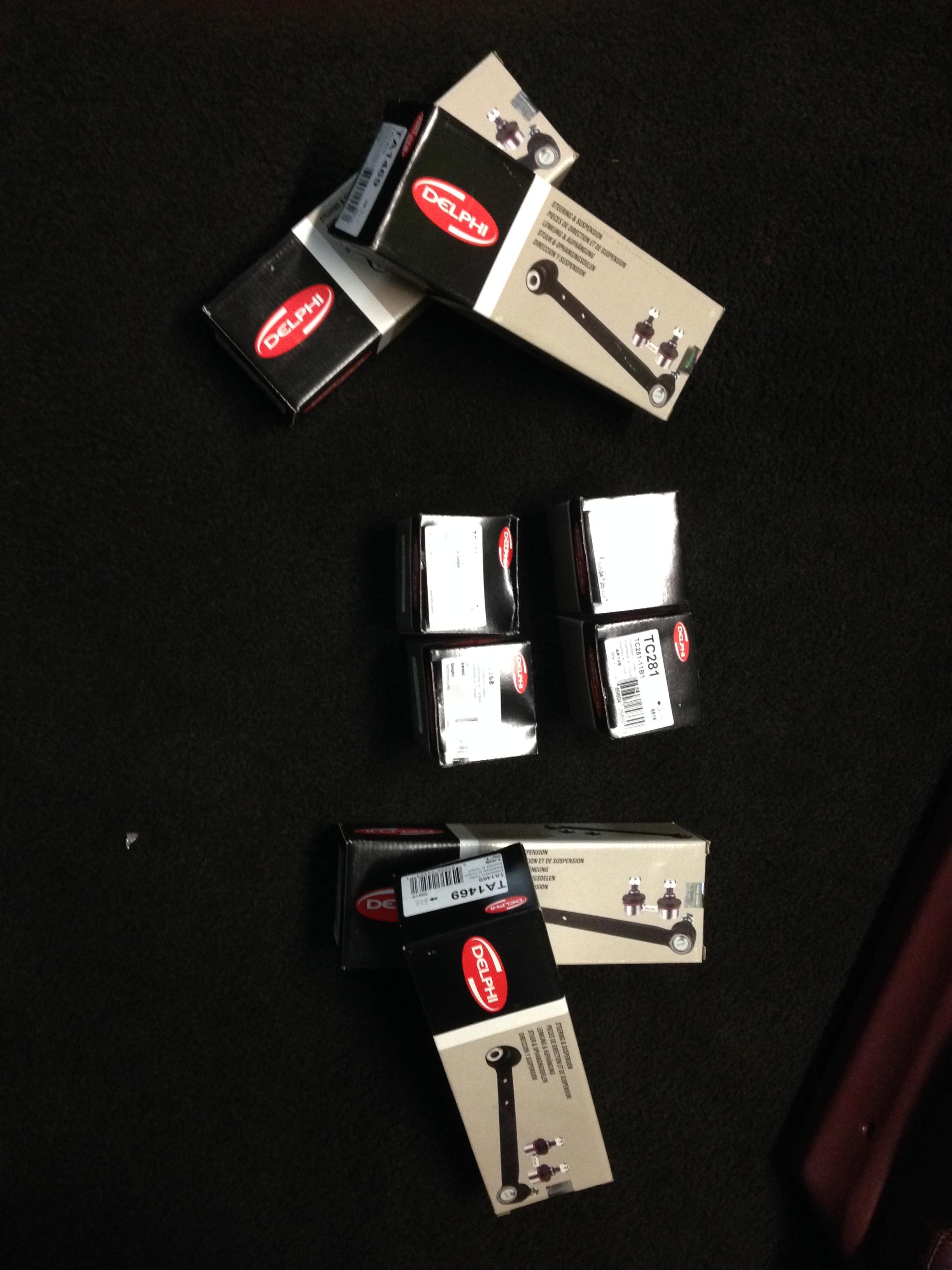

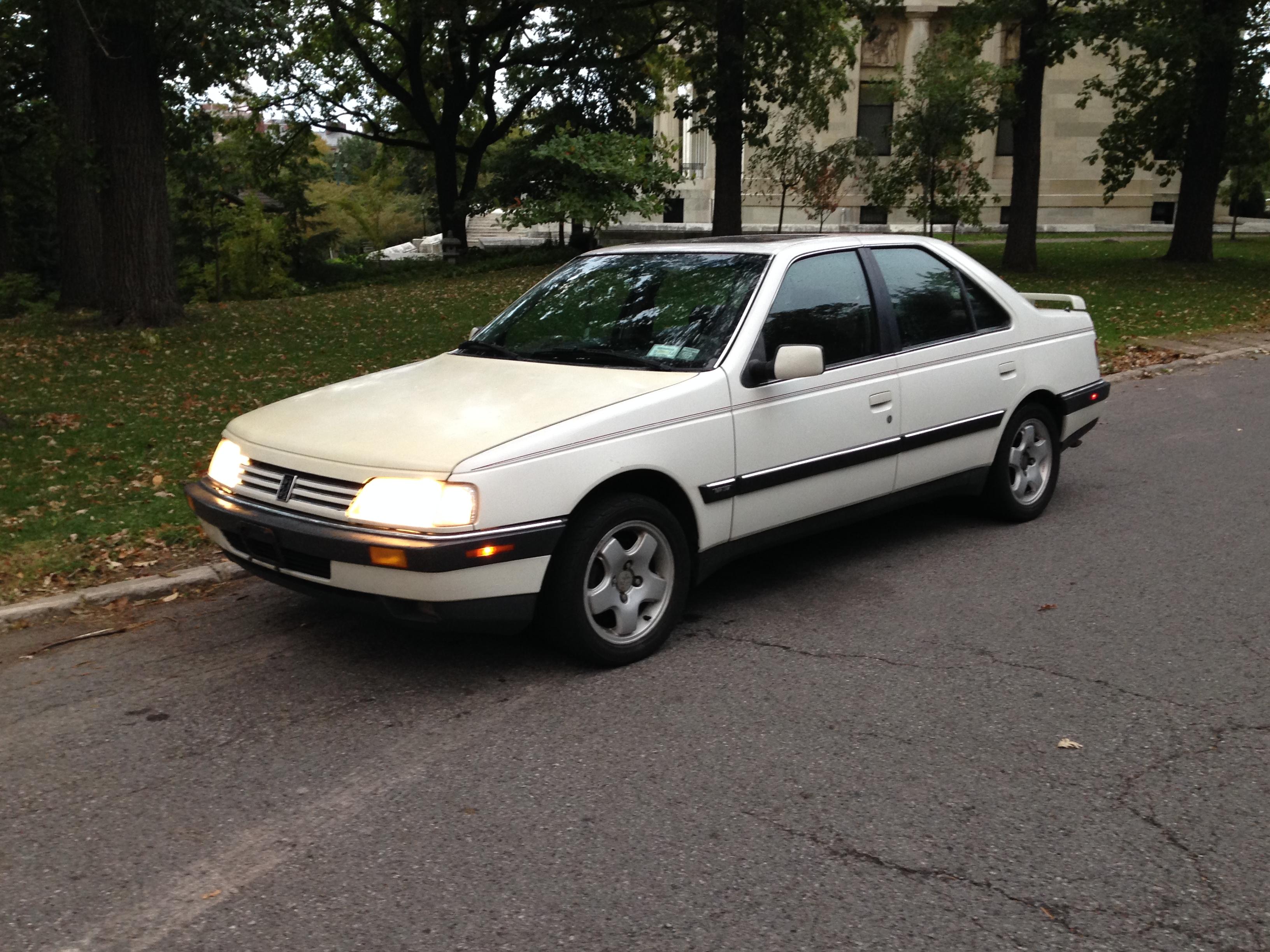

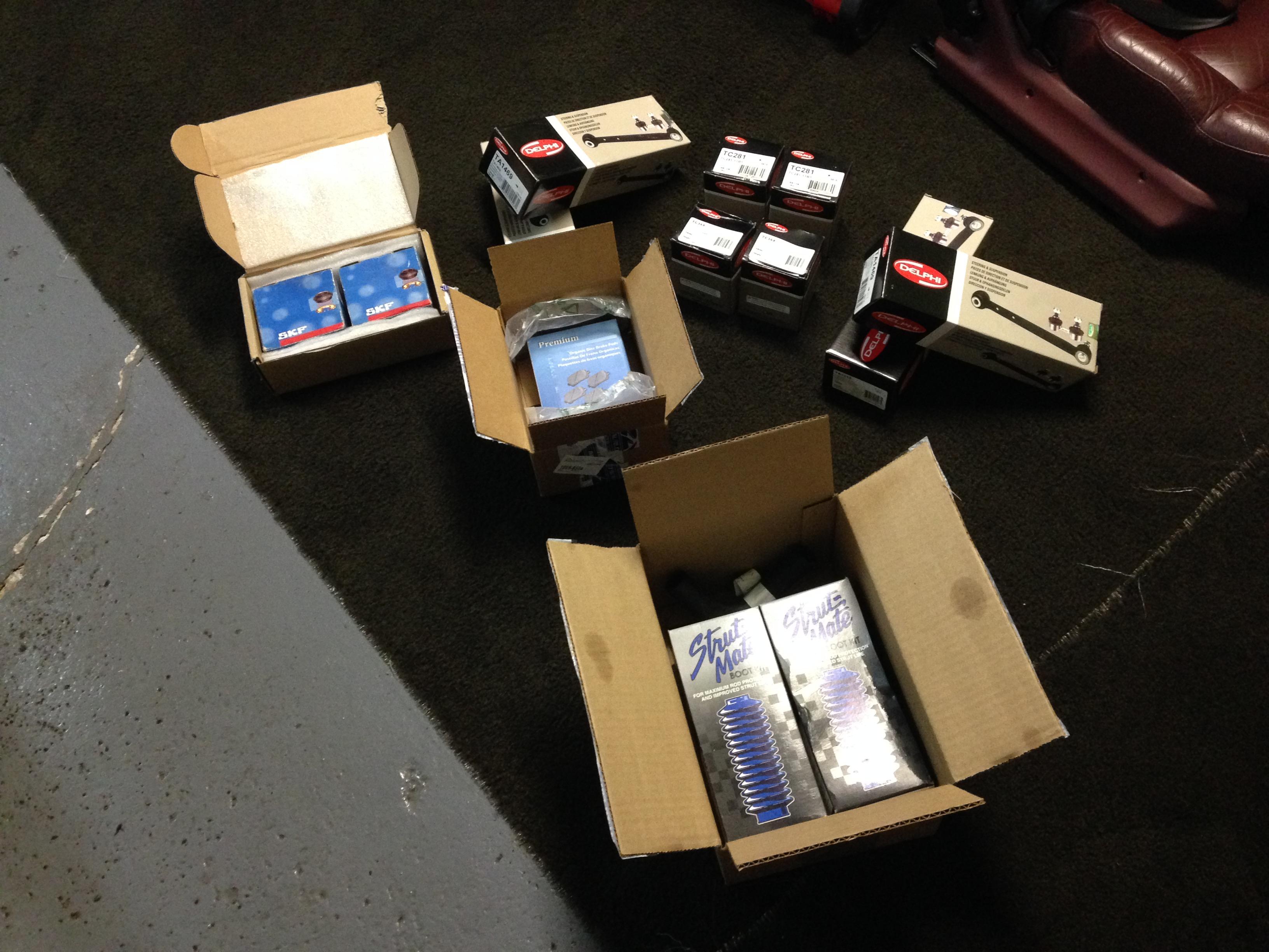

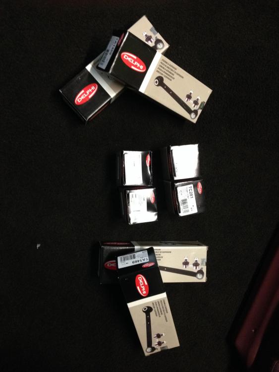

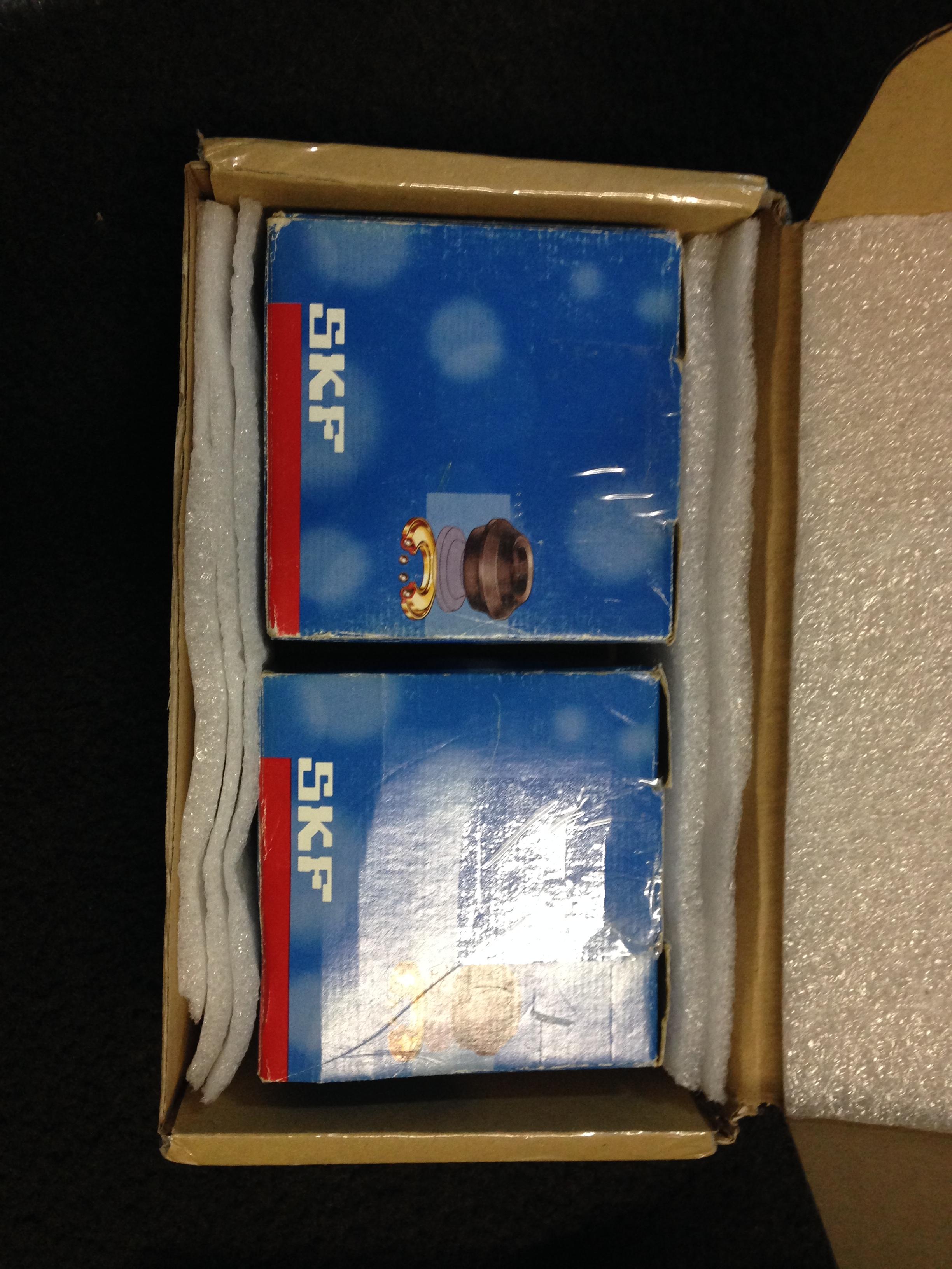

  5. So, here is the plan with this car. The goal is to make it a reliable daily driver for basically 6 months out of the year (may-october). The car has no rust and I intend on keeping it that way. Fortunately it spent the first half of it's life in the southwest, and has probably only seen 2 winters out here, obviously before I owned it. I am aiming to keep it stock, with just some minor updates where it makes sense. I've made the mistake of modding some cars too much, I need this one to be as user friendly as possible, while still being fun to drive... As far as work to do, here goes. We started out with a full belt service, including timing and all accessory belts. All fluids (engine oil, gear oil , brake, clutch, coolant) will be done over the next 2 weeks, once the suspension overhaul is complete. The suspension was actually quite tight, however the driver's side inner tie rod had a little play so I purchased 2 new inner and 2 new outer tie rods, that way everything is new. Also found a set of Boge 1 inch lowering springs (ok, a modification already...), those will be going on the factory struts, as well as 2 new upper strut bearings and bellows, and a new set of lower ball joints to wrap that up. The rear suspension is tight and not needing anything at the moment, but I did just find a set of new KYB GR-2's that I am going to pick up to be used at a later date... I should also add that before everything gets reassembled, both front wheel wells will be fully cleaned/degreased...

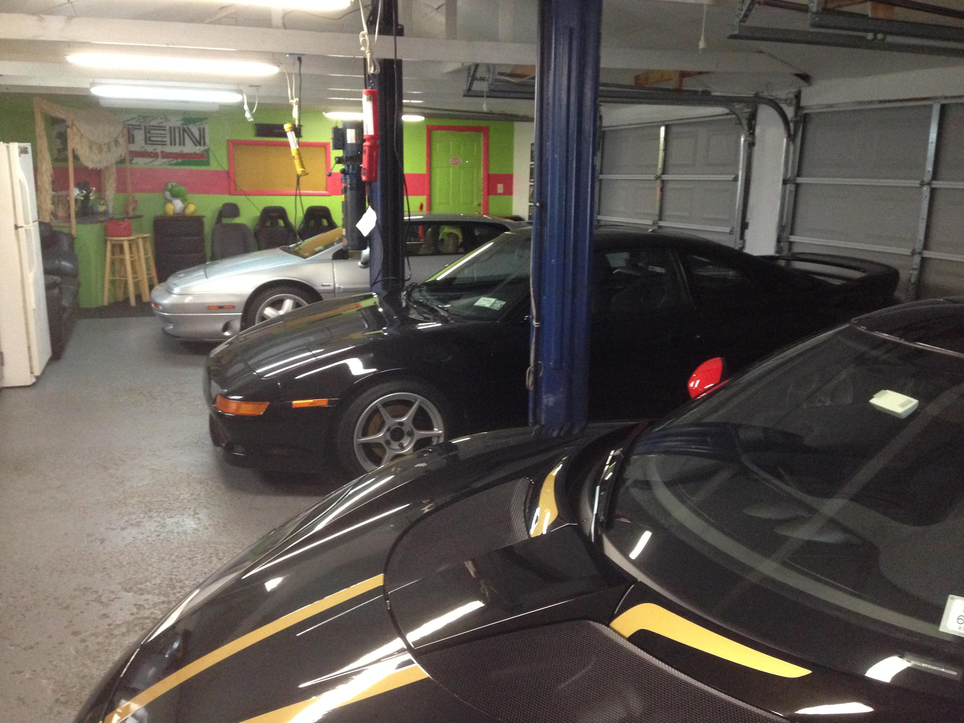

  6. And here are some photos of my other cars and the main garage: a '91 Toyota MR2 (we have 2 of them), '95 Lotus Esprit S4, and '12 Lotus Evora S GP Edition. The red MR2 (not pictured and black/gold Evora are my mom's. At least the Peugeot has some good company to keep in the garage...
